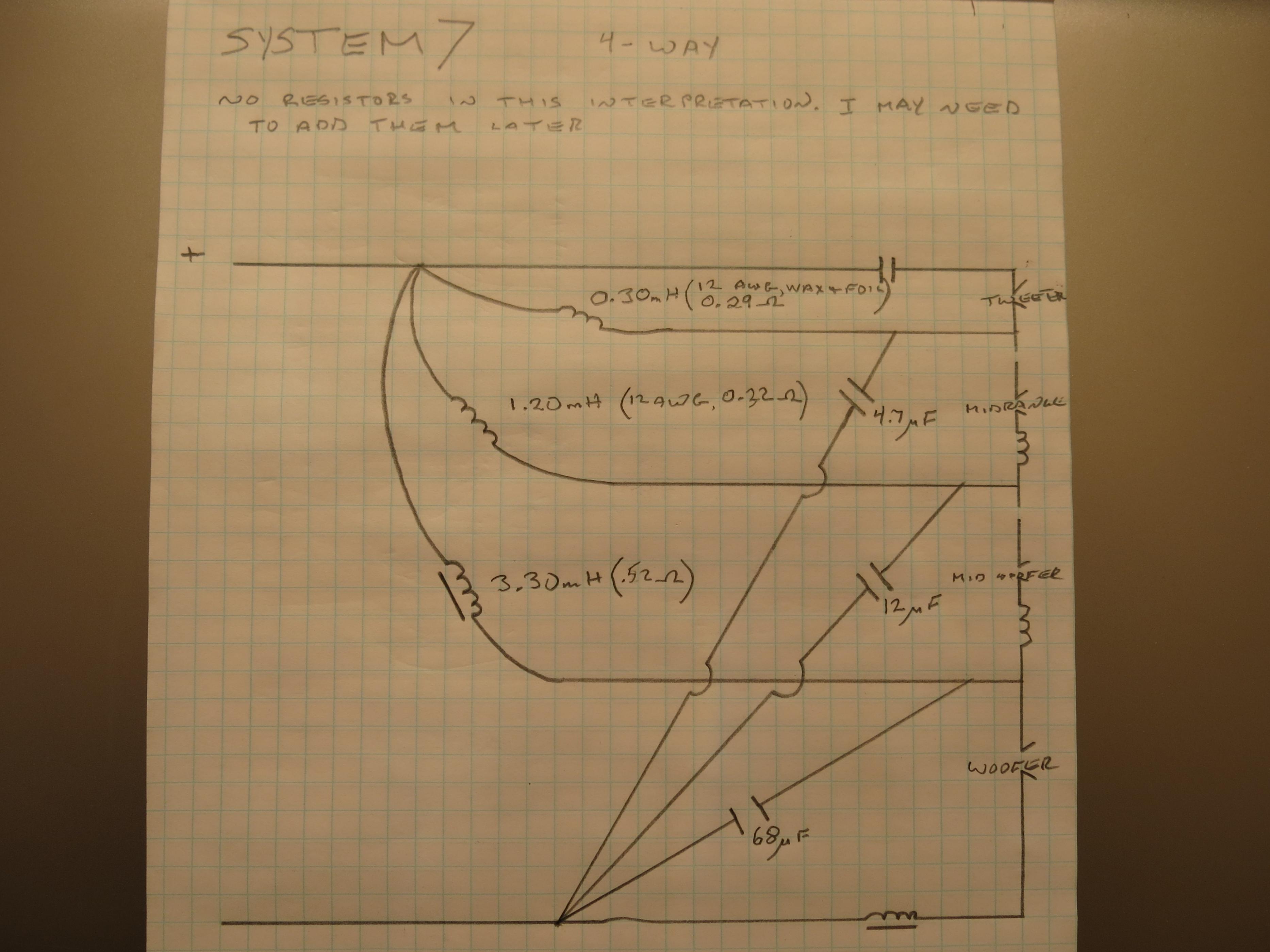

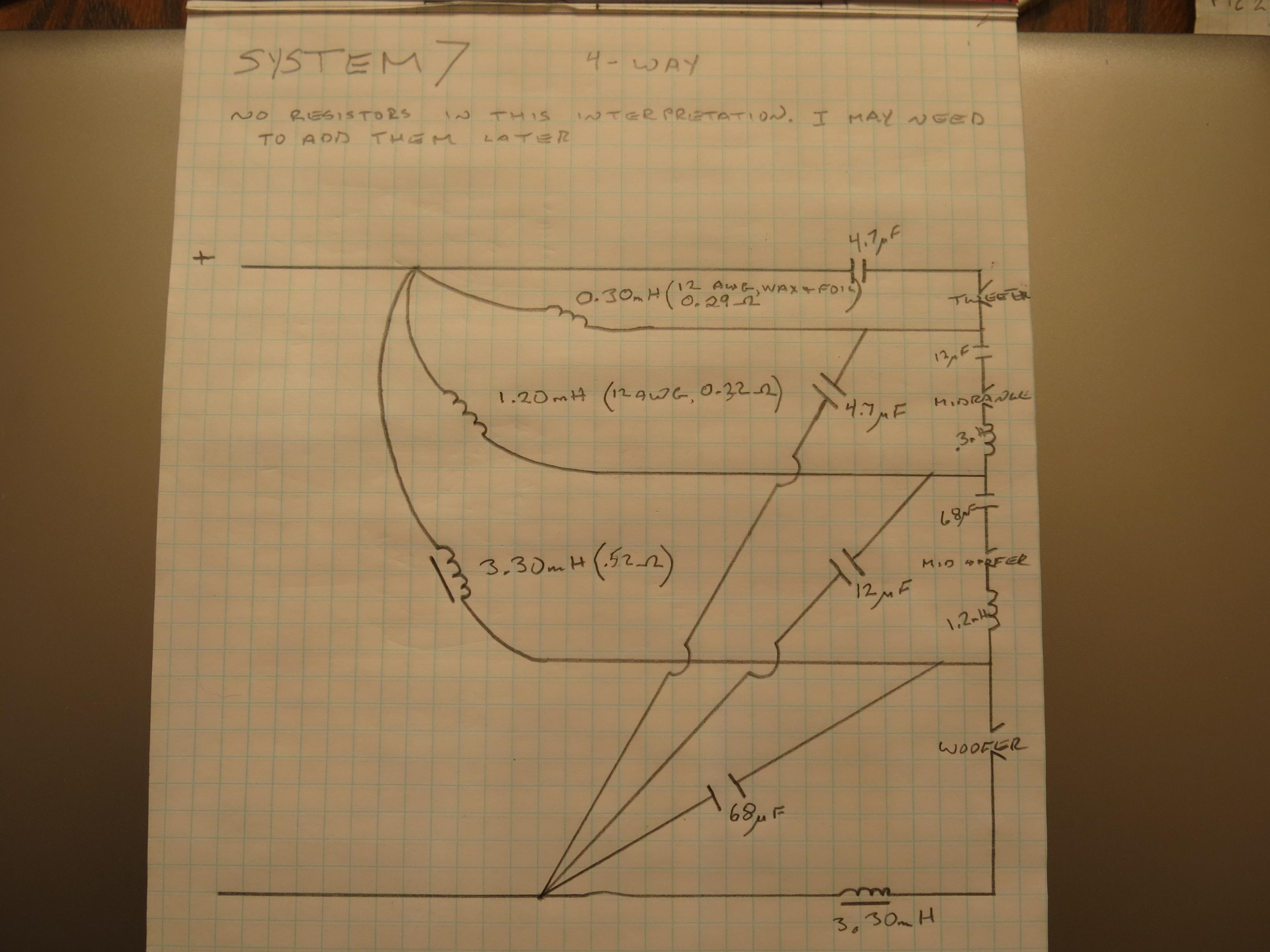

I used his values, in my schematic.
I try not to use resistors. I know they are sometimes a necessary evil. I also know they are part of Mr. Frieds ideas. Sorry.

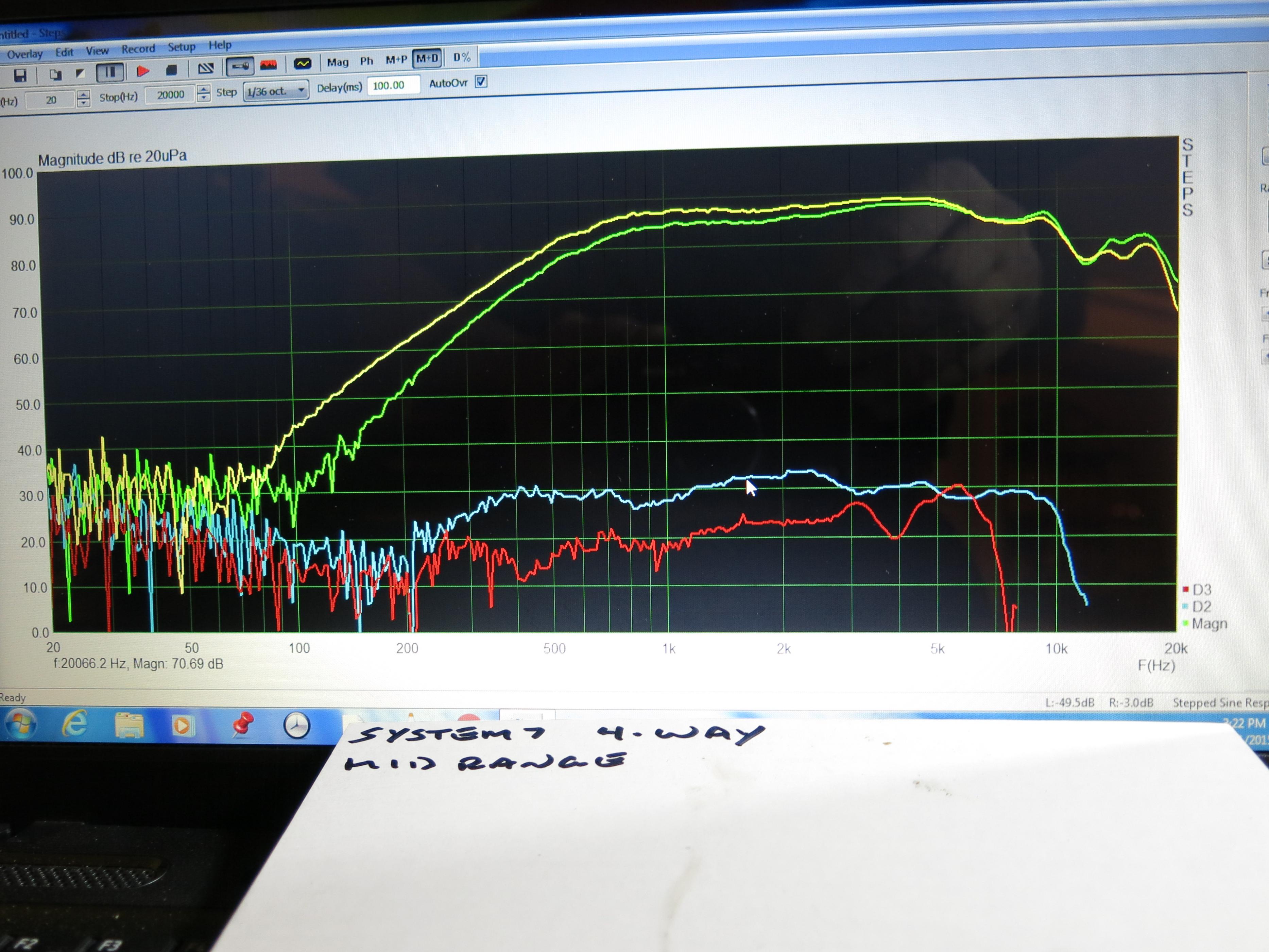

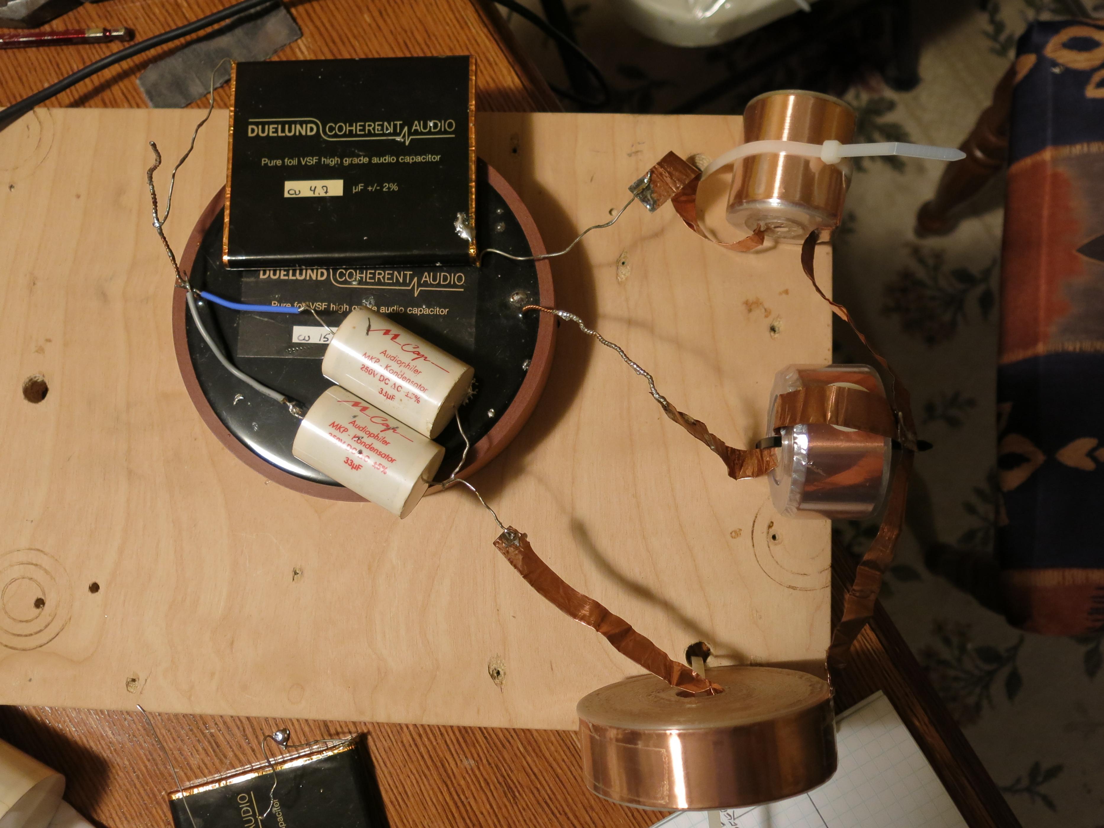

Picture 1) The schematic.
Picture 2) What it looks like.

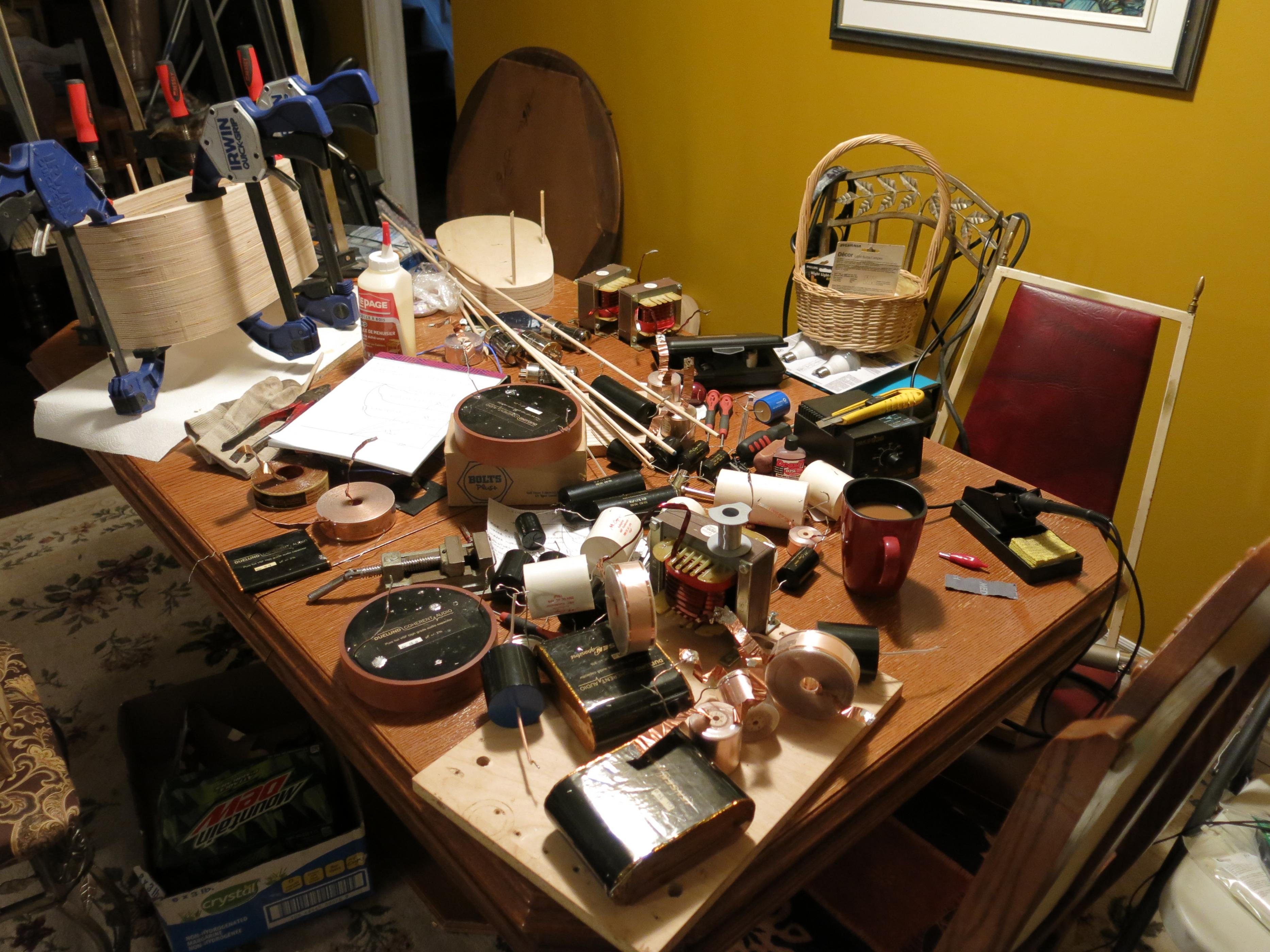

Picture 3) My wife doesn't come in the basement any more. She says I need therapy, maybe even stronger meds?.

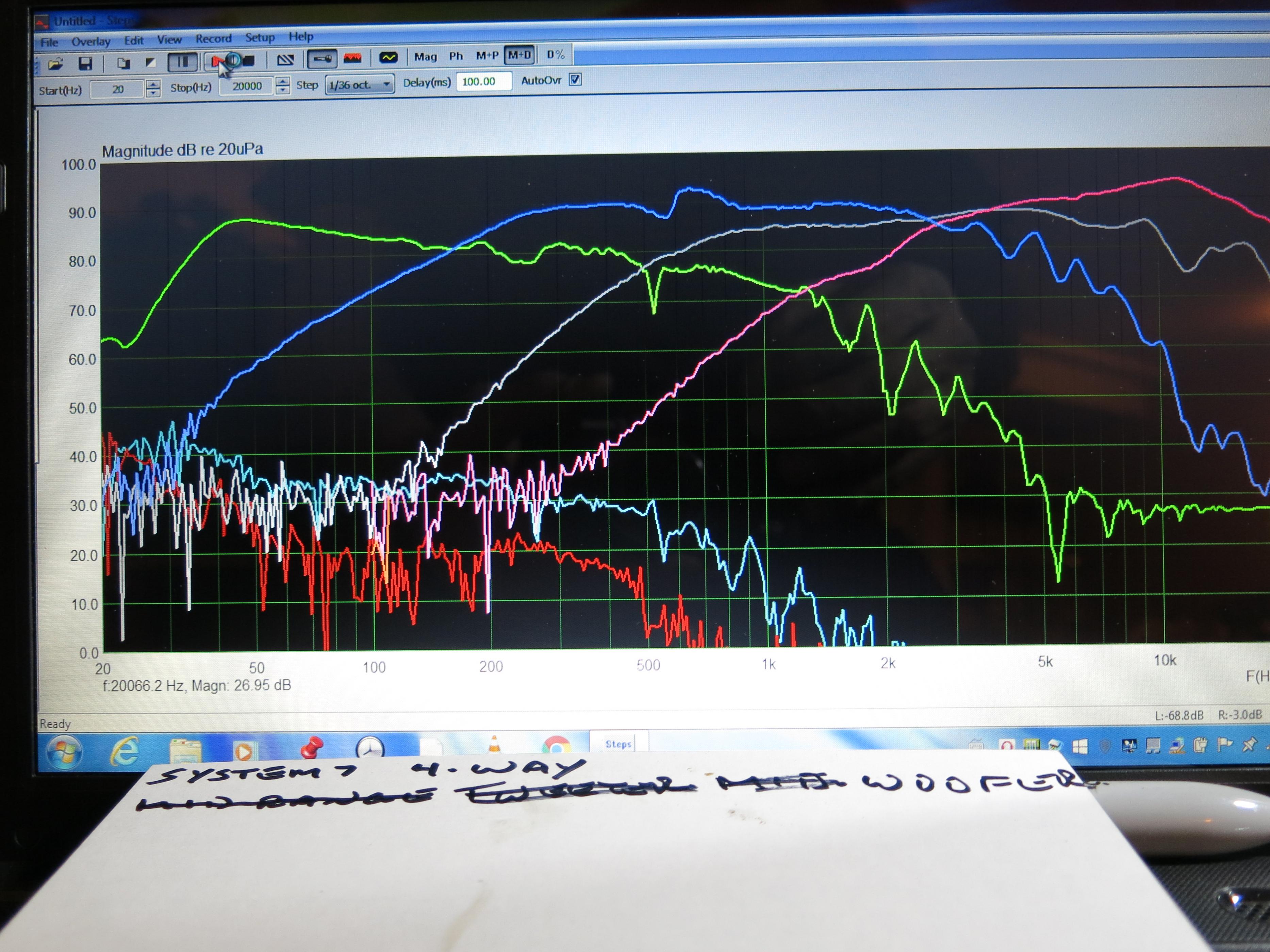

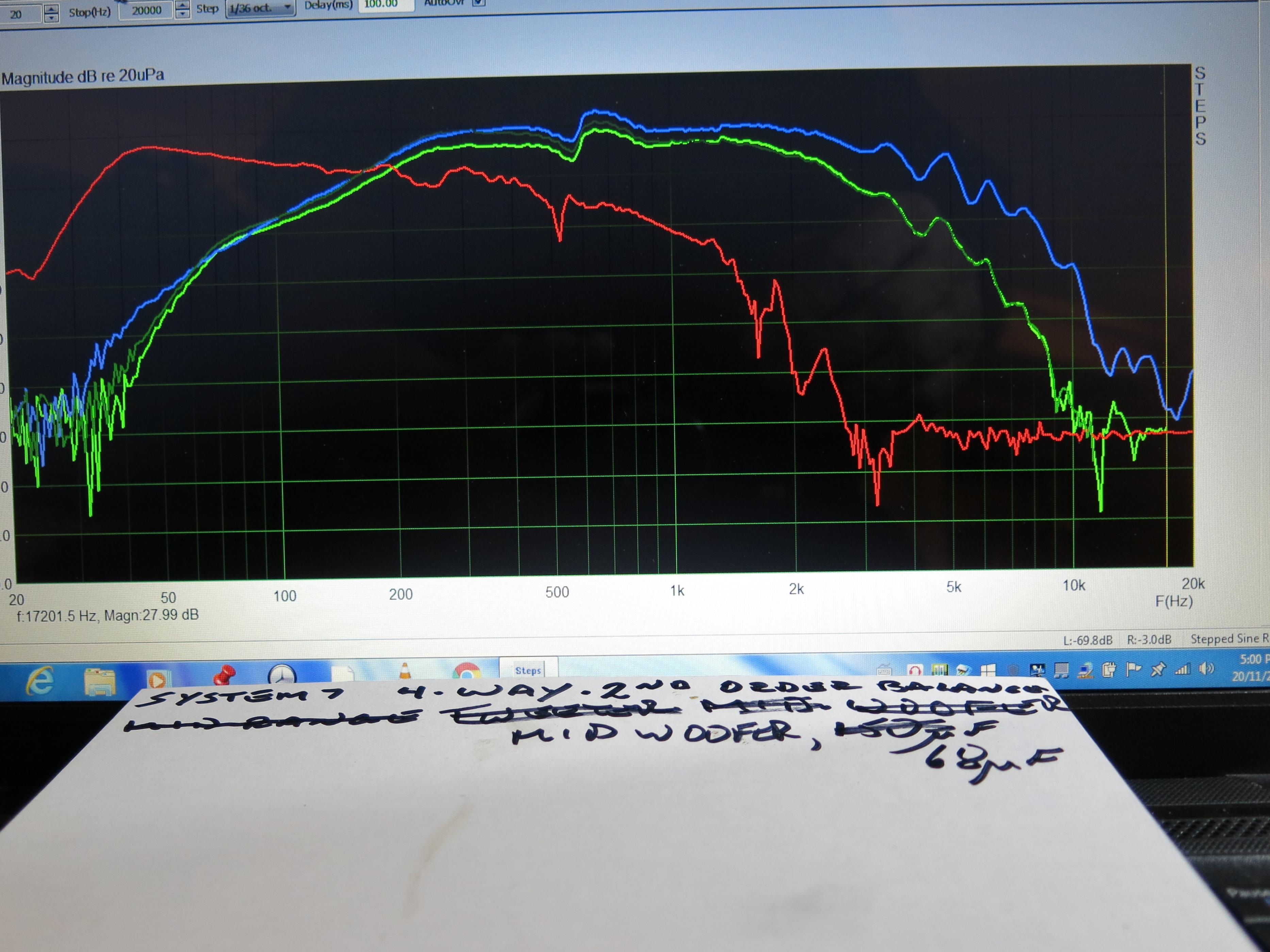

Picture 4) Todays midrange trace. I left the 3-way, 1.5mH trace up for comparison. It's the afternoon, so house voltage may be down a bit?.
Picture 5) Tweeter. We cross around 3800Hz.
Picture 6) Mid Woofer. We cross around 2600Hz.
Picture 7) Woofer. We cross around 160Hz.

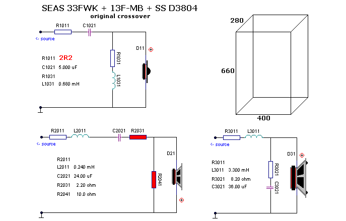

Let's go back to Steve's pictures and see how close they are?

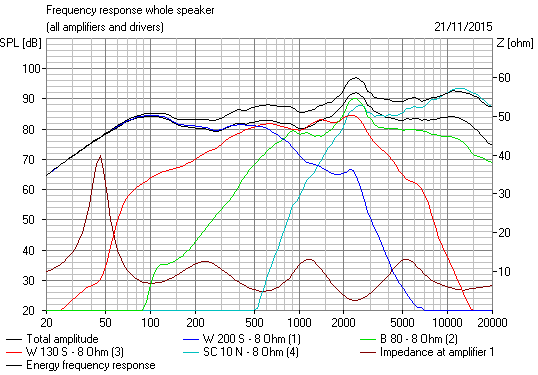

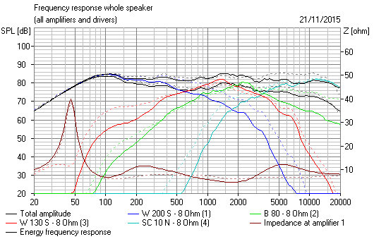

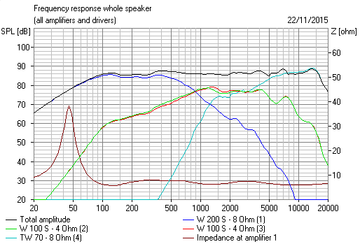

So
Measured tweeter / midrange x-over was 3800Hz, modelled was ~ 3300Hz. Not bad.
Measured midrange / mid woofer x-over was 2600Hz, modelled was ~ 1700Hz.
Measured mid woofer / woofer x-over was 160Hz, modelled was ~ 960Hz. Hmmmm?

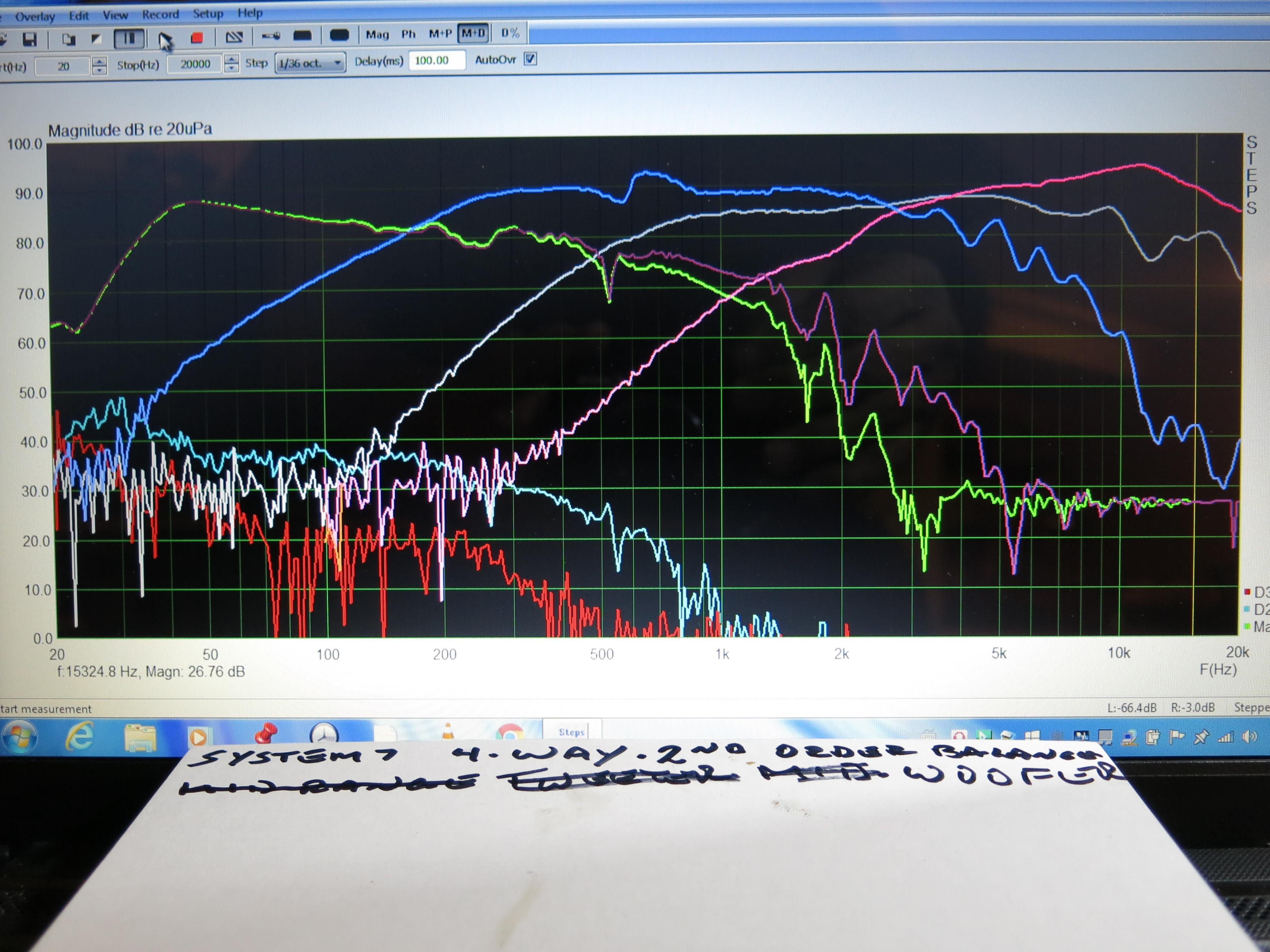

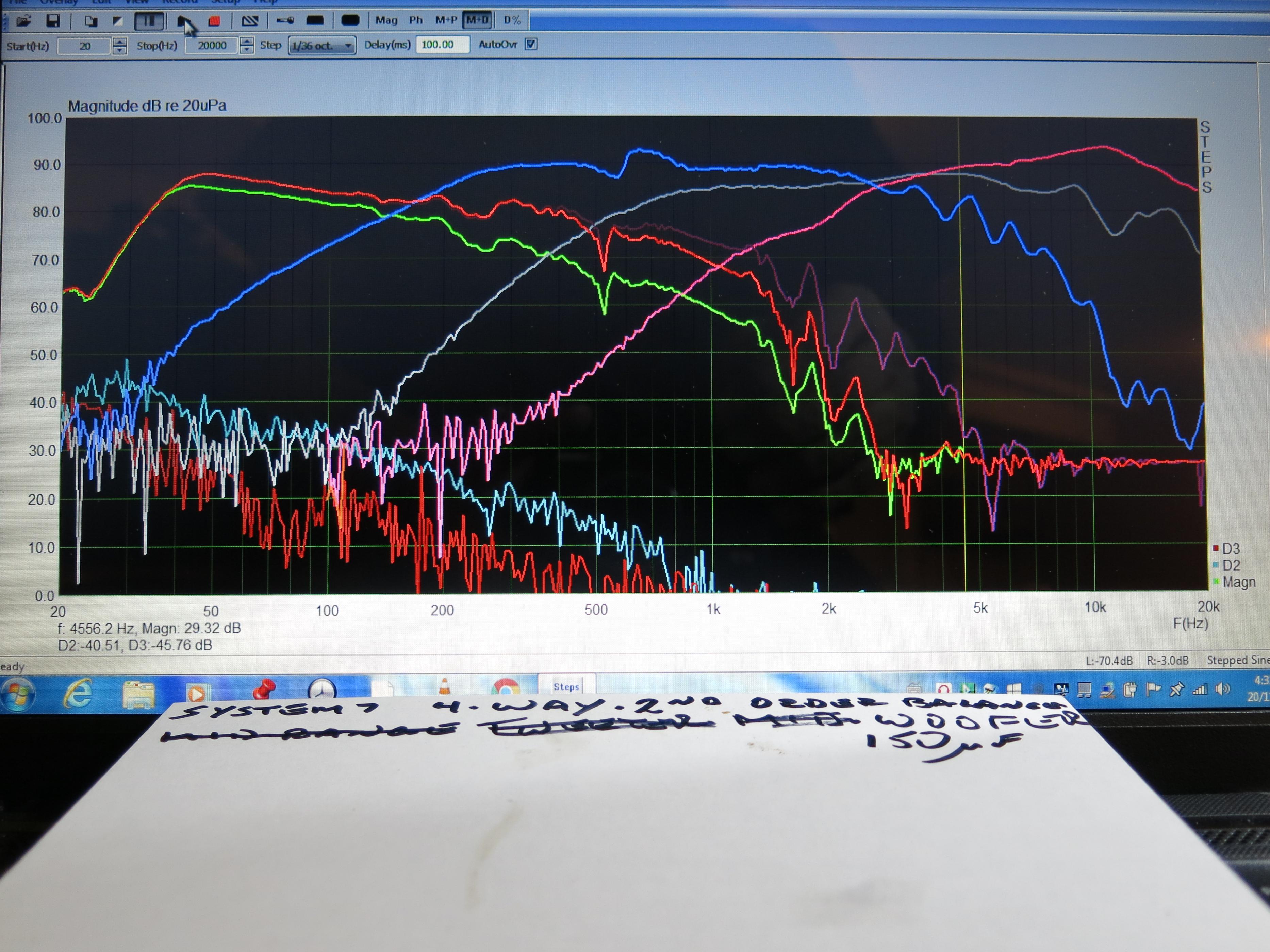

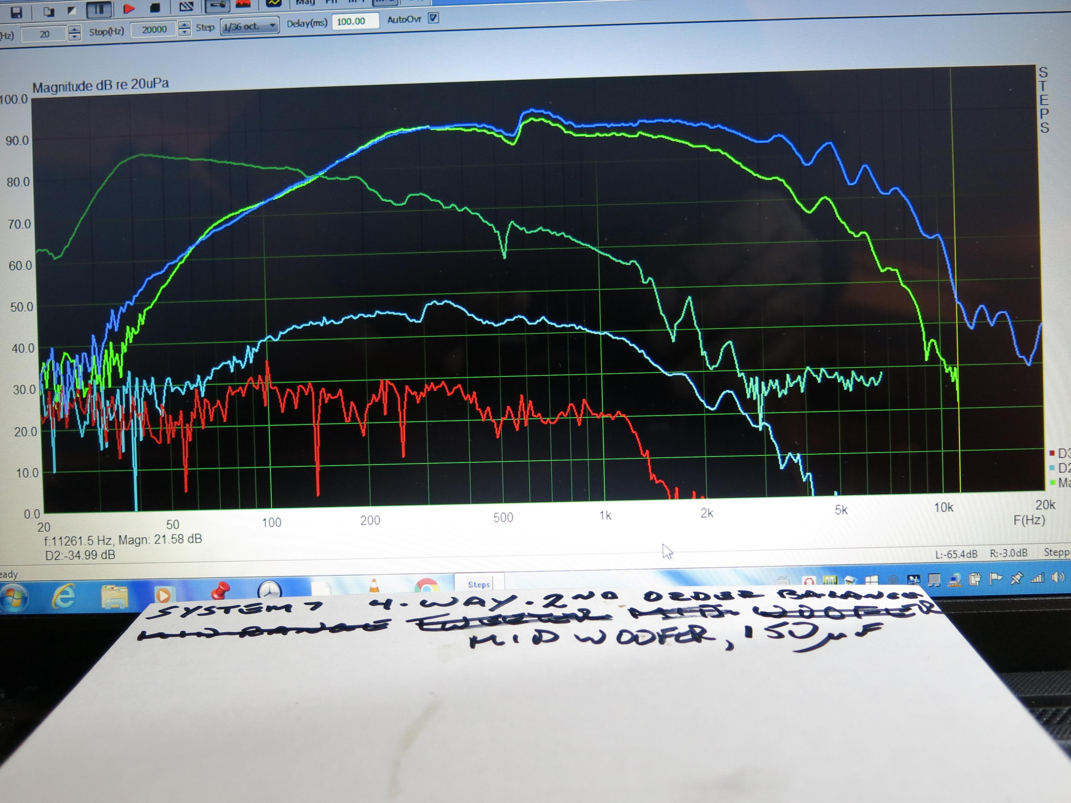

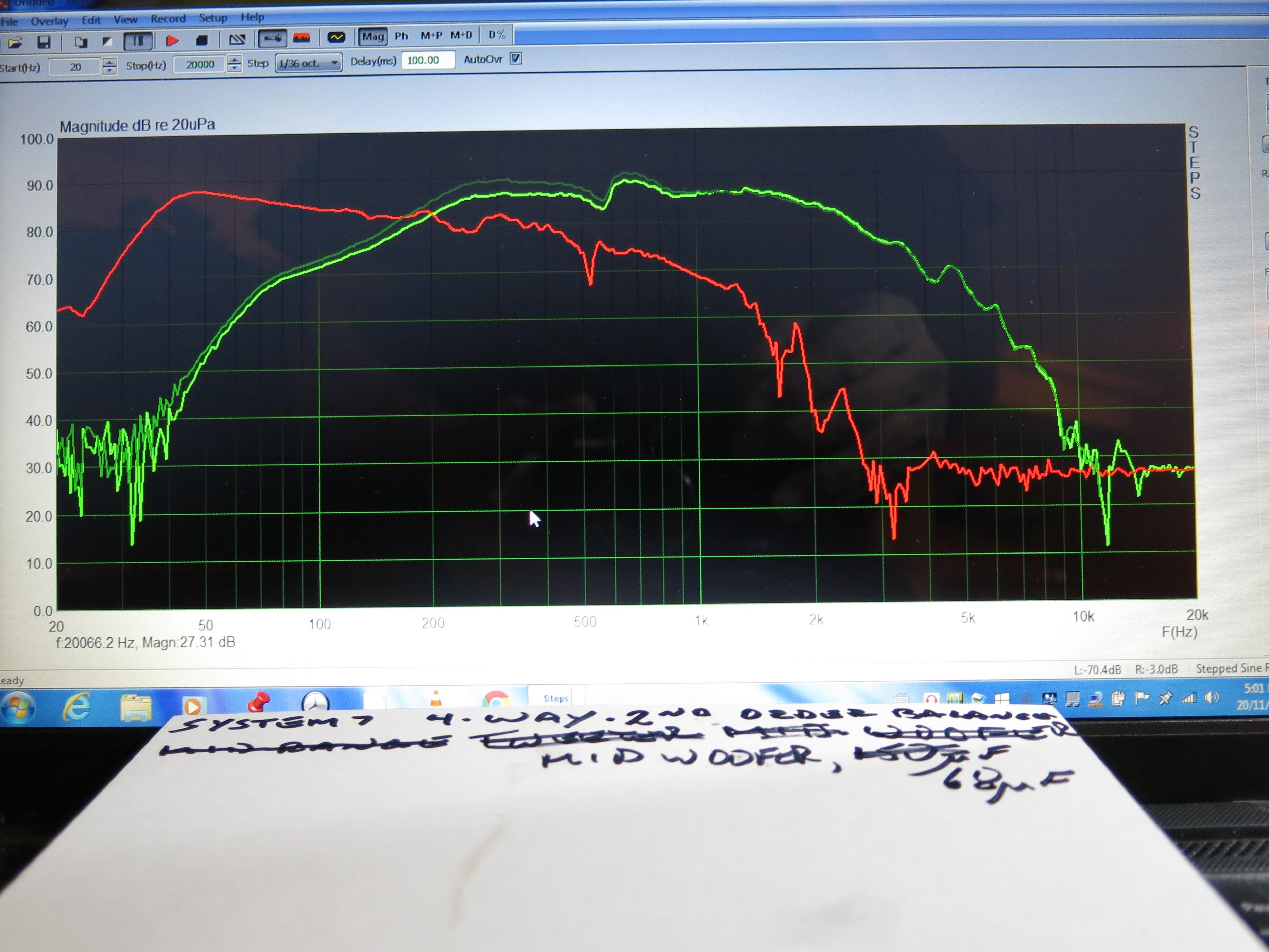

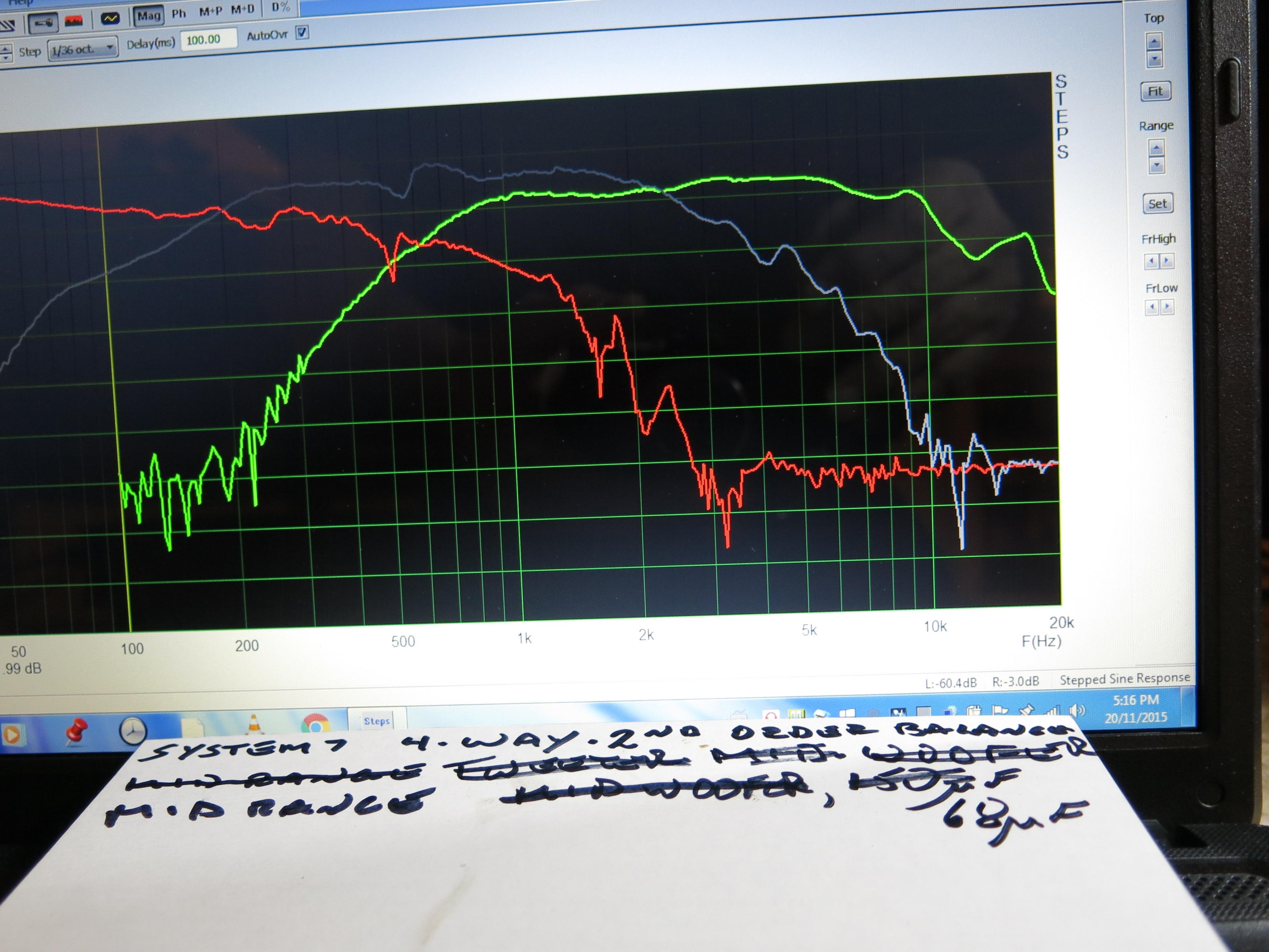

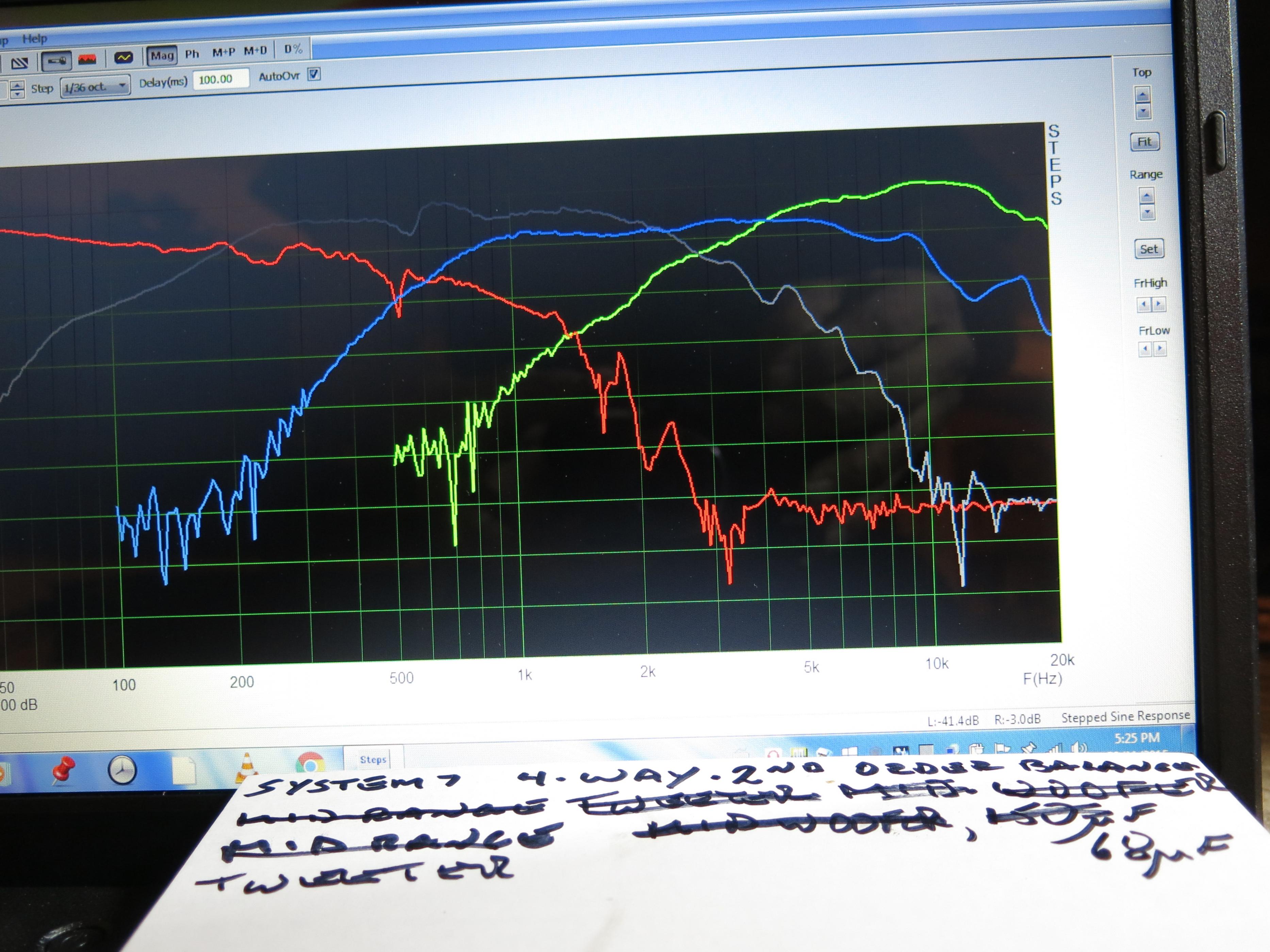

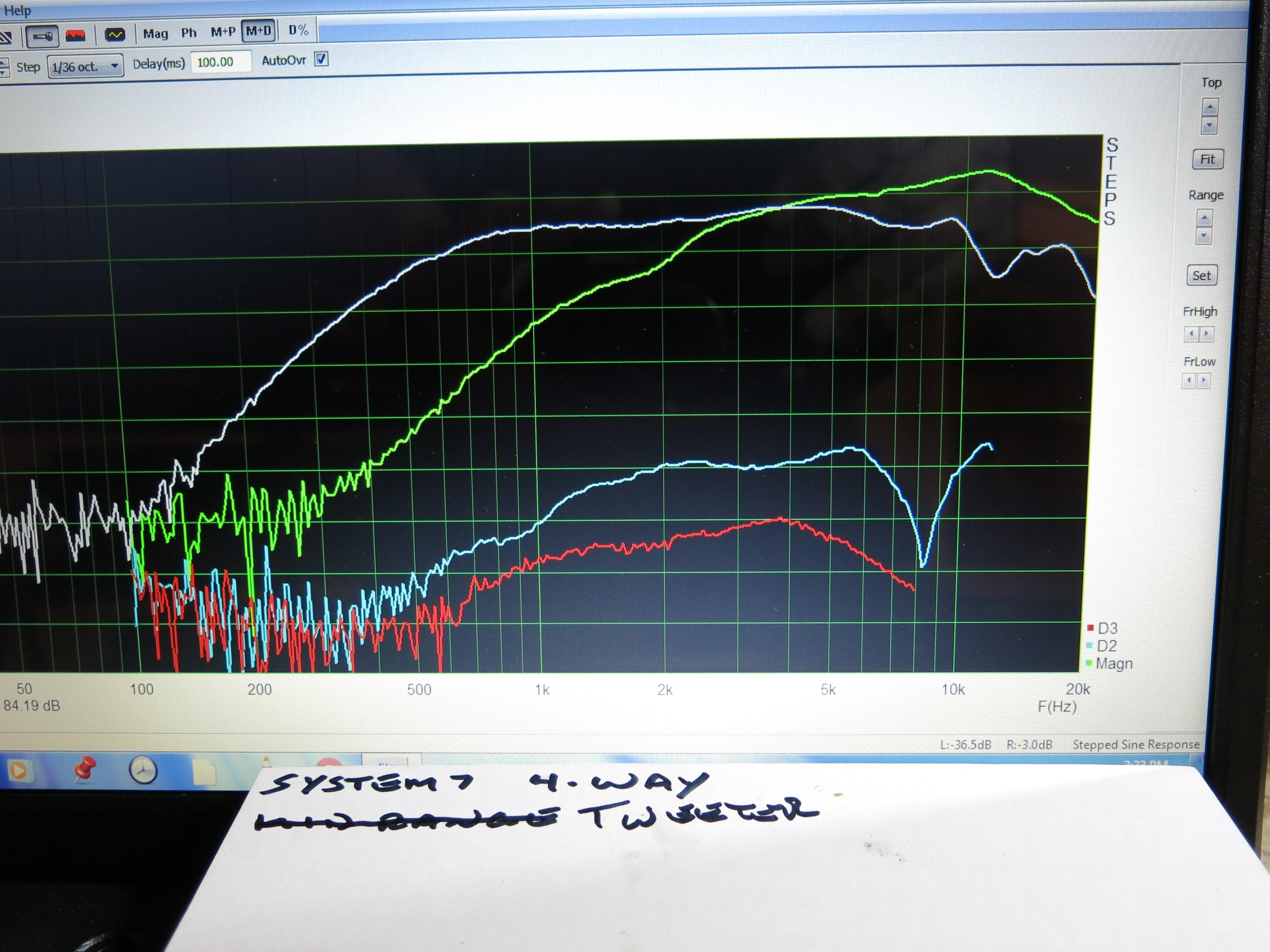

Let's make system7's crossover a 2nd order balanced system.
Picture 1) New schematic. The balancing bits are all attached directly to the drivers.
Picture 2) New woofer trace. I left the purple trace from the 1st order measurement.
Picture 3) Still the woofer, but I increased the 68uF caps to 150uF. The drop in the low end is not what we want. This might imply we need a larger inductor. The inductor we're using has R of 0.53 Ohms. With a larger guage wire, this resistance would drop. A lower resistance inductor might also change the slope. The lower output after x-over is good. This might imply the mid woofer is playing more of the music it's suppose to.
Picture 4) The mid woofer with the 150uF capacitors.
Picture 5) The mid woofer with the 'proper' 68uF. I feel this value pushes too much energy back to the woofer. I need to do more waffling.
Picture 6) Mid woofer with the blue trace removed (Less cluttered).
Picture 7) Midrange.
Picture 8) Tweeter.
Have a great weekend everyone.
Picture 8) Tweeter.
Bill, it is time to take a break, and get some fresh air and exercise. Really.
Your more complex filter just doesn't work in any sensible way.
I can only show you what it does with my choice of drivers. A complete mess.
Back to the drawing board when you have had a rest. Your nice simpler filter will still be there.
You can't just use the same values for first and second order filters. Are you using these formulas to calculate the components?
2nd order series:
C = 1 / (2 * π * f * (Z / √2))
L = (Z / √2) / (2 * π * f)
2nd order series:

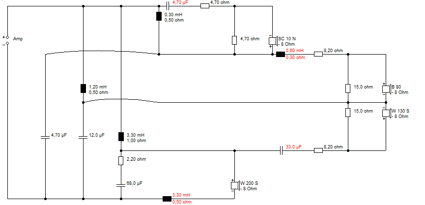

Bill, this isn't an argument. I'm just trying to keep up with what you are doing.
For sure your 3rd/4th order filter has lost the flat impedance.
The more regular way of making a 3rd order series filter might look like the below. The red components are the merest guesses.
Even so, impedance is not flat. But tidier than your series LCRs on the mids.
You can add more to make it fourth order, but I haven't got time right now, and I've forgotten what the component ratios should be.

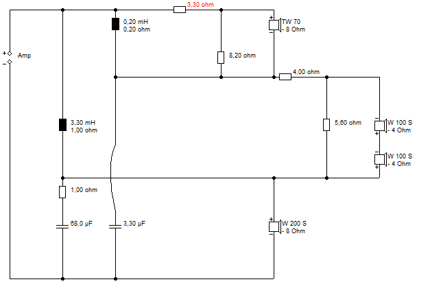

Steve;
Your second 3.3mH inductor is in the correct position.
Your second 4.7uF cap needs to be moved to the right. Past both 4.7 Ohm resistors.
Your .60mH should be a capacitor (not two inductors in a row).
Your 33uF cap should be an inductor. (not two caps in a row).
Let's start with that.
Recap from page one of this thread;
This is a first order series crossover. That's it. Nothing more.
The 'balancing' components ensure the driver sees the exact same pull up of the wave form, as the pull down. Please review my thoughts on 'balancing'.
The balancing components do not make this a second order crossover. At least not in the traditional sense. The greater slope is simply an added positive byproduct.

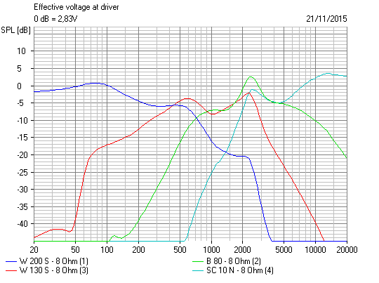

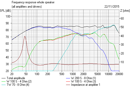

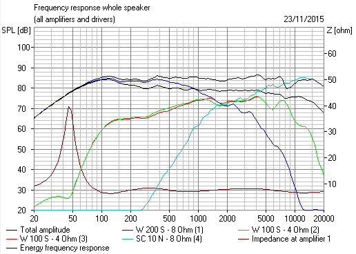

No, No, No. 😱
Your original filter is very good. I like it. But it's important to look at it in a simple way.
It's a second order series filter with a novel and economical topology. Let's look at the three way version and what it does.
Next, I've done something similar with a parallel circuit. And throw in the SEAS Kit 503 to show how mainstream this is.
You can of course do steeper filters like SEAS-3-Way-Classic, and maybe it helps. But simple filters can be very listenable if done right at every level including driver selection. Even two ways. http://www.diyaudio.com/forums/multi-way/147632-classic-monitor-designs-25.html#post4428857

Hey Steve
Nice impedance on both. Nice slopes on both.
I see what you mean.
Monday I'll pick us cheap high value caps and continue measuring.
My circuit will be using a 5.6mH woofer inductor.
Any chance you could do a quick sim with that value? (on the first of your three crossovers)
