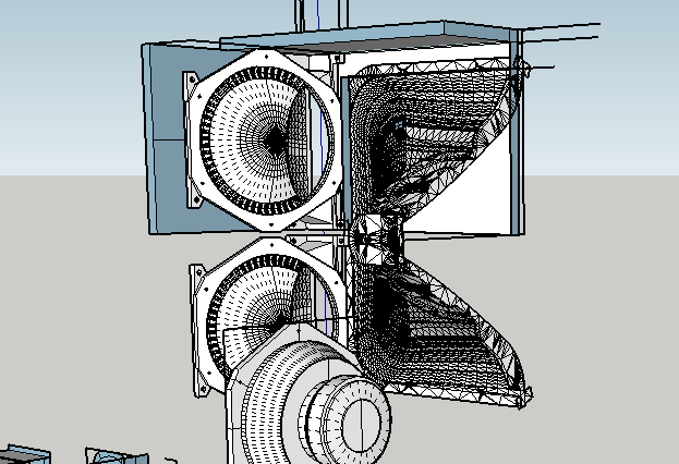

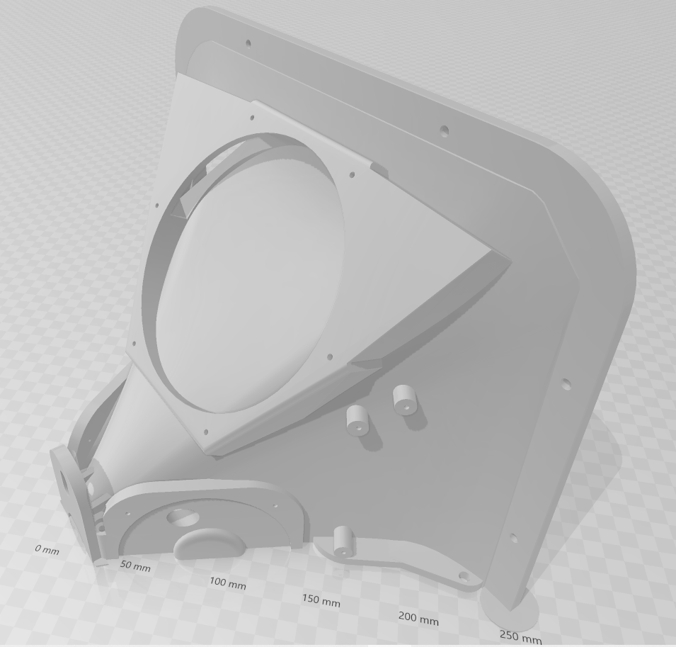

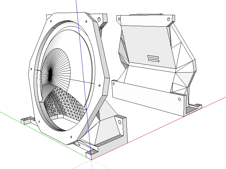

I'm working on a few speaker options based off of this speaker design.
I have designed printed woofer mounts for easily placing the driver exit ports to the sides of the horn. It is positioned for the shortest exit port possible while keeping the sides of the horn as narrow as possible. With 1/2"(15/32") material you can go as small as a 24"w x 15.25"h baffle with four woofers.
They are designed to mount fully inside the enclosure, and have a 1/4" lip inside the mouth for flush trimming the pass-through hole should you desire. I did...
I thought I would put them up here for anyone else who might get an idea from them.
I would suggest at least 2.4mm walls with 30% cubic(or similar) infill. Print with the mouth downward with supports at 50-55deg, as this leaves a large area at the drivers center to be supported, and it can come up through the mouth.
SketchUp and STL files attached

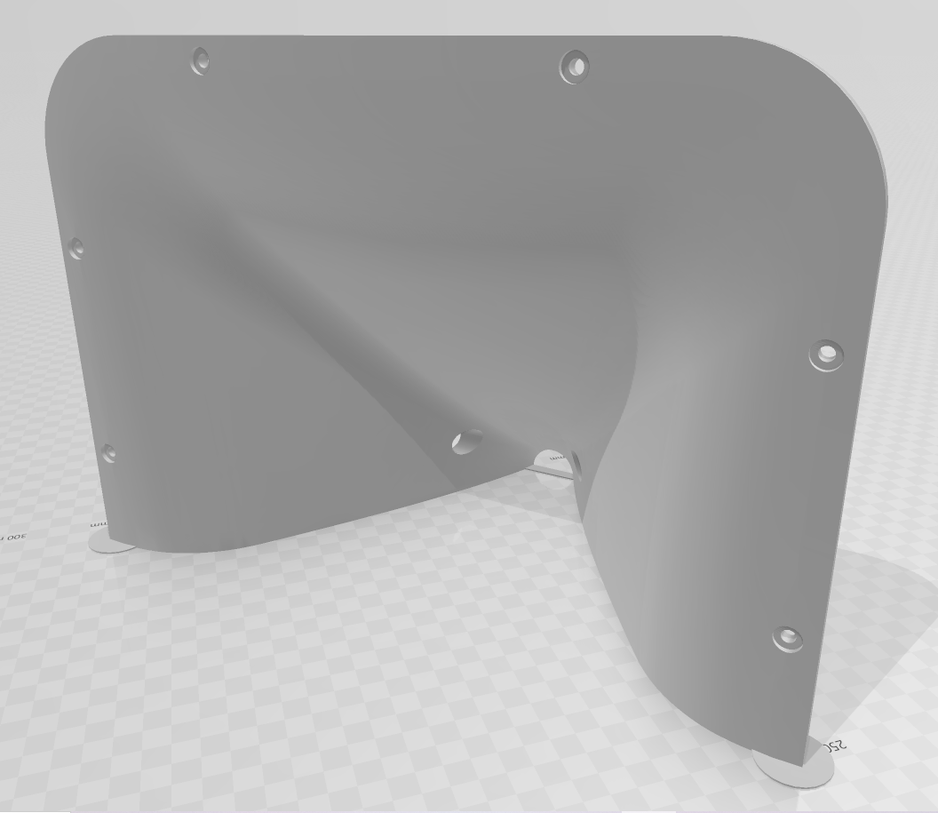

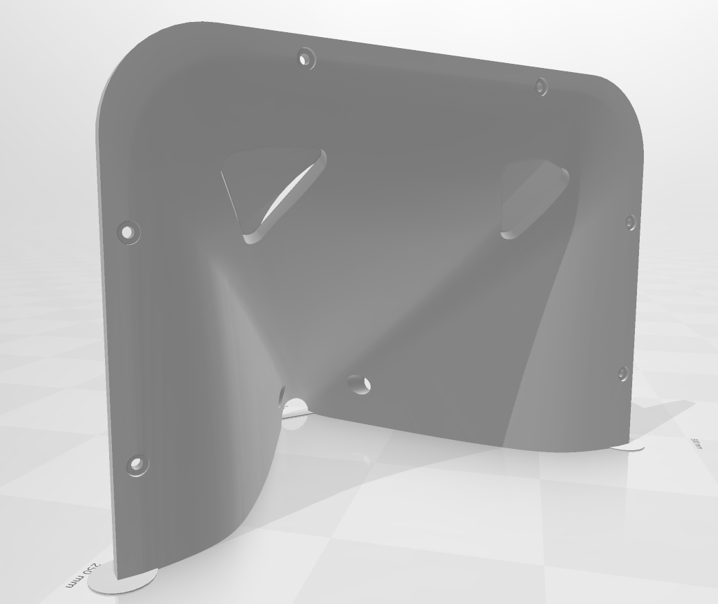

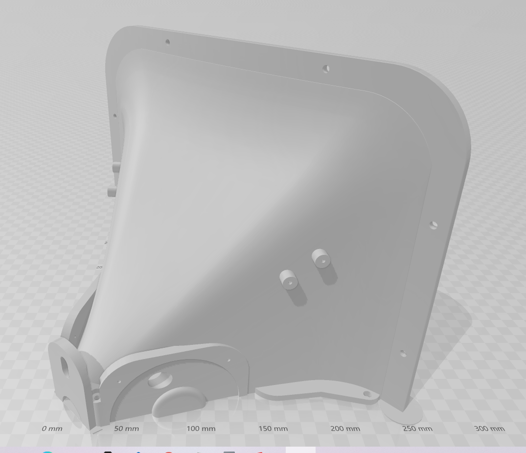

I have made a few alterations to the waveguide STLs bwaslo has graciously provided for us here in this thread.
After printing them out there were a few things I changed to make future prints and installations easier for myself.
I massaged all the section joining mismatches (got to love fusion,) added a bit more plastic around the cd mounting to horn area, and cut a lip for mounting the horn to the baffle. You just trace the horn out and then inset it 5/8" in from the sides, top and bottom. The come in 1"-5/8" from each corner and draw the diagonal.
I used #6 x 3/8" pan heads for the mids, #6 x 5/8" pan heads for the woofers, two each #8 x 3/4" and #6 x 3"(2.5" would work better but aren't local for me) bolts w/nuts to join the waveguide halves. Then #8 x 3/4" pan heads to mount the waveguide.

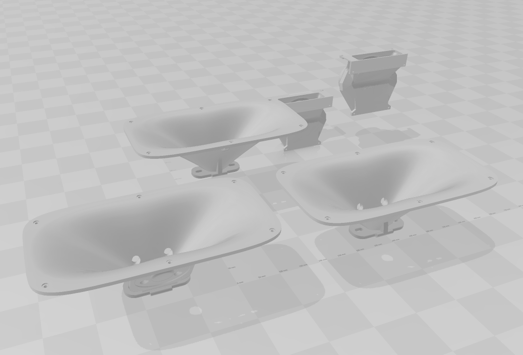

Then I am switching gears and moving to a printed 16" waveguide Small Syns adaptation for myself... Went ahead and did three versions of the horn for future use... My eminence h290b version wasn't bad, but it was always just a place holder for a seos 15 that never turned up...

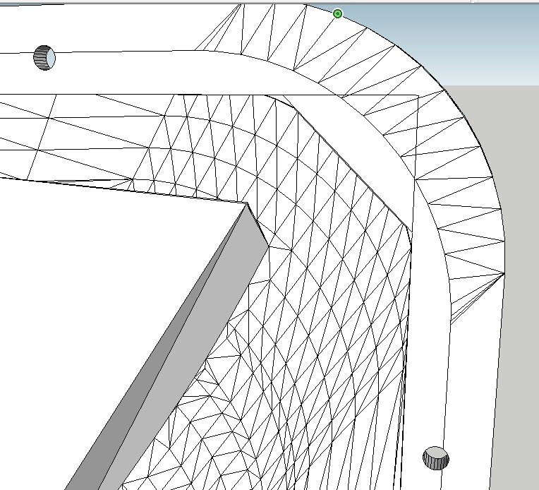

The messiness of my files isn't really all Fusion's fault, I literally was first learning how to do 3D design while I was making this horn so my workflow was probably about as bad as it gets and I didn't quite understand how the program see points on different sketches.
I really wasnt trying to knock your files. All cad programs have their quirks.
I have had similar issues with fusion. You don't notice anything until you go looking and find a simple looking seam is really a multifaceted micro milimeter sized cavern folded over on itself.
SketchUp like i used here creates duplicate (or quad 😡) faces on top of itself almost at random. I probably still missed a few small ones. Cura was happy though.

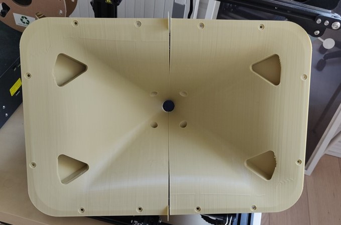

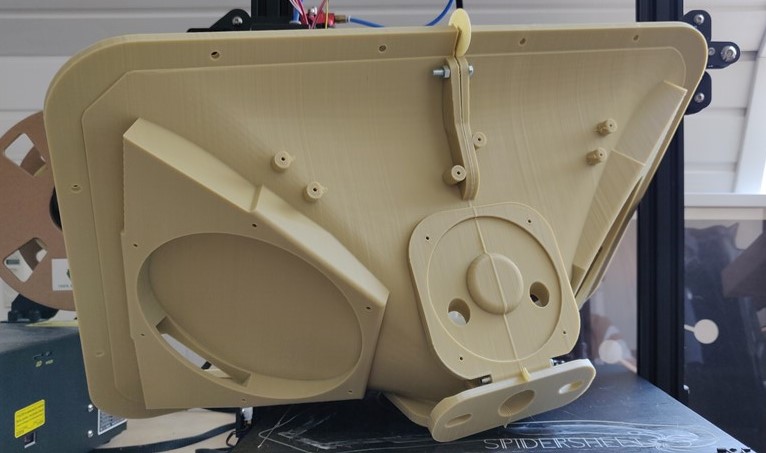

So I finally got to print my own horns. I used to version made by soho54 which removed some of the small error in the file + makes mounting a bit easier. A big thanks to both Bill for designing the speaker and providing the file + to soho54 for cleaning it up.
Since I only have a 0.4 mm nozzle, I had to print with a layer height of 0.25 mm. That meant that each half took 70 hours to print. Quite a lot of that time was spent on me worrying that the print would fail.
My first print failed halfway through by the horn getting dislodged from the bed. Second attempt was done with glue stick on the bed, which resulted in a perfect print. The last half printed without any problems, until I noticed that the spiderprint (a surface treatment glued to the printers bed) had been pulled up at both diagonal edges of the horn, resulting in a slightly warped print. Since I can't bare think of printing another half, I just think I'm going to fill the 3 mm gap with epoxy and give everything a nice sanding and spraypaint. I don't think it will hurt the performance of the speaker once fixed.
Next up is assembly of the crossover and buying the last drivers before testing and measuring.
