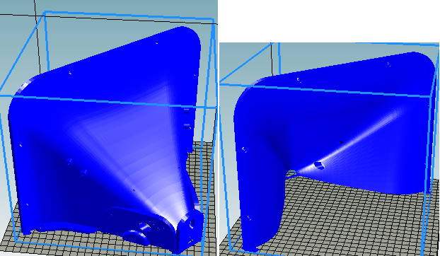

Hi bwaslo. I was looking into printing this for a member here, but when I imported the horn half into my slicer, it appears the horn is larger than my 300mm print bed😱
Is the model intended to printed the scale that the STL files open in?
Thanks for your work, this looks like an awesome project. I was going to do one for myself.
It has to be positioned diagonally on the 300mm square print bed. Then it fits (barely). It was designed to be the largest that would fit on the bed.
Here it the file with the diagonal positioning, might make your slicer more happy!
http://libinst.com/3DP/WG4%20positioned.stl
Oh, 220 in one of the axis? Sorry, I don't think that will work. It was set up for a 300x300 bed, with 'z' able to go to 250

In the (unlikely) event that someone is printing the waveguide for this, and wants to do a version without the woofers mounted onto the horn, here is an STL file without the woofer mounts --
