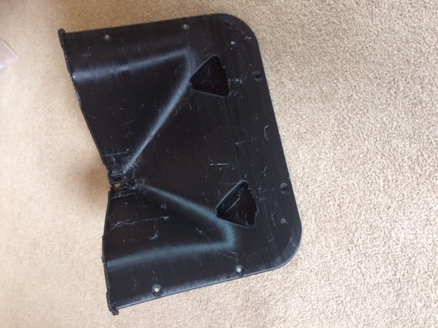

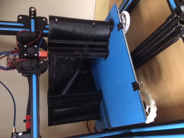

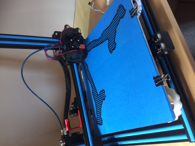

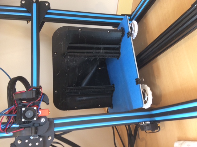

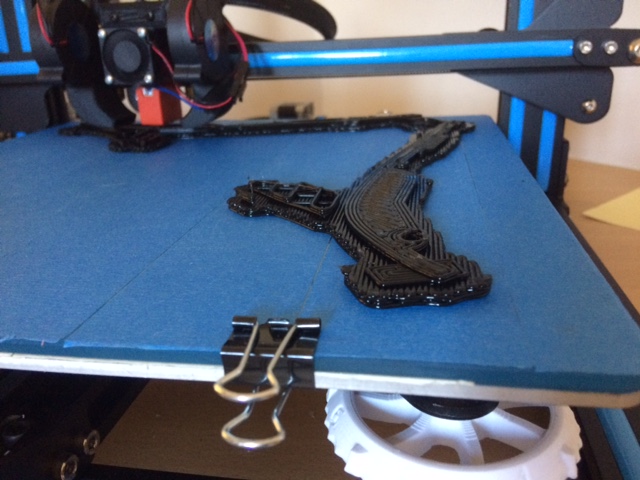

Here's my first complete half, after 26 hours and 53 mins. Unfortunately, it's warped, and so I'll have to fill and paint it. I decided to print it with a raft and supports. This was because I had to abort my first attempt after a couple of hours due to excessive sagging and even worse warping. I'll have to think about how I do the next one.
