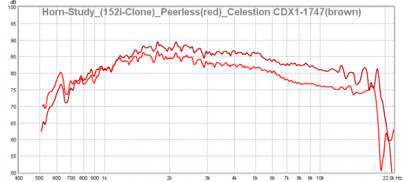

Bill, wouldn't overall sensitivity be 2-3dB lower with 1, instead of 2 Celestions TF0410MR?
Moreover, you've exchanged the small Celestion for the Peerless, but I guess the Celestion CDX1-1747 could be used as well?
This is driver is used in Paul Spencer's PSE-144 and according to Earl K's measurements it's comparable with the Peerless, even though the top end looks a bit ragged.

I was mistaken, obviously you swapped the Peerless for the DNA-360.
Both the DNA-360 and the Peerless are hard to obtain here in Europe, therefore the CDX1-1747 (which is the bigger brother of the 1745) appears to be a nice substitute.

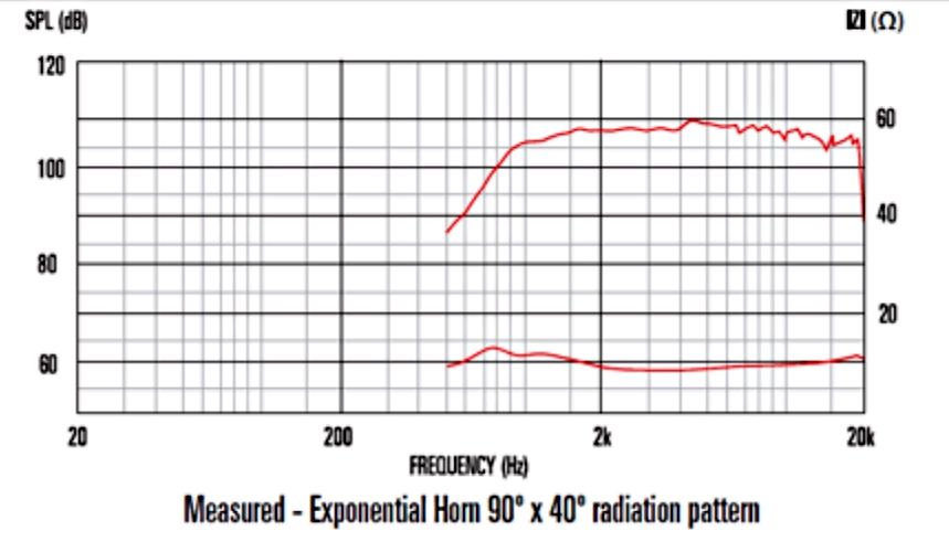

For what it's worth, here's the response of the CDX1-1747 with Celestions own H1 9040P exponential horn:

The DNA360 is an almost exact clone of the B&C DE250, they are essentially interchangeable.
With two midranges actually gets 6dB more sensitivity than one, but becomes nominally 4 ohms instead of 8 ohms. But it doesn't mean too much, one is still sensitive enough. The midrange isn't the limiting factor on overall sensitivity. Just changes the crossover components some.

I am aware of the DNA-360, its qualities and its origin. I remember posting in the "Hey guys..." thread, at the time Erich was sourcing components before he started DIYSG.
Unfortunately, a B&C DE-250 manufactured between (roughly) 2015-2018 is not identical to a DE-250 from 2010. For this reason Earl Geddes switched to the B&C DE-500.
Anyway, I could always order a pair of DNA-360s (and bear the pain from the shipping costs ;-)
As for using 1 versus 2 mids, I have absolute faith in your experience and opinion.
I have read the "Suitable midrange cone, for bandpass mid in Unity horn" thread and from what I remember the mids are seldom the limiting factor, unless you combine a larger (≥ 1.4") compression driver with small, low-sensitivity mids. Sensitivity of a Unity/Synergy horn is largely defined by its shape (shallow vs. wide and short vs. long).

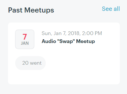

Ah, my mistake, I thought it'd be this one:

Ah, sorry, I misunderstood. Yeah, some diffusers might help in there. Do you have some foam ones made already? I have some ~6ft tall wooden ones made, but they wouldn't be too fun to carry up from the basement.
There are barrels sitting around in the meeting room and nicknacks sitting on a shelf that help some. There are big windows though, and some large expanses of paneling (though mostly pretty high up, would be hard to get something in front of). A surprisingly good room for what it is, though. And the hard walls help to give speakers with directivity an advantage over ones that don't have any. 🙂
