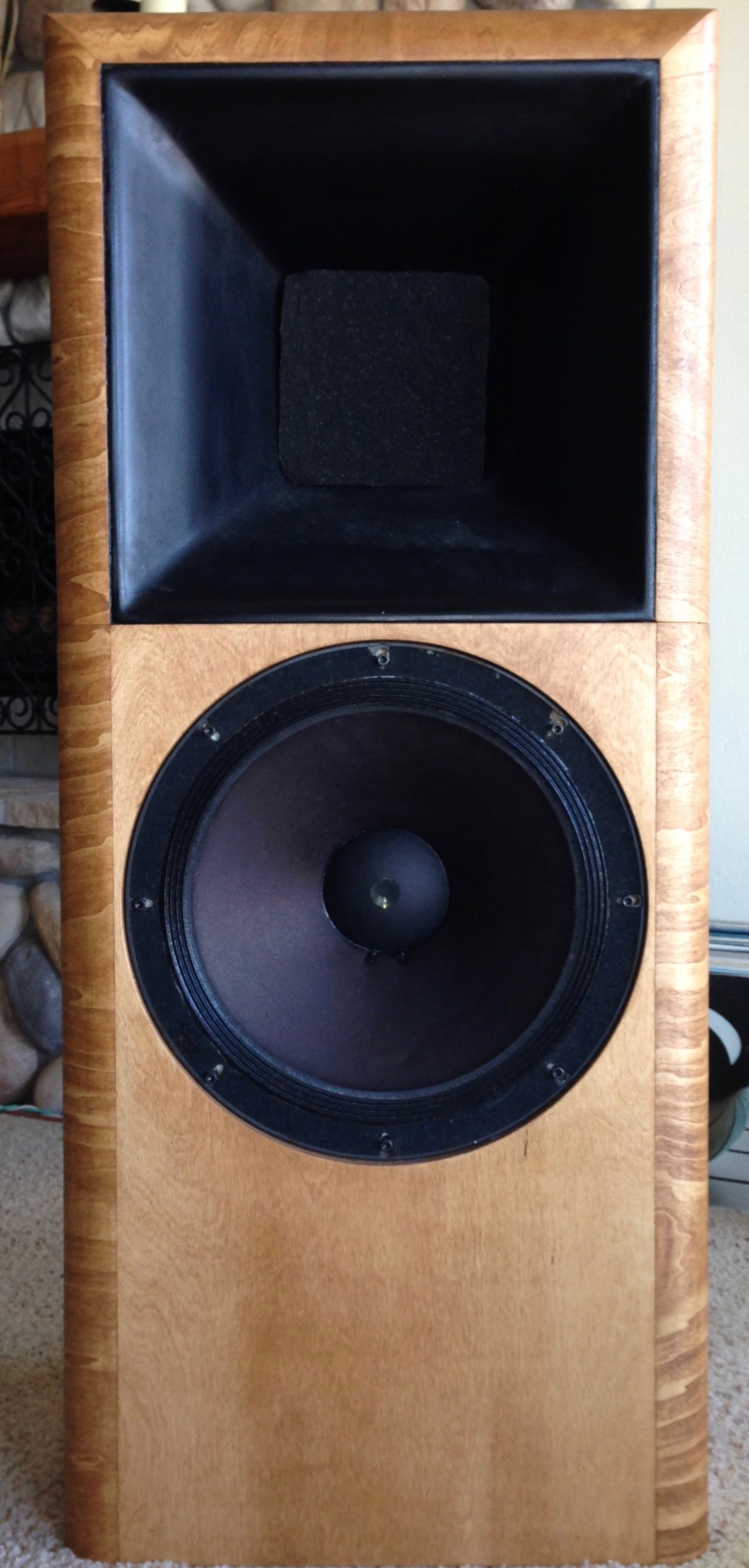

3D printed 3-way Unity waveguide home audio speaker
I was asked about what the printer cost and where it came from. I used one of these:

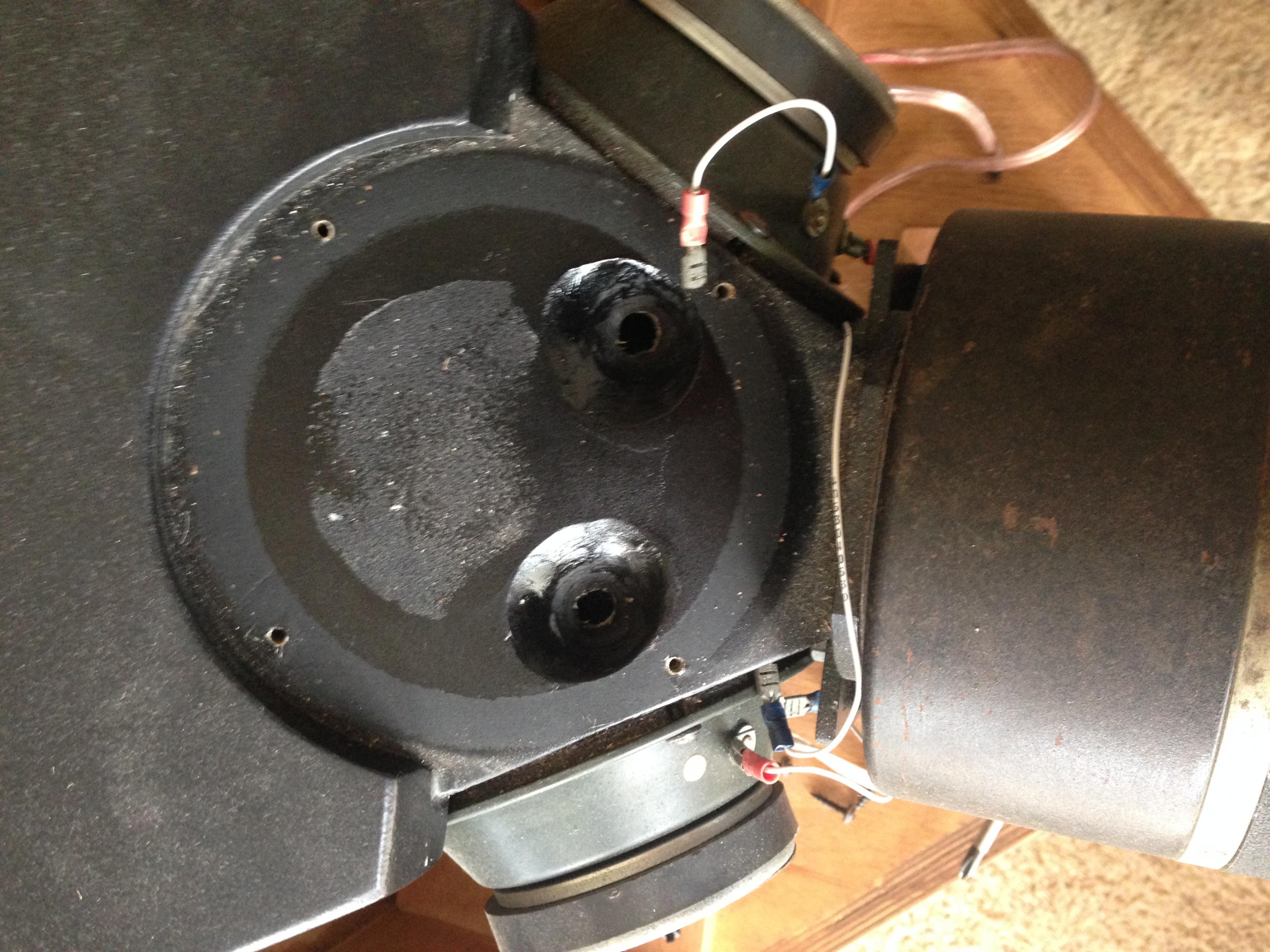

Somewhat off topic, or perhaps threadjacking (I apologize in advance, if so):
I have a pair of the original Danley Unity horns. I'd done a little testing on reducing the volume (partially filling it) under the 5" mids. It seemed to smooth out the response. Anyone here willing to put their printer to a little commercial use? I can supply a simple drawing with dimensions. I'd need 8 pieces.

Hey Sheldon, I have two printers and a box full of the Misco mids that you use. I'm insanely busy at work lately but I can probably get something printed by Thanksgiving or so.
What I'd need is a photo of the existing mounting plate. I can figure out the rest because I already have mids here at the house.
And, obviously, it's easier to collaborate because you live 15 minutes away from me 🙂
I'd love for someone like Autotech to pick up the design and make them under license as I'm not interested in printing them myself (no resources).
In the meantime I might just make some of your SEOS15 based units. I've enjoyed reading the threads though.
I'm in no rush John.

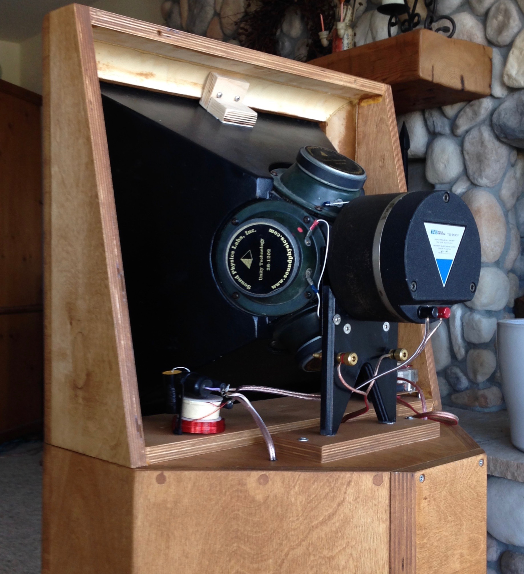

The existing mount is like this: first pics of the new speaks
Here's a sketch. My holes are more round than those in the picture, but if a little more plastic was left, then the transitions could be hand shaped with a file:
BTW, great work Bill and others who have really pushed this concept along. Were I to start today, I'd just copy Bill's latest. It seems an ideal compromise for home use.

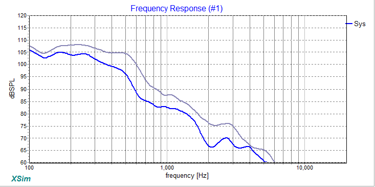

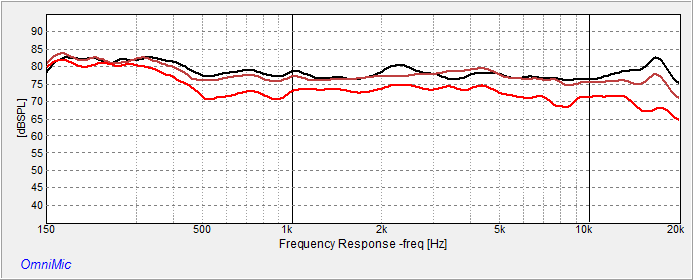

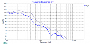

I was thinking about the measurements yesterday and got to wondering why the "spaced woofer" trick doesn't seem to be helping as much on this speaker as on the SmallSyns. This morning I looked again at some measurements used for designing the crossover and overall directivity plots. The off-axis dips a little more than I'd like at 550 to 700Hz and isn't doing much by 350Hz.
attachment.php
The raw woofer curves show the response at 45 degrees dropping starting around 500Hz, but good on-axis to near 600Hz so the woofer trick is working a bit too high in frequency. (Edit: these curves are with woofer crossover, but you get the idea....)
attachment.php
Edit again: Got myself confused here... it looks like the woofer ports should move **outward** a few inches, not inward, and then the mid crossover should be moved down about 25%.... I think. That would put the ports on the edge of the horn. Maybe vertical slits on the cabinet (or in those angled sides) for the woofers?
I probably need to just leave this thing alone!

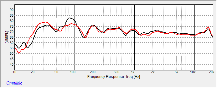

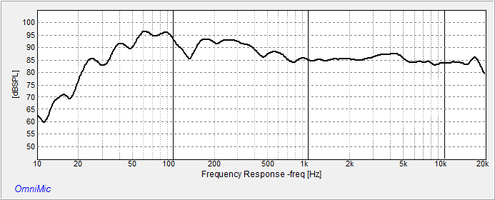

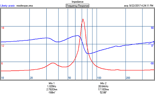

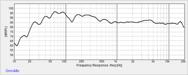

I was checking and comparing the response of the two speakers at the listening position today (I tweaked the midrange down a few dB on one so they match well). Again, noticing the LF response I'm getting in room with these things (and no subs or EQ).
attachment.php
It looks like the in-room F3 is in the mid to low 20's. I'd like to say that this is due to good planning and excellent engineering, but its not, it's a surprise to me. It happens in both channels (R more than L). The odd thing is that this is a ported cabinet, there isn't supposed to be much output very far below the cabinet resonance, which is at about 45Hz. T/S simulation says the box f3 should be around 37Hz.
attachment.php
The cabinets are about 6 inches from the wall (which is designed for), which of course picks the low end up, but this much? One unusual thing is that the woofers close output (just inside the horn mouth) happens through smaller areas than the cross-sectional area of the shelf ports. I did simulations earlier and didn't see any magic happening because of it. And measurement at closer to 1m distance shows the LF about where it was expected.
attachment.php
So it's the room, I'm just surprised it works out this well. The L channel has a room peak at about 85Hz that I should maybe EQ out and both channels have the usual suckout from floor bounce at about 145Hz (which I'll just leave alone). But almost a free lower octave?
