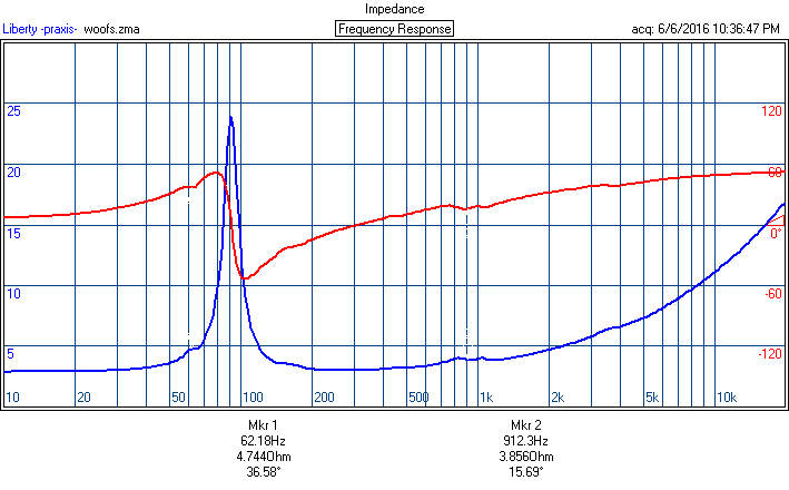

I was reviewing your Small Syns design and noticed it’s impedance is much more flat than the printed horn crossover, despite using the same mid drivers. Is this due to the difference in woofer placement?
Yes, the Solen inductors are big. My preference for aircore inductors is one of those audiophool biases I’ve found hardest to shake.
No, air core is definitely preferable if the series resistance is kept down, and if you can afford it (and have a place to put it). Just that the inductor sounds like you could sell it for its copper weight and buy entire speakers from that 🙂
placement shouldn't make much difference. I sometimes add a flattening network (resistor and capacitor) across the crossovers to flatten impedances at higher frequencies (in case someone decides to use them with a tube amp at some point). Not sure which curves you're looking at or which crossover components were involved though. The Small Syns crossover is different from the printed horn crossover (which uses two midranges instead of one)
I wasn’t reading closely enough, it wasn’t the system impedance I saw, but the impedance of the FaitalPROs alone in the enclosure
