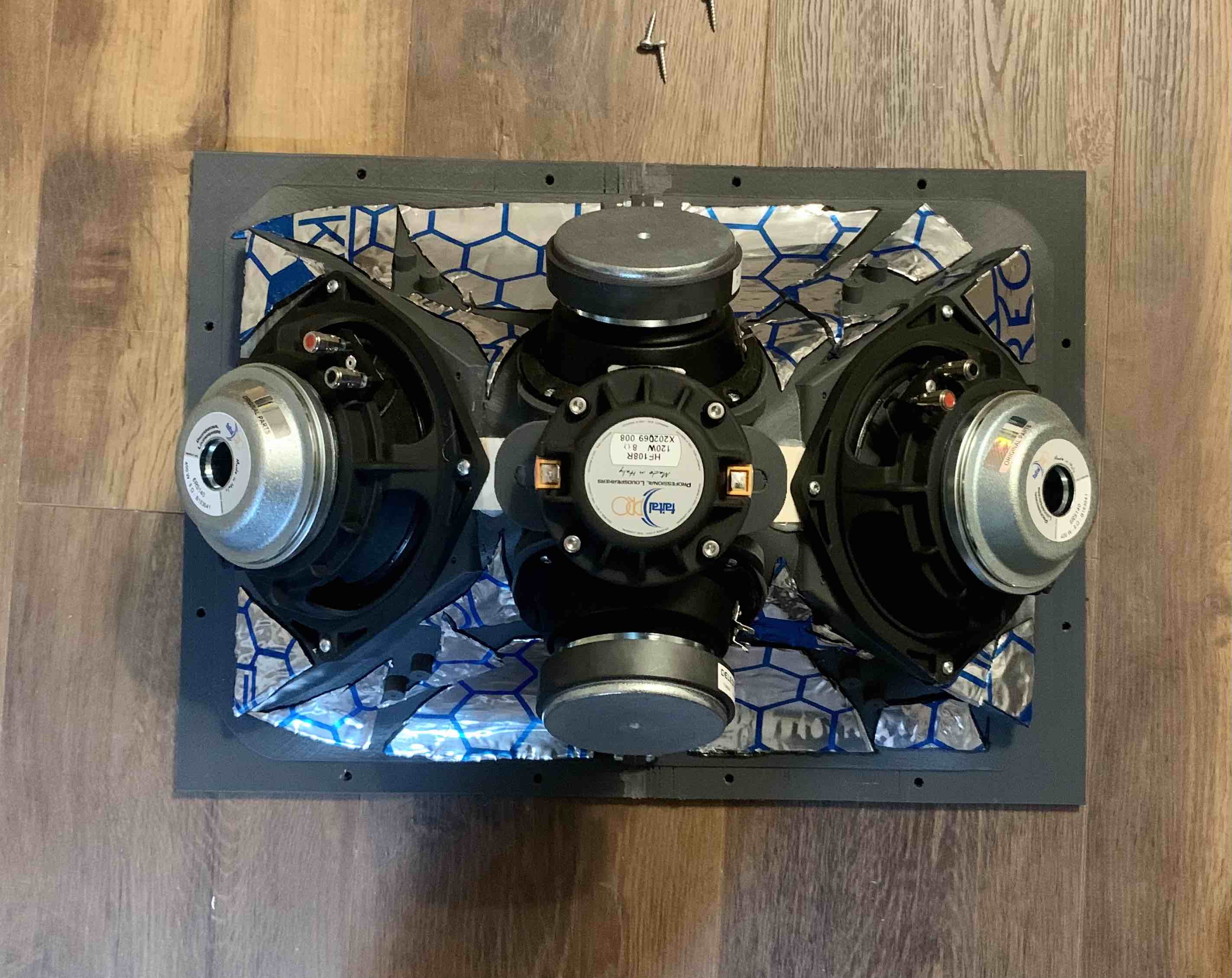

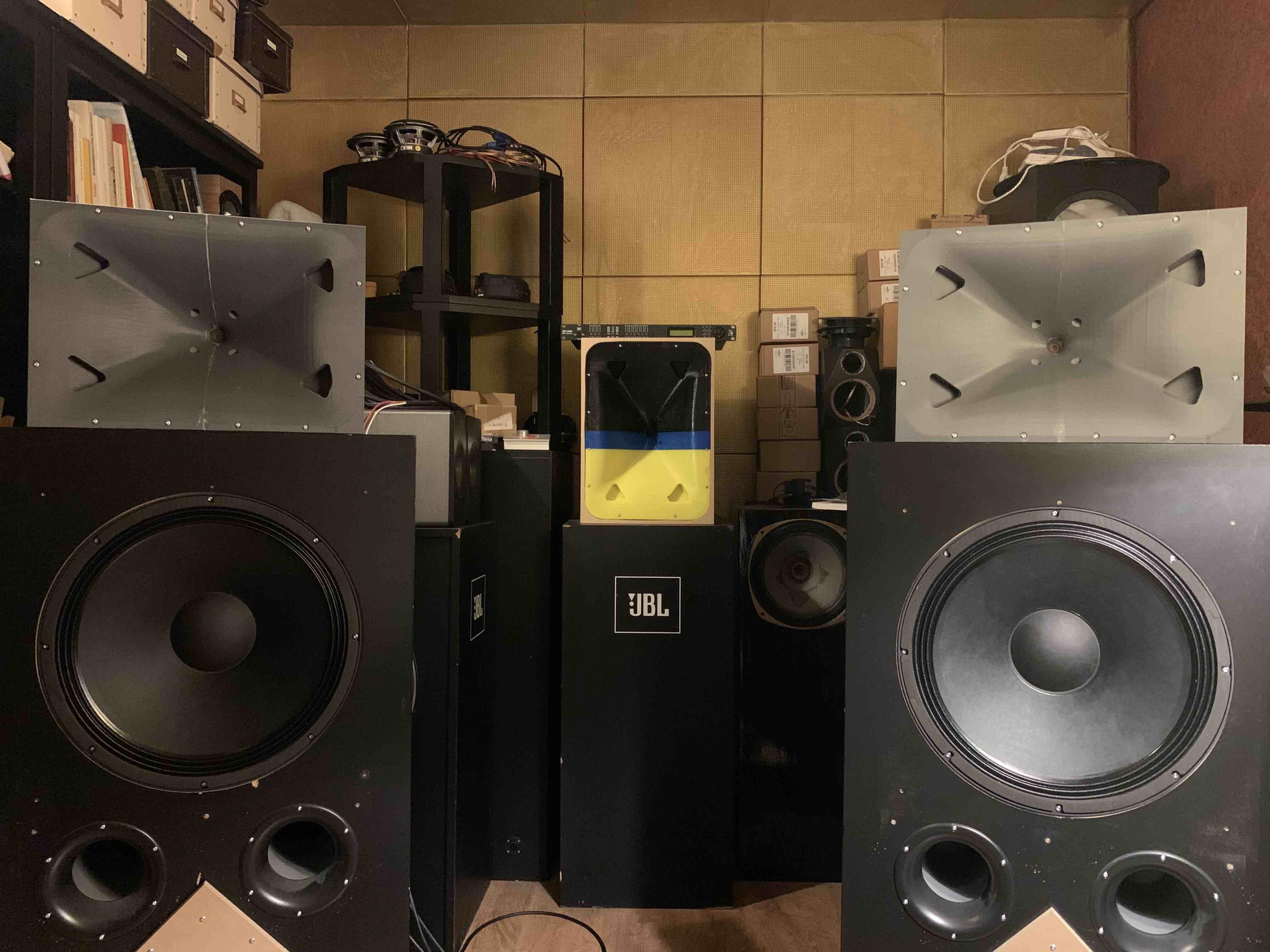

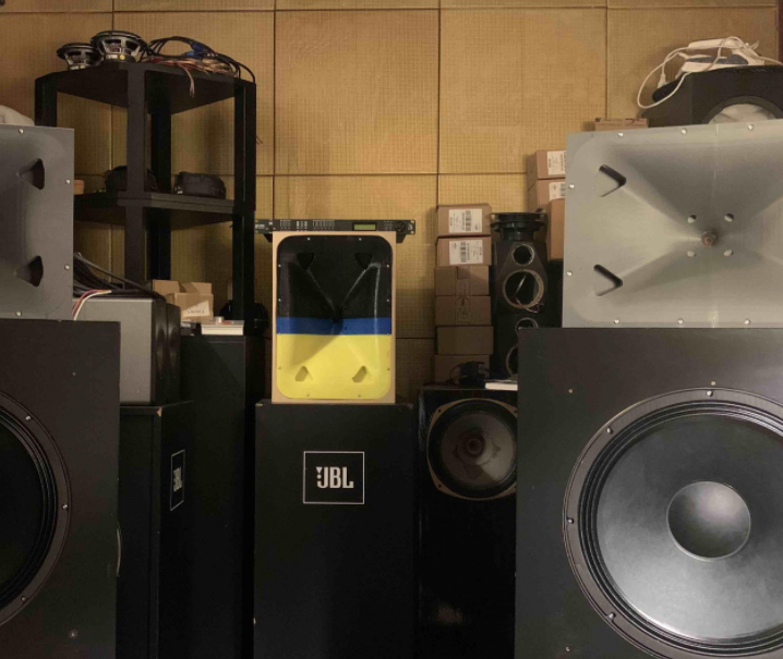

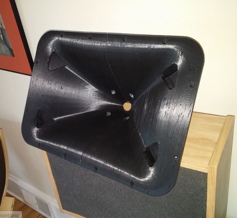

Slowly there’s progress. I finally have two prototypes for stereo listening and they sound VERY promising. The phantom mid, the way they chisel the singer in the middle is uncanny. That’s why I’m posting the picture, everybody stopping by was convinced that the black / yellow / blue speaker in the middle was on (which of course it isn’t). Also the way one can hear for example reverb tails and other micro details is really really good. The crossover is still just on axis measurements -> REW auto eq -> LR filters. So there’s a lot to improve.

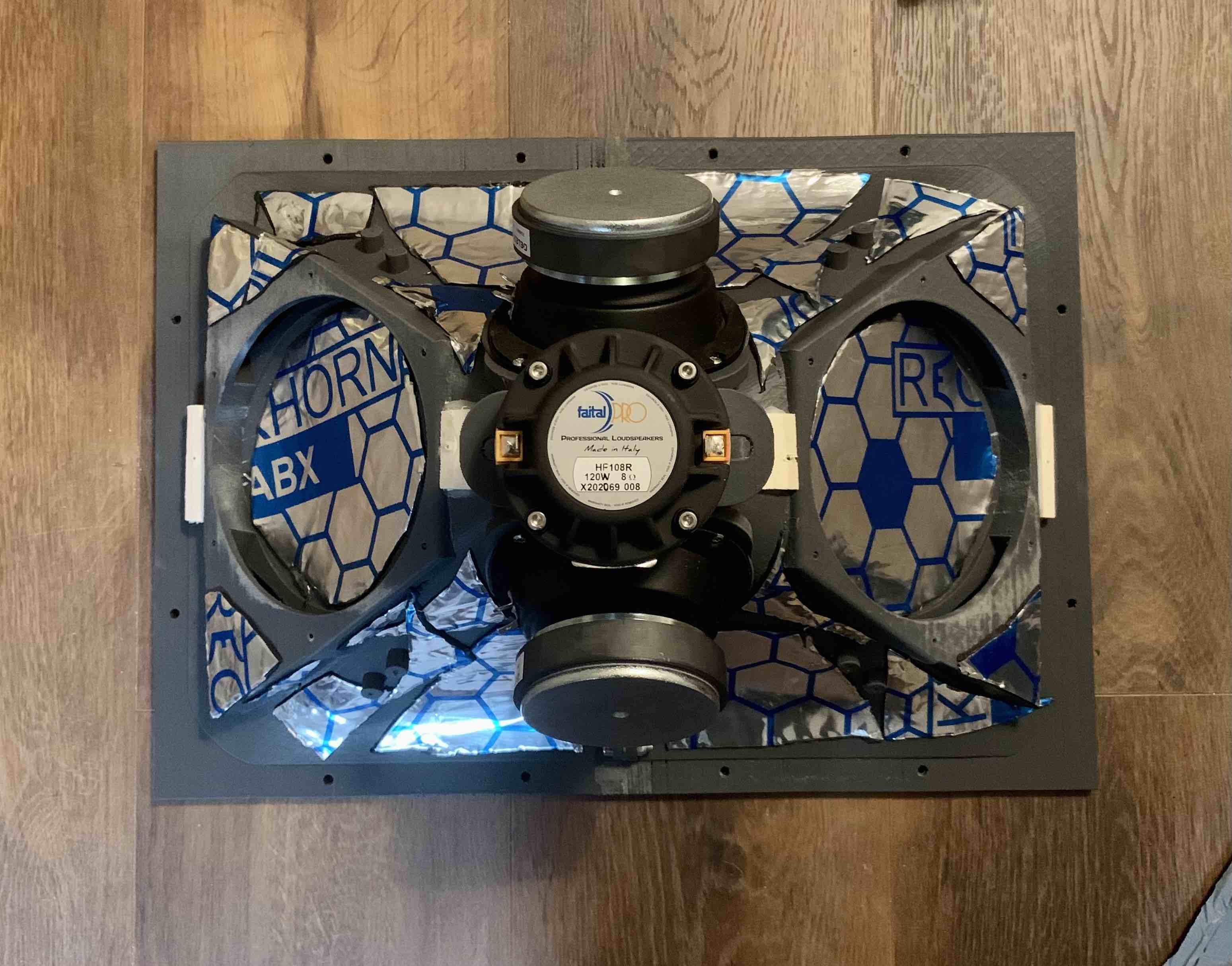

And there were a few issues to overcome. The biggest one is the vibrating of the waveguide itself. Without any treatment the colouring in the lower mids is really strong. With two layers of bitumen & aluminum it’s ok, but I’m not sure more than two layers in the front chamber of the woofers is a good idea so I kept it at two. I hope the epoxy coating that is planned in the future will help even more with rigidity. Also the small enclosure had to be modified for the woofers to even fit (bad planning). In case of the 6RS140 the basket and in case of the 6FE100 the magnet sticks out 'into the wall', in both cases I had to file / sand / route off some of the enclosure. I used 18mm baltic ply, but even with 15mm the basket / magnet would be too big. The pieces of wood for the 4-hole driver to screw into are glued with epoxy and that works really well.
As to drivers, which the damping in place the difference between the 6FE100 and the 6RS140 becomes quite obvious, unfortunately not in favour of the 6FE100. I’ve also tried different compression drivers and for now am sticking with the Faital HF108R. The Celestial 1730 sounds as it always does for me, very detailed, open and sparkly, but ultimately fatiguing. The ‘cheap’ Peerless that gets recommended some times just sounds terrible, basically broken to my ears, maybe that’s what it was (brand new though). The BMS 4538 sounds fantastic and with all the benefits one would expect from a small driver, but I don’t really trust it at 1300Hz even with a 4th order high pass. But I’ll spend more time with it, would be great if it works.

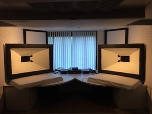

I skipped the basses because the horizontal polar pattern collapses anyway at around 700 hz in that waveguide. So I'm experimenting with a larger separate horn/waveguide with constant directivity down 200 hz for the bass, to sit below the 3d printet horn. You will not get the point source feeling all the way down, with that solution, but I think the controlled directivity is more important. And in the end I'll use DRC Designer to give me a nice step response, so the timing between the horns will be correct.

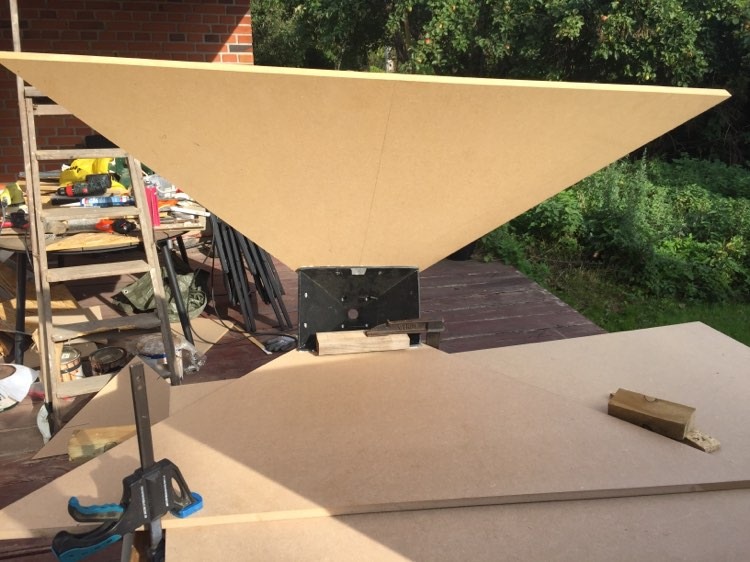

In my other all out Behemoth synergy horn, i used Bill Waslo's other 3d design (thanks for that 🙂) for the start of the horn and extended the sides with mdf boards, so it measured 140 x 90 cm. It has directivity down to 100 hz and uses the same drivers as the smaller horn, but with a 15" pa bass added.

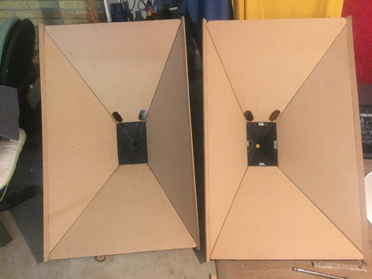

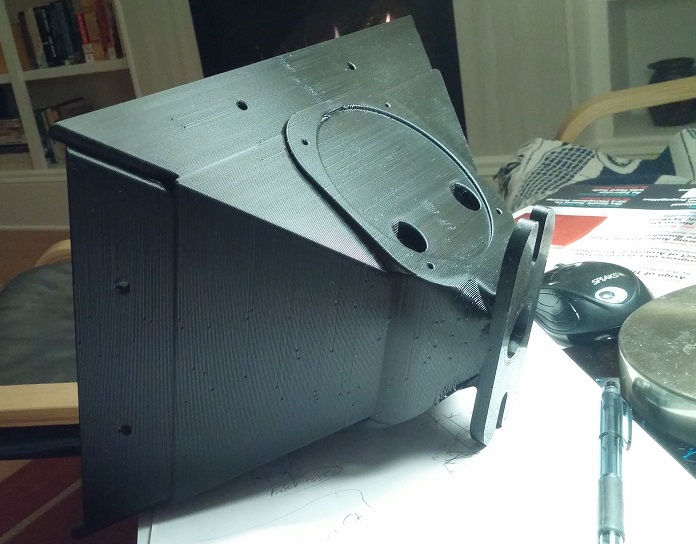

Here is the 3d start of the horn, it looks quite similar to the waveguide in this thread, but without the round over at the mouth.
The idea is that you can extent the horn as much as you want.
work in progress
Oh, this is amazing! I had the same (obviously not very original) idea, but utterly failed at altering the STL I used into something like this. It looks like the throat goes straight to conical without any transition, but then the pictures are quite small and my eyes might be fooling me. But if you could send the STL my way, I'd be very happy.
Regardless of the size of the horn, this would certainly lead to a more sturdy version than printing the entire thing.

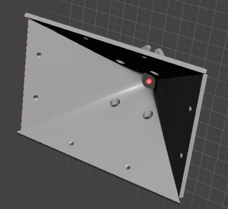

Then you probably don't like most unity/synergy horns, as most of them seem to be more or less conical. All Danley's horn are conical, with af little mouth transition. Also the 3d horn in this thread goes almost conical after the throat OS transition, it actually looks a lot like SEOS horn. Where the walls meet they are rounded.
The horn stub is straight conical after the OS mouth transition. Wallmeetings in the start of the horn is slightly rounded, after there is a hard angle. For all it's worth🙂
