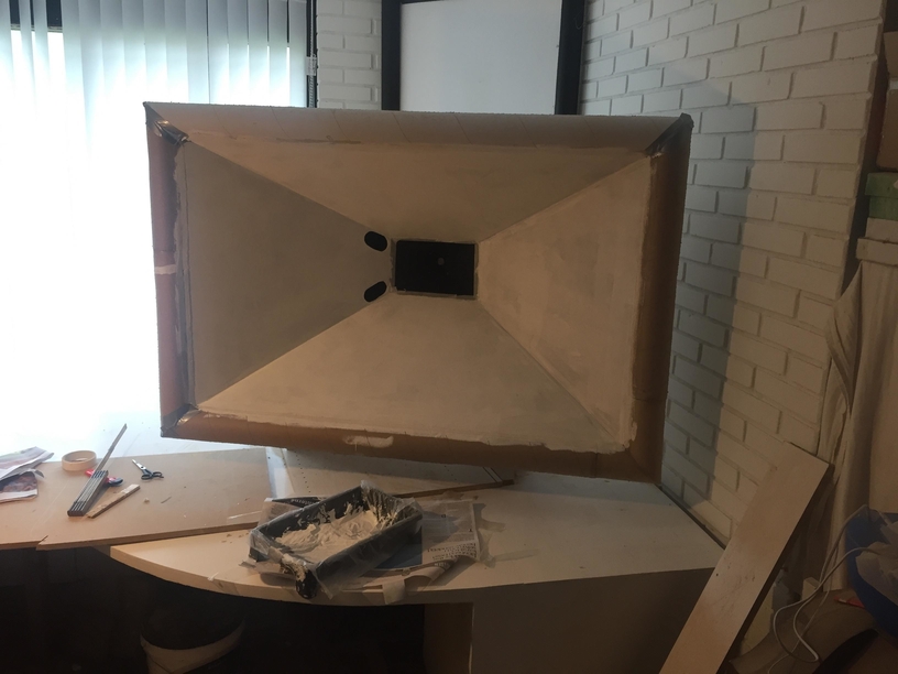

I did the round over at the Behemoth mouth with 4" cardboard tubes, cut in halves.

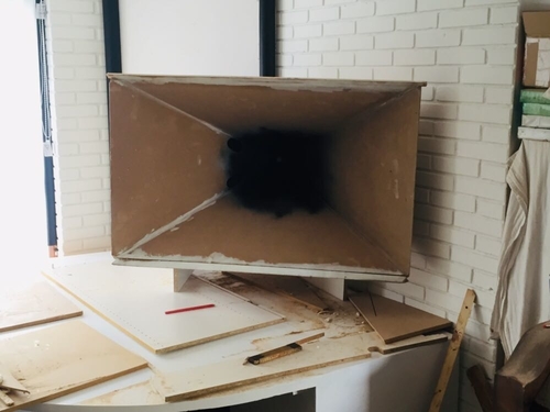

I've added secondary flares to several primary conical horns, tried roundovers (none as big as the 4" tubes however), and am thinking about trying some felt around the mouth ala Charlie Hughes.
One set of secondary flares was curved glassed foamboard attempting to mimic the K402 flares. here's a pict of a few of the builds
On anything i've built, whatever the H/V pattern, adding secondary flares has helped polars some, particularly in the 1-2 khz range.

I've also played with throat matching as best as possible, and flat leaving the mismatch alone. Can't hear a difference.
I think I'd just say I'm a bit deaf maybe, but I can't measure any difference I'd judge significant, either.
