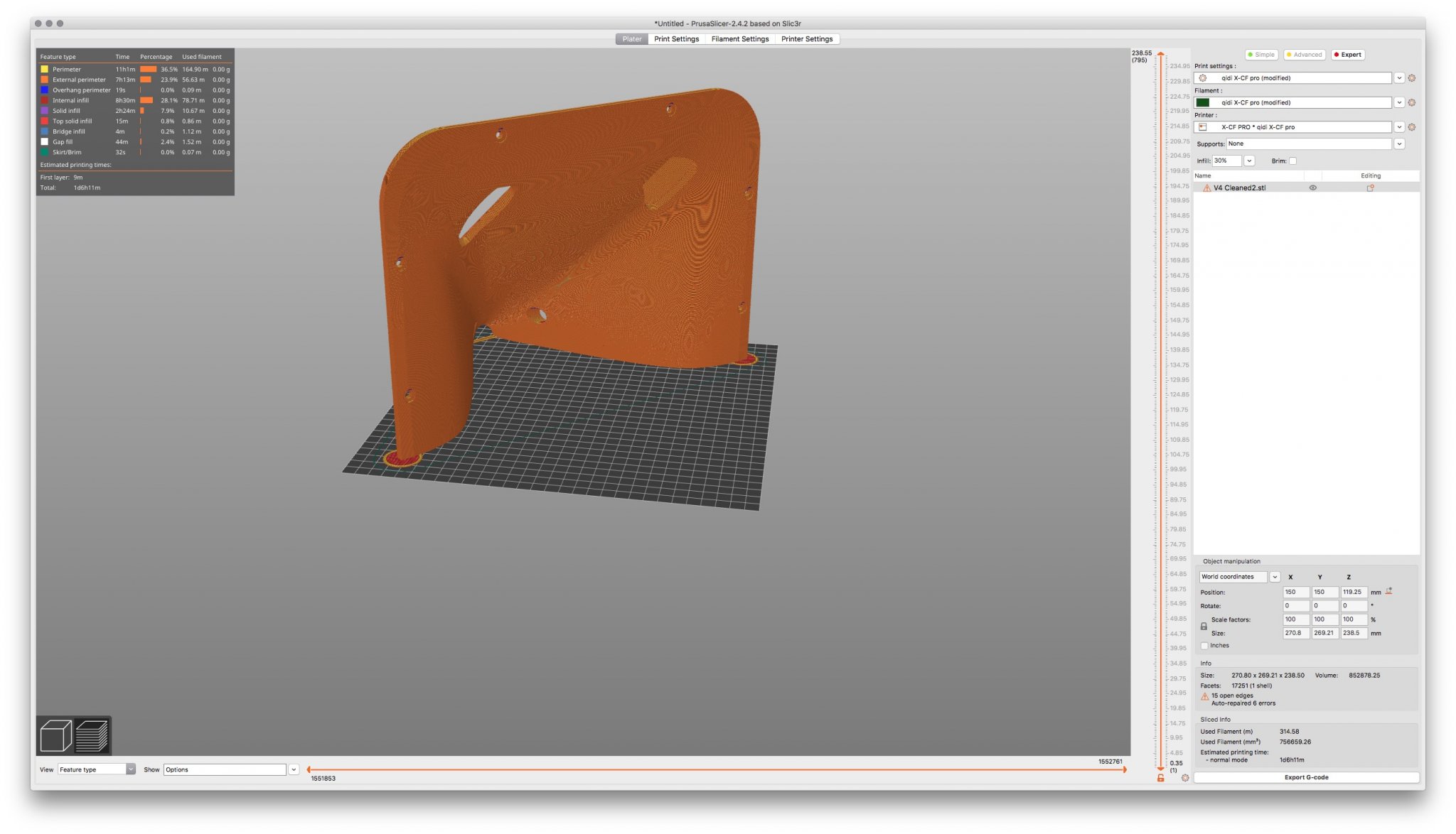

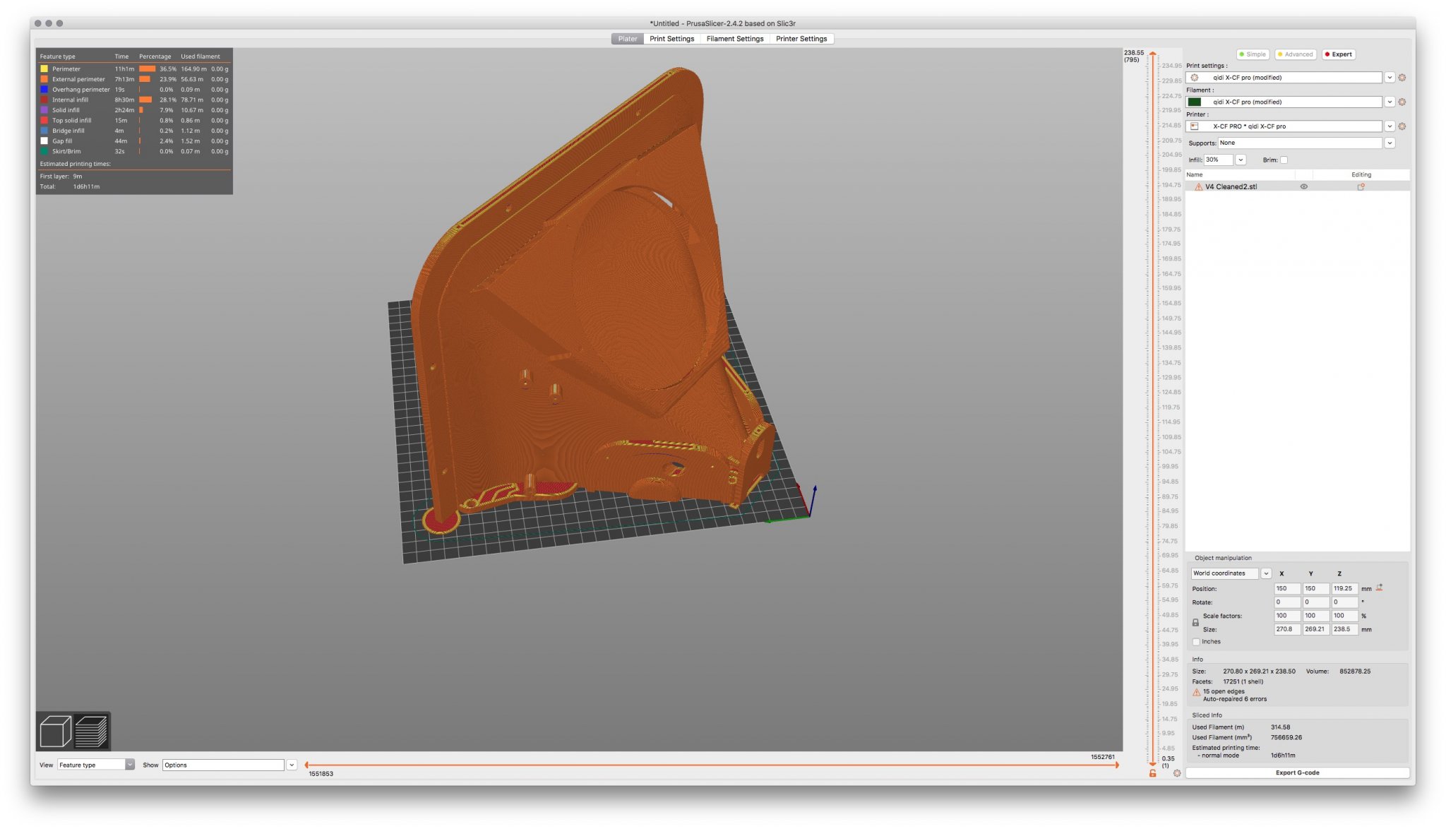

Also, pretty happy about this bit of luck. it fits my build volume perfectly!! JUST! not final print settings, just playing with it at the moment. I use Cura too, but trying to set up a profile for my printer in Prusa. If the estimate of just over a day each is correct, I an live with that. 0.6mm nozzle.

Your asking for trouble printing the halves like that.
Basically if you get even a slight amount of shrinkage, the two parts wont fit cleanly together.
If possible, I'd consider rotating it 180 degrees so that the part with the seam isn't on the print bed.
A lot will depend on your printer and filament choice.
