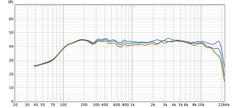

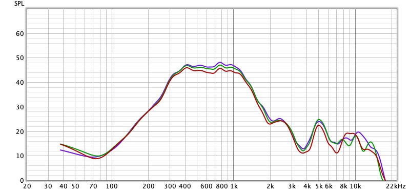

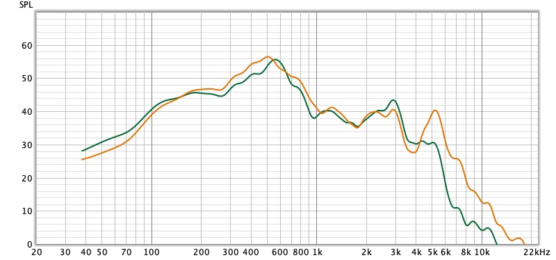

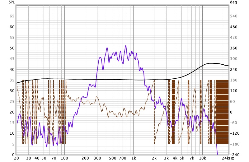

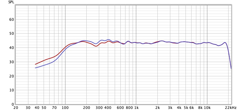

I finally got around to tinkering with this as well. Everything was done super quick and dirty, I mostly wanted to see if other woofers would work as well. The measurement angles are only approximate with a protractor held to the box, so nothing to take too serious. The crossover is done with a first gen low end minDSP through an ancient Denon multichannel receiver and just a couple of standard filters, no adjusting or refining whatsoever. The drivers are Faital 6FE100 and 6RS140 respectively, Celestion TF0410MR and Faital 108R.
The measurements are
1) the whole speaker 6FE100 vs 6RS140 on axis with ERB smoothing
2) the whole speaker with 6RS140 at 0, 15 and 30 degrees ERB
3) the mids alone with 1/24 smoothing on axis
4) the mids a 0, 15 and 30 degrees ERB
5) 6FE100 vs 6RS140 raw on axis ERB
It seems to me the 6RS140 works just as well and is simply the better driver (not judging any sound quality differences) plus (important for me) happy with a much smaller box.

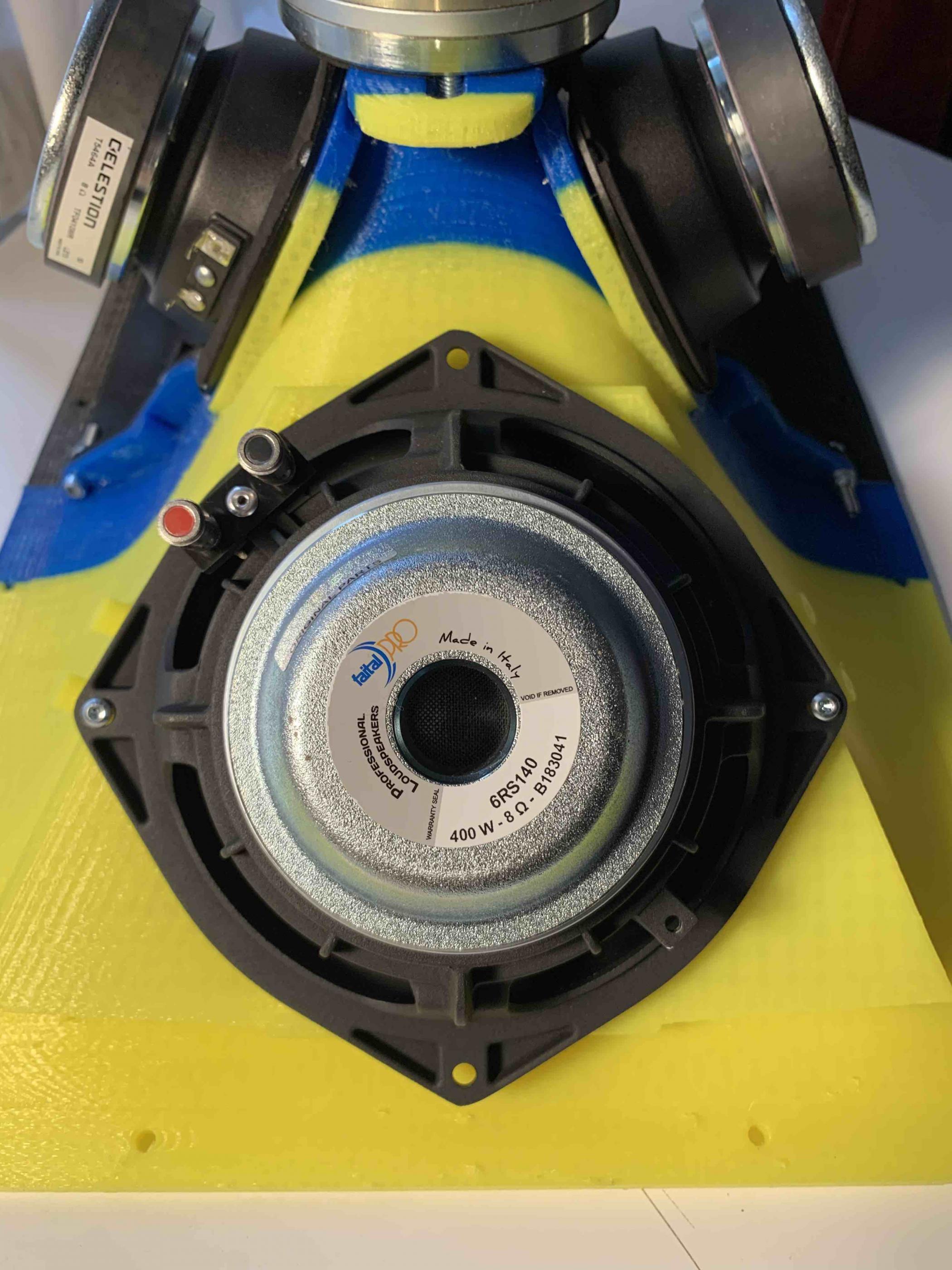

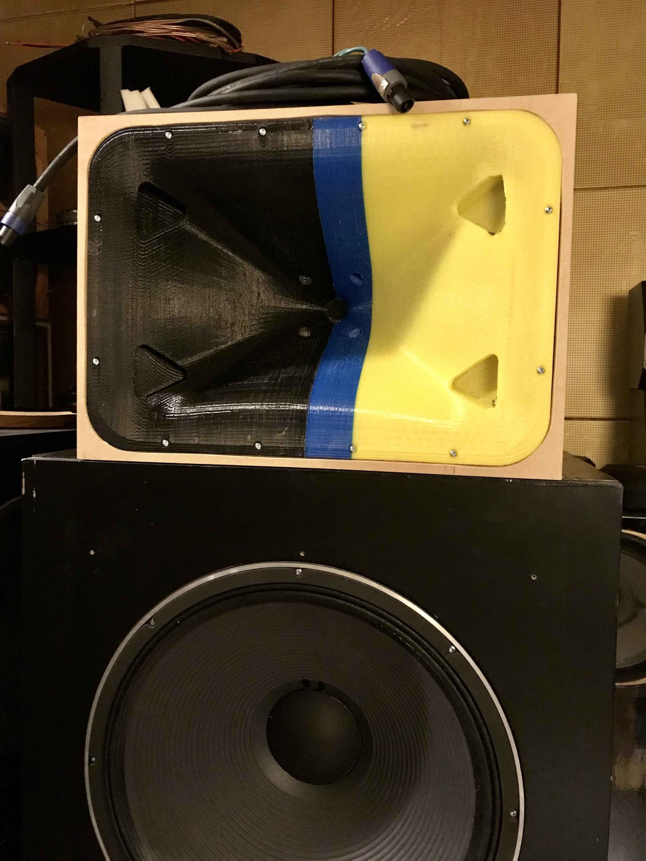

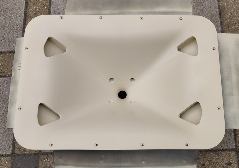

This is what the thing with its 40 liter box looks like. The 18-inch cabs are only used as stands, but ultimately that's my goal with this. Closed box on top of a big woofer. As a full speaker the 6FE100 appears to have more bass and is easier to tune BR, but does need a bigger box.
Regarding the 6RS140 the waveguide design should really be changed though. As it is now, the woofers are only held by two screws. Fine for testing but not for the actual speaker. Being completely ignorant when it comes to dealing with STL files, I have so far failed at editing the STL to add a bit of material on the back of the waveguide to add two more screws. I tried TinkerCAD, is there better software for this? I imagine this to be trivial and I'm just not getting it. This modification would then allow pretty much any 6-inch woofer to be used as the 6RS140 uses the standard hole radius.
Best and free for manipulating STLs is IMHO Blender. Very steep learning curve though. I used it once to change certain area thickness of a complicated STL file. The advantage is that you can manipulate the mesh directly. Importing to CAD is very problematic, I also did some basic changes in Fusion360, but it was painful. I cannot offer any more advice on how to do this as I have not explored Blender further yet.
You could create an add in piece and glue it to the exiting waveguide. As said before altering STL's is a total pain.
Fusion has a new mesh workspace that allows you to do more than before. You could plane cut the waveguide model in sections around where the joins need to be and convert those sections into solid triangulated surfaces with the Convert mesh command. This is prone to crashing if the model has a lot of triangles. The files could be cut in meshmixer too but the plane cut tool is a little harder to get right for me.
You can then create sketches by drawing lines or curves using the points from the model as references or you can create a larger block for the mount and cut or intersect the body with the converted surface.
Some images and explanation from a prior version of Fusion here might help where I cut a block with a whole waveguide STL
3D Modeling Tips and Tricks
Thanks guys, this does sound like an uphill battle though, I'm having a hard time even following the nomenclature. I think I'm better off glueing pieces of wood to the waveguide. Will take some time and filing etc, but should ultimately be stronger as well (they can be screwed on from the front with counter sunk screws too since the front of the waveguide will ultimately be covered with epoxy).
