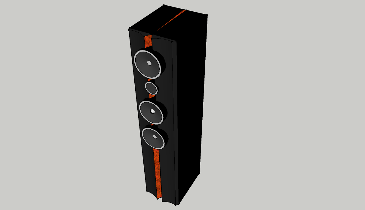

That's not a bad idea! My main concern is if the amp I am proposing is going to be enough for the design I have shown.
I also wonder if I couldn't recreat the sunflowers with one size larger drivers......6" woofers and 10" subs....or is that just a little on the silly side. I understand it's a proven design, I'm just trying to make something unique to myself.

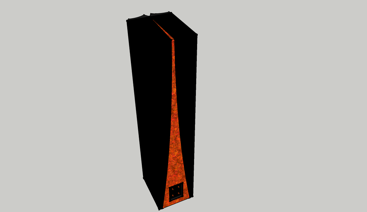

In the meantime I might start on these. This is a very rough draft, It's to get a general idea of the finished product....I'll put full details in the multiway section

i wasn't really looking for any info on the speakers....just wanted to show what I was up to in the meantime
