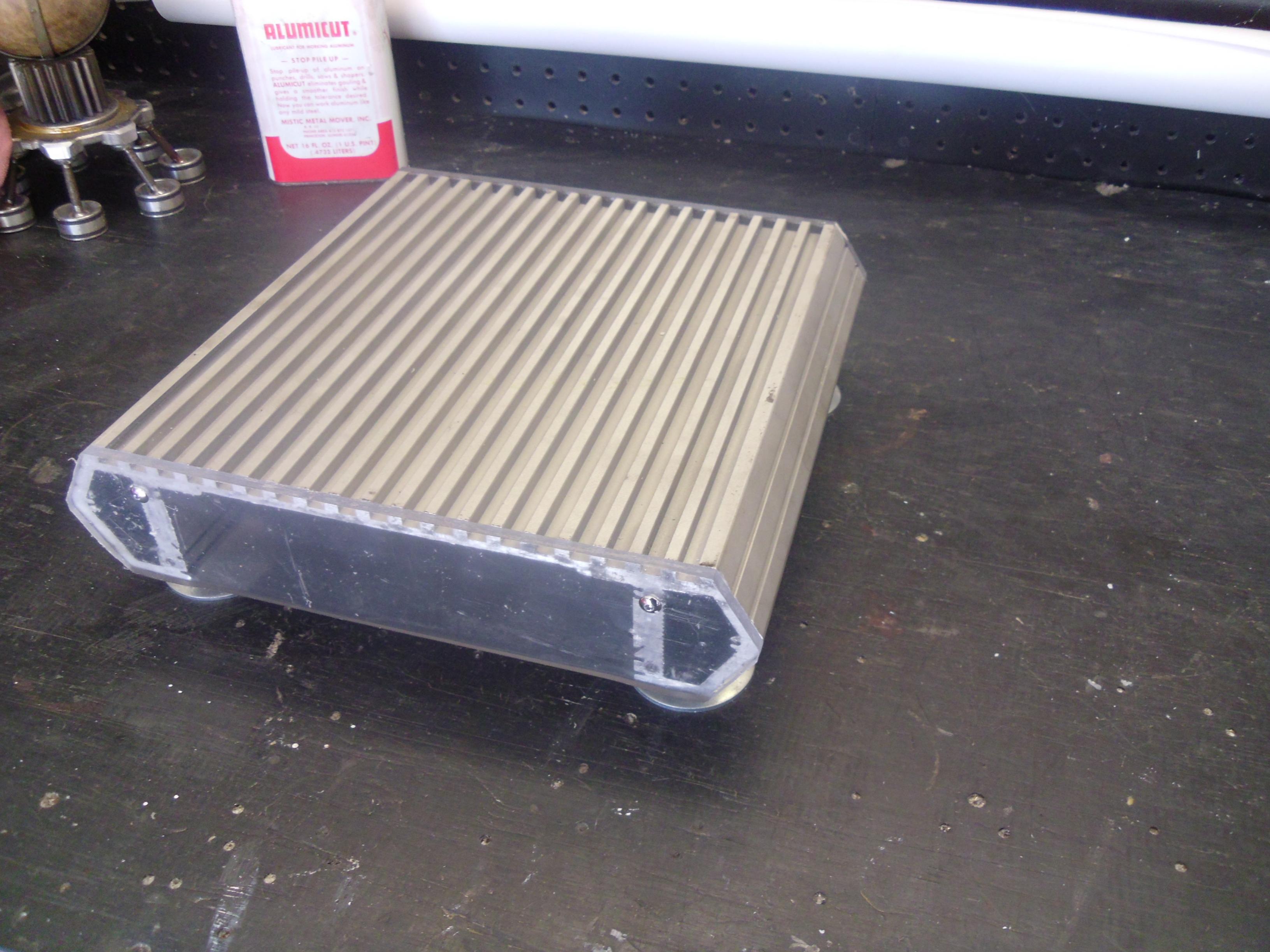

one piece bent acrylic won't work the bends aren't tightly folded.
going back to a 4 piece setup.....delay,delay,delay

I decided to stick with what I have now..... I was told to finish this project before I move on to the surround speakers so I'll just use what I have and "upgrade" my transformer later 😛

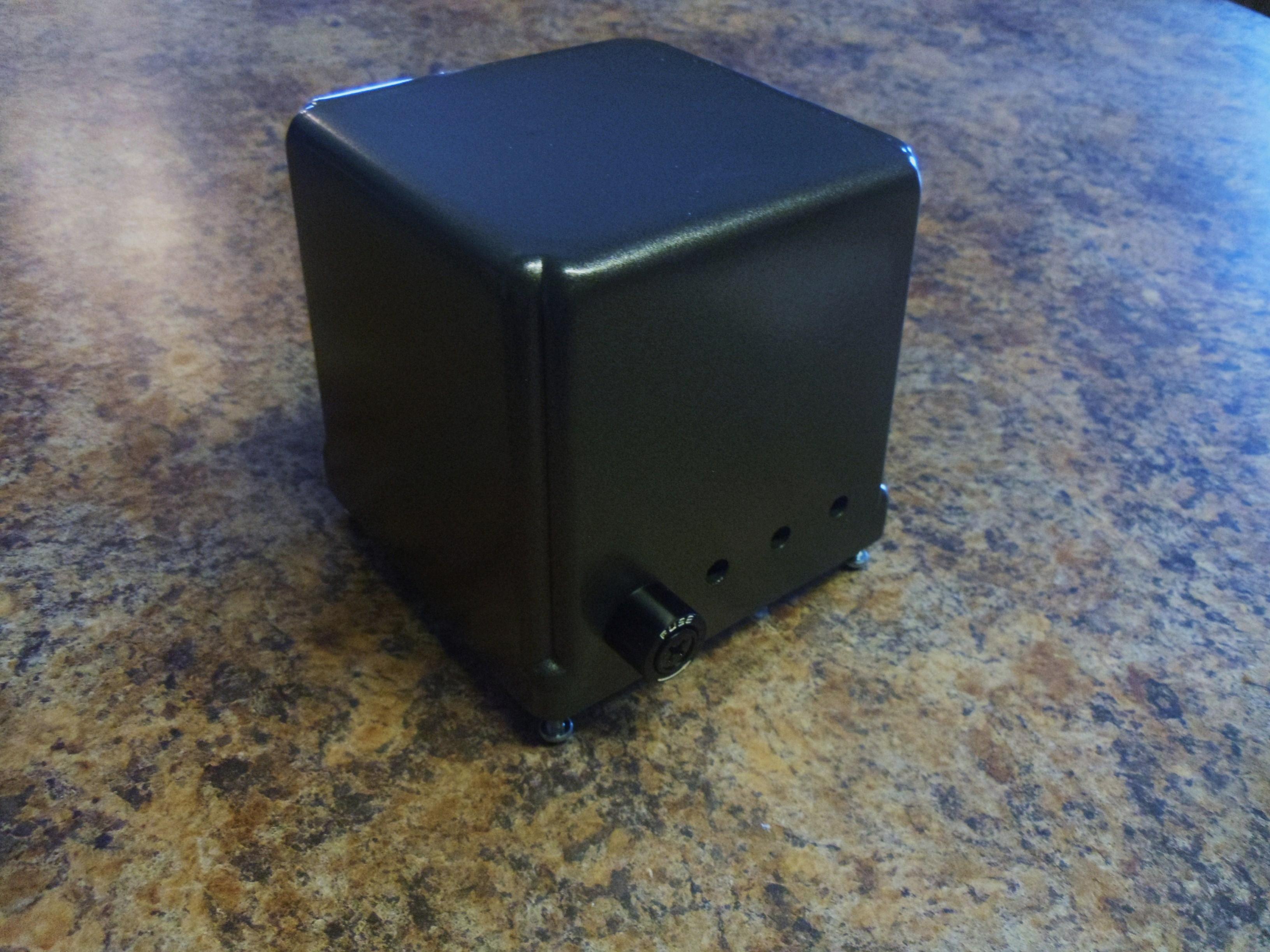

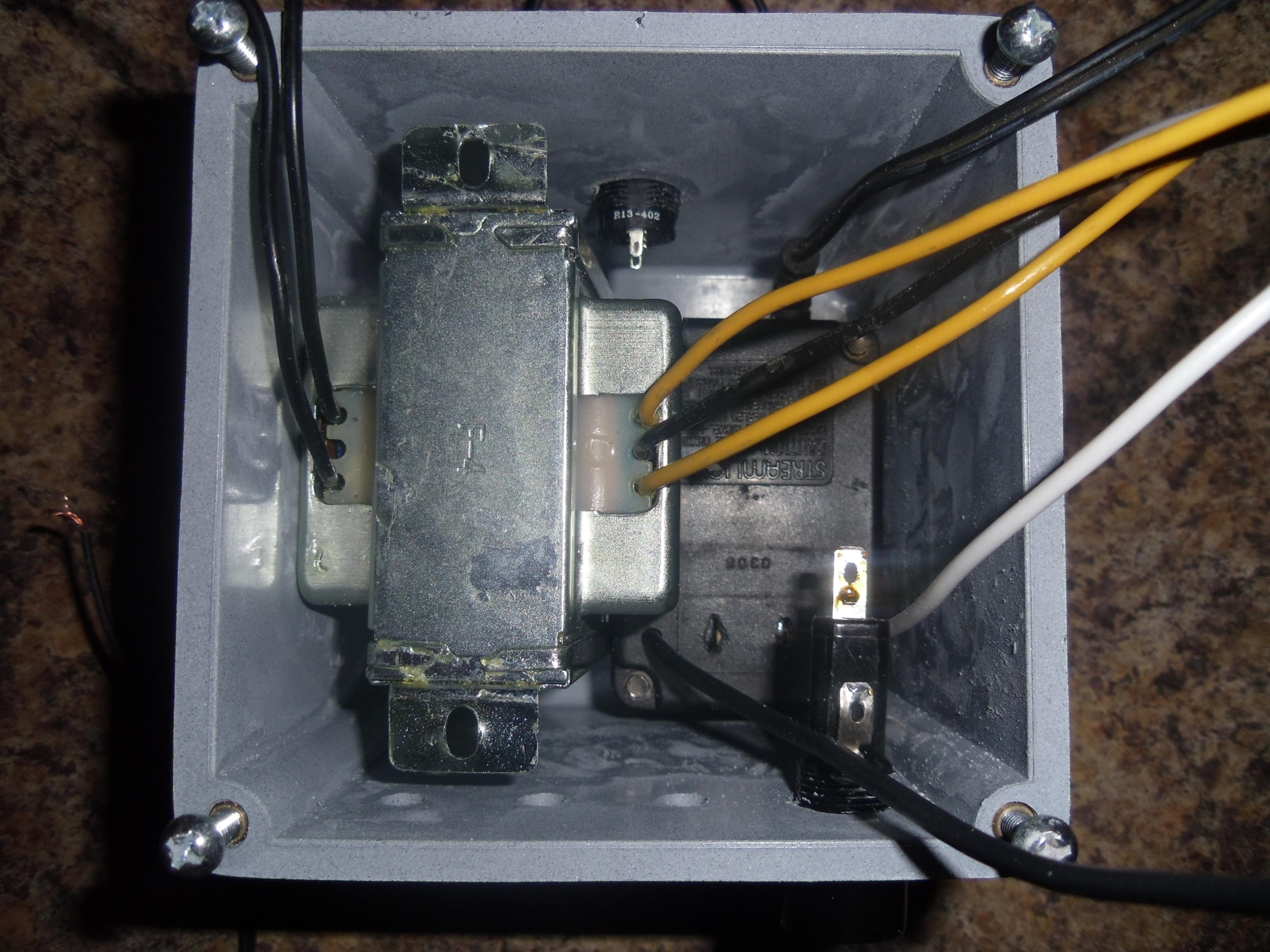

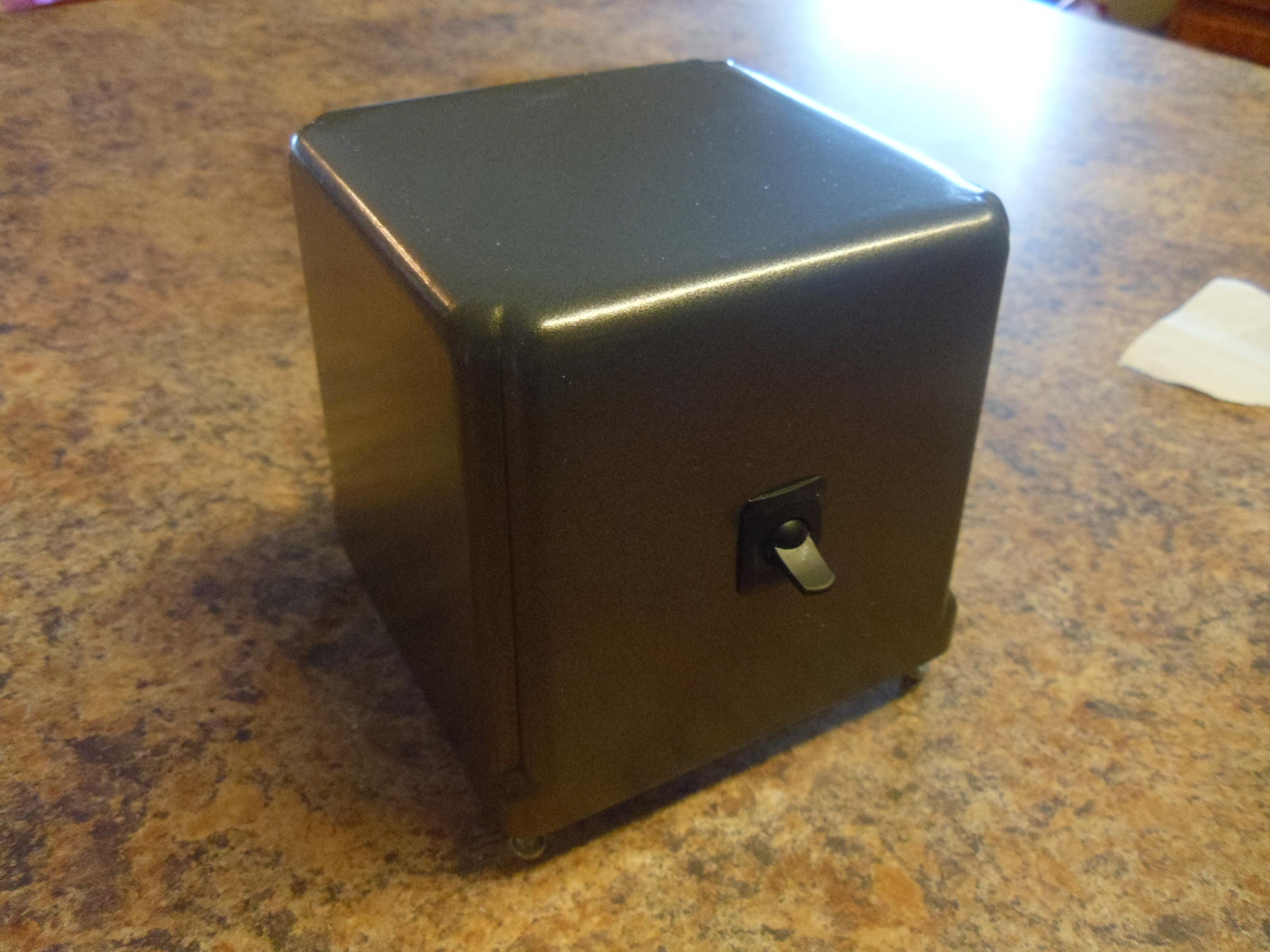

I believe I have come up with a rather unique idea for the housing. It's a 4x4x4 plastic box found in the wire isle of my local Home Depot. All of $8.00. I dug through my box of goodies and found a wall wart, cut the prongs off and soldered on a set of wire leads. It's hot glued to the the top inside of the box while the main trans. is going to be bolted to the bottom lid. Don't worry, even though it doesn't look like it, there is plenty of room around everything to be properly insulated from each other. Oh yeah...... the wall wart is going to power up the LED's in each case.....

I hate to be less than enthusiastic but I see a few problems or issues.
1) Wall wart does what? Just for LEDs? No need, they will be fine running off main amp power rail with a resistor in series limiting current. Constant current LEDs (via resistor instead of a regulating switching driver circuit) won't even add any noise to the power rail like a fan or other active electronics could. If as I mentioned below you're putting the PSU board in a separate (amp) case, you could just use a single diode and resistor for the LED in the transformer case. It'd have a little bit of 60Hz mains pulsing output (or doubled 120Hz if you used more diodes) but I doubt it'll be undesirable for a power indicator.
2) Where's the ventilation? I don't think the 3 small holes near the bottom (heat rises) are going to be sufficient, especially when using an arguably undersized transformer for the amp. Doubly so when the transformer is encased in metal itself so it runs even hotter, BUT it is possible they derated the current capability of the transformer a bit due to it being encased.
3) Hot glue + gravity + heat... think I'd find another way or as mentioned in #1, leave out the wall wart.
I'd be sure to measure temperature after powering the amp at reasonable volume for awhile. Even if it doesn't overheat a lot, large swings in temperature tend to wear out the transformer's embedded thermal fuse sooner.
Assuming you are going to put some kind of feet on the bottom so what it's sitting on doesn't block them, what I'd do is drill a bunch of vent holes into the bottom/lid of the box and a row of them on the back at the very top near the corner... and of course make sure anything inside is not blocking too many of those holes.
I'm a bit confused though, your power circuit for rectification and smoothing caps is going in the amp case or this case? Not that it necessarily matters but it does make the two boxes a bit less modular, thus most people would keep the power circuit board with the transformer.

Well the whole reason for the wall wart was to separate the LED's from the main trans. for "noise" issues. I plan on running quite a few LEDs in this project....up to 16. Maybe I'm being a little paranoid about it.
If that's the issue I'll remove the wall wart and put the PCB in the case with the main trans. The holes in the back are for the umbilical cords to power the main case. I haven't cut the heat vents yet. Man I'm glad I'm getting help with this!!

Things that don't create a magnetic field, or radiate RF, or switch power levels don't create noise. If you were using 3W LEDs and a *proper* LED switching driver circuit that'd create a little HF noise but resistor current limiting won't.
Too great a load causing power rail droop might be a factor in some situations but in this case assuming ~ 20mA LEDs, it's only 300mA. On second thought since the transformer is already undersized I think I'd run the LEDs off +/- power rails instead of only +/gnd which is what I'd do instead if the transformer were higher current.
One other factor which will matter later is if you set a current for the LEDs with this transformer then come back later and use a different transformer, you might have a current increase to the LEDs. For this reason I'd set the LED drive current for a safe range with a future transformer's anticipated voltage and let the LEDs be a bit dimmer with the present transformer.

Well, after rearranging everything and relocating the power supply board to the remote switch housing I have a TON of room in the main case. So much in fact I could add another channel for a subwoofer.

I'm not sure a plastic box can house a power amplifier or a power supply, as both dissipate heat and need proper sinking.
To do proper sinking you need another surface that will also dissipate the heat: a ribbed heatsink on the amplifer and a metal sheet on the transformer.
To work the box should have to be large and have ventilation holes, already there or made by you. Heatsinks should have to be warm to touch, or you will have to force ventilation with a fan.
Wall warts may be nice for preamplifiers, but they can't provide the current you will need on an amp. To do so they wouldn't hold on the wall.
Next thing: copper is not that good for dissipation. Aluminum is much better. A proper heatsink done with copper would be heavy and much more expensive.

well now that's got me wondering if I shouldn't add a fan to the rear panel on the main case to keep the acrylic from warping. Seriously considering adding another kit in the housing for a subwoofer channel.
