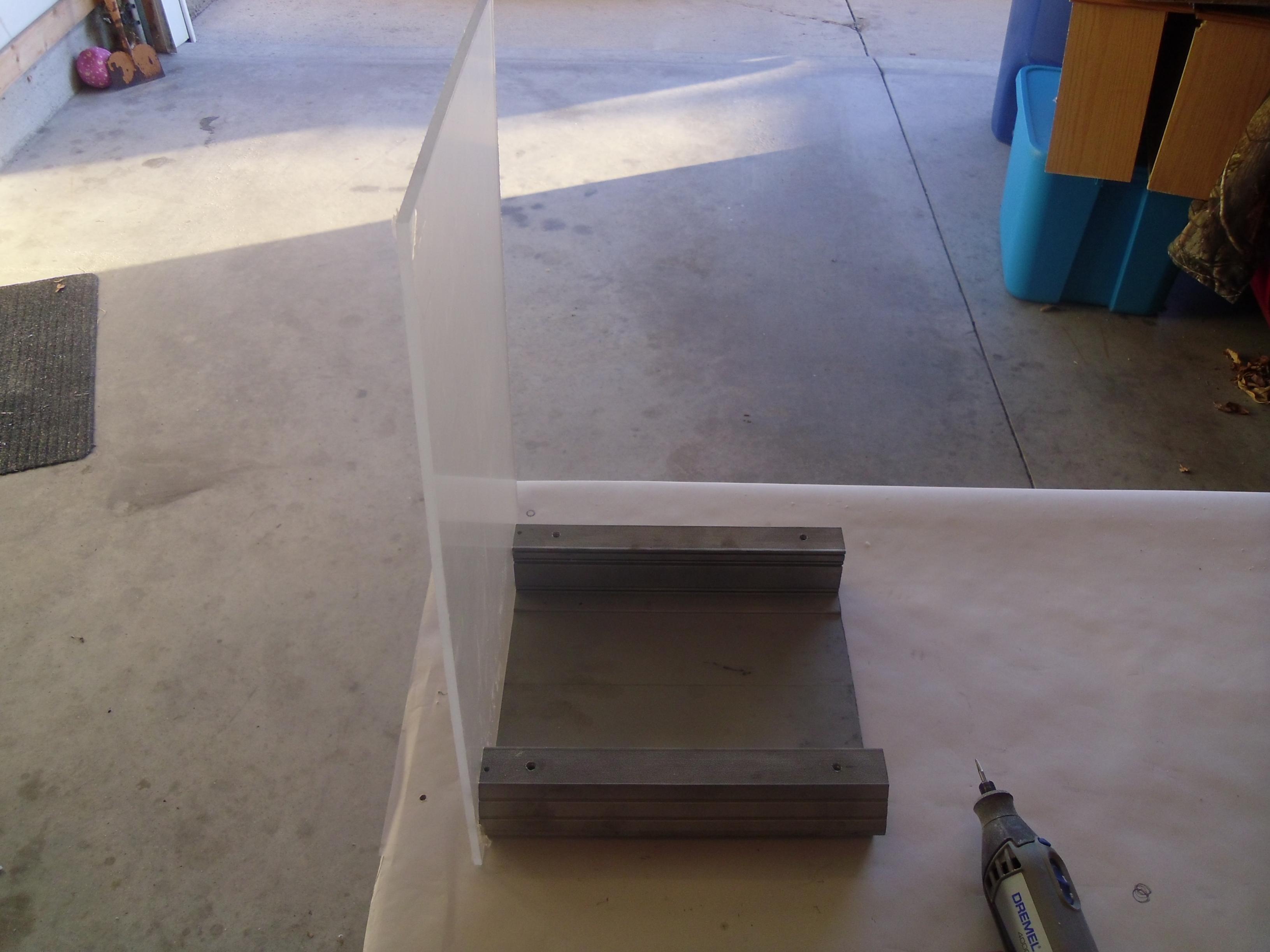

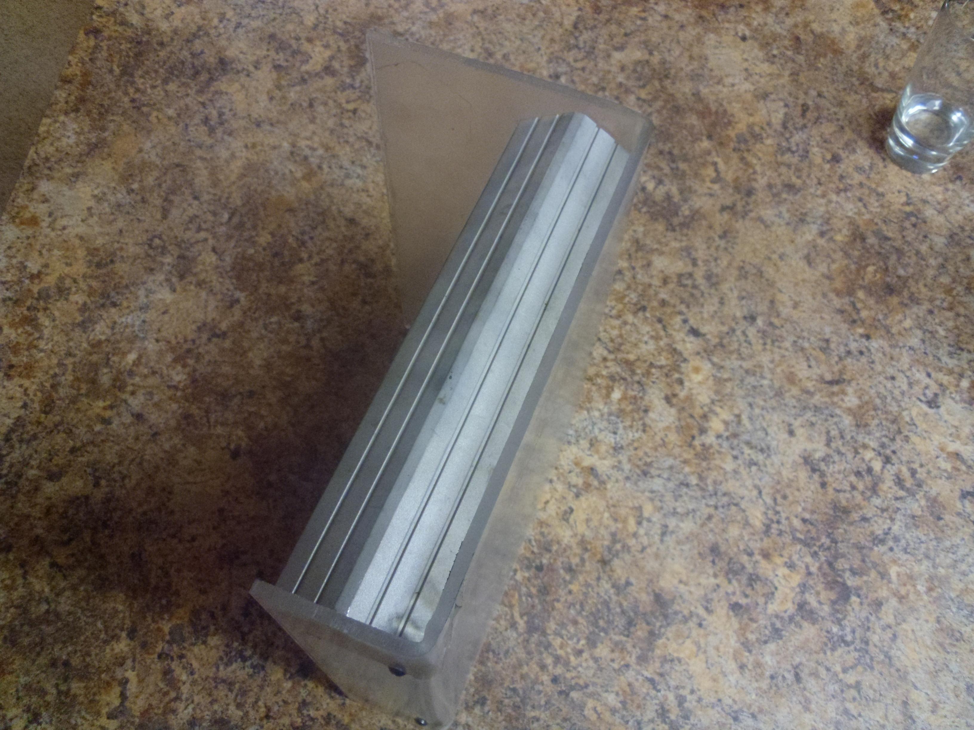

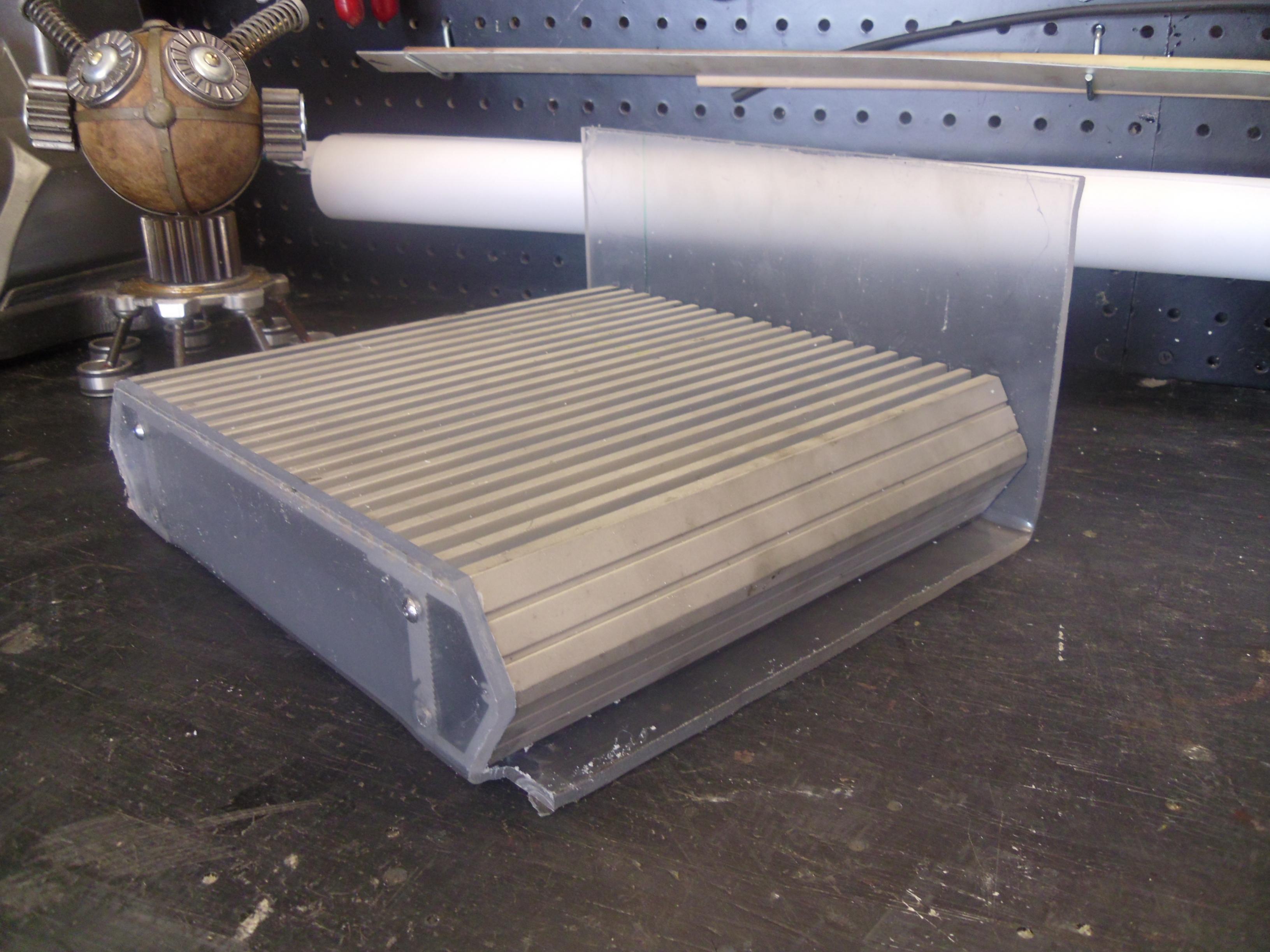

Well, pushing on with the task at hand. I was slooooowwwwlly able to bend the acrylic sheet and make it fit to where I was somewhat satisfied. I wasn't able to take any "during" pictures as it was done on my lunch break while at work tonight. I have to say that it takes a lot of patience to get it to fit tight. Overall I'm quite happy with it. Now I just have to cut and trim the leftovers and decide on how I want to mount the hardware.😀
Looking forward to seeing what you come up with. I like the last chassis you built.
This is going to prove to be a (pita). Wanted to make this a 2 piece enclosure but, it's gonna be difficult to wire up and still be neatly wired
Gonna have to think it through before i cut anything.
Thank you for the last enclosure.... think I might use it for the computer still.

Now seeing your further work on that case, check the dimensions on the transformers as you might have to stay within a certain VA rating to get it to fit inside. AN-3222 datasheet shows 2.9" height, but maybe a little more with the rubber mounting pads. AN-2222 is 2.3" + pads.
Well the internal height of the main case is 1 7/8" but, I have been kicking around ideas for a separate case for the power supply. I've been looking around at other builders layouts and I really like the separate case look. I was thinking something like a 4" id aluminum pipe tower of some sort. (I can get pipe from 1" to 8" at work. steel,chrome molly or aluminum)

Even the lesser 200VA transformer has a diameter of 4.5", then add a little space around it for ventilation purposes, and the holes or slits for convective cooling either in the pipe or top and bottom panel. Toroidal transformers don't have a strong magnetic field but what there is, is along the axis so people generally mount them oriented so nothing else is along the axis, though their general shape and the shape of a rack chassis case also makes this easier.
