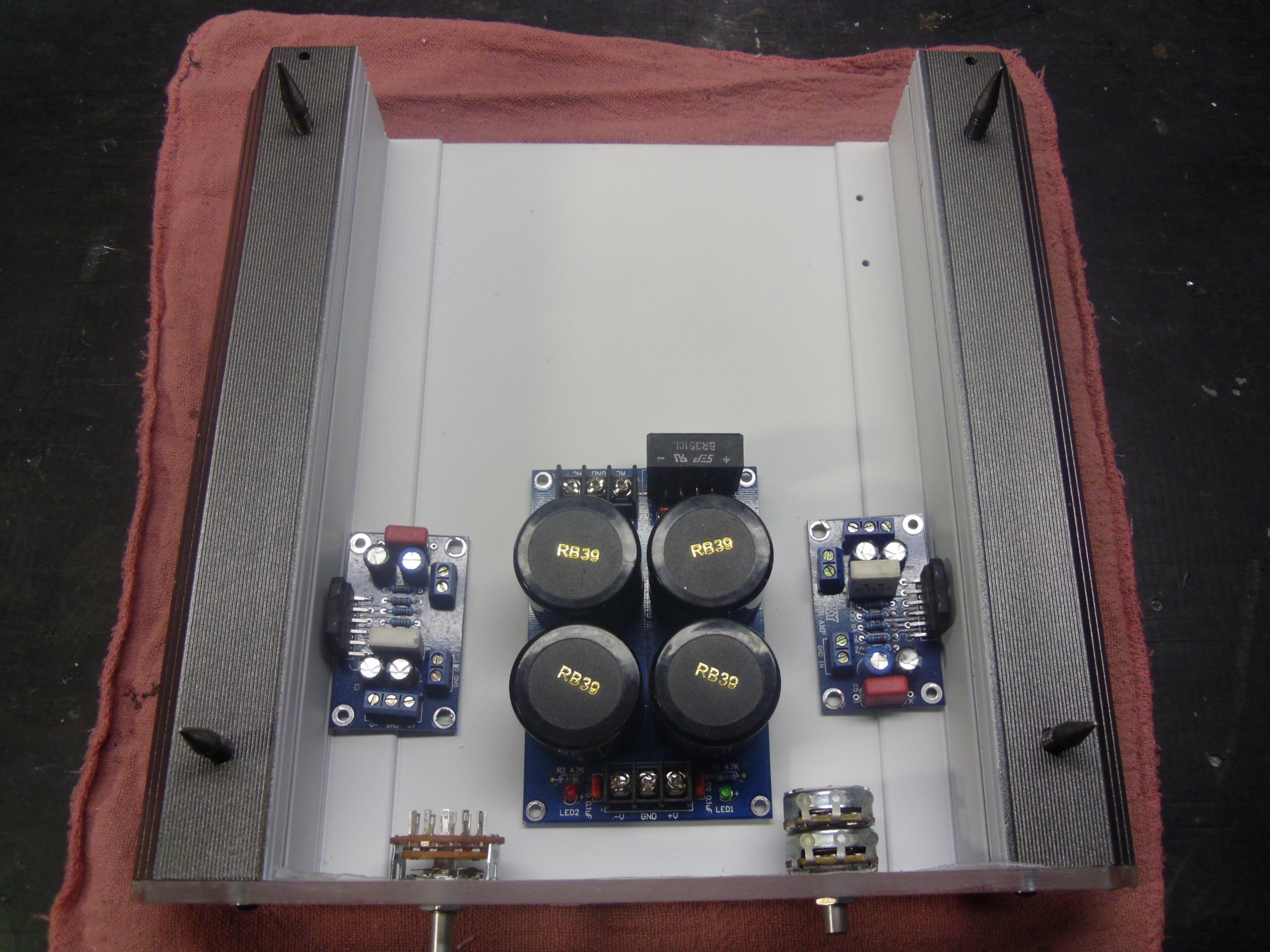

OK here's a quick shot of what I'm looking to do for adding another kit for a subwoofer.
The first shot is upside down with the acrylic sheet removed and the second shot is of the topside with a view of the selector and the volume knobs.The third shot is the actual case.
Hope this comes out OK and helps visually
That's looking real good so far. I wouldn't be too concerned about the heat and the case/HS expanding much. You'd have to have this thing cranked fairly high (and loud) constantly to generate the kind of heat that would stress the acrylic! There is a lot of surface area with that case to dissipate the heat. Now, if it was using Darlington output devices in TO-3 cases that's another story. 😀 Looks great.OK here's a quick shot of what I'm looking to do for adding another kit for a subwoofer.
