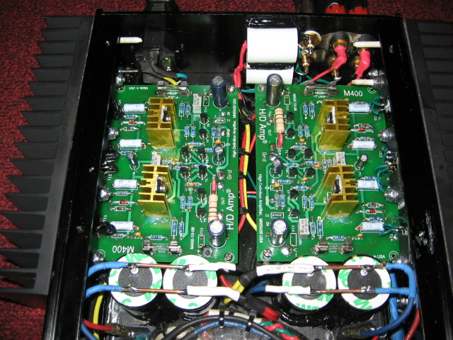

It will be an Antek toroid. I have another identical kit coming from China and should be here around the 4th of March. I wasn't sure if I needed to use both filter/rectifier boards or not. I thought I was going to be able to bridge one set of chips for a sub woofer but, after some research and suggestions from fellow diy's.....that's not going to work. I was also pondering running two amp boards in parallel for the left and the other two in parallel for the right.
I've been trying to get all the right parts and now I'm down to the proper transformer to run both of these kits. I've narrowed it down to either a 300va or a 400va trans with 25v or 24V secondaries.

The idea for the enclosure was ok, but my metalworking skills are rather modest - next one will be better. It is only around 2.2" high, otherwise it would not have gone into my tv stand (clearance above filter caps only 0.2").
I'm using a 150VA 2*19V 2*3.94A toroidal for it. I first bought a 300VA 2*30V, but this gave +/-50V after rectification and filtering, the filter board hummed loud on it's limits.

this is odd.............. I first bought a 300VA 2*30V, but this gave +/-50V after rectification and filtering, the filter board hummed loud on it's limits.
Normally a 35+35Vac transformer gives +-~50Vdc from the PSU.
30+30Vac should give nearer +-43Vdc.
Loud hum also indicates some error.
AndrewT you are right!
I checked in my electronics closet, that copper donut is 2*35V indeed.
I bought the thing before I learned that after rectification increases voltage. Now I need to wait until some project comes by that can use the higher voltage.

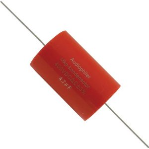

Can those Wima input capacitors be replaced by Audiophiler MKP 4.7uf 400V like the one shown on the picture attached to this?
Sure! if the input caps are on boards and the "upgrade" input caps are too big to fit on boards.. just remove them and use jumpers instead and just put the big caps at the RCA inputs!. Check mine!
So is it good practice to have a 4.7uf axial cap at each input. I'm looking at 4 inputs. so 8 caps total? If so then I have 12 of them in a drawer somewhere.
Yes, Better safe than sorry! they are there to eliminate DC do not get into your amp.if you have the space for these big caps, just put one on each board, but if you do dot have space than you can put one in each input RCA before the input selector and potentiometer. if you have them...USE THEM 😉So is it good practice to have a 4.7uf axial cap at each input. I'm looking at 4 inputs. so 8 caps total? If so then I have 12 of them in a drawer somewhere.
Remember to take the wima caps out and put jumpers there.

in that case you will need just two caps, one for each channel. post pictures of your project!😉
