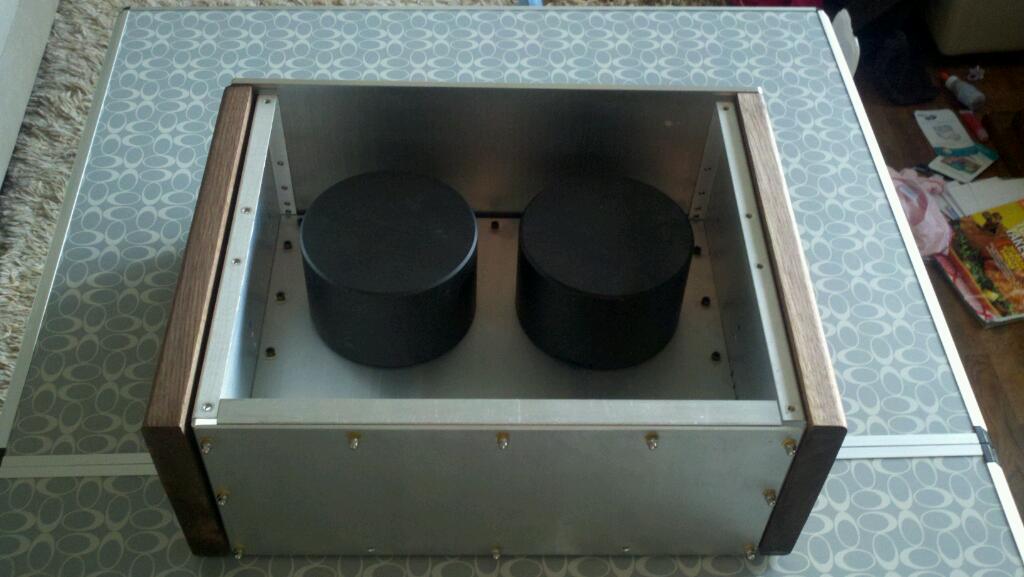

Try as I may, I can't get everything to fit without interference with each other. I have decided to listen to the veteran builders here and build a bigger case for everything to go in and sacrifice the one I have now to provide me with the heat sinks. This should give me a more professional appearance and layout of the components. I appreciate everyone's guidance and advise. It should be wrapped up soon.....I hope!

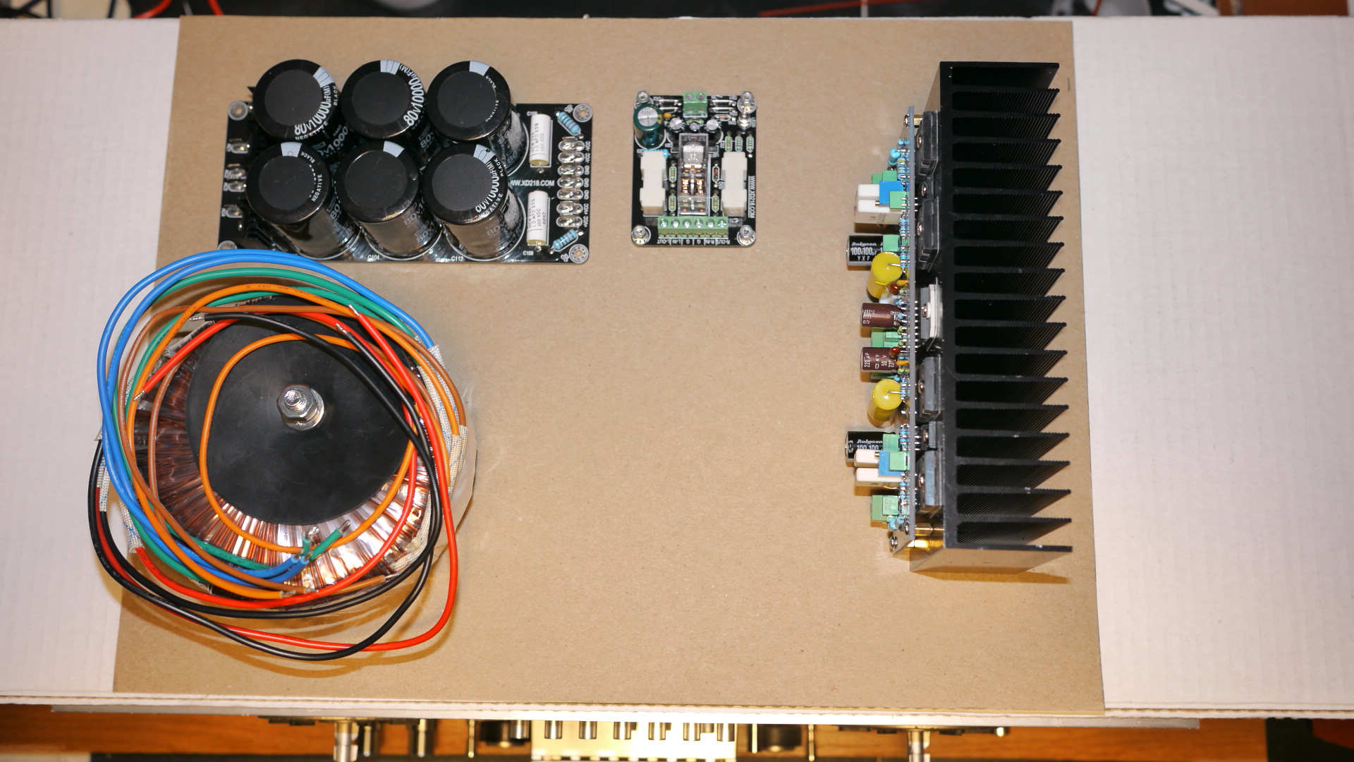

I went the other way with my enclosure and decided to go bigger (16 x 12 x 4) from the get go, since I wasn't quite sure of what my final design would include. I'm still not sure whether or not I'll include a preamp - maybe even a DAC board and another tranny. But, I'll have the space if if I need it. 🙂
My chip-amp is using the LM4702 which is class AB. So, needless to say, it includes a fairly good size heatsink attached to it. I was thinking I would just install the amp/HS vertical in my enclosure (as suggested by bcmbob) since it is well vented. Now I'm thinking I may try and hang the HS out the back of the enclosure, but that will involve a lot more case mods than I may want to put up with. We'll see. My enclosure is coming from NJ (Par-Metal), while I'm still waiting for more parts from China. 🙁 I've had real good luck dealing with an eBay vendor over there, who's been working with me when I'm not sure exactly what I need. However, since they're 13 hours ahead of NY, I have to stay up till midnight just to communicate! 🙂

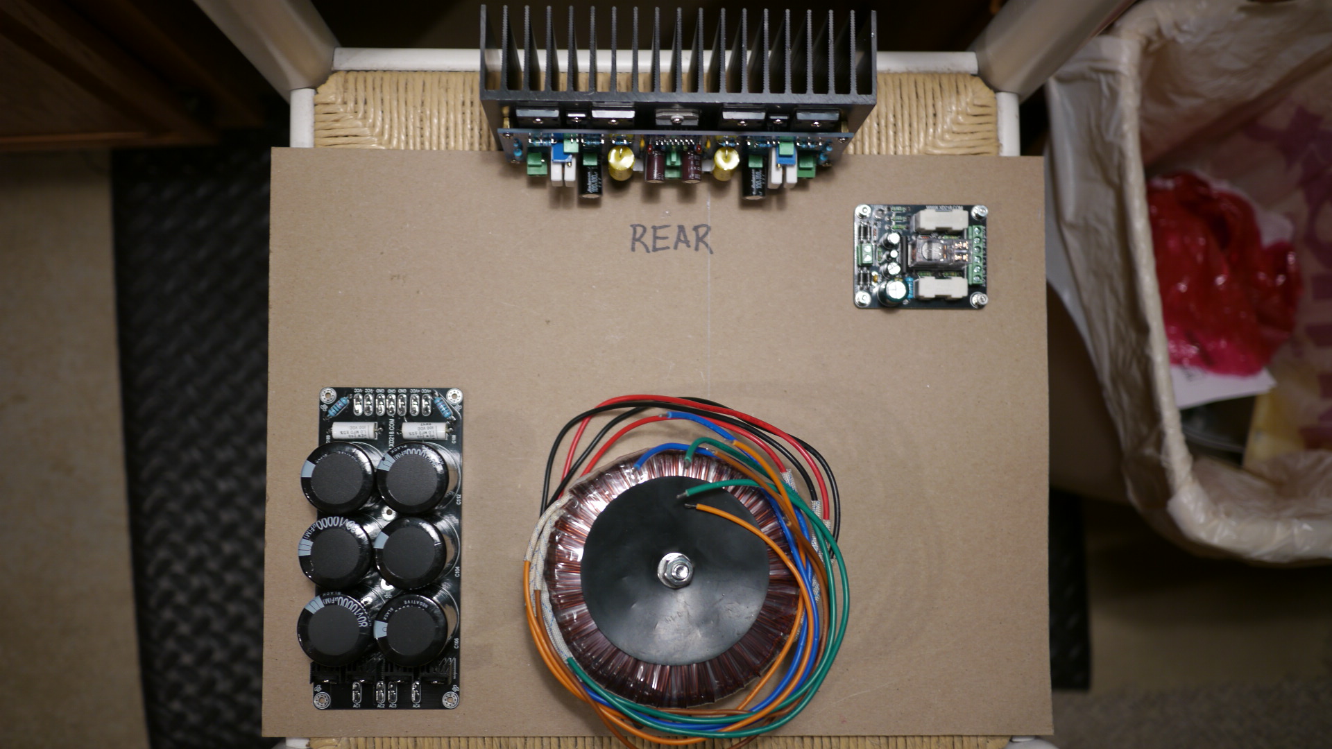

Shown below is my current thinking for the internal layout, but that may all change once the case shows up and I can see how much trouble it'll be to hang the HS outside the case for a better cooling. I can't wait to get started on the construction. It's all fun!
Redjr What about putting the other boards in front of your amp board/heatsink and the transformer in the front. It would move your sound path away from the transformer and shorten your wire runs from power supply to amp etc.
It's not clear from that picture, but the front of amp is the bottom of the image. I should have labeled my cardboard bottom plate template! If I move the amp module to the back so the HS can hang out the back, there'll be plenty of room to do just that. I always figured the x-former would be up front, but with that new configuration, I can put the PSU up front too. I also want to try and balance the weight so the thing won't list to one side or the other when lifted. With the amp module and x-former in the middle it solves that problem.Redjr What about putting the other boards in front of your amp board/heatsink and the transformer in the front. It would move your sound path away from the transformer and shorten your wire runs from power supply to amp etc.
The downside to the x-former in the middle front is the space on either side may be limited for other modules I have yet to decide on. One side will be the PSU module. I just need my enclosure to get here! I had the factory custom punch the back plate for an IEC power connector and paint (anodize) it black for me. That costs me a couple of days. Decisions, decisions. 🙂
Edit - See photo with proposed configuration. Should leave plenty of room for other modules.

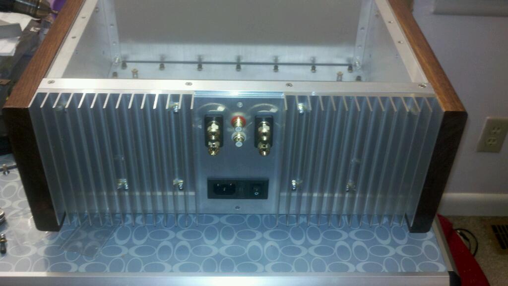

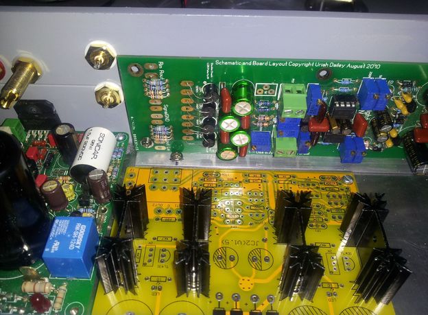

Redjr I had a similar problem with deciding where to put my heat sinks. I used walnut for the sides of my amp so I couldn't put them there. And I didn't want to keep them inside the enclosure so I had to hang them of the back. Bad thing was I had already finished the basic "box" of my enclosure. I bit the bullit and went back and re-engineered the back half of of the enclosure. I recessed the heatsinks to line up with the wood sides. This left me just enough room for the iec, rcas, and the binding posts. It was a pain but it was worth it. You could place your heatsink in the middle and have a binding post and rca on either side for a balanced look. Or your binding posts on one side and your rcas and irc on the other. Its no joke that most people spend most of their amp building time on the enclosure, I definitely am.

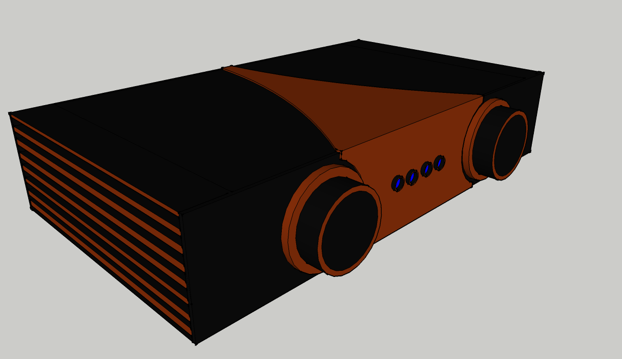

This is what I've come up with so far...... It should suffice. I've been looking at the photo archive from various internet photos.
Very nice!
🙂 As an old planner by trade, I don't like to leave anything to chance! So I'm probably 'over-anal' about my design and trying to get it just right. You know what they say, "measure twice, cut once". 😉 It goes without saying that spending the right amount of time with upfront planning will pay dividends in the end result.Redjr I had a similar problem with deciding where to put my heat sinks. I used walnut for the sides of my amp so I couldn't put them there. And I didn't want to keep them inside the enclosure so I had to hang them of the back. Bad thing was I had already finished the basic "box" of my enclosure. I bit the bullit and went back and re-engineered the back half of of the enclosure. I recessed the heatsinks to line up with the wood sides. This left me just enough room for the iec, rcas, and the binding posts. It was a pain but it was worth it. You could place your heatsink in the middle and have a binding post and rca on either side for a balanced look. Or your binding posts on one side and your rcas and irc on the other. Its no joke that most people spend most of their amp building time on the enclosure, I definitely am.
