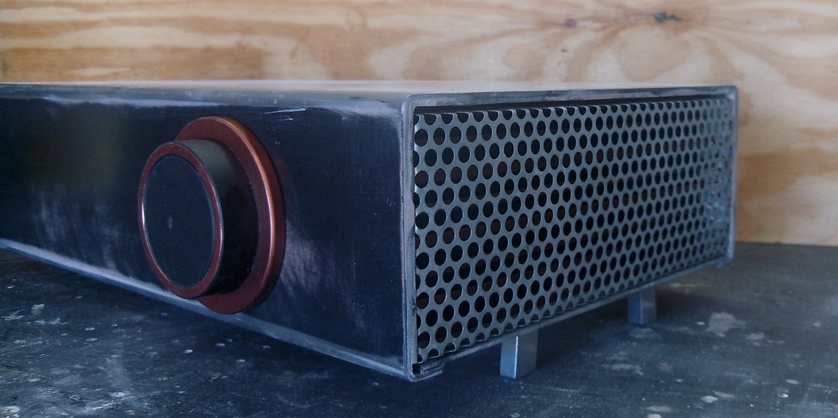

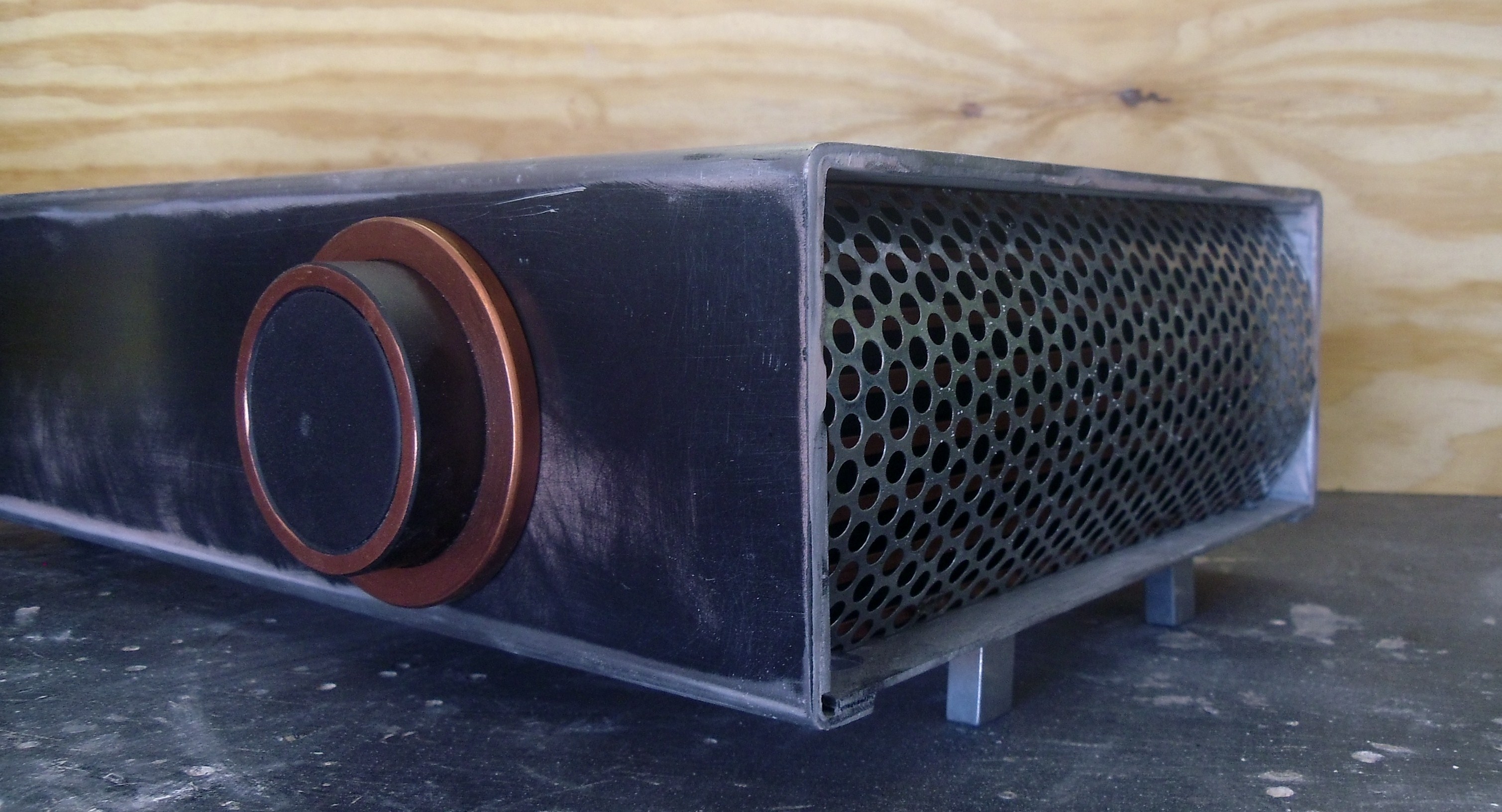

I vote flat. Although the curved does have a certain appeal. If you figure out a way to finish off the edges of the curve it would work. I like how it matches the knob, but the flat looks more finished.
yeah i thought it would killer curved and paint the case a laquer teal with white knobs..... kinda like an old school 1962 stratocaster
really don't know till it comes time to paint it....everything is up in the air at this moment🙄
I like the round one better! it is different than the usual flat and it looks nice too.😉. I like the mesh, because it has a lot ventilation on the sides that aloud air flow to circulate better. 😉

A nice rounded sound?
But the chassis would need to be designed to make the rounded feature/s attractive, not just stuck on, as at present.

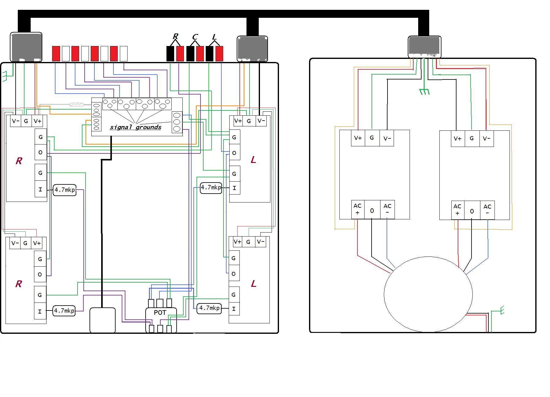

Ok....jumping back a bit here. This is the current mess I'm working with here. Hope you can see it.
I don't know what to do with the signal grounds on the selector board or how to wire in the center channel
I've been reading and learning from this thread http://www.diyaudio.com/forums/chip-amps/207971-bought-xy-lm3886-kit.html He seems to be doing exactly what I'm doing except for the speaker protection boards. I don't want to mess with his thread so I'll keep my questions here.
