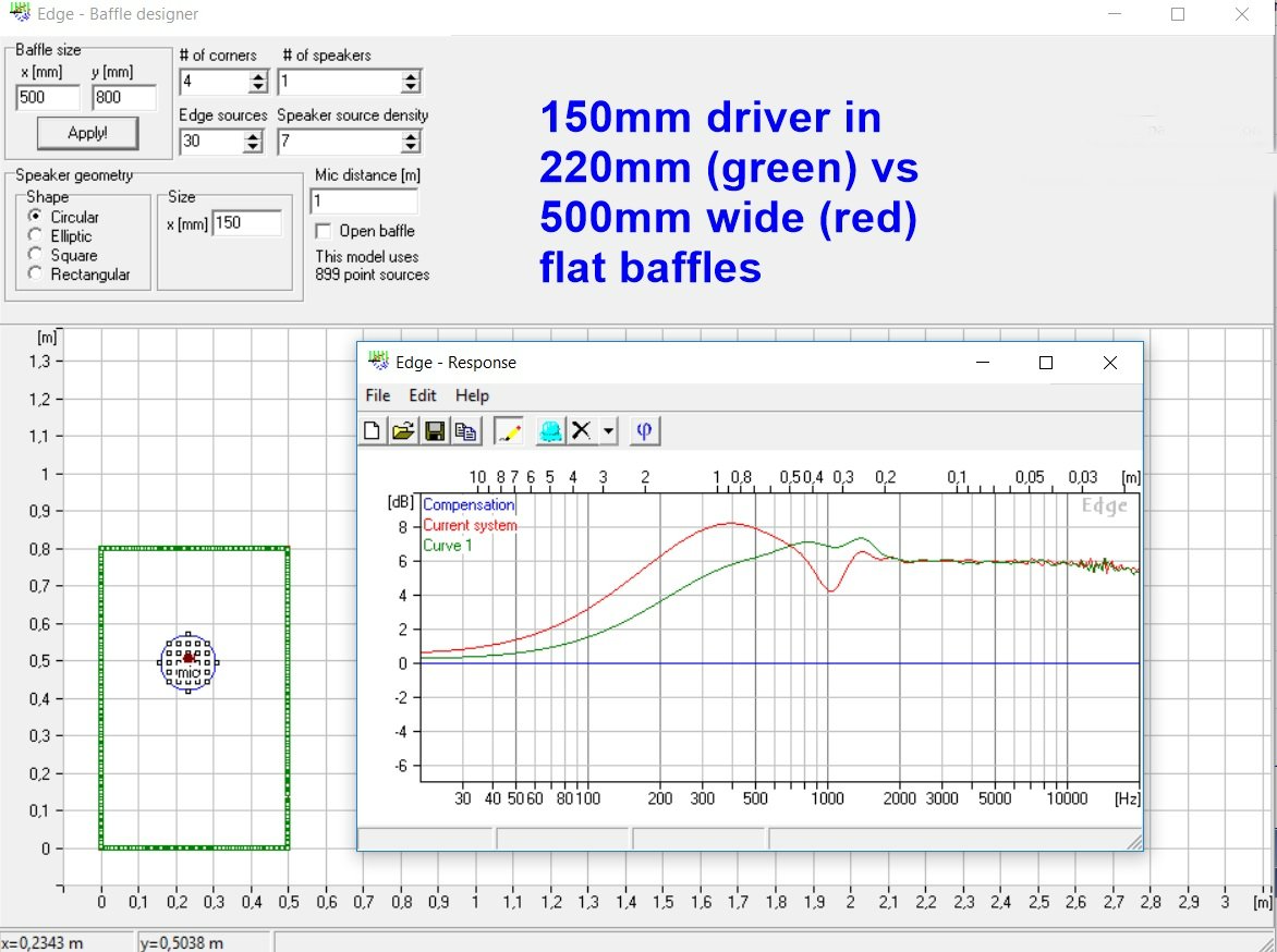

Looks like you don't have baffle step eq at all (below 600Hz). Safest is to set 1st order - 3-6dB lowpass shelf for mid (or woofer in 2-way). Then attenuate tweeter channel respectively.
1kHz bump comes most likely from baffle step, you must eq it for all overlapping drivers (peak correction with suitable Q and -3dB gain). 6kHz bump must be flattened too.

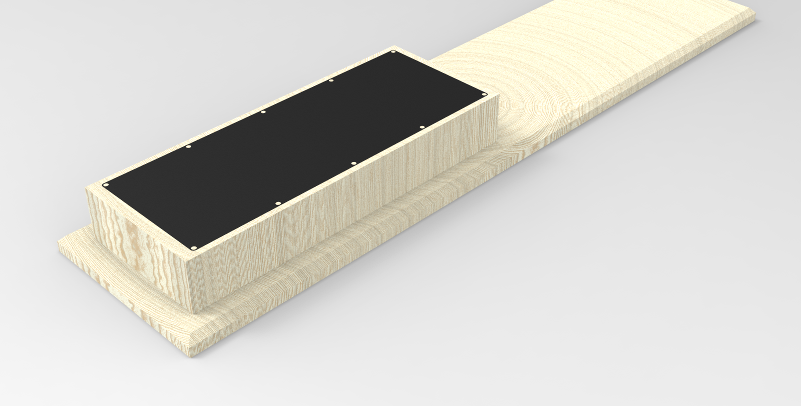

Вы можете показать мне свои идеи на рисунке, дать мне размеры, и я сделаю для вас их визуализацию.Мне нужно изучить САПР, чтобы я мог проектировать как ты.
Nahimic, via google translator is saying "You can show me your ideas in a drawing, give me the dimensions, and I will make a visualization of them for you."

Спасибо!Вы можете показать мне свои идеи на рисунке, дать мне размеры, и я сделаю для вас их визуализацию.View attachment 1396575

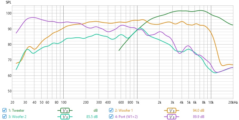

Here is what I get for individual drivers and the port (with 2 woofers). 5cm distance, other drivers muted in HFD. No filters or gain settings except 500Hz highpass on tweeter. 1/3 smoothing
Surprised how different the response from woofer 2 is!

Interesting responses, with woofer 1 looking remarkably flat up to 8khz and approx 10 dB more output, its not making too much sense to me at the moment.
The measurements are of individual drivers with the microphone on axis a few cm away, all other channels muted?
Woofer 2 I would expect to be similar amplitude and a reasonable match when measured close up.
At 1 meter distance and a short 4mS time gate you will see possibly differences caused by the drivers baffle position differences in their heights relative to the floor. Also interesting is that it does seem to have a 1Khz bump, and then its frequency response tails off in a different manner. I wonder has the suspension hardened, maybe it is getting old . Do they have identical part No's and date stamp, what happens too the measurement's if you swap drivers?
Tweeter looks OK, and the combined plot, I assume measured on tweeter axis shows how the drivers and Xover combine. Just flip the tweeter phase as a learning exercise and see how it may change the response.

I was also puzzled by the difference in two woofers. Worth re checking everything and re measure to eliminate any errors.

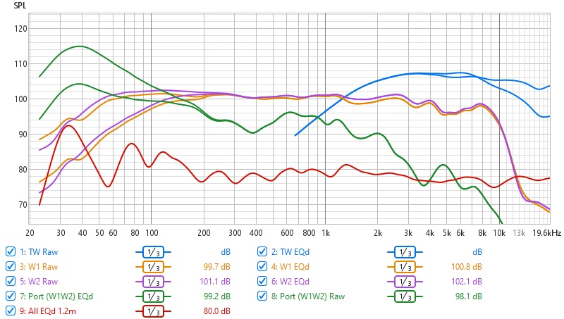

Another long session learning to measure and HFD, trying to take the above advice into account and I think the results are much better.
- the two woofers measure similar now, so I must have made a mistake before. so this mystery is solved
- the two LF dips are now proven as room modes - they change completely when the mic is moved (not the speakers!) - thanks to Juhazi!
It can be interesting to change smoothing to 1/24 octave, just to better see any potential resonances.Here is how the individual drivers and port (raw and EQed) and then the overall EQed system look like now.
I find the ability to control the response so easily and accurately using dsp absolutely amazing! When you know what you are doing that is.
I have now added a delay to the tweeter based on the relative position to the mid depth of the woofers in the baffle plane.
I had poor success attempting to physically measure any distances, or even using interferometry in the case of using Hypex. The delay I thought I should use and what ended up being right were not even close.
A better solution for me came from examining the impulse response for the initial delay setting for a rough delay estimate followed by inverting the tweeter and carefully nudging the delay until I achieved the minimum null. Helps to add excess delay at first so you can clearly differentiate the two different signals. Measure the delta, subtract your excess delay and then nudge.
Also, using higher order (LR4) electroacoustic targets really helped optimize the off axis response.
