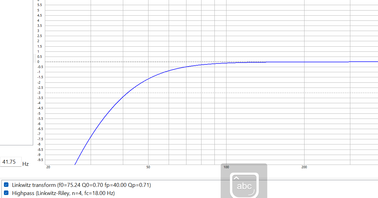

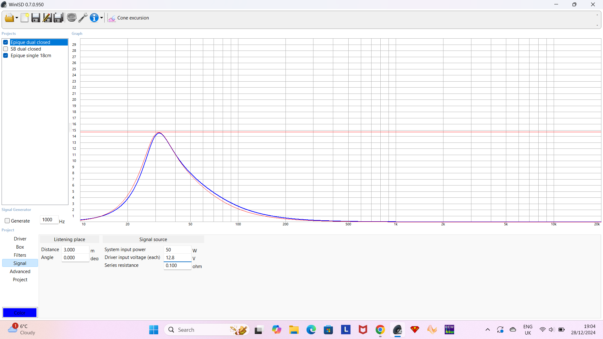

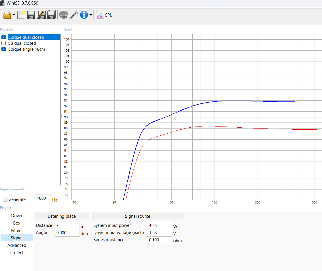

Now modelling the new drivers in WinISD. Using two Epique drivers in 10L available to me, adding Linquitz Transform and an additional 9dB boost to flatten output down to 30Hz as much as i could while fitting below the xmax by limiting the input power. Applying highpass LR4 at 27Hz helps reduce excursion peak. I get this:
Not clear - is the power per driver or total? And will I have to apply this limiter (50W? 50Wx2?) on the Hypex channel output? Or is it enough to just keep the playback volume sensible?
You're doing something weird/wrong with the Linkwitz transform filter.
On the box tab of WinISD you should see and FSC and a QTC below the box volume input. Bump the box volume up by .01 and then back again to make sure the FSC is correct (it should change and then go back to the original when you do this).
Example
Model a single 5.5 epique driver in a 3.44 liter box. You should get an FSC of 75.23hz, and a QTC of 0.703
Plug these numbers into the F0 and Q0 in the LT, then drop in your desired end state parameters into the F1 and Q1. In this case 40hz and 0.71.
Should look like this:

Doing wrong? Not only possible, but quite likely! Will have another go.
