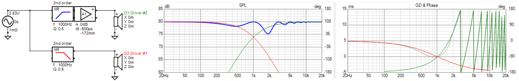

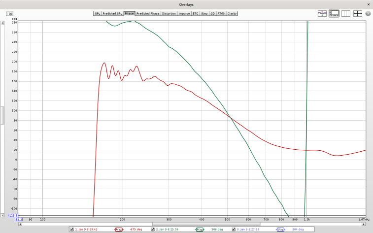

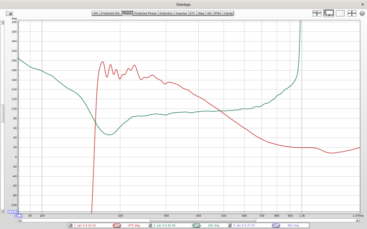

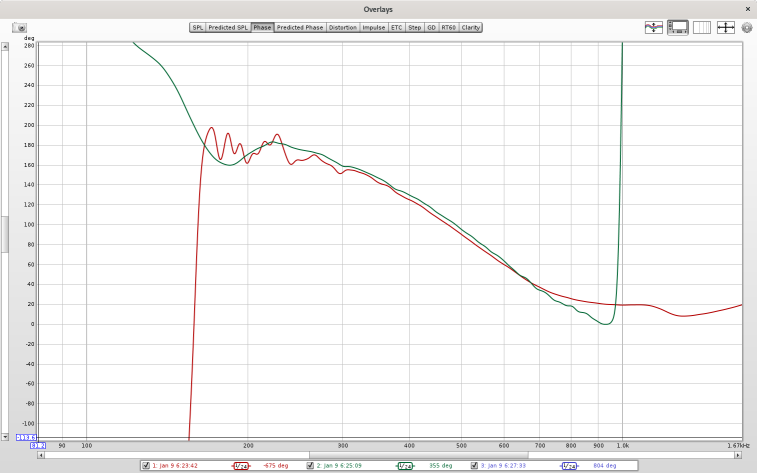

Is that enough, or is there more to it than finding some kind of best fit?The delay I thought I should use and what ended up being right were not even close.
examining the impulse response for the initial delay setting for a rough delay estimate followed by inverting the tweeter and carefully nudging the delay
Examining phase does hold the key, but phase is influenced by the response to begin with so finding the precise delay isn't that simple, not that I think it matters.
Looking at nulls is the same as looking when in phase, except the nulls may miss important information.examining the impulse response for the initial delay setting for a rough delay estimate followed by inverting the tweeter and carefully nudging the delay until I achieved the minimum null.

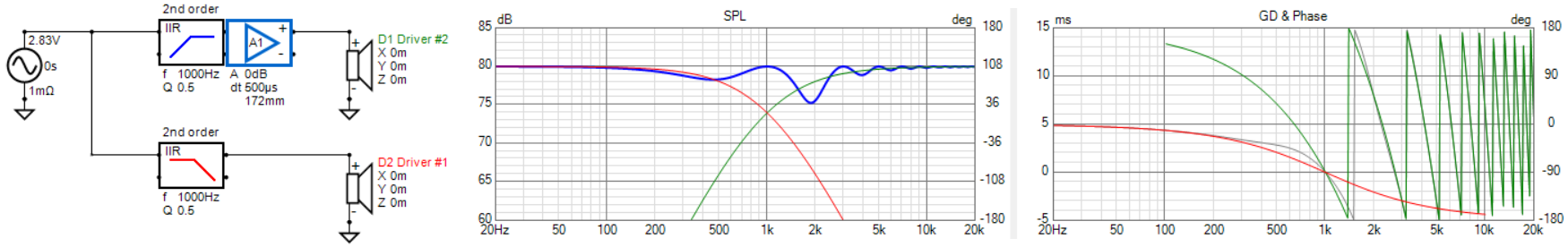

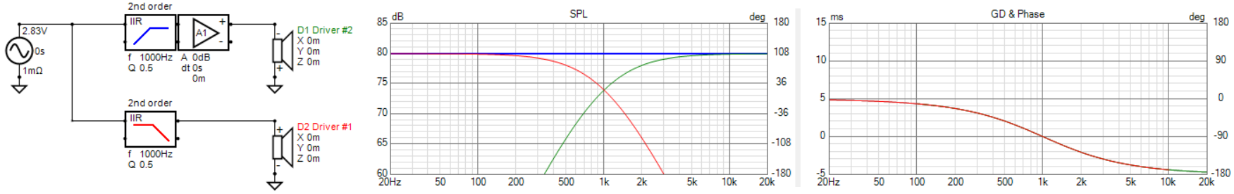

Here's an example where each will produce a nice null, but only one is reasonable to use. Cross at 500Hz, three different delays, one plot has polarity swapped and the others don't.

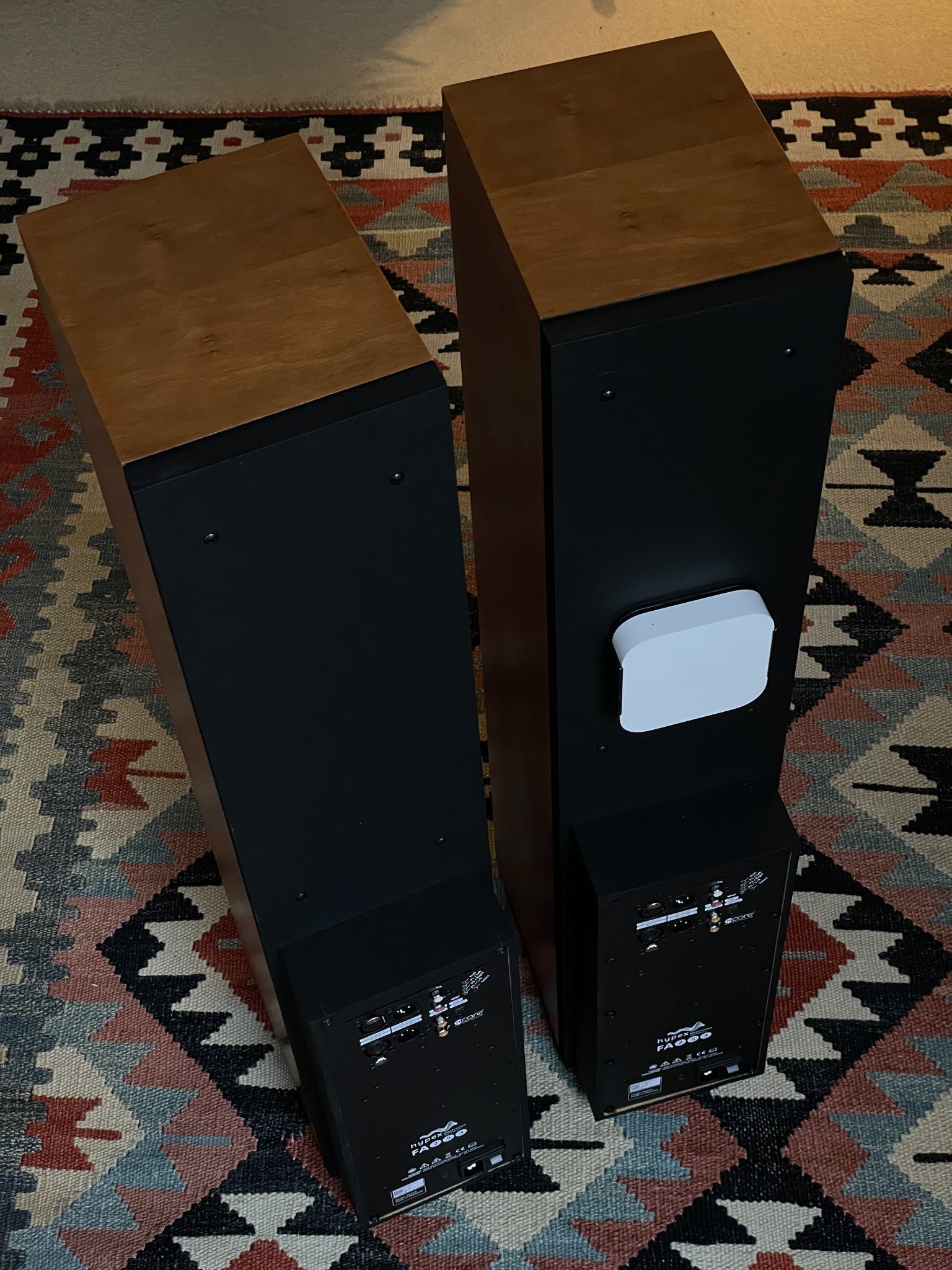

Assembly of both complete. Time to measure and program as a pair.

Null testing is a common discussion across the internet for more than it's limited scope of useful applications.For the purpose of my last post, I was trying to be as short and succinct as possible
In this case it causes a loss of information, as I wanted to point out with the example plots.
Somehow i thought the op was a beginner whose design would fit well in the category of useful applications 😀across the internet for more than it's limited scope of useful applications.
I don't follow your example plots at all. A reverse null test can tell a lot, but not if you aren't already close. I have no idea what you are trying to show there. Loss of information???? How is measuring something a loss of information.Null testing is a common discussion across the internet for more than it's limited scope of useful applications.

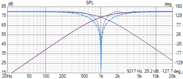

In those three plots, phase is the same for both traces at the crossover frequency of 500Hz. This means all three would produce a good looking null at 500Hz.
I don't need to reverse anything to prove this.. however if I use null plots I'm not able to clearly see the phase relationship in the wider crossover region. With correct polarity plots, I can.
Ok... I see one correct alignment, and two with either a positive or negative time alignment of almost 7" error, which is a lot, and beyond anything I might build.
At a glance, it's obvious that the second two are not "excellent x-overs", because the sum at 2k drops below the tweeter output at 2k. The drivers are fighting each other there.
Can you now show all three in the opposite polarity? I predict that there will be a null at 1k in all three, which was maybe your point..... but, 2k will peak slightly above the tweeter response in the second two. The null on the first will be nice and wide, and "perfect". The null on the second two will be much more narrow near the top, and probably not quite symmetrical.
The shape of the null is a poor indicator of the phase relationship and besides, natural driver variations will change the phase and levels so that the peaks/nulls may be widened or narrowed, removed or reversed. Not what you see on the simulator.and two with either a positive or negative time alignment of almost 7" error, which is a lot,
Half a wavelength is the nearest null event either way but with driver variations, you may not need even this amount of delay to see a null 😉 Here's an overlay of the above plots with reversed polarity. The null depths are the same.
