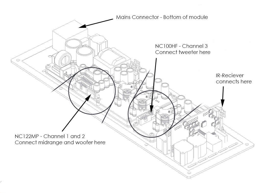

Step 1 – Hardware setup
The first step will cover the physical hardware setup of the FusionAmp.
Fist we need to wire up the amp to our speaker drivers. I first installed the speaker drivers in the cabinet. Then I hooked up the fusion amp with the included cables as shown here:
attachment.php
The red and black wire from the two-wire connector goes to the tweeter.
This is channel 3 - the special 100W HighFrequency amplifier. Red is positive and black is negative.
The Blue and gray wire from the four-wire connector goes to the midrange driver.
This is channel 2 – one of the two MultiPurpose 125W amplifiers. Blue is positive and gray is negative.
The red and black wire from the four-wire connector goes to the woofer drivers.
This is channel 3 – The other full-range 125W amplifier. Red is positive and black is negative.
The remote receiver is connected to the top PCB (the digital DSP board) in the only connector it fits.
This is not needed, but nice to have.
Install the amp in the cabinet
To hide away the sensitive electronics, wires and the mains power.
Connect the mains cable.
LEAVE THE MAINS SWITCH ON THE MODULE OFF!

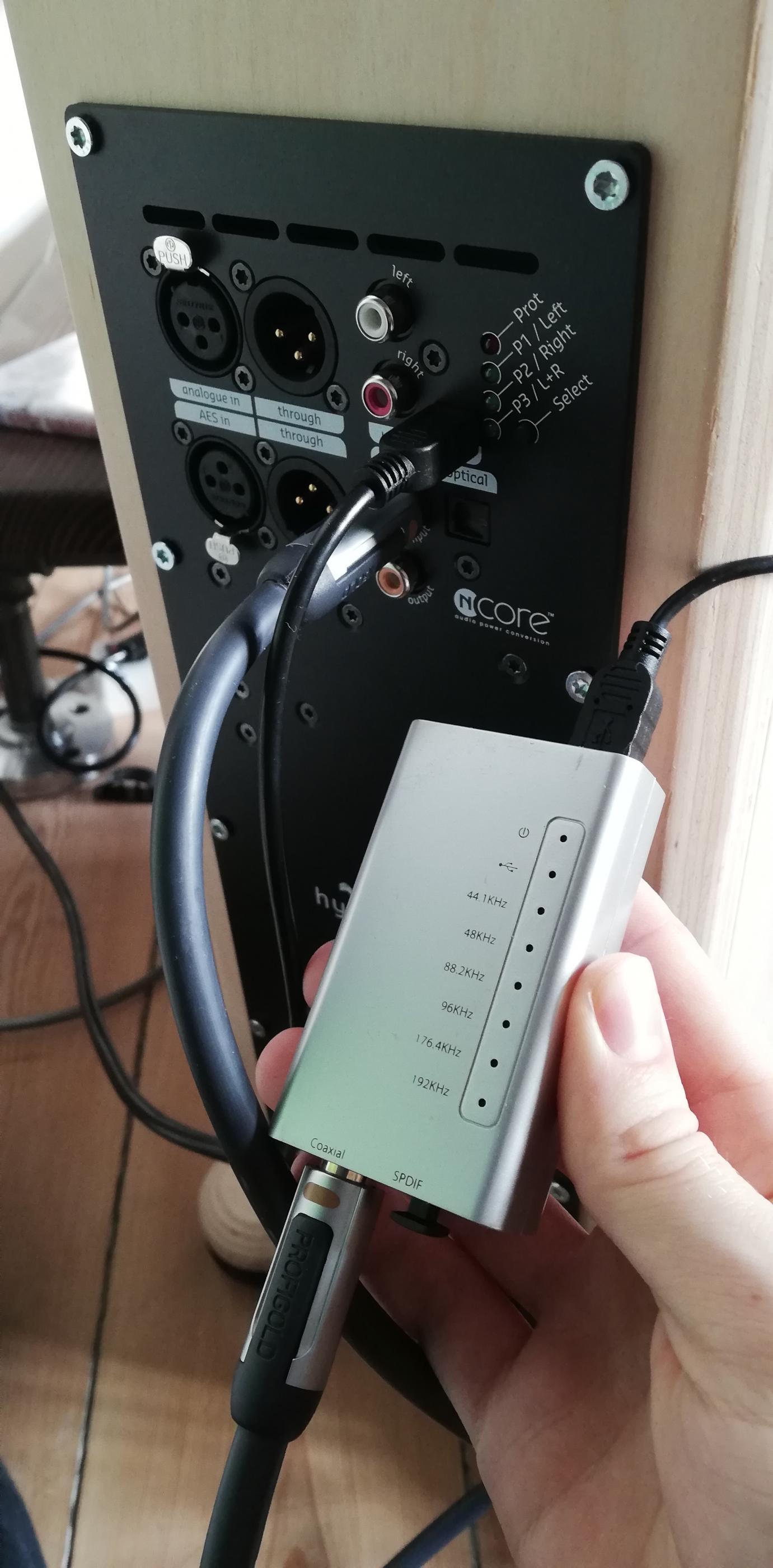

Connect the amp to the computer with a USB mini to USB A (normal USB) cable.
Connect a sound input on the amp to you PC.
I chose to use the S/PDIF input on the FusionAmp. To use S/PDIF, I use a simple USB to S/PDIF converter like this one:
Kob USB D/A 24-bit 96kHz converter - (DAC) pa Av-Cables.dk
I know MiniDSP also has one but I have not tried it.
I choose to use S/PDIF only based on my own intuition. I think it will be the most direct way I can connect my pc to the amp without using my laptops horrible mini-jack. The FusionAmp will handle all the conversions needed. I may be wrong, but it works and it sounds good 😛
attachment.php

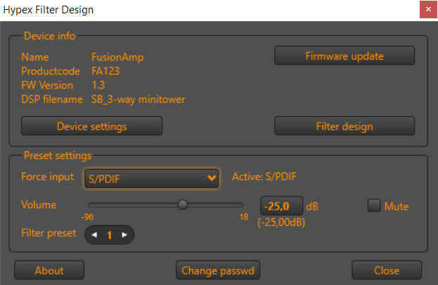

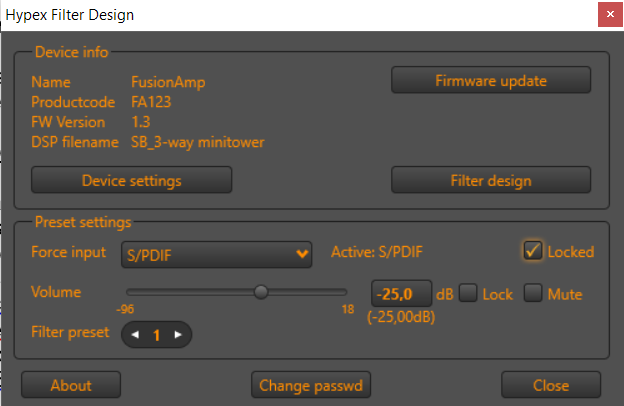

Open HFD and wait until a device is found.
If no device appear.. contact Hypex xD
When HFD finds a device, the start window should look like this:
attachment.php
If you see the module running old firmware (“FW Version”), then it should be updated. At the time of this writing, the newest firmware is 1.3.
The firmware 1.3 is included in the HFD 4.8 installation download.
Click the “Firmware update” button
Navigate to the HFD 4.8 download > “Resources” > “FusionAmp firmware”.
Choose the “FusionAmp v1.3.hex” file
attachment.php
DON’T TOUCH ANYTHING until the firmware is installed.
When prompted that the update was successful click “OK”
Wait for HFD to find the module again.
Confirm that the new firmware is installed by checking the “FW Version”.
If this does not work… Contact Hypex xD

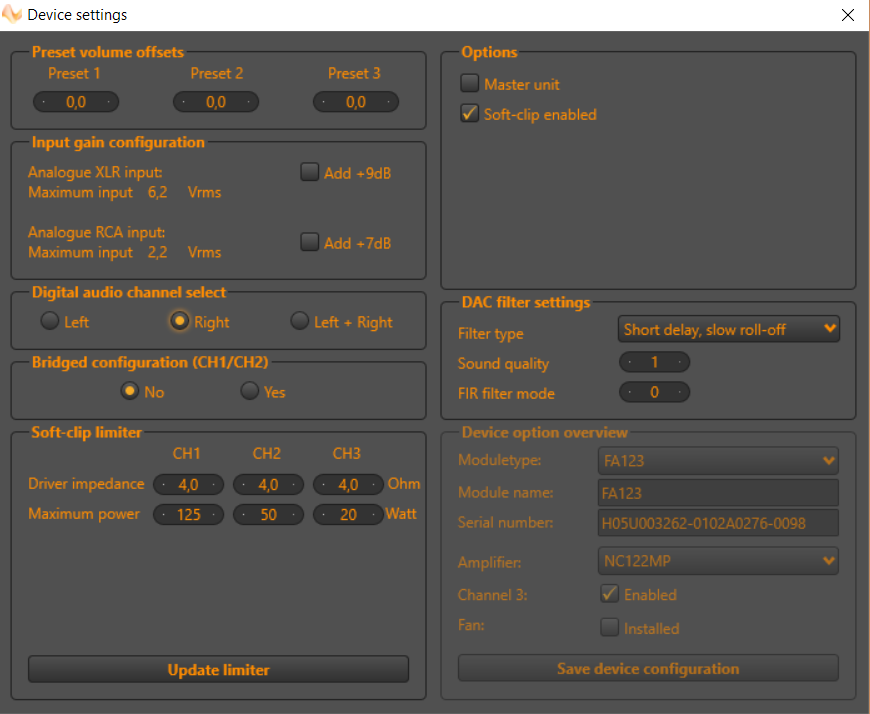

Step 3 – Initial Module Configuration
In this step we will setup one module for crossover designing. I strongly recommend the following settings are used while doing measurements. The auto on/off and source select are awesome features (from firmware 1.3) but they WILL fuckup your measurements eventually 😛

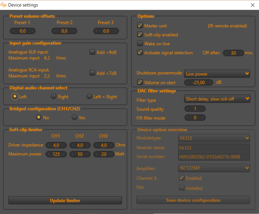

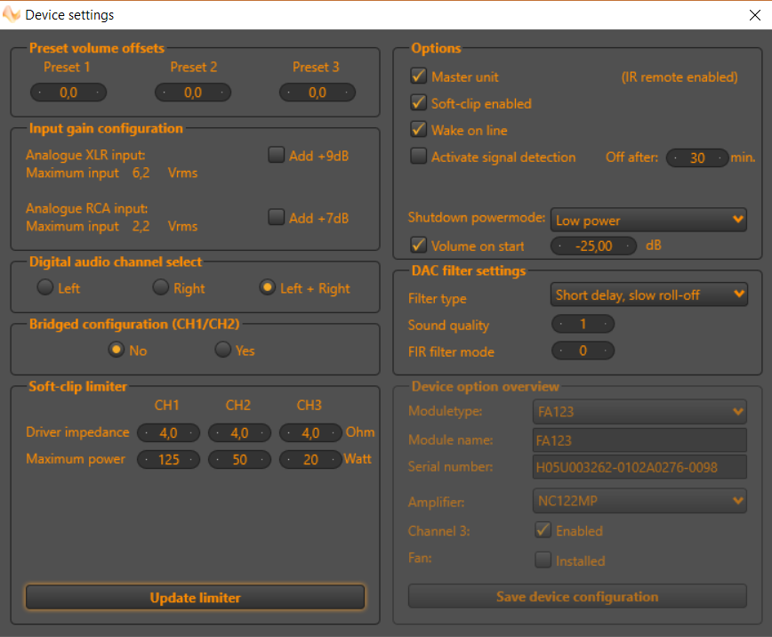

Click the “Device settings” button on the HFD start window.
In the “Device settings” window, set all the settings as shown here:
attachment.php
”Options”
There must always be a master unit for the system to work. Therefore, we set this first module as master.
I enable “Soft-clip enabled” to protect my drivers while testing.
In the “Soft-Clip limiter” set the driver impedances according to your drivers.
Remember Channel 1 is woofer channel 2 is midrange and channel 3 is tweeter.
Then set the maximum power to a value you are comfortable with like half your drivers max power or whatever.
If you later figure out it is not enough then go back and increase it.
CLICK THE “Update limiter” button
If this button is not clicked, the limiter settings will not take effect. When playing music or measurements you will see that the limiter kicks in when the red LED flashes. Either on the back of the module or on the IR receiver.
As mentioned signal detection is not a good idea for measurements – it’s annoying to start a measurement by the time the speaker has went to sleep and then having to wait for it to wake up again.
Volume on start.. Well depends on the sensitivity of your drivers. I use -25 dB.
I recommend starting with a low dB (like -40dB) and later increasing when you know what you need and filtering is done.
“Dac filter settings”
I have still not used any of this since it is new in firmware 1.3. Leave it untouched unless you know what you are doing. I do not xD Inputs are VERY WELCOME.
“Preset volume offset”
It is what it is. No magic there. I left it at 0 dB. It is useful if you have a specific input forced on a specific preset that needs different input gains.
“Input gain configuration”
I did not use any of this yet as I only use SPDIF and Optical in my system.
“Digital audio channel select”
I suppose you can choose what you want her. I chose “Left+Right”. This way I do not have to worry about what channel is used for output in REW. In addition, it gives a better impression on sound when playing test music on one speaker I think.
“Bridged configuration (CH1/CH2)”
As we are configuring a 3-way, we do not want to bridge these channels. I do not have any experience in using a fusion amp bridged.
Now close the “Device settings” window.

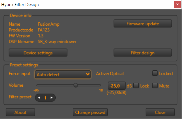

“Preset settings”
Under force input, choose “S/PDIF” or whatever you use.
DON’T USE “Auto detect” while making measurements!
Be aware that the input selection is preset dependent. This means that if you change the preset the input changes. I just selected S/PDIF for all three presets – just to be sure!
So far so good! Ready for some filtering!

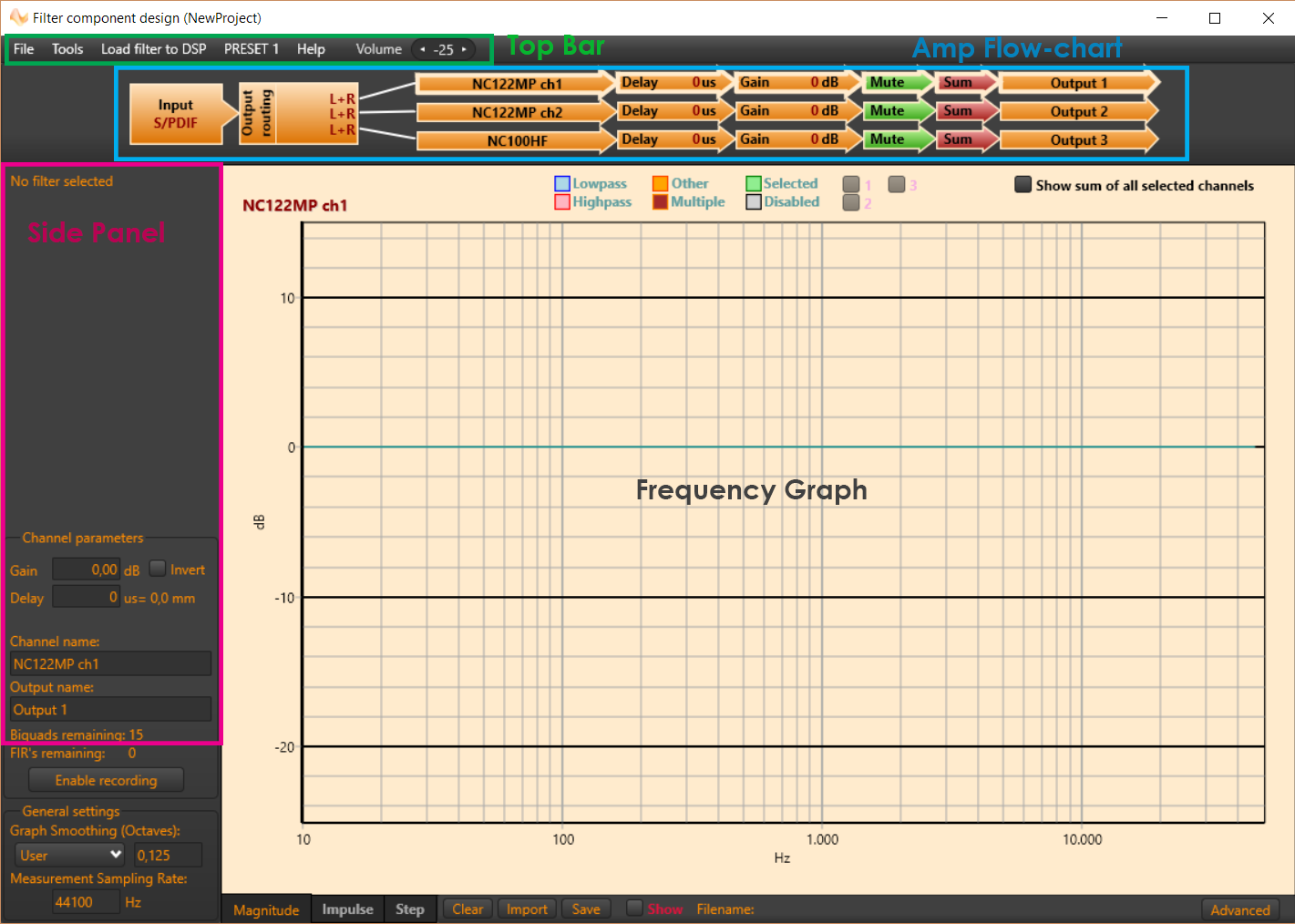

Step 4 – HFD Filter Design intro
This step will introduce you to the basic filter design window of HFD. This is really the only feature you need to get going. I will not cover all the other features of HFD. Simply because I have yet not used it myself. Refer to the HFD manual for more information on these matters.​
On the start window of HFD Click the “Filter design” button.
This opens a new almost empty window.
In the top left corner click “File” and chose “New FAXX”
In my case “New FA123”.
This should open a window that looks like this:
attachment.php
This is the only window we will be working with.
I did not load any measurements into HFD. I tried in 4.7 without success. It may work now in 4.8 I have not had time to experiment with it. When I have time to try it again I will report back here. If anyone of you have any experience with measurements in HFD please feel free to add to this guide J
To get started I recommend that you only use HFD for filter settings and use REW (or whatever you are used to use) for measurements as this was what I found easiest.
In the very top you have 5 buttons: “File”, “Tools”, “Load filter to DSP”, “Preset 1” and “Help”. After these you see two small buttons and a input field for volume control. Let us call all this “Top bar”
Click the different buttons to see their under functions.
Under the top bar is shown a small flow-chart-like diagram of the FusionAmp. Lets call this the “Amp Flow-chart”.
Starting from left it shows the currently used input – in my case S/PDIF.
Next it shows what side is playing – in my case “L + R” for left and right.
Then it splits into three rows representing each channel with channel 1 on top and channel 3 on bottom. These first three boxes are also buttons used to select which channel you are working on.
Try clicking the different channels and see that they become highlighted.
Each row then contain a “Delay” and “Gain” box which shows the delay and gain on that channel.
Then a green box called “Mute”.
Try to click the “Mute” box.
It then turns red and changes name to “Muted”. When this box is green then the channel is live and playing. When it is red, then the channel is muted and does not play.
Then the next box is called “Sum” this is used to decide if that channel is showed in the summed response in the graph window. However, it only works with a measurement in HFD. So we will skip these.
Finally there is a box called “Output x”. This box and the first box in the three rows can be renamed from the “side panel” on the screen.
The “side panel” is one of the parts of this screen we will use the most. This is where filter types are chosen and values changed. Now it just says, “No filter selected” on top.
But further down it says “Channel parameters”. Here you can first adjust gain and delay for the channel that is active in the “Amp Flow-chart”. You can also invert the channel.
Next, you get the option to change the name of your channel and output for that channel.
After these input fields you are shown how many biquad remains – 15 since we did not add any. Think of Biquads as “filter functions”.
The “Fir” field is new in V1.3 and I have no idea what I means. I did not use HFD to do measurements so we will leave the rest untouched.
The buttons along the bottom of the screen I also did not use so leave these untouched, unless you feel brave 😛

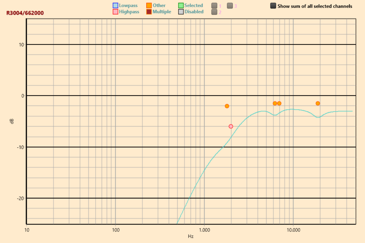

Finally, we have the big beige graph. This is the frequency response graph. This is where every filter starts.
Right click anywhere in the graph area. Choose “Add filter”
A green dot should appear.
Click anywhere else in the graph
Now it disappears again. That was because we did not choose any parameters for the filter. Let us try again.
In the side panel open the drop down menu called “Functions” that appears under the “Set filter parameters”.
Chose “HighPass2”.
This adds a pink dot in the graph area. And the blue line that was hiding at 0 dB now shows itself. Under the drop down you can now input a center frequency and a Q for that filter. Note that your “Biquad remaining” now shows 14 instead of 15. Each dot in the graph area is a biquad and you can use 15 on each channel. For a full list and short description of the different functions see page 14 in the HFD manual.
Grab the dot and drag it from side to side.
This changes the center frequency value. BE CAREFULL! You can drag it off the screen.. If you drag it off the screen and deselect it, then live with it there or start over.. Thanks Hypex.. xD
Right click on your pink dot (if it is green then click somewhere else first).
You can either add a new filter or disable this filter.
NOTE: In the first firmware version/HFD 4.7 there was a bug. If you had any delay and gain applied on I.E the tweeter channel, then it would be stored in the filter named BQ 1. That is the very first filter you added to that channel. In our case the only one so. This means that if you later added more filters and chose to disable this first biquad instead of deleting it (don’t know if I am the only one doing such stupid things?) then all delay and gain would also be disabled. The only way to reactivate delay and gain would be to delete the first biquad (the delay and gain info will now jump to the second Biquad - HFD might rename it to 1) or enable it again. However, this seems to be fixed in the version 1.3 or HFD4.8 – not sure which fixed it.
Left click in the graph. Left click on the filter (It should turn green). Right click on the filter.
Now you are also allowed to delete it.
Right click somewhere in the graph area. Add a new “HighPass2” filter. Enter the exact same value as your first filter has.
This will place the two dots on top of each other.
Right click the dot.
This allows you to add a filter or disable one of the two filters.
Left click the dot.
This allows you to either select one of the two biquads or disable them.
Chose “Select BQ 1”.
Now that filter can be edited in the side panel again.
With one of the filters selected (It should be green) right click the dot.
Now you can also choose to delete either of the two filters.
Move one of the filters so they are far from each other.
If you select any of the dots in the frequency graph, then the blue line will show the frequency response of that filter. If you click anywhere else than on a dot the blue line will show the sum of all your active filters (filters that are not disabled).

I find it easier to rename the different channels after my drivers and the output after what they are supposed to play. You decide what you think is easiest.
Mute all channels.
attachment.php
Now choose the tweeter channel (channel 3, the bottom one)
With the tweeter channel selected, add a “HighPass2” filter.
Choose a low center frequency like 500 Hz and leave the Q at 0.7.
A high- or low-pass filter with Q = 0.7 in HFD (I guess in general?) is a theoretical LR12 filter (Linkwitz Riley 2. Order filter with a 12dB slope). For a full list of how to build common filters see page 22-29 in the HFD 4.8 manual.
This filter is just applied to protect the driver when doing measurements. Alternatively, if you use REW start the measurement at 500 Hz (or what ever your tweeter can handle).
With the 500 Hz high-pass filter in place and enabled. Click the button “Load filter to DSP”. Choose “Upload current preset”.
Now your FusionAmp holds a blank filter (no filtering whatsoever) for your woofer and midrange and it holds a protection high-pass filter for the tweeter.
If you try to play music, you still will not hear anything since all channels are muted.
Un-mute the tweeter channel by clicking the “Muted” button.
Take a measurement with your desired software. I use REW.
Adjust your SPL to your desired level by increasing the volume of the module. This can be done with the remote or the volume control in the “Top Bar”.
I use a SPL of 74-80 dB for measurements this is roughly -10dB for my drivers.
Apply corrections as needed for your tweeter in HFD. By using the different types of filter functions.
I added three small notches and moved the LR12 high-pass filter to my desired crossover point of 2000 Hz. I also added a high shelf with a negative dB value and low Q to get my desired drop in the high frequencies.
attachment.php
Click the button “Upload filter settings”. Choose “Upload current preset”.
The fusion amp now holds a blank filter for your woofer and midrange and a fully configured filter for your tweeter.
Measure with HFD to ensure that you get the desired result. Fine-tune as needed.

Choose “Device settings”
Setup as shown here:
attachment.php
I now changed the channel to “Left” because my master module is in the left speaker.
I also activated the signal detection feature.
Close the device settings.
On the start window of HFD chose “Auto detect” in the “force input” dropdown on all presets, or whatever you want to use.
Power down the amp. If you have the remote, I suggest you power down the module with the remote before the main switch. If you do not have the remote then mute the module first (this can be done from the startup window.
Your main speaker is now ready to RUMBLE!!!

Click the “Device settings” button.
Set up as shown below:
attachment.php
The main difference here is that we do not choose “Master”. This will put the module in slave mode.
We also choose the Right channel because our master is set to left channel.
Otherwise, the settings should be the same as for the master module.
Close the device settings window.
In the HFD start window set the settings as shown here:
attachment.php
I choose to force the input to S/PDIF. This is because I use the S/PDIF cable to connect the master and slave. The S/PDIF out on the master is connected to the S/PDIF in on the slave. If you have additional subs, they must be dasychained. So S/PDIF out from slave to S/PDIF in on first sub and so on. You can also use the AES cable for this connection. Then you should choose the AES as input in the slaves. Master and slave MUST be connected with one of these cables. There can also only be ONE MASTER.
Lock the input by enabling the “Locked” box.
This means that when the master switches between AES, S/PDIF and Optical then the slave stays on the S/PDIF which carries the sound from the master to the slave.
If you use analog in.. Theeen you have to force both speakers on Analogue, I guess…
