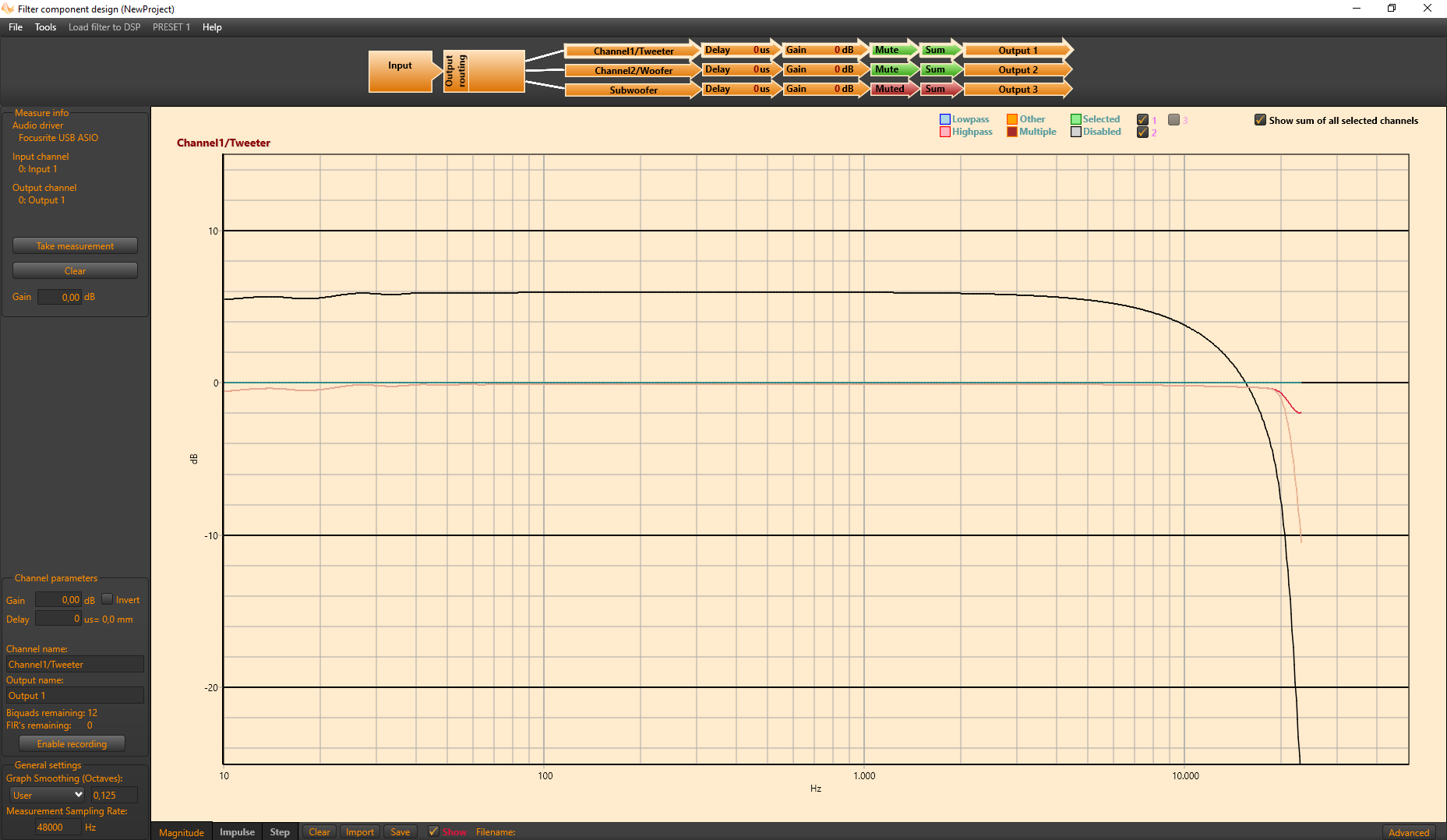

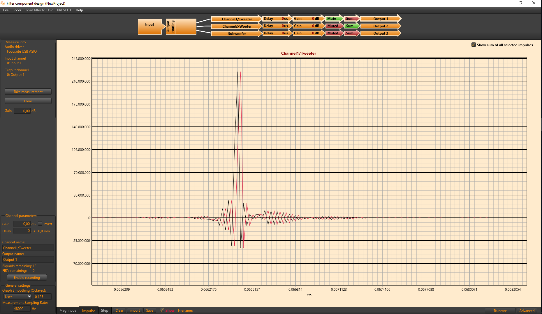

Two loopback measurements with the Scarlett:
https://www.diyaudio.com/forums/attachment.php?attachmentid=735582&stc=1&d=1549870611
When you do let's say 10 measurements 1 is correct. With the Focusrite ASIO driver it's more worse.
https://www.diyaudio.com/forums/att...tting-fusion-amp-3-step-step-meetverschil-png

I discovered this when I made new measurements of my 3 way system with the Scarlett.
When I made new filtersettings I got unrealistic delay settings, like the mid was shifted fisically 30 cm forward and the tweeter to the rear.
I think the XMOS chip is the culprit, so validation of the measurement setup will be a important part in the manual.
