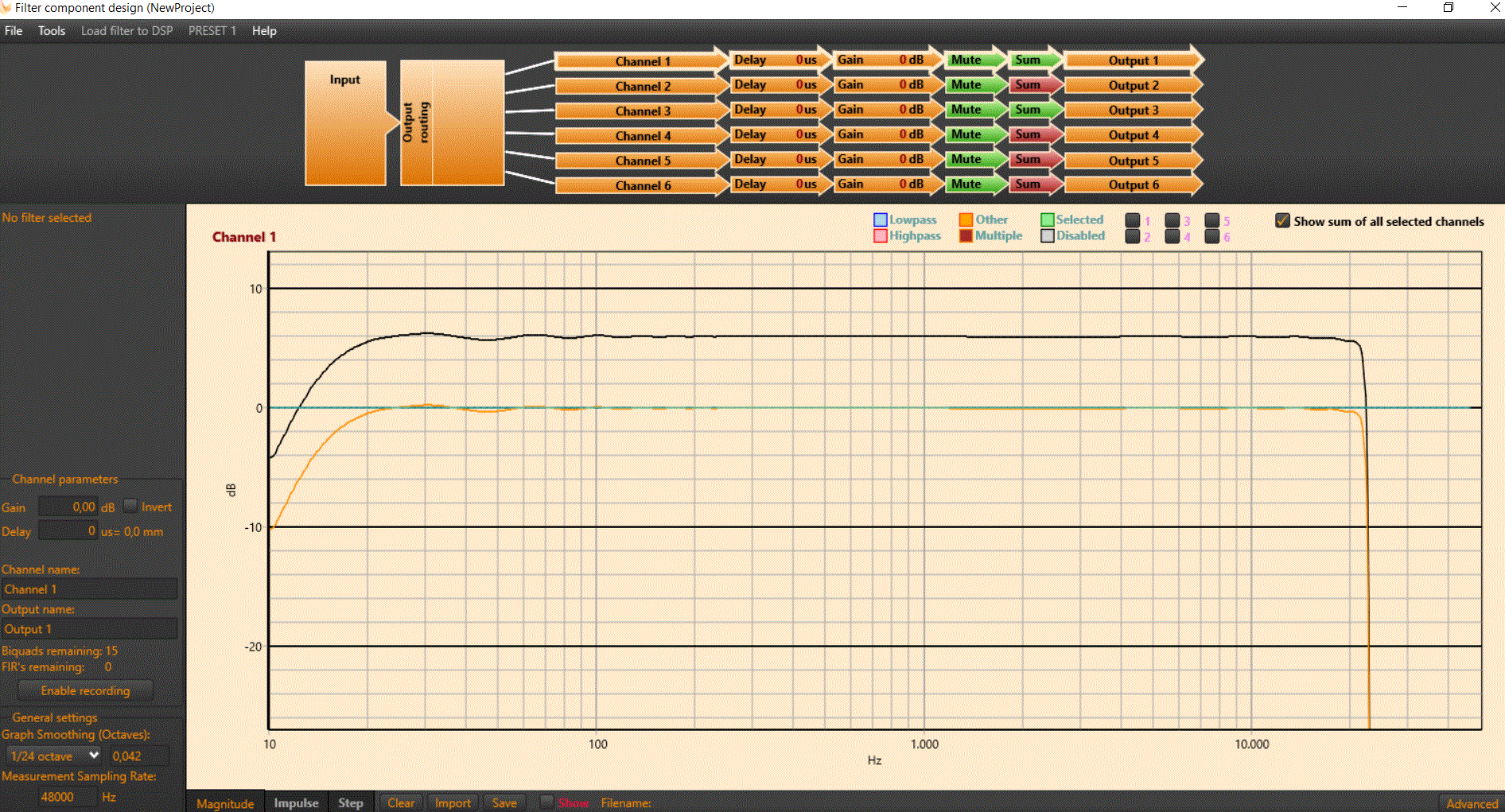

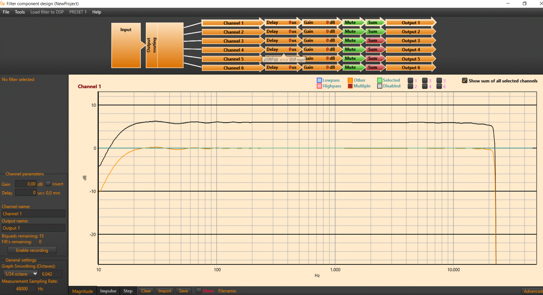

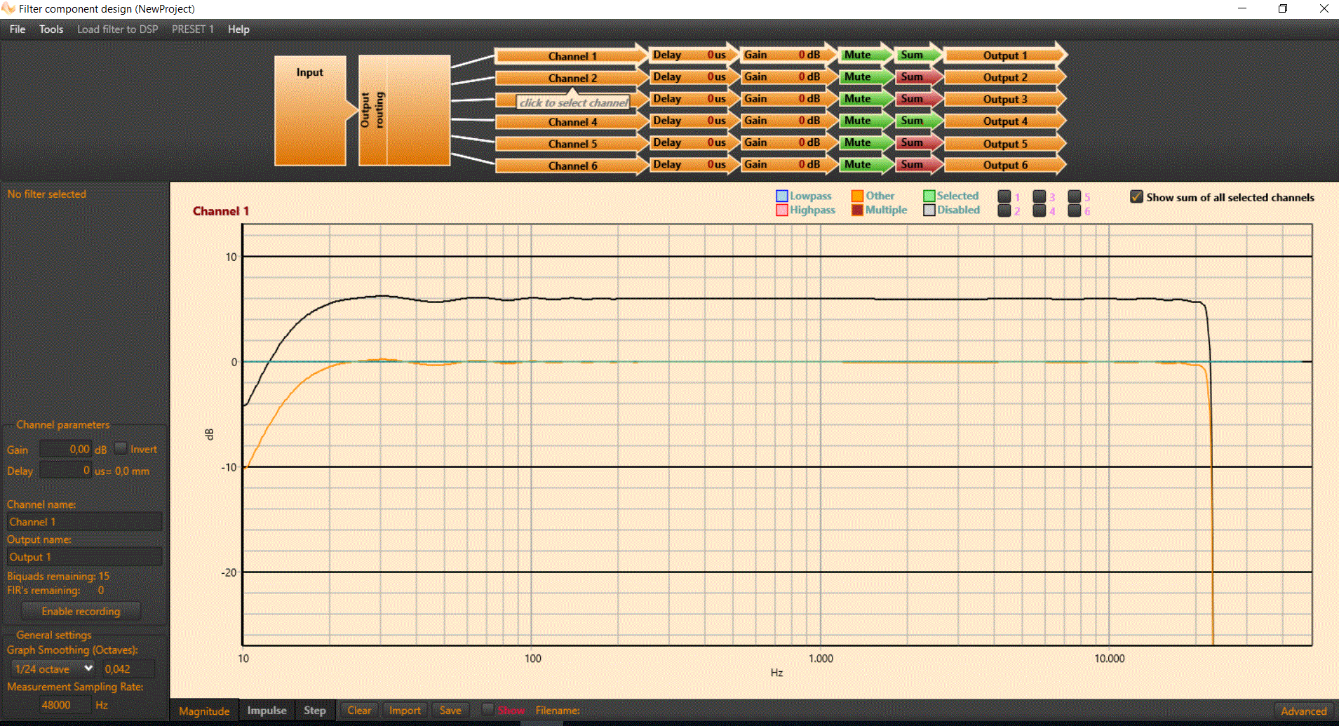

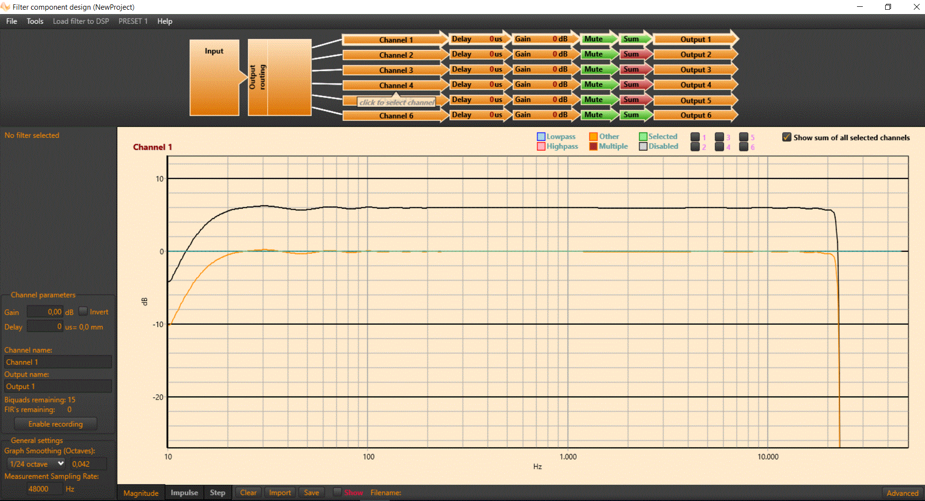

I played a bit more with this, at 96khz, waiting a few minutes between measurements, redoing only one channel. The error is either small (about 10µs delay) or absolutely 0 (perfect overlap of the impulses).
Asio4all gives me the same behavior. Somewhat random results, either no delay or a 10µs one. That's weird. I also noticed that HFD will output completely off results if I click to soon on "sum" after taking a measurement.
I wish HFD provided the option to autocalibrate in real time by using a loopback on a second channel. Iirc, there was a logiciel (not a freeware) that did that but the name escapes me.

When you make measurements in HFD you also register the offset of the drivers. To do this correctly you need exact timing between the input and output. This only garanteed with a usb souncard/mic preamp which share the same clock. If you use an Umik, this relation does not exist and the simulated responces will be wrong.
