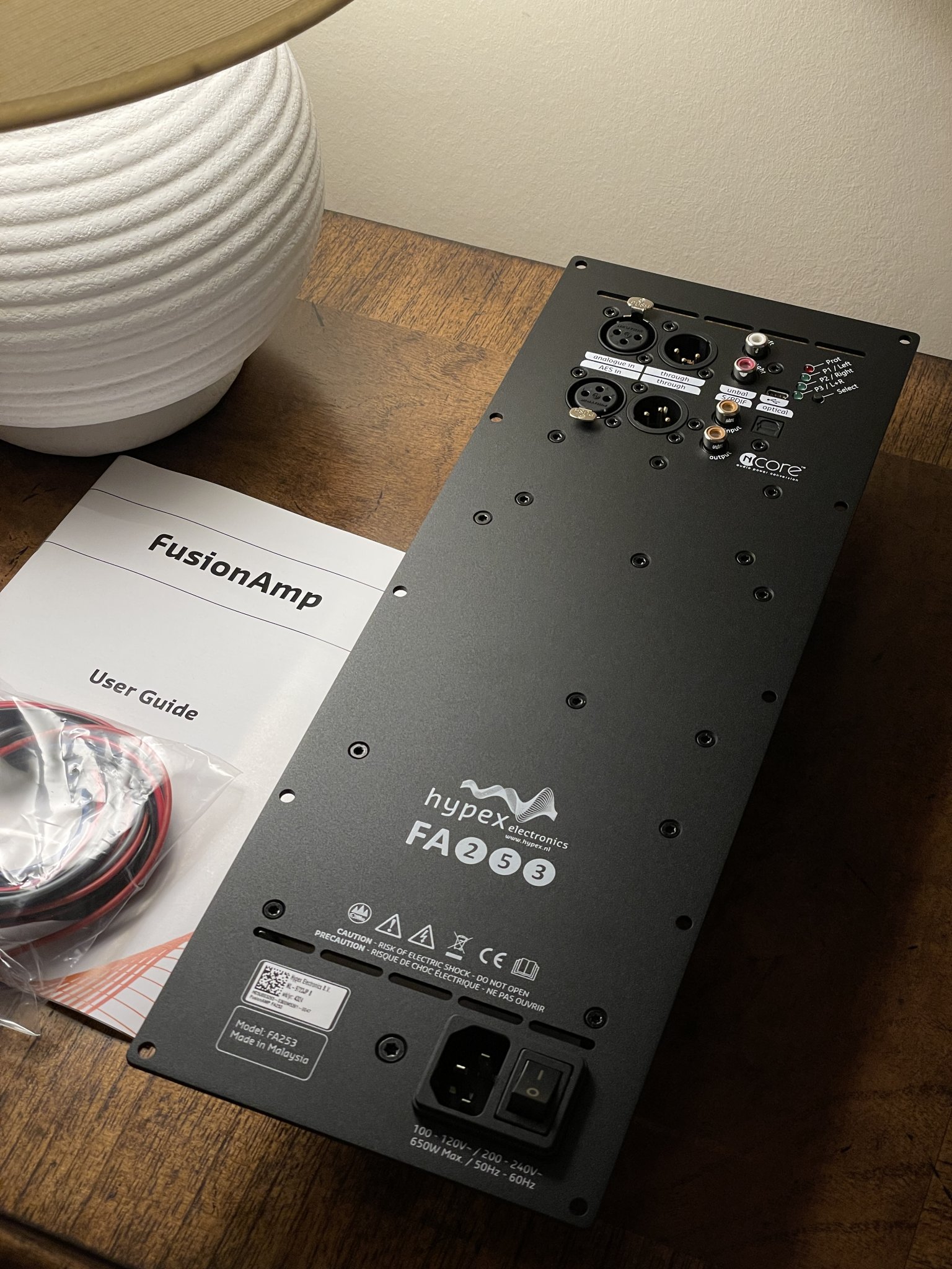

First impressions: very compact, surprisingly light. Build quality is good.
Note: No USB or power cable included (only the driver connection cables).
Nope. Hypex not recognised by HFD. Windows said USB device could not be installed when I first connected it. Bummer!
