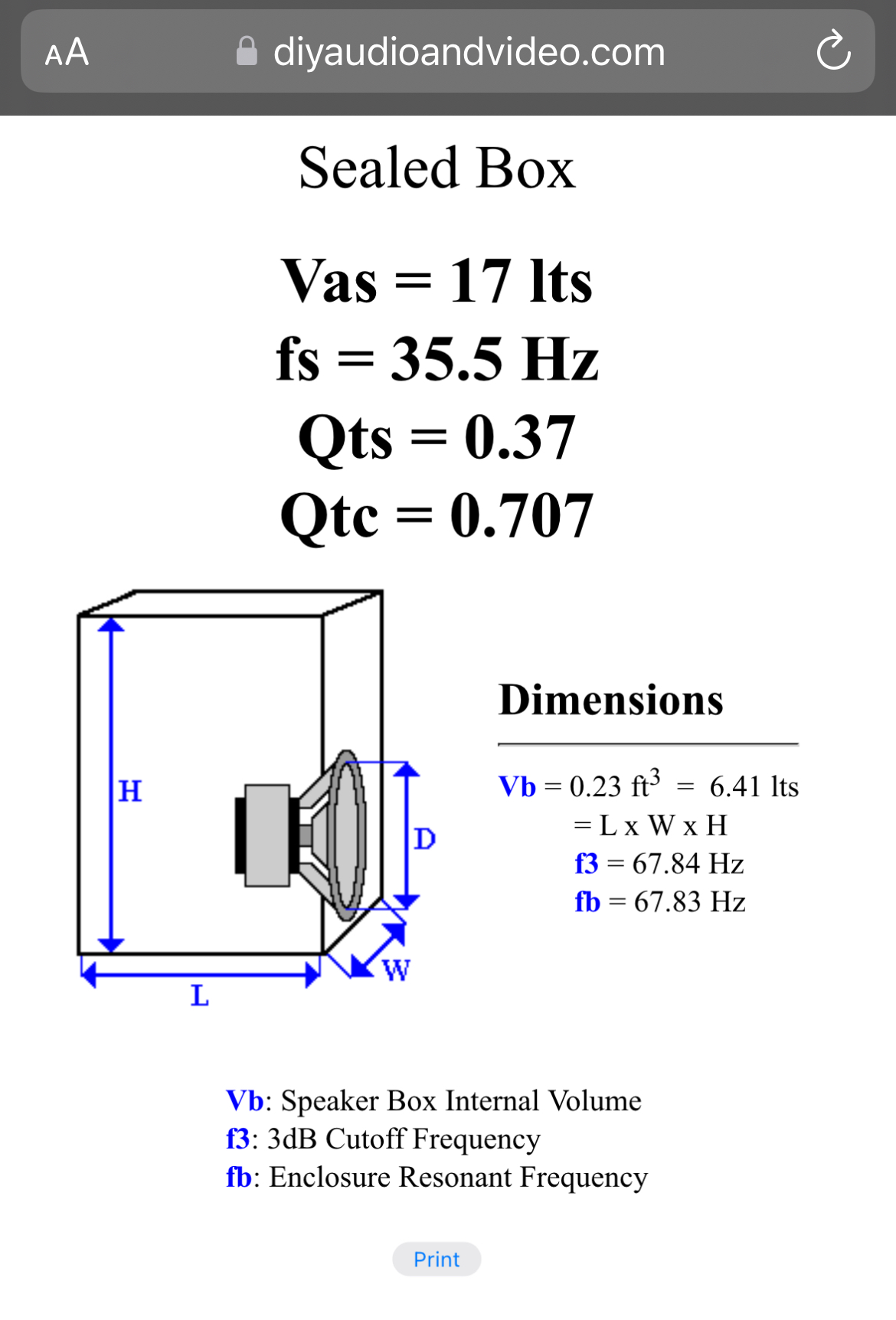

If I calculate the box based on the Dayton Epique 5.5in, I get this:
So to use 2 drivers I have to double the volume.
But what will be the f3 for two drivers?
Thank you!

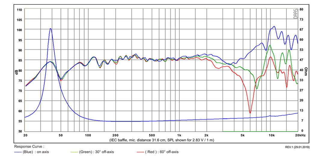

now, looking for achievable low extension, I get this:
How does the 30Hz potential here relates to the f3 of only 72hz in the above calc?
How do I practically achieve 30hz if it seems possible based on xmax and size?
If you use a PC, download Vituixcad2 and use the Enclosure tool to calculate all tha data; you can use WinISD too.

You will use DSP which allows you to compensate for the drop or surge of the frequency response of the speaker at its resonance frequency, this allows you to reduce the requirements for Qts, Fs and Vas. Simply put, the lack of volume of the box is easily compensated for by frequency correction using DSP, as long as the speaker can withstand the necessary power to correct its frequency response.I have looked at other 5.5in woofers but they all need much larger box for their Qts, Fs and Vas

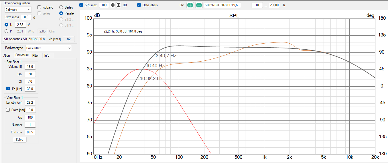

If you have 20L, this are two sb15nbac-8 in parallel; tuning frequency is 38Hz (vent 6x23cm)To clarify current thinking for the drivers per channel (in step 2):

I was planning closed box, with hopefully lower volume requirement. I may struggle to get 20L. How much smaller a closed box would be?
I would use a port if I am forced to by some consideration.

This was the thinkng that lead me to the Epiques. I thought I can push them to 40-30hz at reasonsble spl as they have high power and xmax spec, way higher than any other 5in I could find. They also have way lower box vol requirement. But I am not sure if my thinking is right.You will use DSP which allows you to compensate for the drop or surge of the frequency response of the speaker at its resonance frequency, this allows you to reduce the requirements for Qts, Fs and Vas. Simply put, the lack of volume of the box is easily compensated for by frequency correction using DSP, as long as the speaker can withstand the necessary power to correct its frequency response.

two sb15nbac-8 give me 12.82L, which I may achieve in my box.

You also don't have to stick to the Qtb=0.707, because you will use some equalisation anyway. Having lower Qtb will slightly reduce the required low frequency boost and power and thus thermal voice coil stress.
Again, you will equalise the bass drivers anyway, so the main limiting factor for sealed enclosures is the max displacement volume (Sd*Xmax) and eventually the max. thermal power that will limit your low frequency output, irrespective of actual driver response in the box.simulate a pair of the 5.5in epiques in 6-12L closed box and help me to compare vs the SB?
