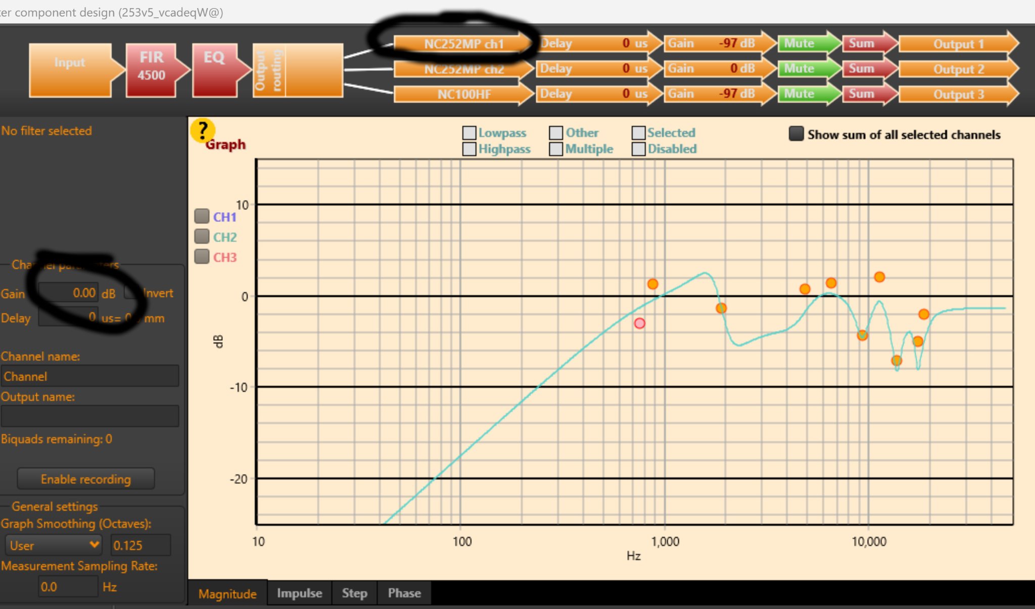

Question: to align the level between the the three drivers (due to sensitivity difference) do I do that using filters in each channel, or using the overall EQ?
I think it is filters per channel.
For crossover I plan to use LR 4th order. Not too sure why. Which in HFD means adding two identical 2nd order lowpass/high-pass. Right?
You don't use filters, there is a gain for each driver. Just click on the driver (at the top) and the gain is on the left side. You will see the number for each on the summary at the top. It is probably 0db now.
Yes.
Yes.
