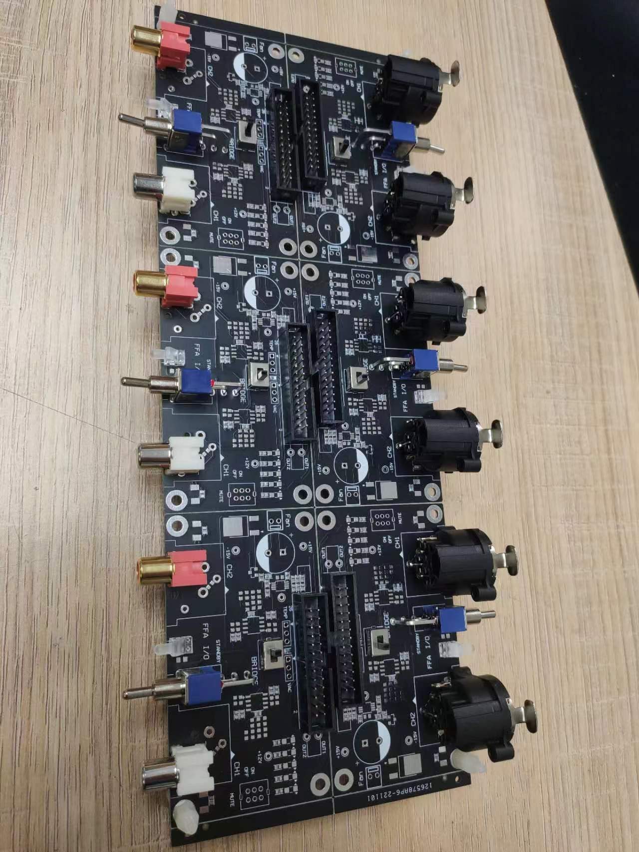

Hello Friends,
You'll soon own this I/O buffer for the FFA amp module, let's make a poll here, which one do you need, RCA or XLR? I thank you for your kind input.
And, we may sell the "TypeC to RCA" and "Lighting to RCA" cables too, if you need.
Thanks,Eric
Looking good, Eric, your response time is amazing. Only question, why is the switch in the middle of the input connectors? I hope you do not mind honest criticism, I, for one, would have to reach a finger in there between the "Y" end of the RCA cable pair to turn it on. Now don't get me wrong, them gyals go loud with my finger
In my case, I don't want a rear mounted switch, so doesn't really make a difference. My I make a recommendation, consider the merit of the switch being fitted to a JST or similar with a bit of ribbon for front or rear insertion

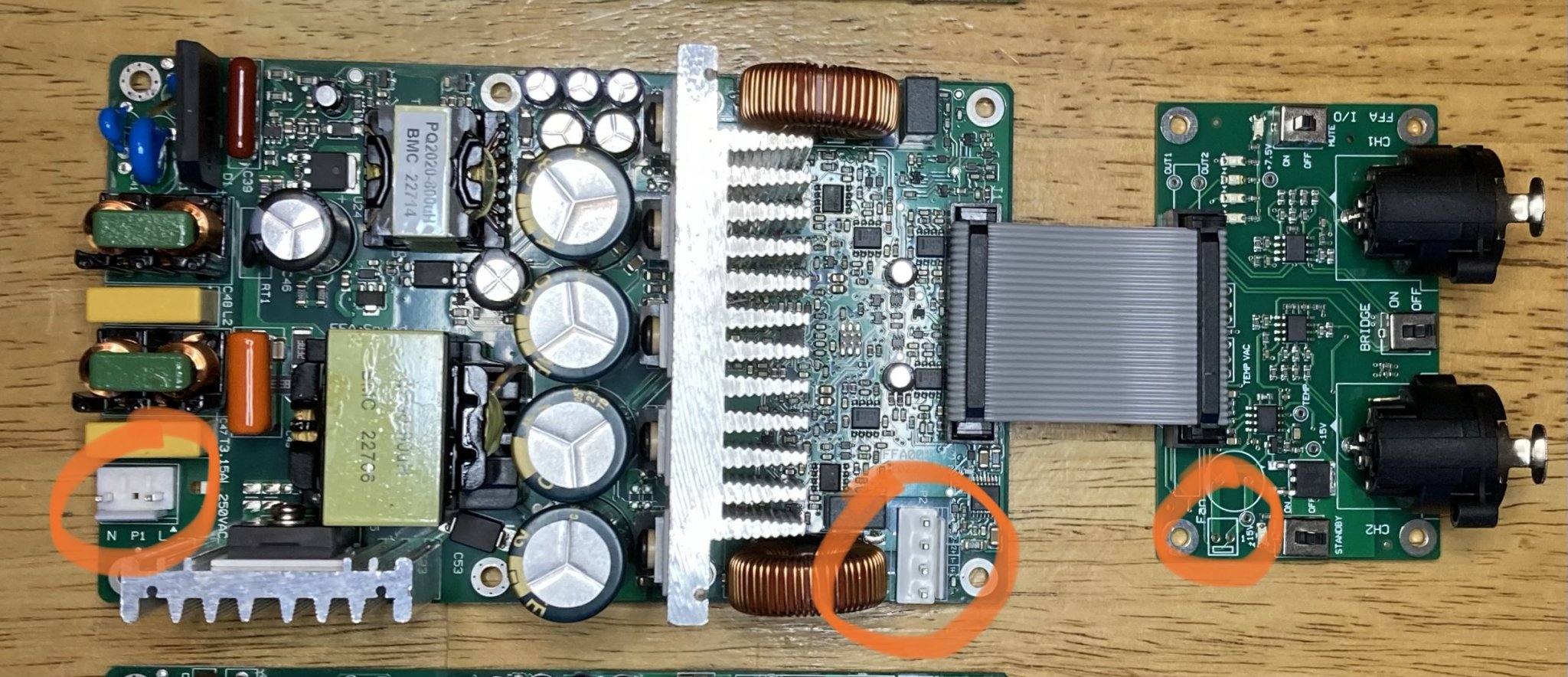

Eric (or others who can readily tell), can you provide specifications for the three connectors highlighted in the attached picture (i.e., connector/pin/terminal type and pitch)?
I want to minimize ordering the wrong things. I’d rather not solder to these pins and want to be able to easily disconnect the fan(s).

Hi, Randy
Your comments are always welcome. I appreciate your inputs.
Put the toggle switch between the two input jacks, that's my design philosophy with symmetrical looking for the rear panel 😀 laughing here.
And, with the field experiment, the toggle SW will not interfere with input cables.
But, your suggestion is excellent, put the JST or similar wafer parallel with this SW, and DIYer can route it in the front panel.
Thanks,Eric

Hi, Von
If you need it, the I/O buffers are all free for you, only need the shipping charging,
Try to google the "VH3.96 -4Y" for the amp output connector, it's 4pin,3.96mm pitch wafer. I also can provide you the mating cables for this wafer, sorry for missing them in your delivery.
Thanks,Eric
Eric,
I may go with both and make the rear panel removable on my case so I can change if I want (I will be purchasing FFA003 modules). I will probably unsolder switch and mount mine on front of case.
Bill
Hi, Bill
Thanks for your continuous support.
Like Randy's suggestion, I'll parallel the wafer with this toggle switch to let it easily re-wired to front panel at FFA003 IO buffer.
Thanks,Eric

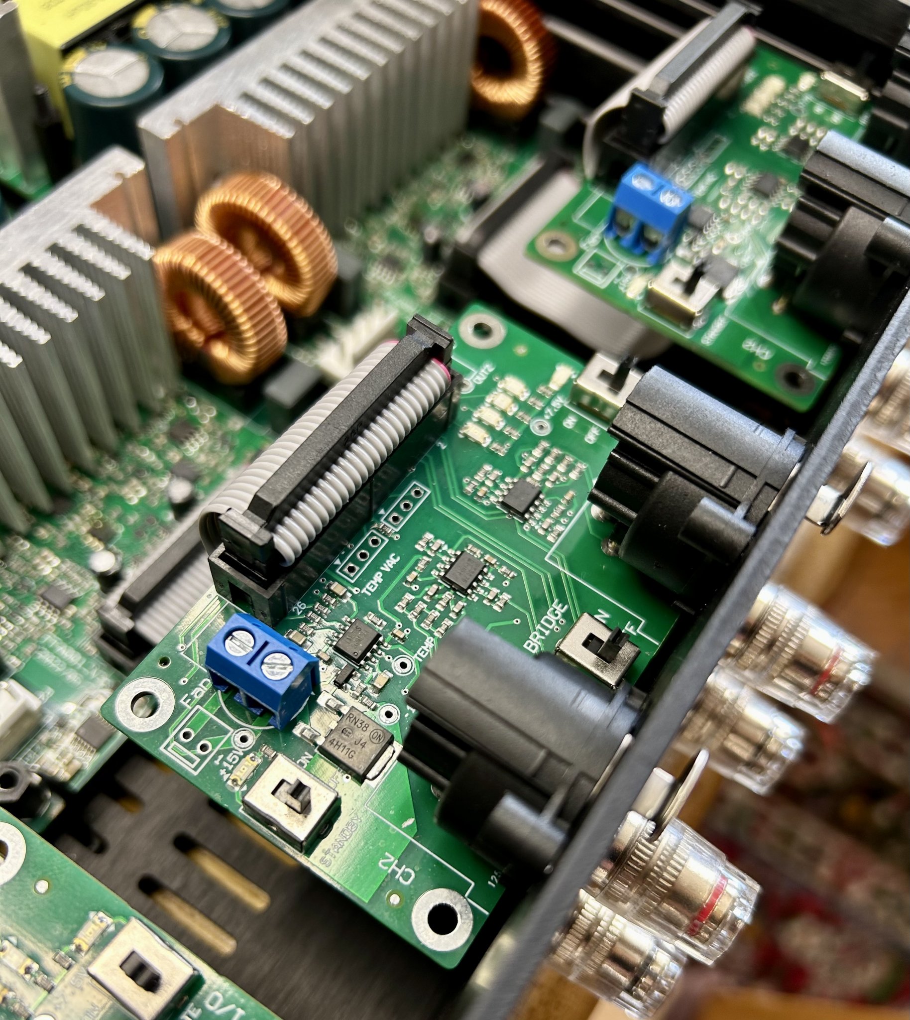

Thanks, Eric. I’ll PM you about the buffers, etc.
I discovered that I have two pin terminal blocks that will fit in the area marked “Fan,” so that has been solved.
