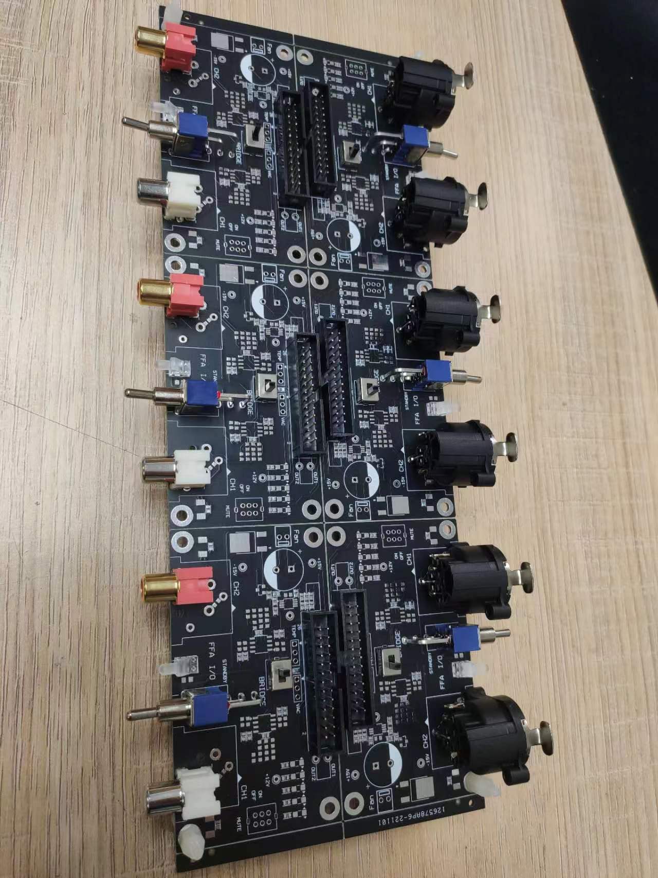

You'll soon own this I/O buffer for the FFA amp module, let's make a poll here, which one do you need, RCA or XLR? I thank you for your kind input.
And, we may sell the "TypeC to RCA" and "Lighting to RCA" cables too, if you need.
What is the function of the blue switch - bridging both channels and what happens when used with the (high/low) bi-amp module?
Could you please post a drawing with the XLR/switch coordinates for drilling the amp's backplate.

How much would it be for just the new IO board without the connectors?Personally, I can support this requirement, just let me know which type of input connectors you need to pcaked~~~

--The blue switch (toggle switch) is the standby switch. With the down-side positon, it will power off the main PSU and shutoff the +/-15V from the aux PSU, only letting the 12V_always_on alive. In this situation, the total power consumption is near 1W. You can think it as the "soft" power switch.XLR for me please.
--With high/bass version, I think there is no need the function of "bridged" sw.
--We will provide the drawing file of both I/O buffer board.

As usual, the price is no change with $5.99/ea w/o shipping.How much would it be for just the new IO board without the connectors?
The FFA003(mono) IO buffer is different with the FFA001/002 stereo module.I don’t see the big deal just unsolder the connector, it’s the same io board for both connectors.
I was wondering about that, has a different set of connectors on the board. 2 io boards for stereo? That would keep it dual mono all the way through.

Yes, each main board will have its own i/o board, and the system will be dual mono as the original plan, is that ok? I'll let you comment here.I was wondering about that, has a different set of connectors on the board. 2 io boards for stereo? That would keep it dual mono all the way through.

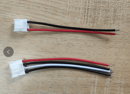

Try to google the "VH3.96 -4Y" for the amp output connector, it's 4pin,3.96mm pitch wafer. I also can provide you the mating cables for this wafer, sorry for missing them in your delivery.

Hi Eric. I hope all is progressing nicely with the amp builds. Question for the FFA-001 Ver3 do the JST B4P-VH & B3P-VH connectors come with it or do I need to get them elsewhere? Thanks.

Hey,BroHi Eric. I hope all is progressing nicely with the amp builds. Question for the FFA-001 Ver3 do the JST B4P-VH & B3P-VH connectors come with it or do I need to get them elsewhere? Thanks.
Thanks for your follow-up, I'm pushing the CM to build it asap, there should be no more surprise 🙂
And, below cables (100mm)will be free of charge and packed with the module.
