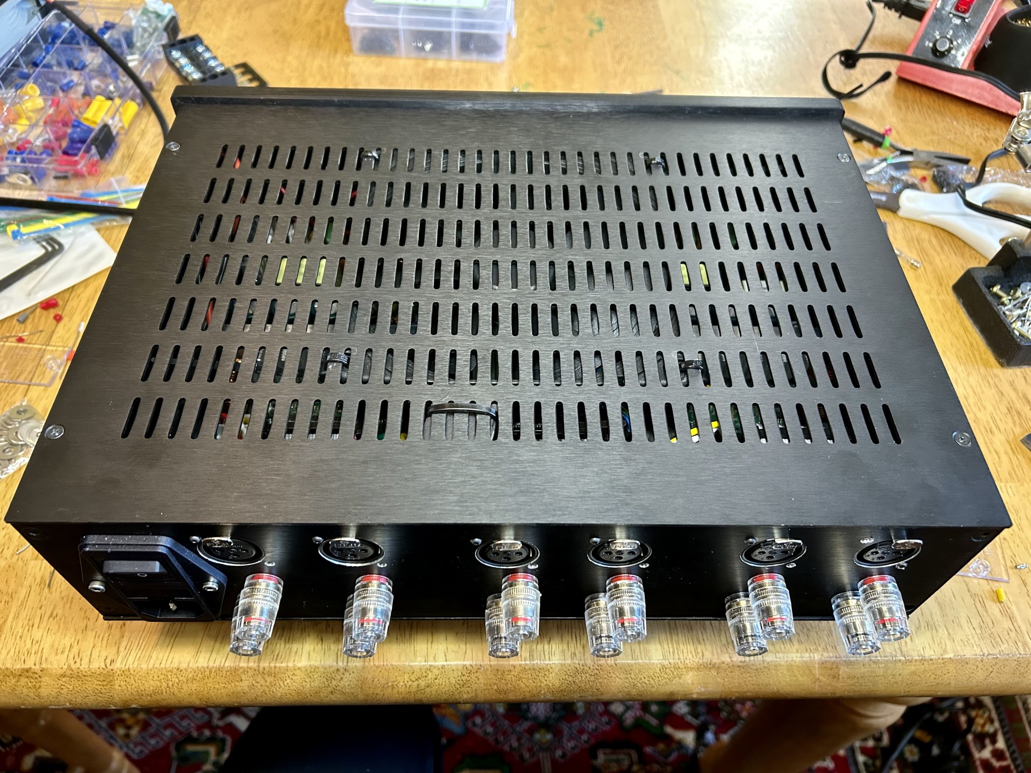

I’ve buttoned up my 6-channel amp and have been running it nonstop with just two channels for a couple days. My chassis is fully vented top and bottom. There is perceivable warm air exiting the top, but it is nothing to be concerned about. I tried a few ways of incorporating fans in the chassis, but they either were too loud (the input module has ~20VDC out from the ‘fan’ points), or when slowed down with a DC-DC buck converter produced electrical noise in the output. Keeping it simple for home use (no fans) works best for me.
For the record, I tried inexpensive 24v fans, a 140mm 12V Noctua, and a 140mm 24v Noctua.
The amp sounds great and has plenty of power. The intended use for 3-way DSP crossovers will happen in the near future.

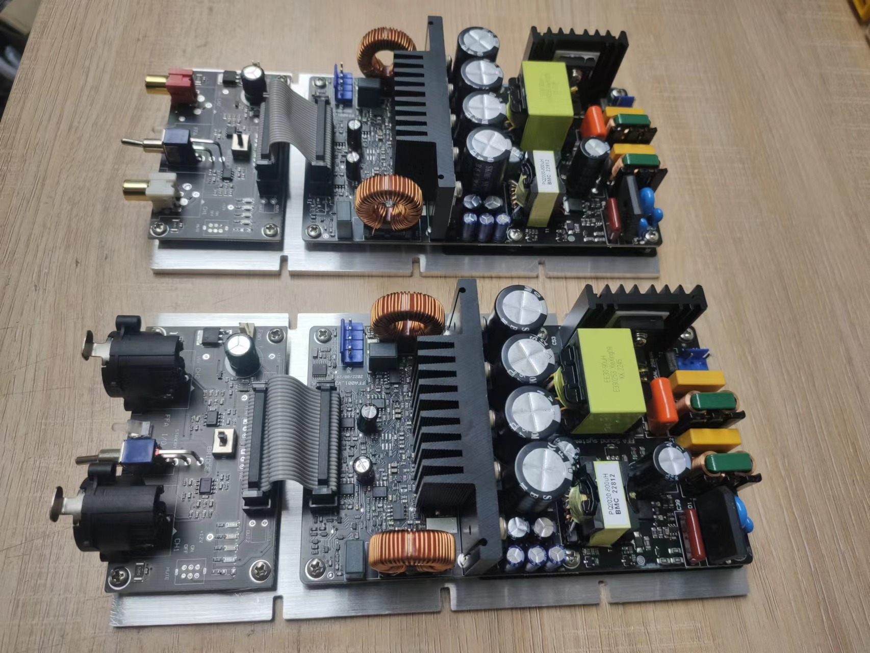

Hello dear friends.
FFA001_V3 new build is ready, welcome to place order. We have XLR and RCA input in this new I/O buffer, please PM me for your detail requirments.
Thanks all for your kindly support.
