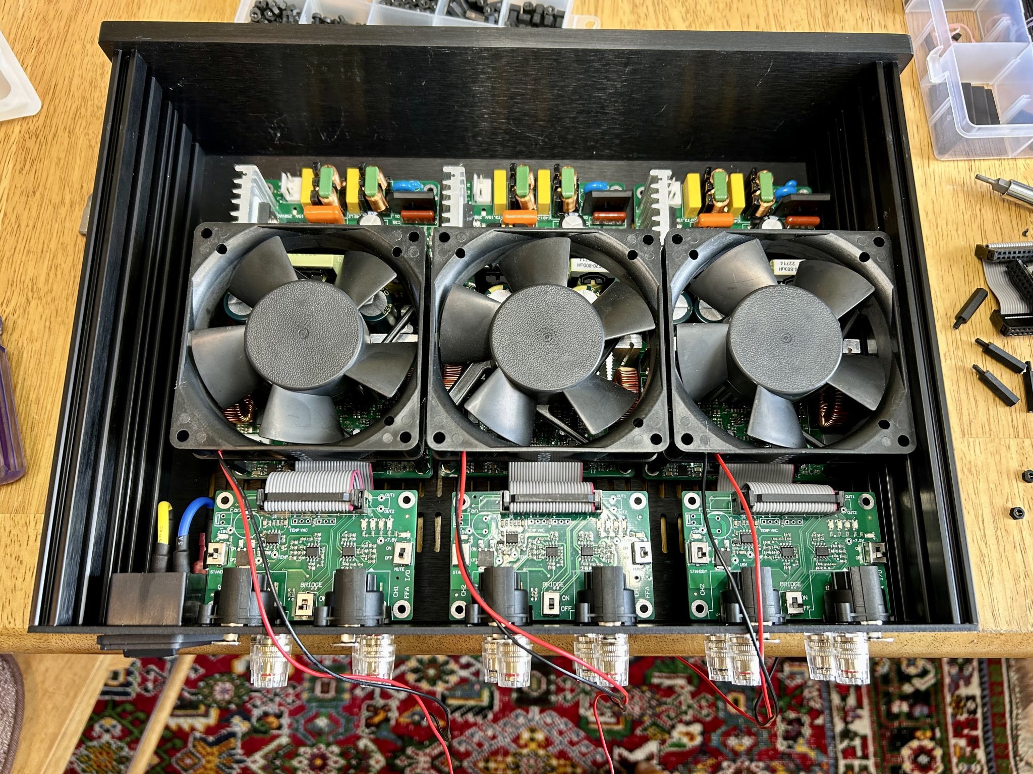

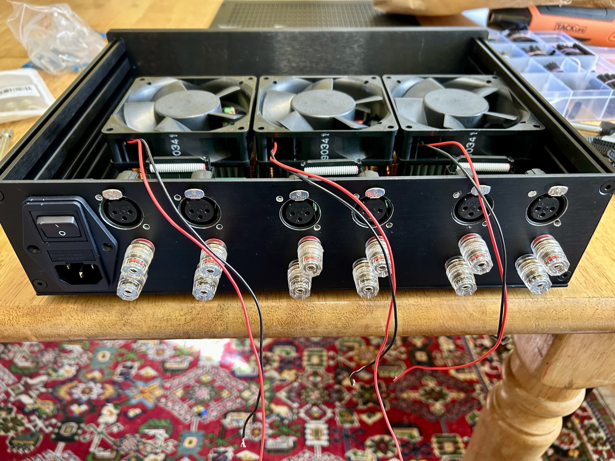

It’s not pretty or exact millwork, but I’m getting there. I need M2(?) screws and nuts for the Neutrik input jacks, and connector headers for the mains inputs and speaker outputs…
