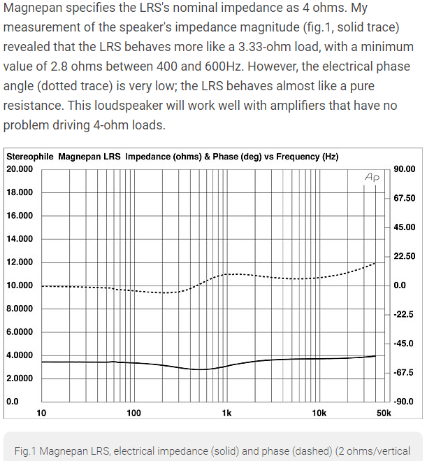

Hi Eric and thank you very much for responding to my questions! My memory was off just a bit, as the minimum dip is 2.8 ohms and not 2.2 ohms. The averaged load is 3.3 ohms, but there is little change in the phase, so "a resistive load" I believe is the term. Here is the chart/measurements from JA/Stereophile on this speaker (I hope I am allowed to show giving proper credit?):
Based on the above, would this amp or the FFA02/03 amps be suitable?
Thank you again - David

Thanks for your update. Based on this, I'll recommend you try the FFA003 module. But the Cons. is, it's just the mono output.
Thanks,
Eric

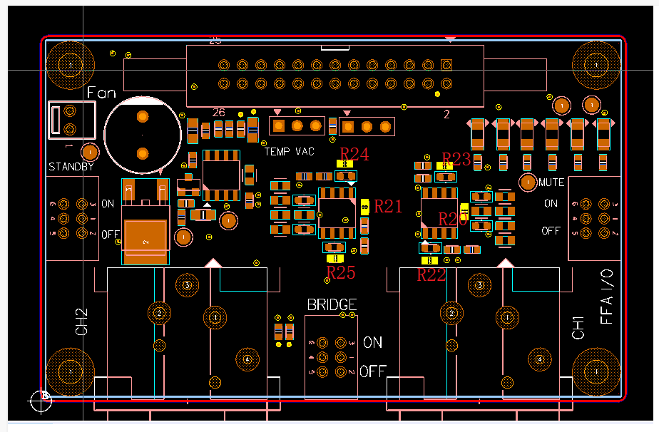

Hi, FrankEric can you tell us which resistors to change to reduce the gain of the amp?
Check below pic of the I/O board.
Currently R22=R23=R24 =R25=2.49K, R20=R21=4.99K。
And the Gain =1+ (2x R24)/R21; same for the other channel.
So, you need to change the R20 or R21 to adjust the gain of the corresponding channel.
Thanks,Eric
And, Based on the above equation, there is not much room to reduce the gain.🤣Hi, Frank

In my case the gain worked out well for me, the dac I was using it on had low output. I would hope the future boards were dialed back a little on gain.
Hi, BillIn my case the gain worked out well for me, the dac I was using it on had low output. I would hope the future boards were dialed back a little on gain.
Thanks for your feedback, unluckily, we got all the PCB ready now. May think to add a volume pot next time for a better use scenario.
Thanks,Eric
No big deal I can just make some small fixed attenuators if need be. Since I will be switching between amps I may need to do that to get their output close to each other.
