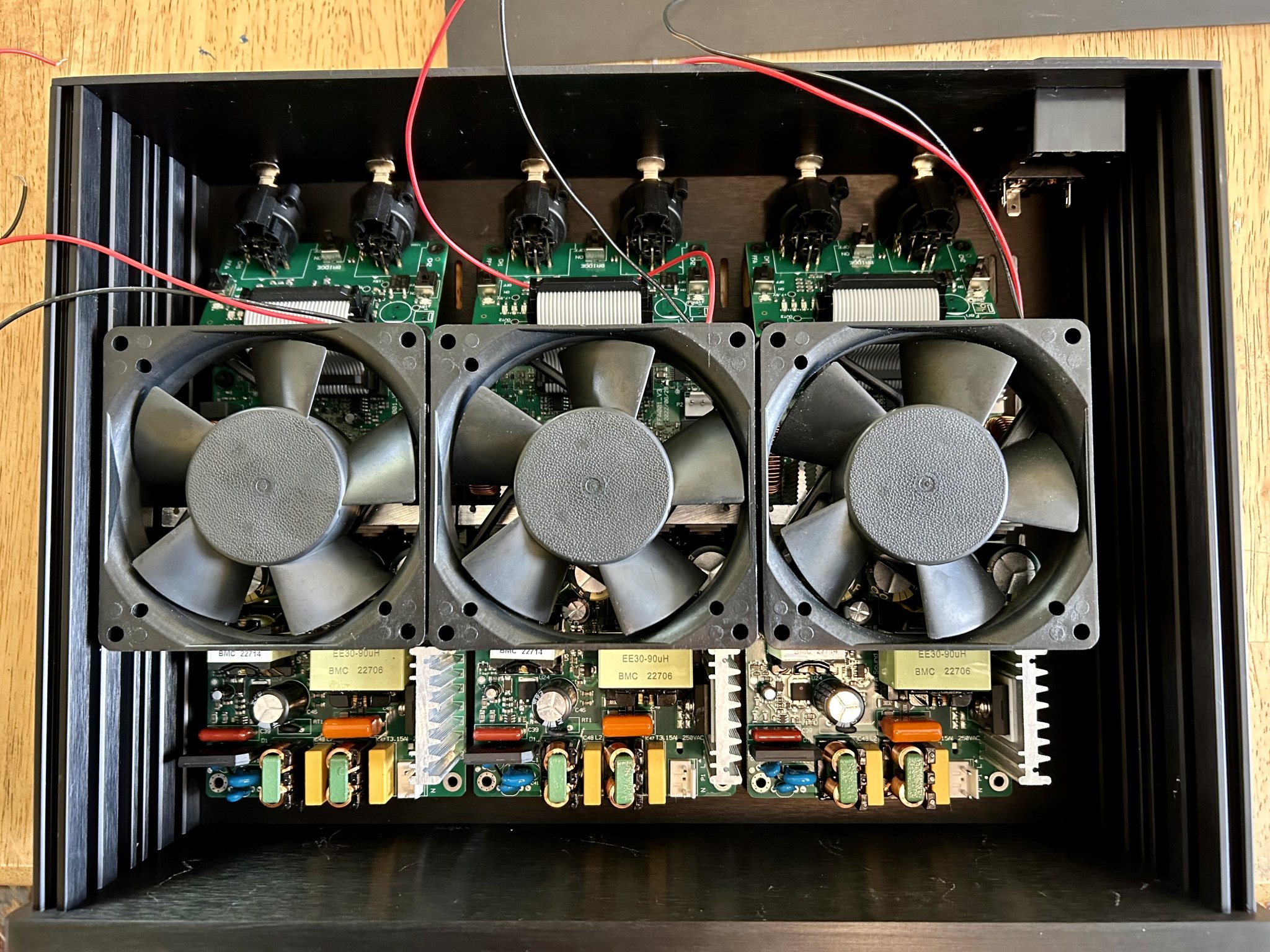

I’m slowly progressing on my build. Test fit with fans in the chassis looks good! These inexpensive 24V fans fit perfectly over the PCB holes with standoffs. Just enough room for soft mounting of the fans with o-rings… I’m hoping running them under powered will keep them relatively silent.

Thanks @von Ah for the reply. I'm hoping @Erica.C will answer/recommend what route I should take. That is your HT 6-amp assembly, right? Looks really good - and I build PCs and undervolting works well with the right fans to significantly reduce noise. Just look out for any fan harmonics caused by slight variations in the rpm's that multiple units might create...
Thanks for that recommendation. I confess I thought about PC building when I took that picture. I've built a few PCs for my kids over the past several years and enjoy that, too. A point of clarification, though -- this build is strictly for 2-channel music listening. Six-channel amplifier for 3-way stereo crossover work.
I'll be tinkering with crossovers forever, now.

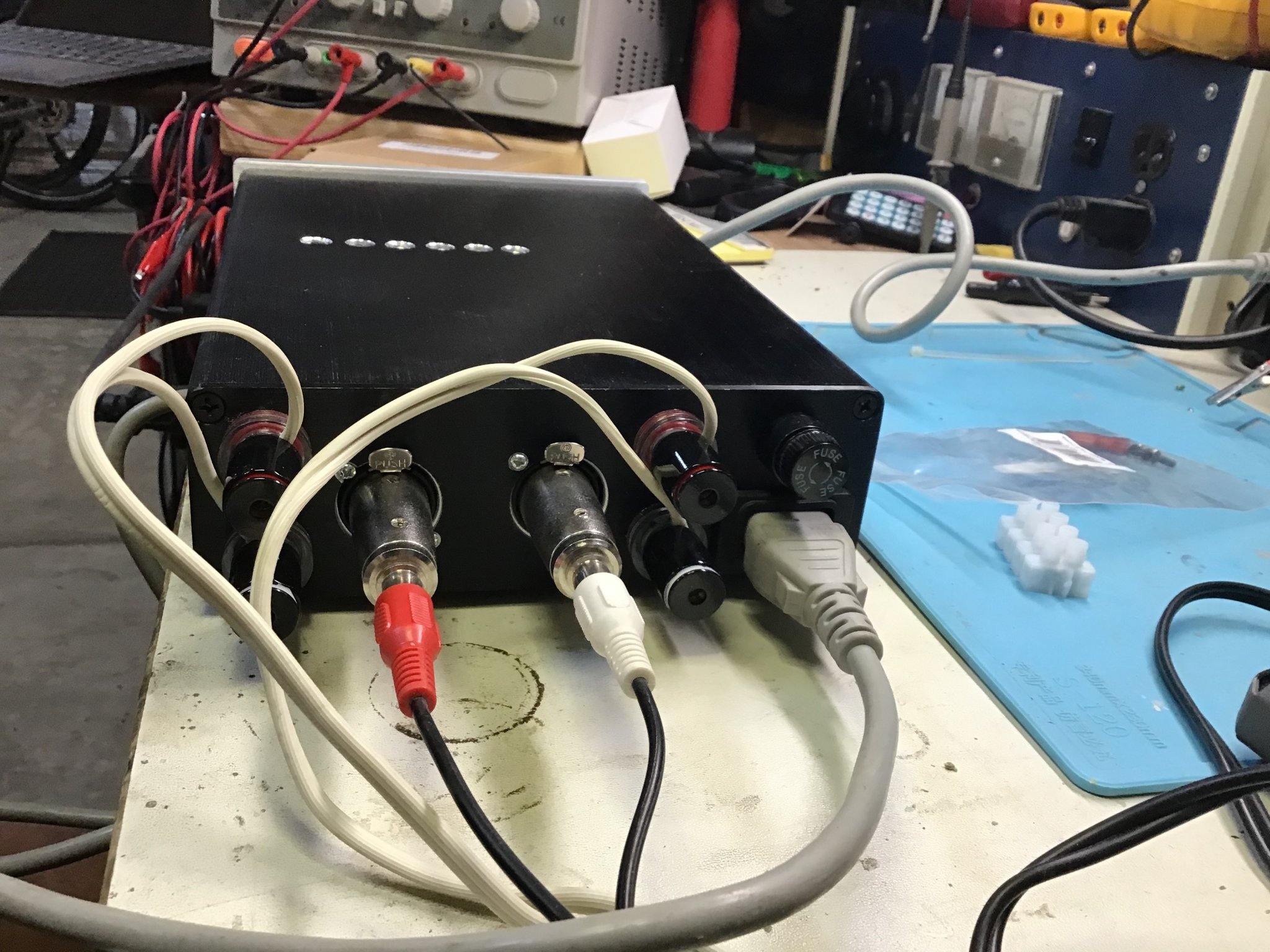

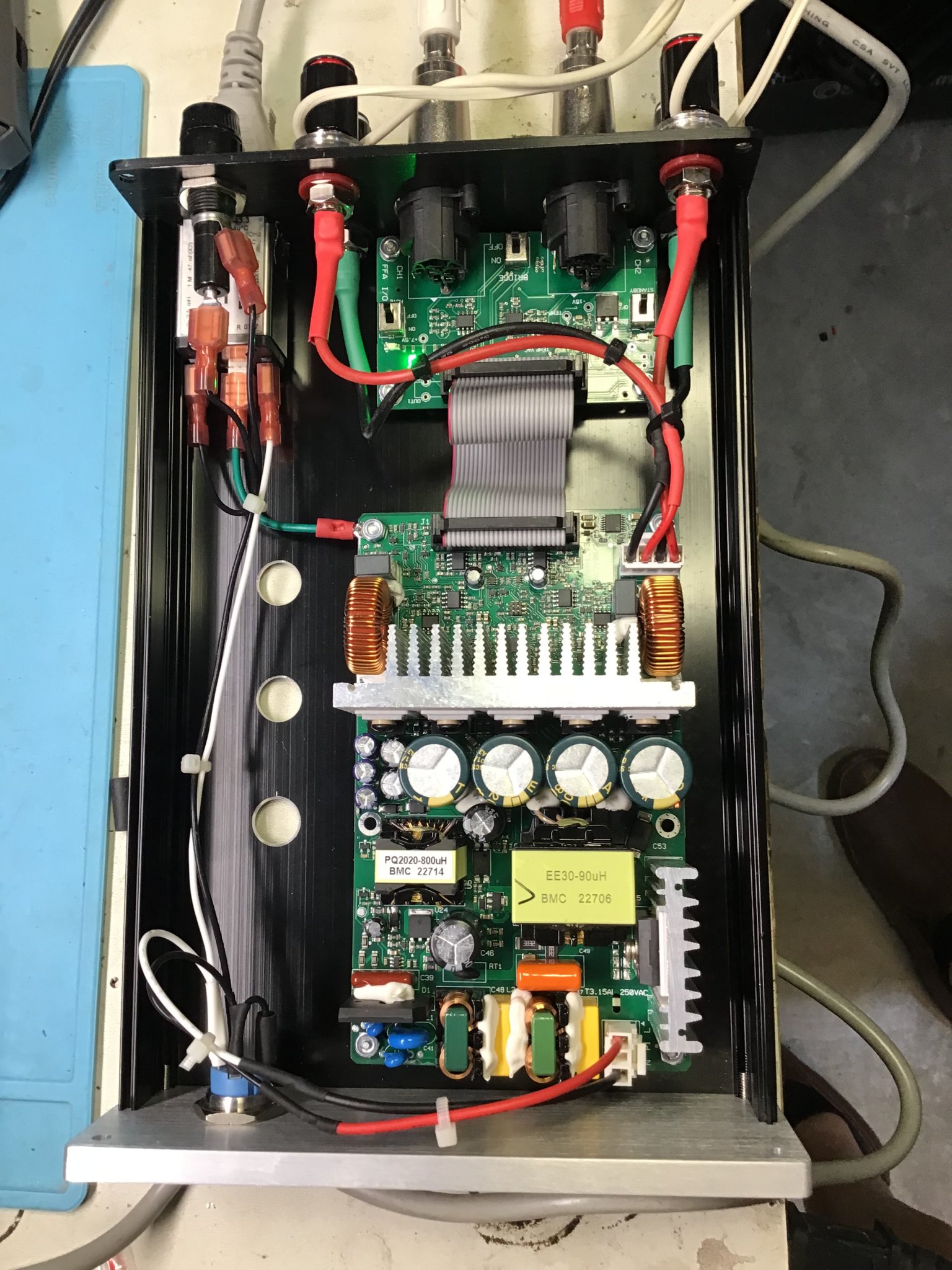

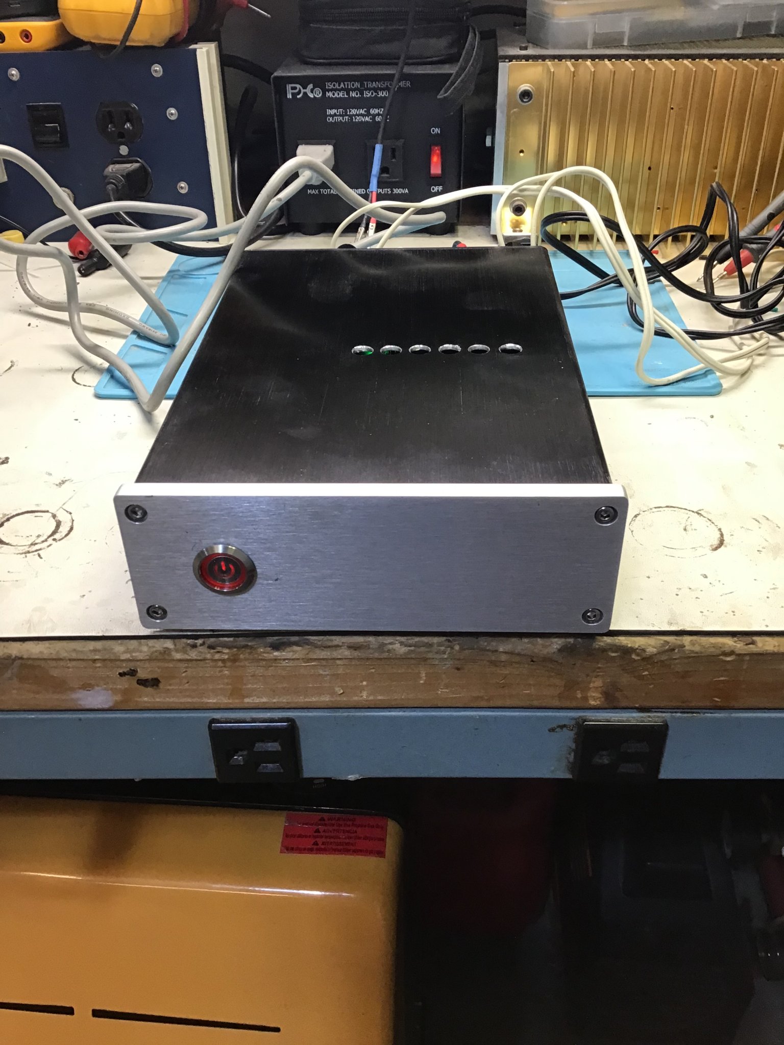

Very nice and tidy. Well doneIt was a little tight in the back but I tucked it into a 170 X 250 X 60 case.
