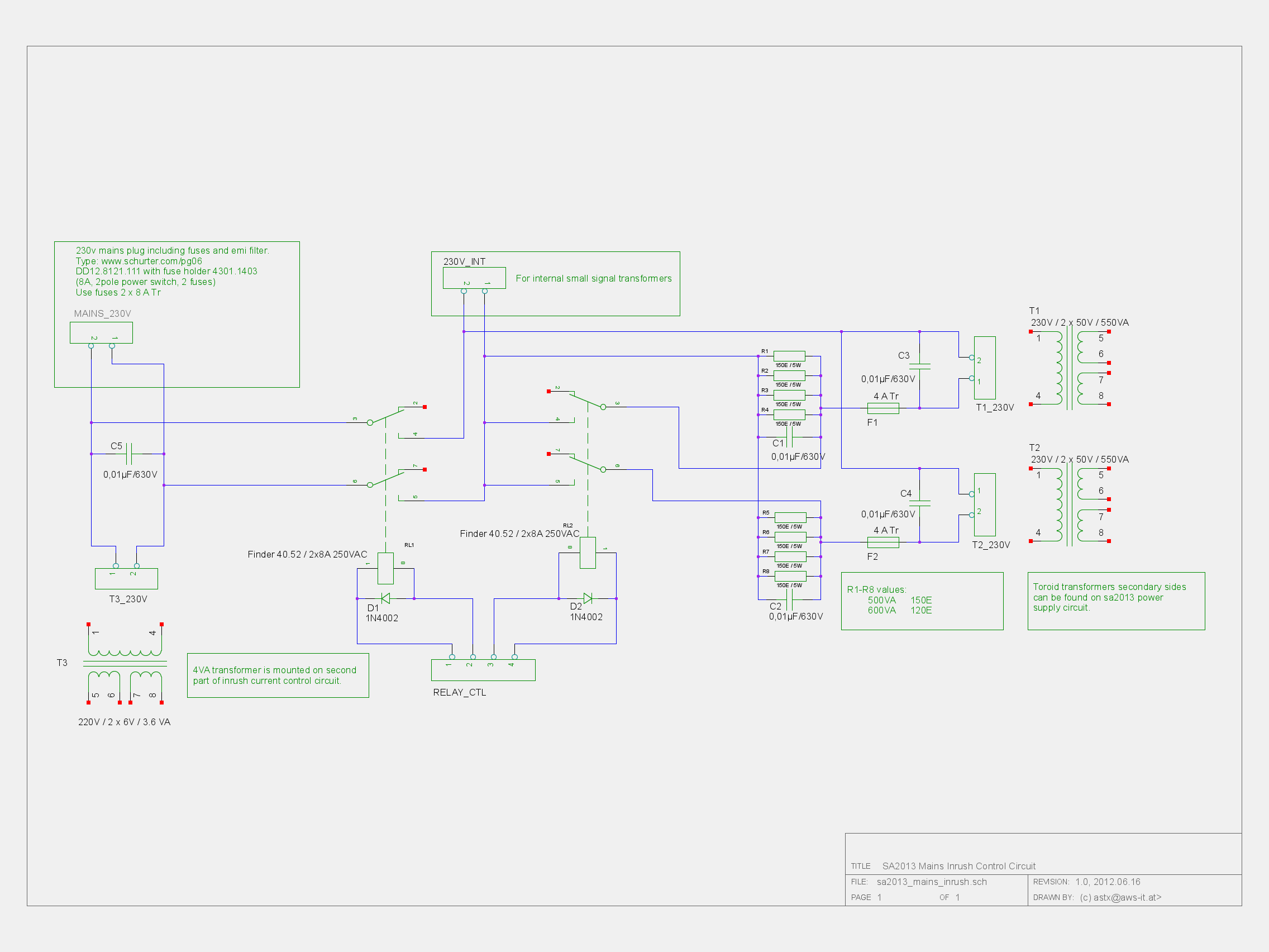

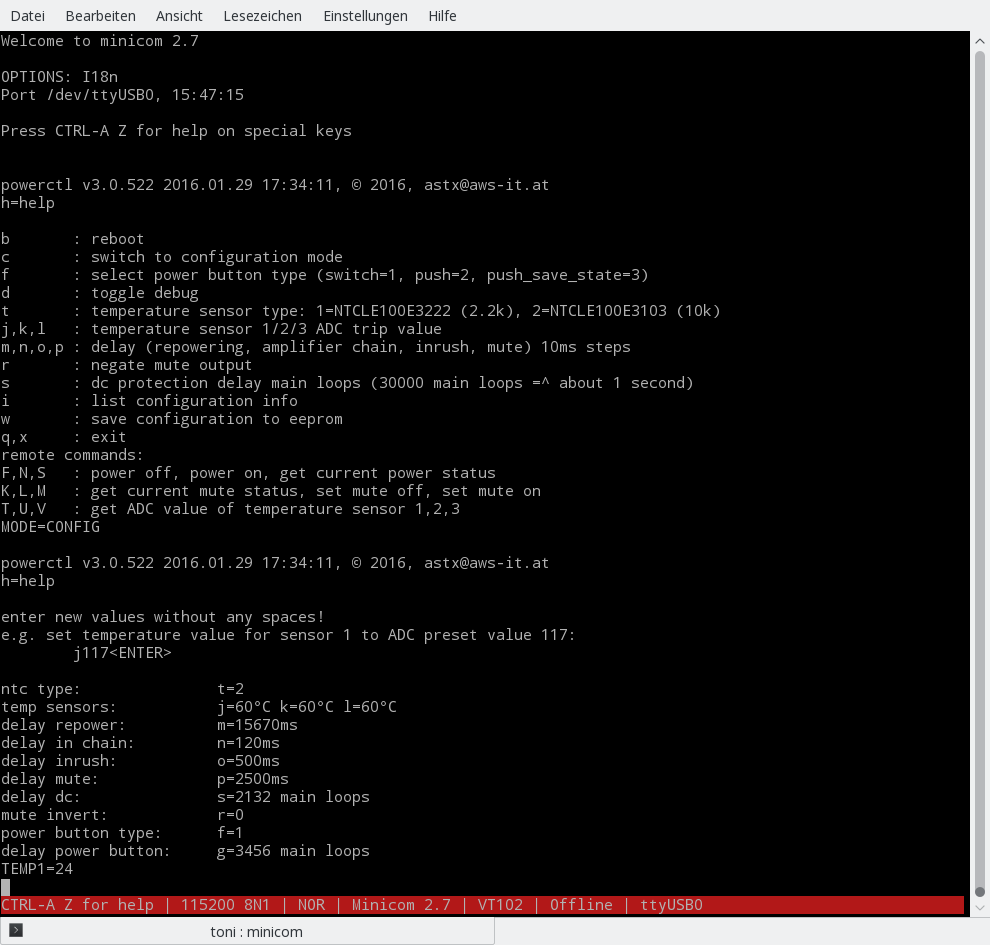

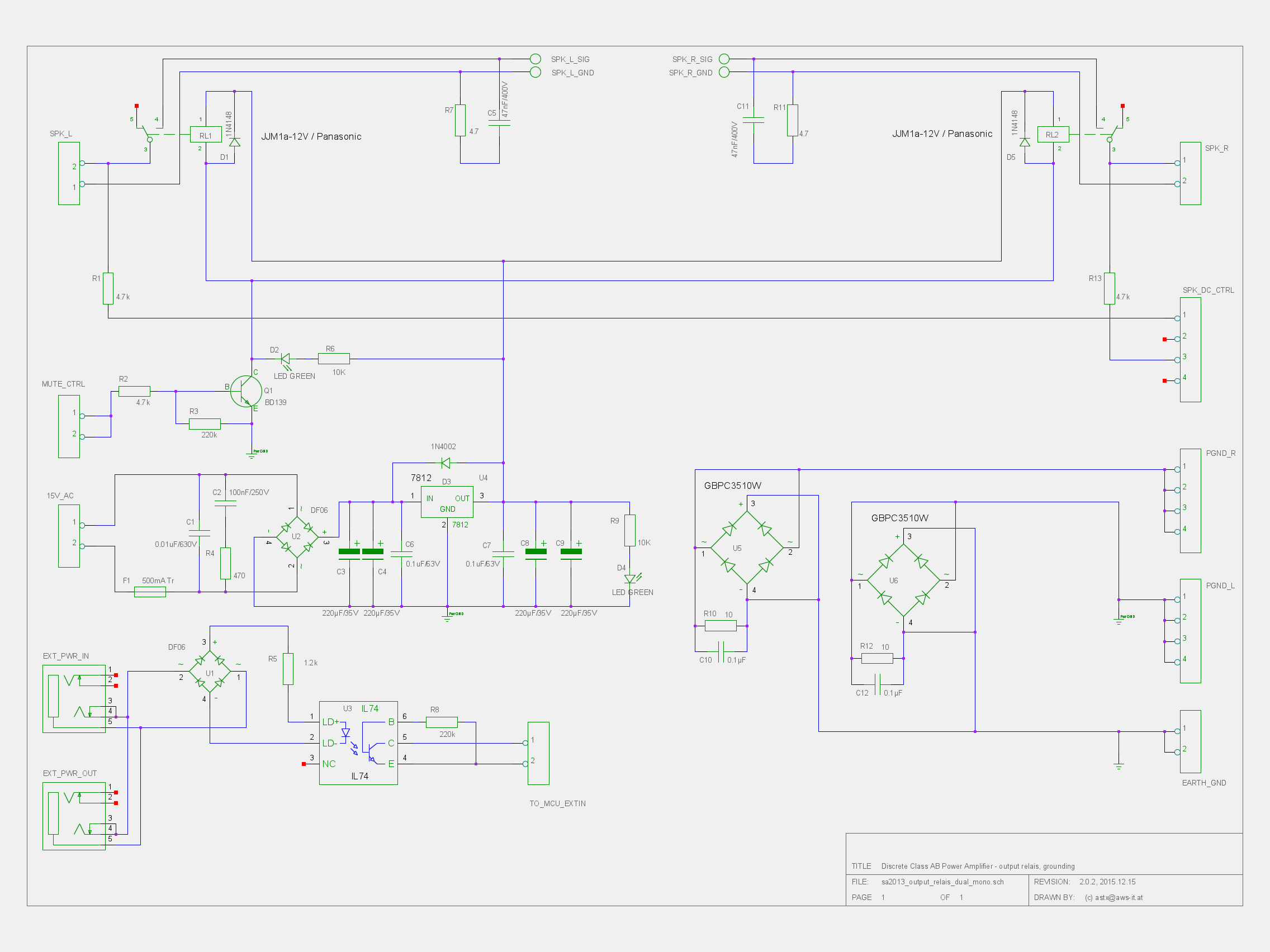

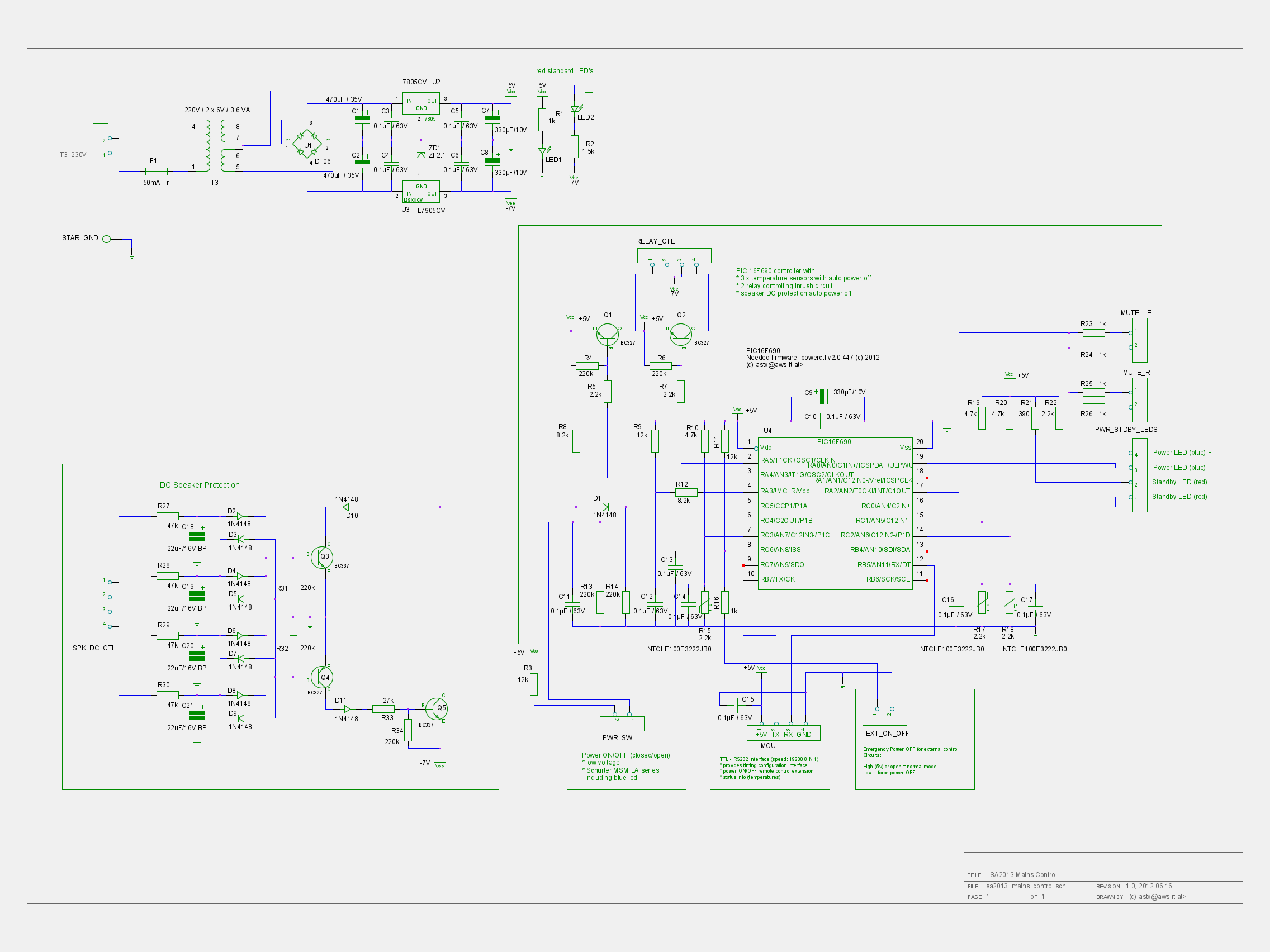

SA2013, SA2014, SA2015 housekeeping circuits
PIC16F690 has been replaced by PIC16F1829 and needs firmware 3.x or higher. Used NTC can be selected in Software: either 2.2k or 10k
WARNING: these circuit are using very high AC voltages and is therefore very dangerous and can be lethal. I am not responsible for any costs, damage and/or injury using these schematics. Do not use this schematics if you do not have the necessary experience and knowledge.
Schematics are free to use only for non commercial DIY projects. The used microcontroller needs a special firmware which is currently non free and not public available.
Have fun, Toni

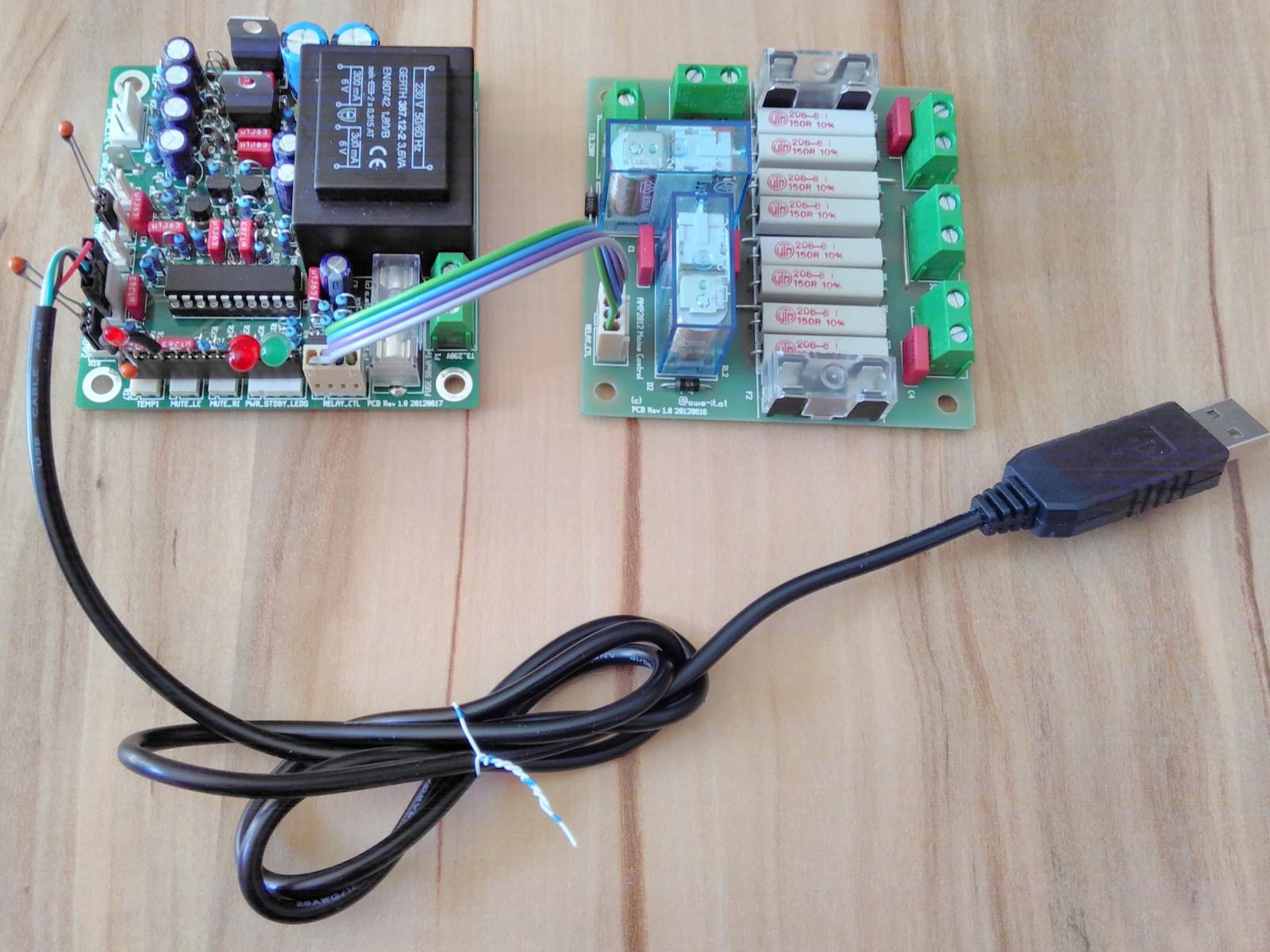

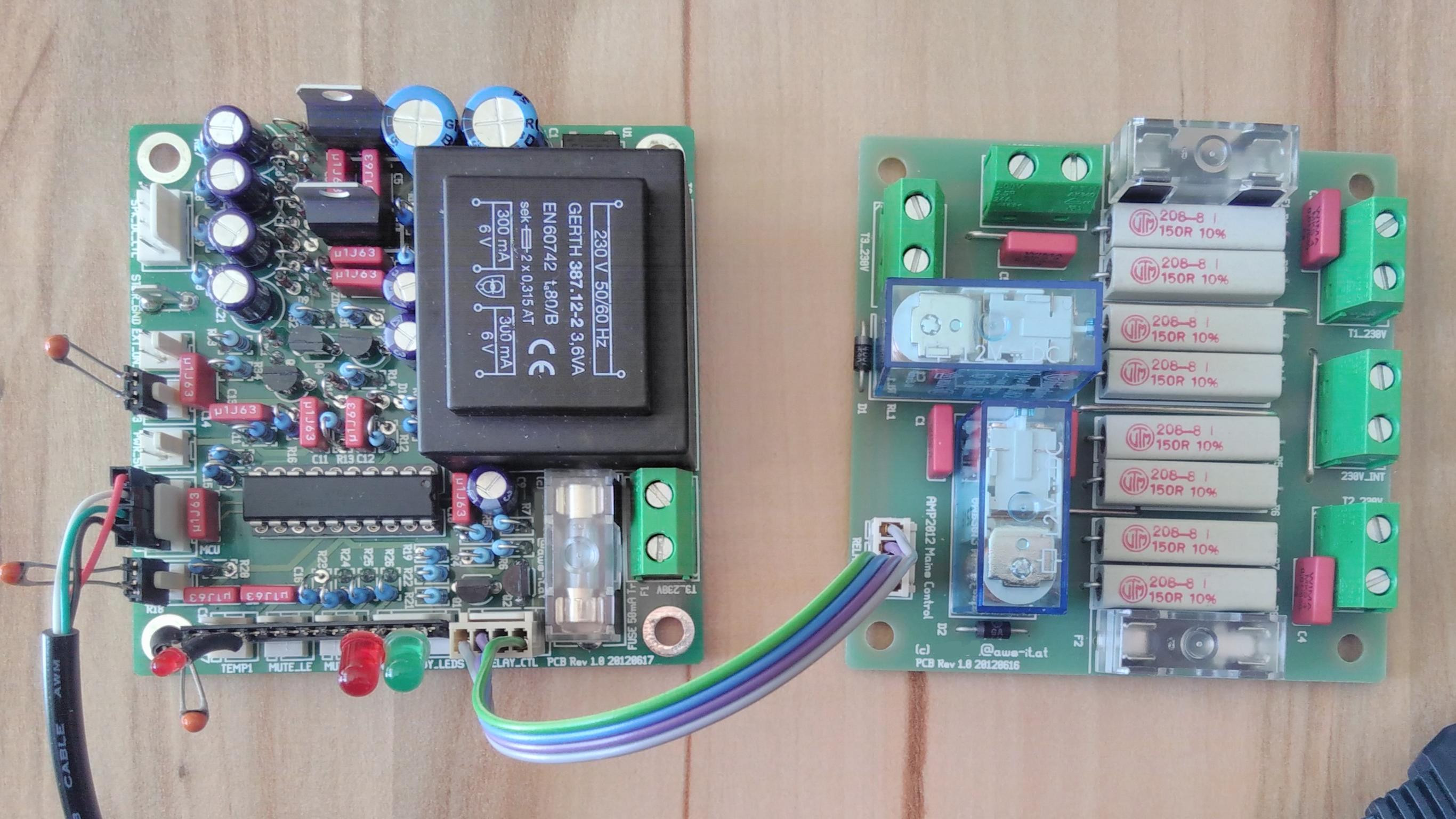

Some pictures of my development sample (you can see some leds and ntc attached for testing)
For configuration you need an
Have fun!
Toni
- USB2RS232 serial adapter with TTL level output. You can get such adapters for below 10 $ or 10 EUR.
- and a terminal program:
- Windows: Hyperterminal
- Linux: minicom
Toni

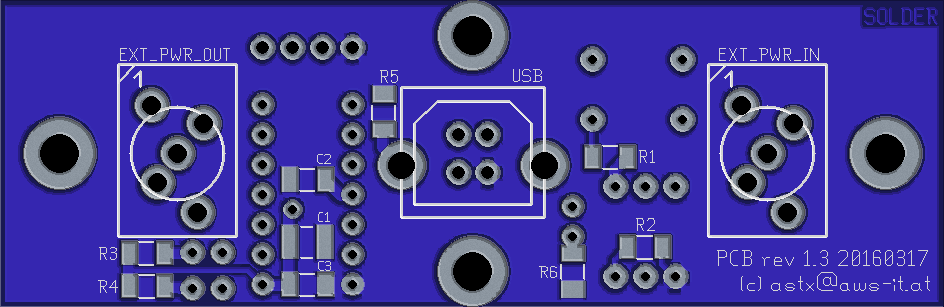

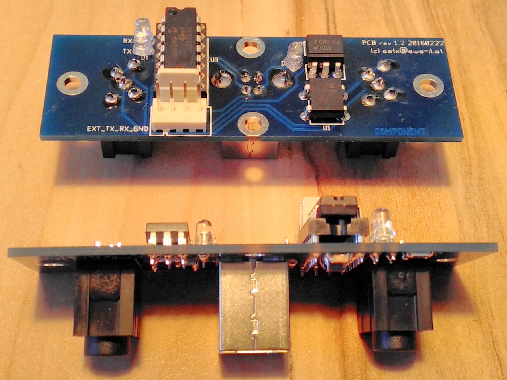

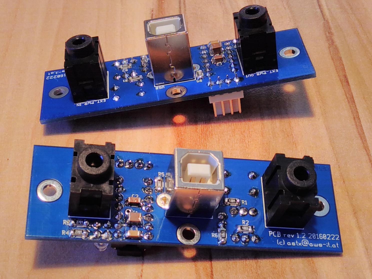

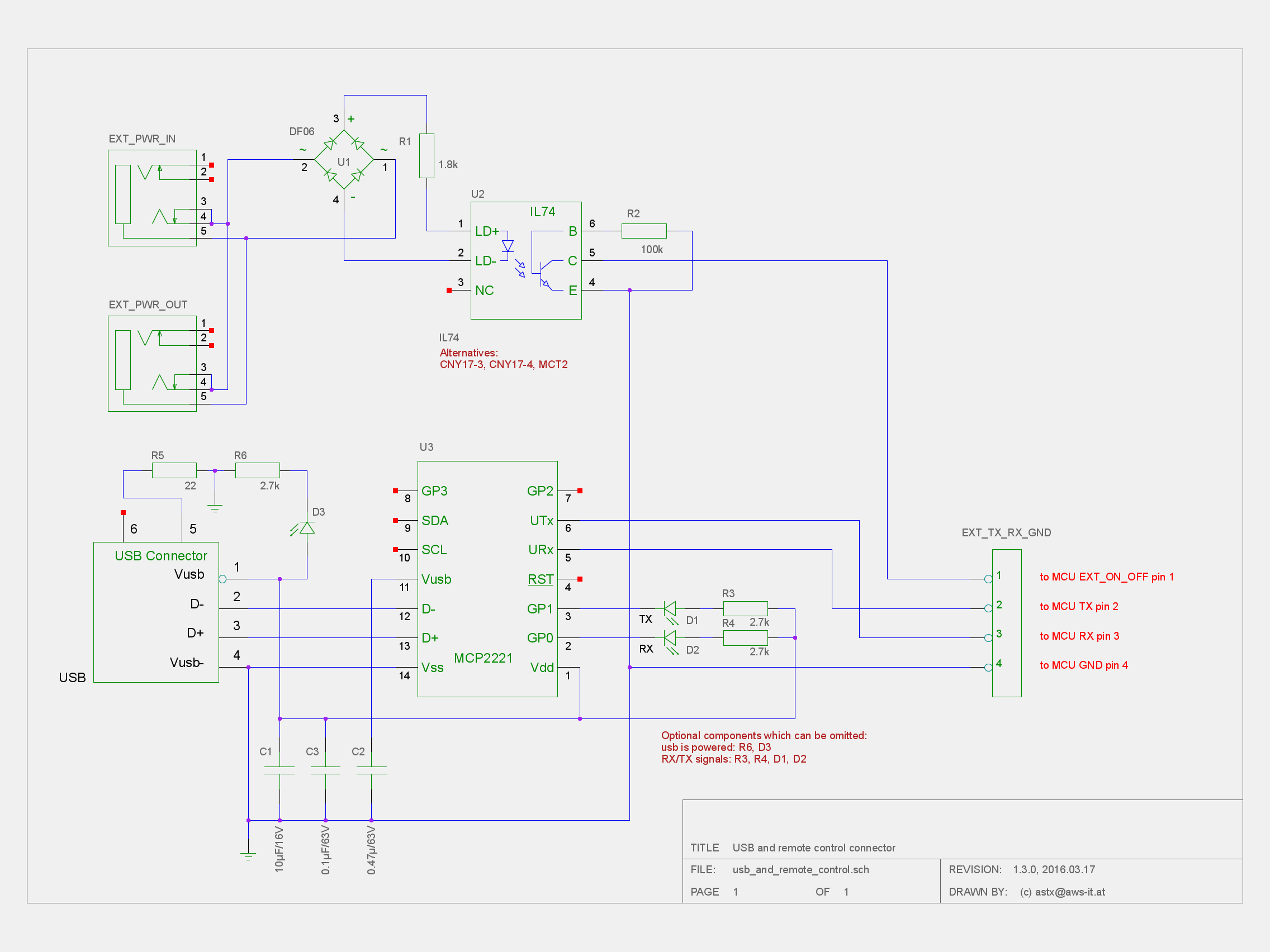

... small board for nerds who often want to reconfigure their mains power on configuration:
- remote power via 12V signal
- usb interface for mains control board MCU configuration

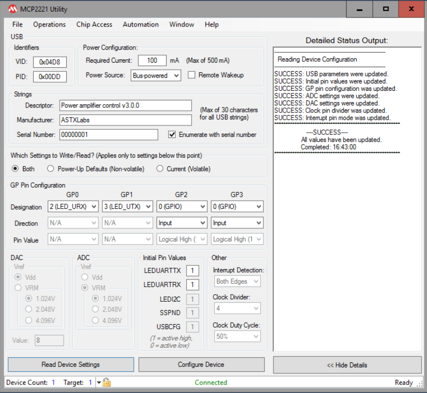

... the MCP2221 works out of the box but need some fixed configuration otherwise it could be configured to be unusable ...
Using menu "chip access" the settings can be made permanent. Unfortunately the microchip mcp2221 utility only runs under windows ... 🙁
The MCP2221 registers as /dev/ttyACM0 on a modern linux machine
In windows it registers as usb serial port.
BR, Toni

Code:
[630862.959686] usb 4-1: new full-speed USB device number 2 using xhci_hcd
[630863.148435] usb 4-1: New USB device found, idVendor=04d8, idProduct=00dd
[630863.148443] usb 4-1: New USB device strings: Mfr=1, Product=2, SerialNumber=3
[630863.148448] usb 4-1: Product: Power amplifier control v3.0.0
[630863.148452] usb 4-1: Manufacturer: ASTXLabs
[630863.148455] usb 4-1: SerialNumber: 00000001
[630863.152234] hid-generic 0003:04D8:00DD.0003: hiddev0,hidraw2: USB HID v1.11 Device [ASTXLabs Power amplifier control v3.0.0] on usb-0000:0b:00.0-1/input2
[630863.725208] cdc_acm 4-1:1.0: ttyACM0: USB ACM device
[630863.725775] usbcore: registered new interface driver cdc_acm
[630863.725782] cdc_acm: USB Abstract Control Model driver for USB modems and ISDN adapters
toni@tnserver01:~/pcb/audio_power_amplifier/usb_and_remote_control/doc> uname -a
Linux tnserver01 4.1.15-8-default #1 SMP PREEMPT Wed Jan 20 16:41:00 UTC 2016 (0e3b3ab) x86_64 x86_64 x86_64 GNU/Linux

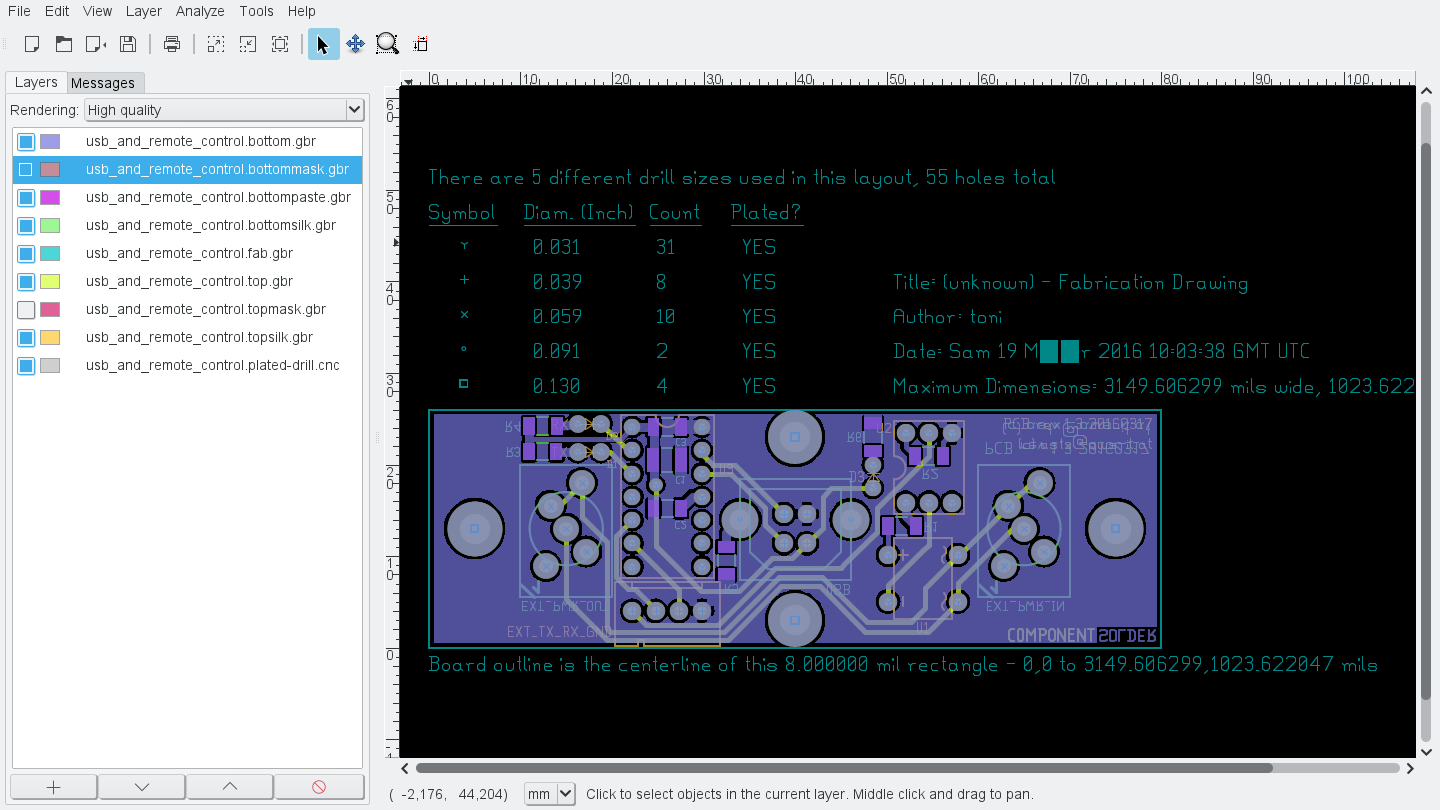

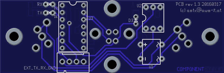

... gerbers for the small usb/remote power pcb ...
Schematics and pcb/gerbers are free to use only for non commercial DIY projects.
Have fun, Toni
Have fun, Toni

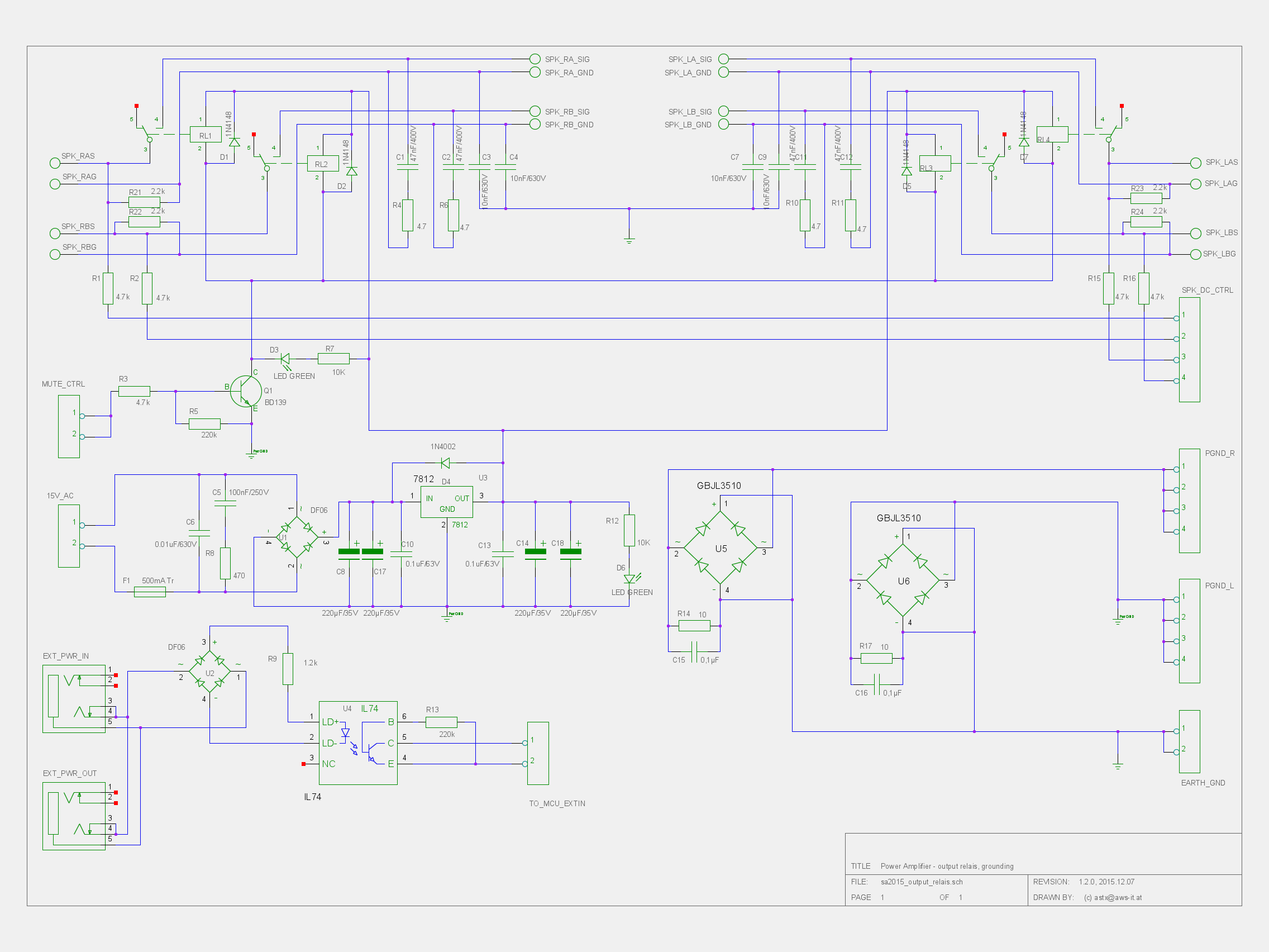

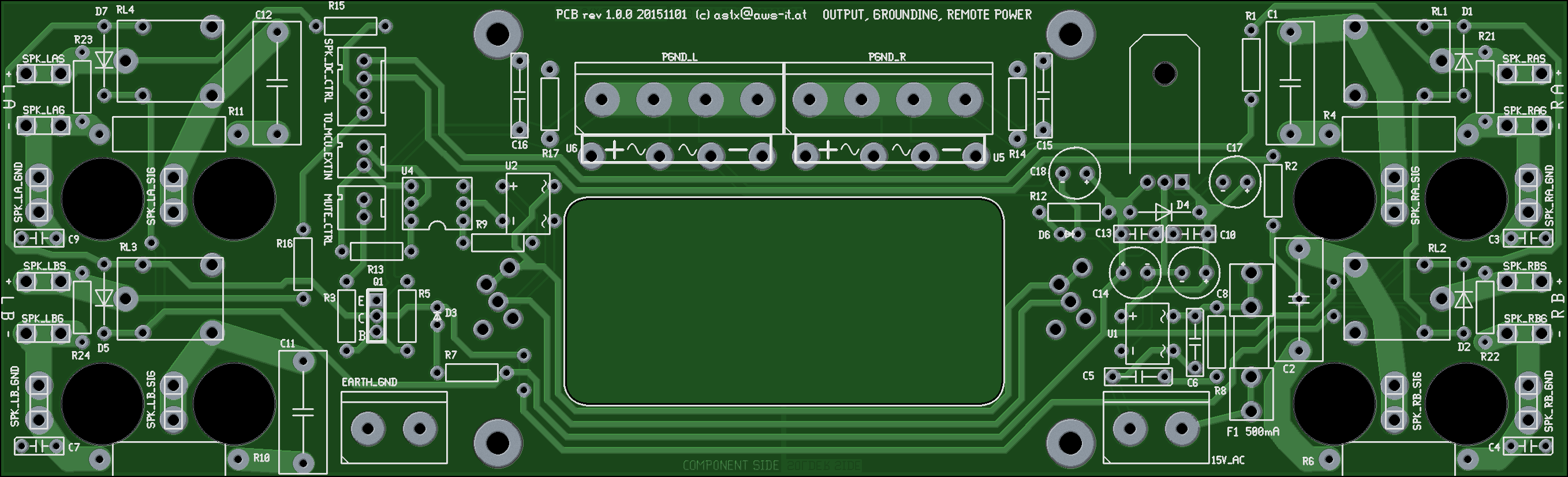

This is the back panel electronics including speaker relais for the 4 channel MOSFET power amplifier...
BR, Toni
BR, Toni

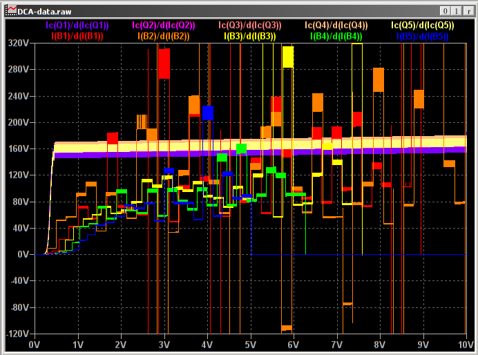

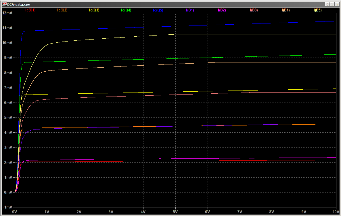

One problem with the DCA data is that at 10mA the device is heating enough to shift the curve. 2mA curves are probably okay.
10mA at 1V is 10mW which means 2C rise for TO92.
If I knew the exact timing of the measurements I could use the thermal response of the BJTs to estimate a fit, but estimations upon estimations is bad for accuracy.
Strangely, the Fairchild model matches the OnSemi data very well at low thermal points. See the attachment. The OnSemi parts have a bit of quasi-saturation which shows you which curves are the real device.
Great! Hmm ... some of the DCA sweep parameters can be tuned. I will try to catch the timings with my scope if I find some spare time. Tell me which range, steps and from/to values for which devices are of interest for you ... 🙂
BR, Toni
I don't know if it would be feasible to try and eliminate the thermals through changing the testing parameters, unless they are very flexible and can use a function. The best thing to do may be to reduce testing current by 10, so test at 1mA instead of 10mA. But that would hide quasi-saturation.
More datapoints in general would be useful, because the Vaf can be found in noisy data through averaging. Although I have to convert to CSV by hand so unless that can be automated I don't want to risk carpal tunnel.
