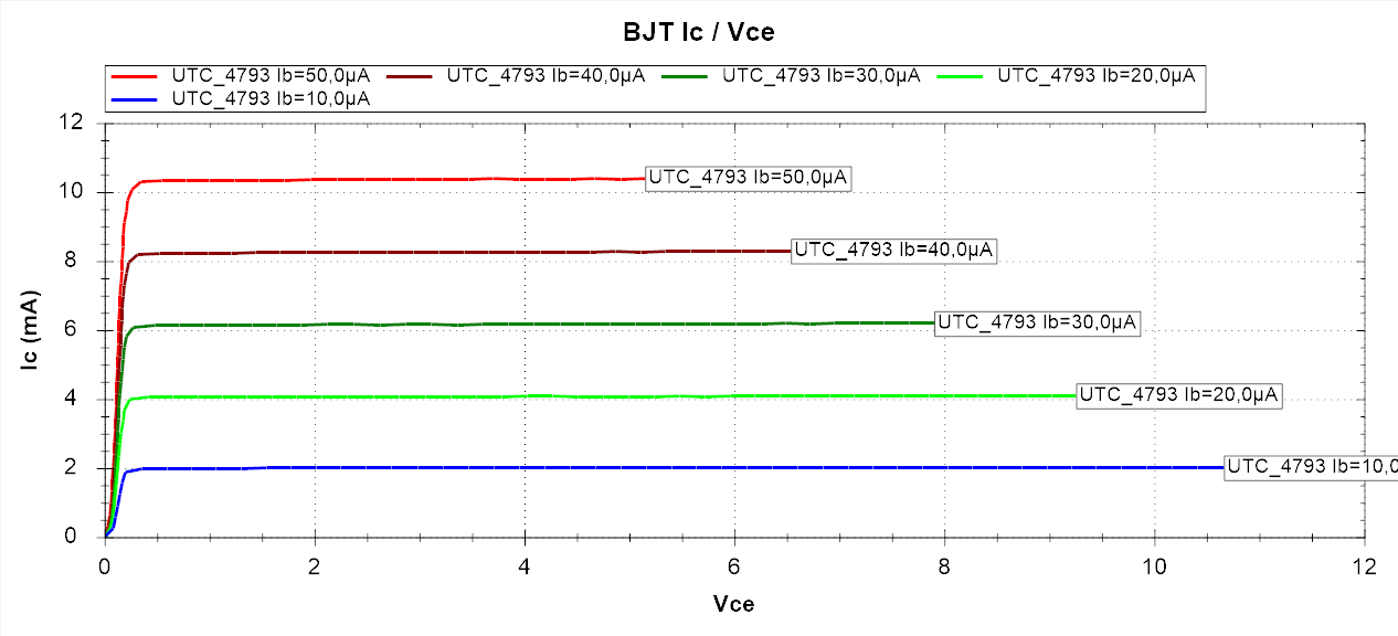

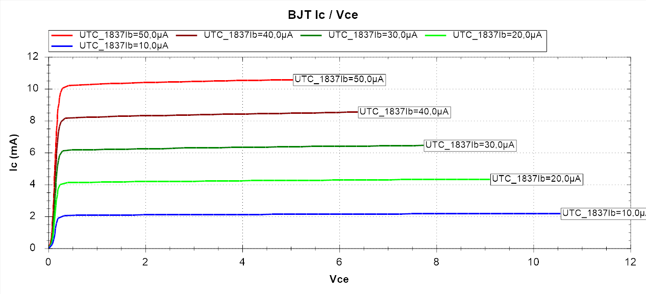

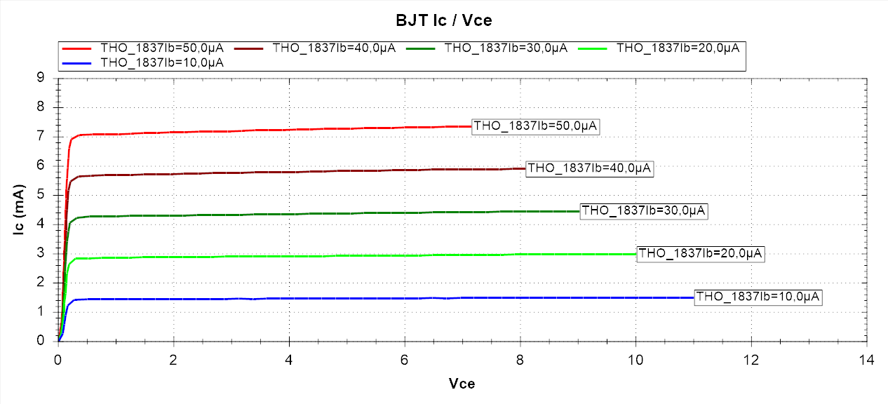

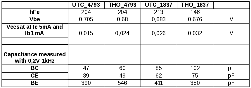

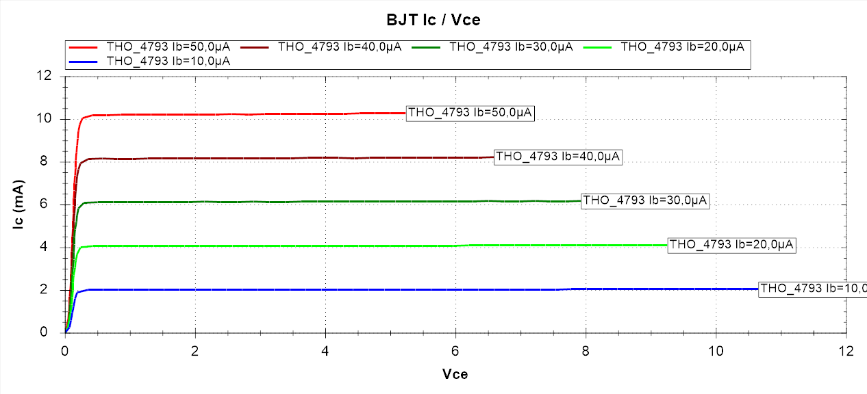

I was warned away from Unisonic transistors when they were being sold at Profusion by homemodder who said they were slow and inferior. This was for the D669/B649 pair but I imagine it applies to many of the others.
But, it would be nice to see some actual comparisons.
Thanks for info/warning. I've ordered 10 pieces
"2SC4793LB-TF3T, 2SA1837LB-TF3T" each from profusion for testing.
BR, Toni
