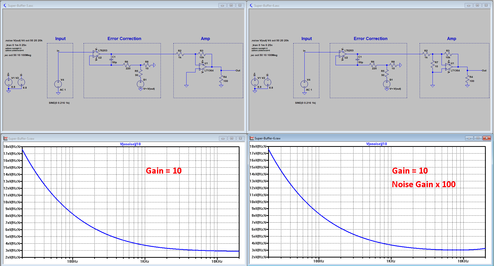

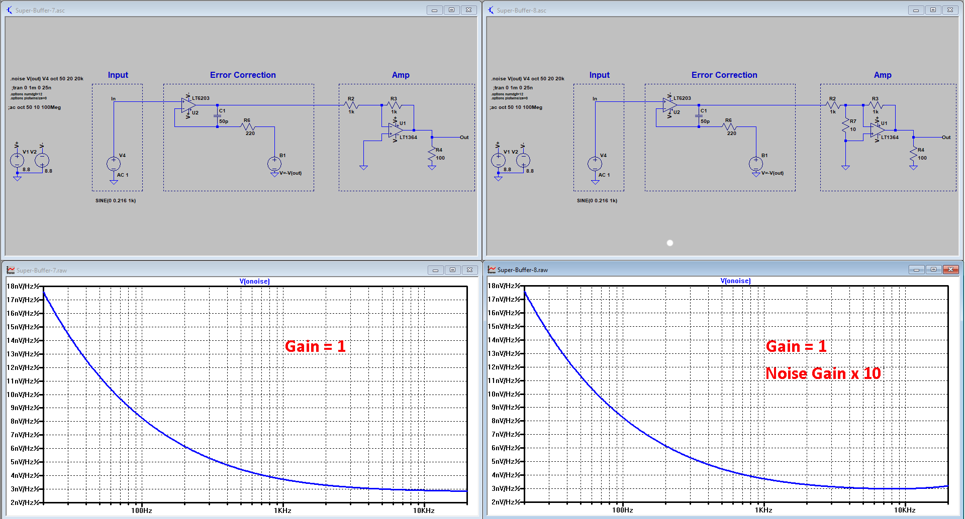

As Promised, I show you how a well behaving EC handles noise. I made a relatively simple EC circuit with an Op-Amp having much lower noise as the LT1364 has, to show you that the noise from the LT1364 will be cancelled by the EC, and only the own noise from the EC will remain.
I have made 4 sims, resp. with a gain of 10, as in your original circuit and also with a gain of 1, in both cases without and with a 10 Ohm resistor between the inputs to raise the noise.
As long as your EC cannot produce exactly identical noise spectra for all these 4 configurations, I find it very hard to believe that your EC is working properly and therefore most likely will not meet the distortion figures that you are expecting.
Hans

I made a typo in the above noise image having a gain = 1.
The mentioned noise gain increase with the added 10 Ohm resistor between the inputs of the LT1364 must not be 10x but 50x.

There are quite a few things that LTSpice cannot do in a reliable way, but when in a simulation an EC design is not able to control noise in a believable way, which seems to be the case here, distortion modelling of a certain component is completely irrelevant. ��
And don’t we all agree that simulating beyond -120dB is wishfull thinking.
Hans

Quite a few of us have spent their time to support you, helping to let your feet landing on realistic solid ground. A more mature reaction would be to come with a reasoning why your EC does not treat noise the way one would expect, or going back to the drawing board to see if something is not designed properly.
Hans
