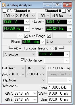

The part that confuses me is that I don't see a way to set the reference. So I don't know what the reference is.
The reference is what you set it. Example. If I am doing distortion measurements on a design at 5V, 1V and 0.5V, I set the dBr references for each case to 5V, 1V, 0.5V (there are several fields in the bottom of the analyzer window and the graph Y axis is adjusted accordingly).

The results are divided by 8.87 and 10 respectively as shown at the top of the graph.

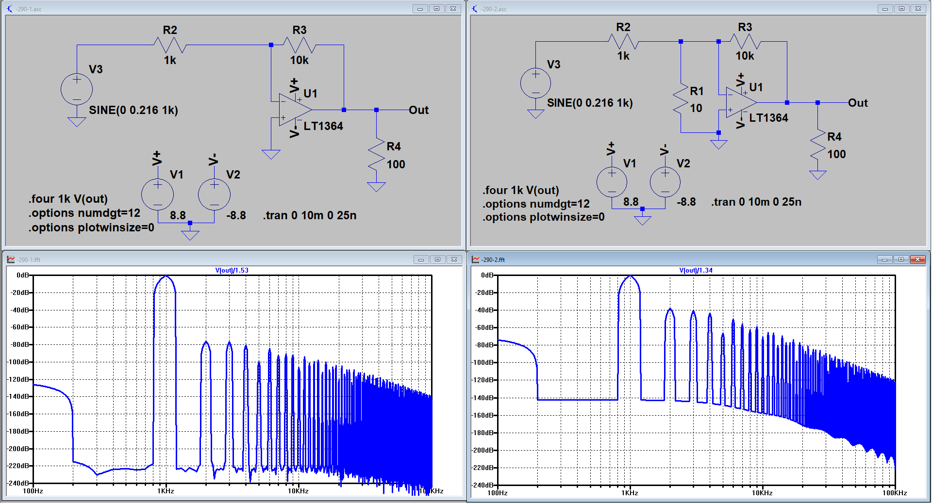

I started with the 4.32V p-p at the output that you mentioned, or 1.53Vrms. With the given circuit without the 10 Ohm resistor having a gain of 10, I had to apply 0.216V pk from the voltage source to get this 4.32V p-p.
However when inserting the 10 Ohm between the inputs, output voltage dropped from 1.53V to 1.34V rms, meaning that the gain dropped from 10 to 8.77, this because of the low open loop gain of the LT1364. Since I calculated the noise RTI (referred to the input) of the circuit, I had to divide both noise spectra resp. by 10 and by 8.77.

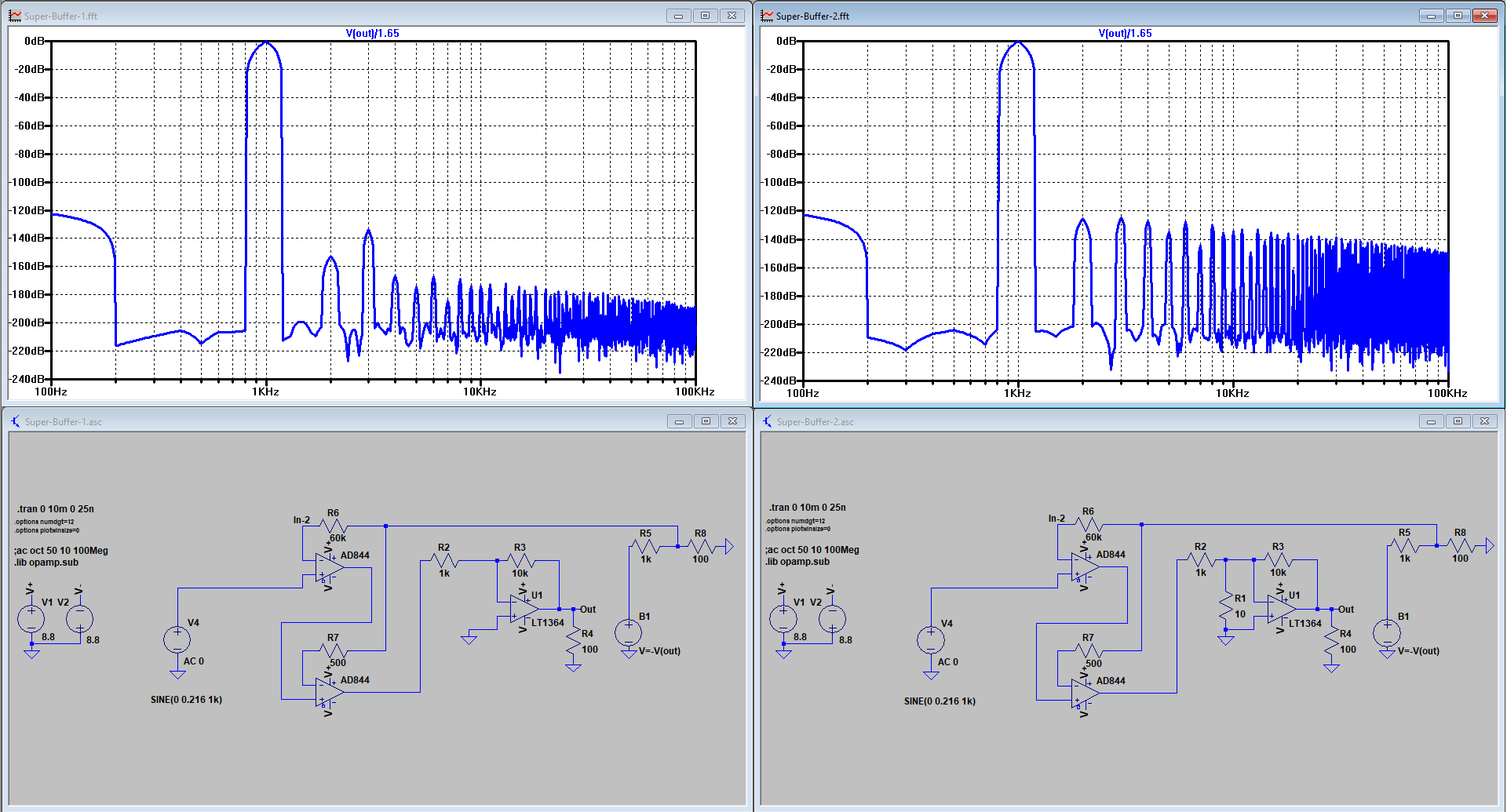

What I showed was not an FFT. I used the Noise function of LTSpice instead, as is visible in the images..noise V(out) V3 oct 50 20 20k

I see. You said you wanted the noise sim with my EC applied? I can only use half of the performance of my EC with the resistor method. However this would be the result with the usable half with no 10 ohm resistor
With the 10 ohm resistor
The output level was the same on both so I kept the division by 10.
The full scale circuit is not stable at a gain of 10 in the sim or in real life and the resistor causes it to go unstable even at unity. This is the result of the full scale circuit without the 10 ohm resistor at unity.

Okay I changed it to Hann. I applied the EC to the LT1364 under the same conditions and increased the circuit sophistication in increments as far as I could go while keeping it stable at the 10X gain.
At 1X gain I could still squeeze more out of it.
I'm using 10khz instead of 1khz because I'm still getting that strange 1khz result.
The improvement in the last image is difficult to see but if you look carefully, the improvement of the main harmonics are consistent with the rest. Overall it is consistent with what I've seen in my tests and what I was expecting. I don't know what all the fuzz in the sim is though, doesn't appear when I'm simming without the window option.
But this is an example of why I assumed that the -290db value was correct getting the results I got. Every test and sim I've done suggests the improvements are independent of the state of the main amplifier.
I think that is flawed Marcel. The input of the opamp is not zero by definition - rather, it is, by definition, Vout/Aol. There must be some input to support the output. That means that the noise and non-linearity of that 10 ohms is also amplified, with the noise gain in this case.
Jan
Apparently you use a different definition for ideal op-amp than I do. To me, an ideal op-amp is basically just a silly nickname for a nullor, and a nullor by definition has zero input voltage and zero input current.
In any case, you can also use a perfectly linear voltage-controlled voltage source with a gain Aol, put a non-linear feedback network around it and then look at the trend for increasing Aol. It just complicates the thought experiment a bit.
In the case without the extra resistor, as long as the loop gain is large, the distortion will be nearly independent from Aol, because in this thought experiment, the distorting components are in the feedback network rather than in the controlled source.
Now add the extra resistor between the inputs of the controlled source, size it such that loop gain drops by a factor of 100 and again look at the effect of changing Aol. With increasing Aol, the voltage across the extra resistor decreases, so its impact on the behaviour of the circuit decreases. In fact, except for its thermal noise (*), you can make its impact as small as you like by increasing Aol further and further.
If the purpose of the extra resistor is to increase the distortion by a factor of 100, it clearly failed, because its impact tends to zero with increasing Aol, while the impact of the nonlinearity of the feedback resistors does not.
