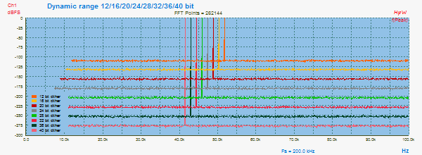

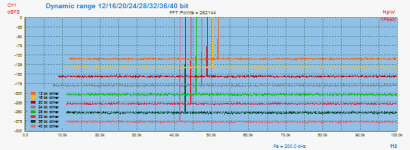

Would this be a good time to say that if someone says he can measure to -290dB then we may doubt him? I might take it seriously if someone from CERN or LIGO made such a claim, but almost everyone else (whatever their guru status) has to provide proof.
Some real digital generated signals using various bit sizes... 😀
Hp
  • HpW-Splash reference Noisefloor using 12-16-20-24-28-32-36-40 bit 3D-A7e.png
Well, obviously the noise floor itself is going to prevent the circuit from being any distortion beyond that. Regardless of anything else. I never claimed to be able to reduce noise floor below any point. My claim was that the circuit was capable of of reducing signal distortion down to -290db based on my tests and sims. Actually I'm pretty sure it can go further if the logic holds. However as it's been stated, I need to have a third party individual or lab confirm the results. I have limited money to spare so I'm holding back for a bit before I spend several hundred dollars on a prototype designed for critical testing.

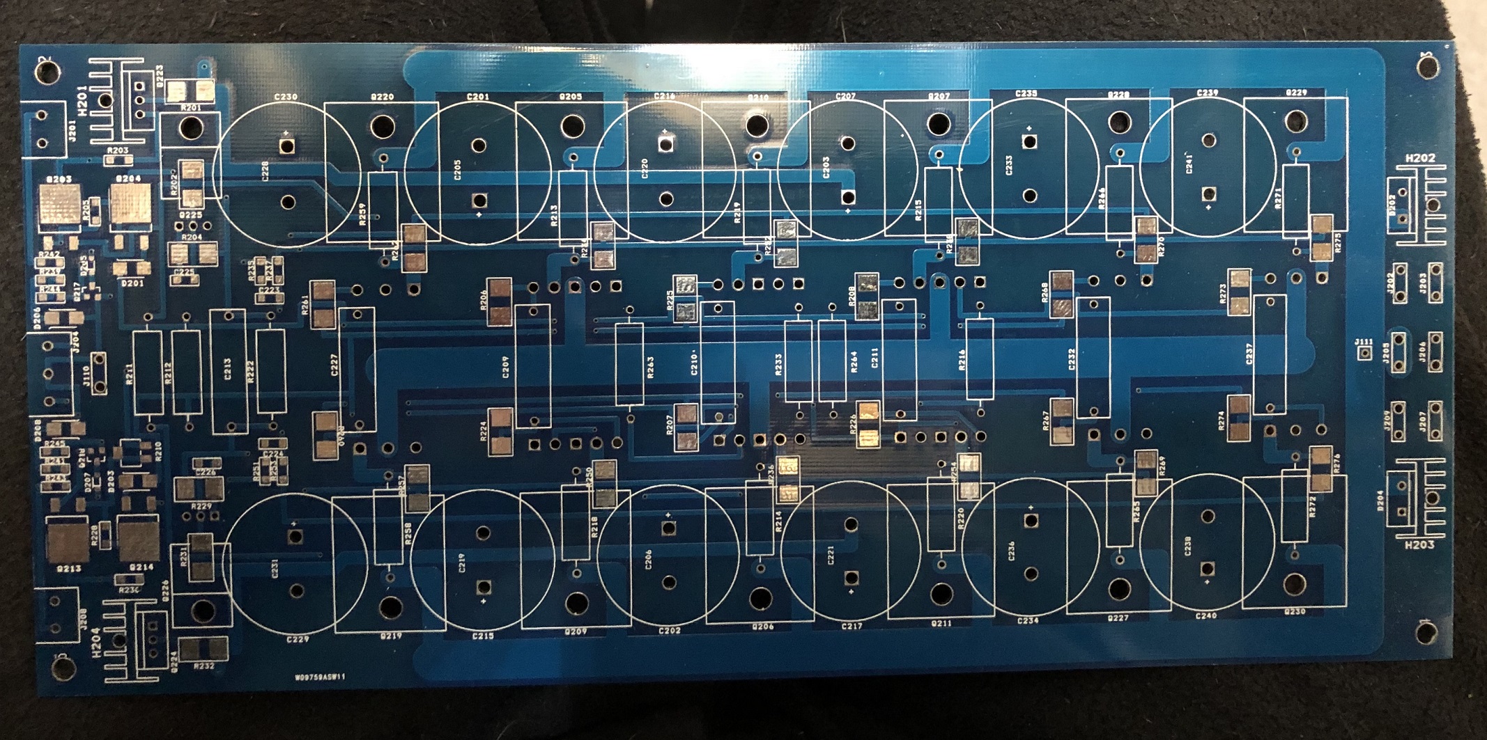

In a class-B bridge amplifier, the current from the power supply via the output stages to the other end of the supply would still be a rectified version of the signal.
Marcel, this probably deserves a separate topic, but the magnetic effects of the half rectified power supply currents can be largely avoided by a clever PCB layout. Find attached such a layout I developed for a high power (up to 500W/4ohm) amplifier using Thermaltrak devices to compensate for temperature.
This is based on an idea from the same Cherry paper you quoted, where he suggested an "8" shape input stage layout to avoid magnetic effects. Here, the idea is to alternate npn and pnp devices and drag the +/- power supply lines through the middle of the PCB on both sides. This is equivalent to twisting the power supply lines straight from the power devices pins, the resulting external magnetic field being essential sinusoidal (much less harmonics than a full rectified sine), and I can vouch the practical results are nothing but spectacular compared to the standard layout with +/- supply lines each at the edge of the PCB.
As you can also see from the attached photo, the output trace takes the edges of the PCB, with the feedback pickup nicely placed at the current centroid.
Of course, this has nothing to do with -290dB distortions, but my result shows that such a layout can help not only in reducing the output stage magnetic distortions (such distortions cannot be in principle reduced by increasing the loop gain) but also making the whole problem of wiring a power amp much less critical.
I have no idea why such a layout was never employed in any commercial products (to the extend of my knowledge) since it is essentially a free method to improve performance. It probably doesn't sound good enough for the audiophiles 😀
Nice layout! I read about Cherry's 8-shape, great that you managed to improve it further.
What kind of distortion do you achieve with this layout? Is the input balanced or single-ended? I presume the big capacitors are the power supply capacitors rather than local decoupling, is that correct?
