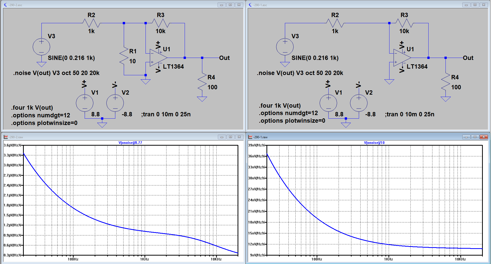

Why did you divide the result in your sim?I’m still interested in the simulated noise spectra with EC.
That could give some additional info helping to setting your goals sharper.
Hans
Also could you explain how this noise measurement can help me?

I would like to answer your question, but I don’t understand. What result has been divided.Why did you divide the result in your sim?
As mentioned before, EC cannot cancel its own noise. Doing this should give exactly the same noise spectra for both versions, with and without 10 Ohm, if not, the EC it is not maximally tuned. The second reason is that you get your information at what level the noise of your 100 Watt Amp will be and thereby the theoretical measuring limit for the THD for a given bin width, still completely neglecting things like the own THD of the EC, etc, etc.Also could you explain how this noise measurement can help me?
The results are divided by 8.87 and 10 respectively as shown at the top of the graph. What is the reasoning?
Also do you know how to remove the noise floor in the FTT? I could show some more useful figures if it wasn't in the way. I don't know how you made FTTs look like you showed before.
