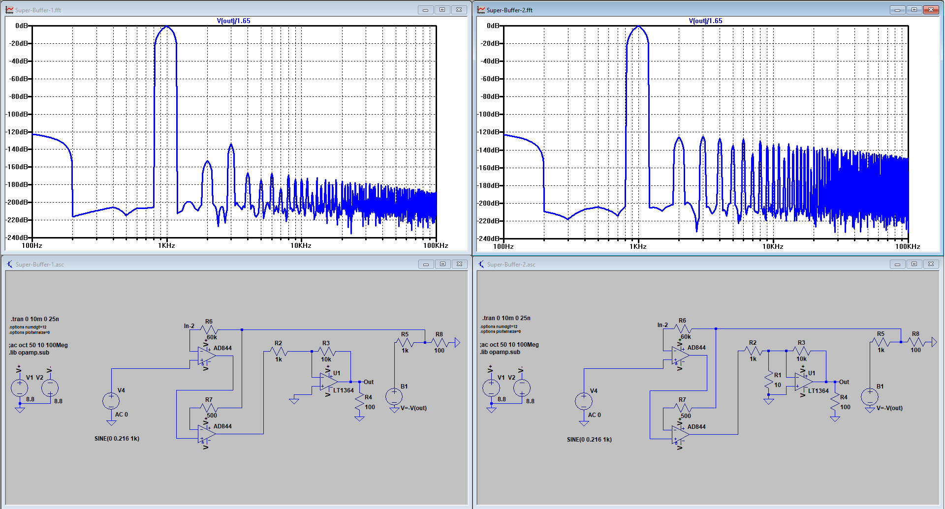

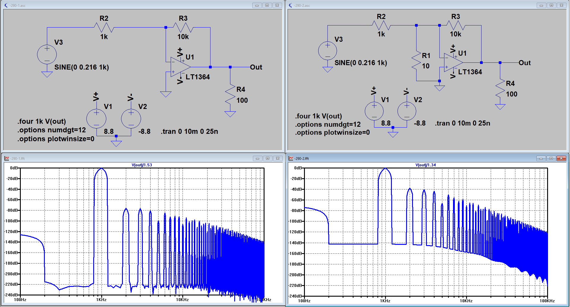

In an attempt to structure the discussion a bit, I have made two sets of simulations. The first set is with the LT1364 in the configuration as shown by you, resp. without and with a 10 Ohm resistor between both inputs to increase the noise gain and thus distortion by a factor 100. As can be seen in my simulation, distortion goes up by 40dB as expected. For some reason the images shown by you go up only by 30dB, you probably have done something wrong.
In the second set of simulations, I have included an EC mechanism with two AD844, just because I had that sim model available. But I could just as well have selected another more modern high speed amp. And again I simulated without and with the 10 Ohm resistor between both inputs. What can be seen is that the harmonics in the 10 Ohm version to the right are going down by some 80dB because of the EC. However the left version shows a different behaviour, especially for the third harmonic, going only down by 60dB and not with 80dB.
This is to show that you simply cannot say that when in a bad situation with lots of distortion, THD goes down by 80dB, that in all situations THD goes down by 80dB. The claim that your EC reduces THD by 140dB in a situation with very high distortion, does therefore not at all imply that also in a very low distortion situation THD goes further down by 140dB.
The other thing that I have shown, is that it must be relatively easy to get a -150dB THD amplifier, when starting with a good AMP having THD in the ppm range when using a proper EC circuit.

By the way, at least for a plain old feedback amplifier, the noise gain method only increases the distortion of the active part, not of the passive components in the feedback network. That's easy to see by a thought experiment.
Suppose you had an ideal op-amp with a feedback network consisting of resistors that distort a bit. All distortion will then be due to these resistors.
Now connect some small but nonzero noiseless resistor between the inputs of the ideal op- amp. As the voltage between the inputs of an ideal op-amp is zero by definition, there will be no current flowing through the extra resistor and it will have no influence at all.
This may be an advantage when you want to measure the op-amp's distortion, but it causes wrong results when you want to use the noise gain method to measure the distortion of the whole amplifier.

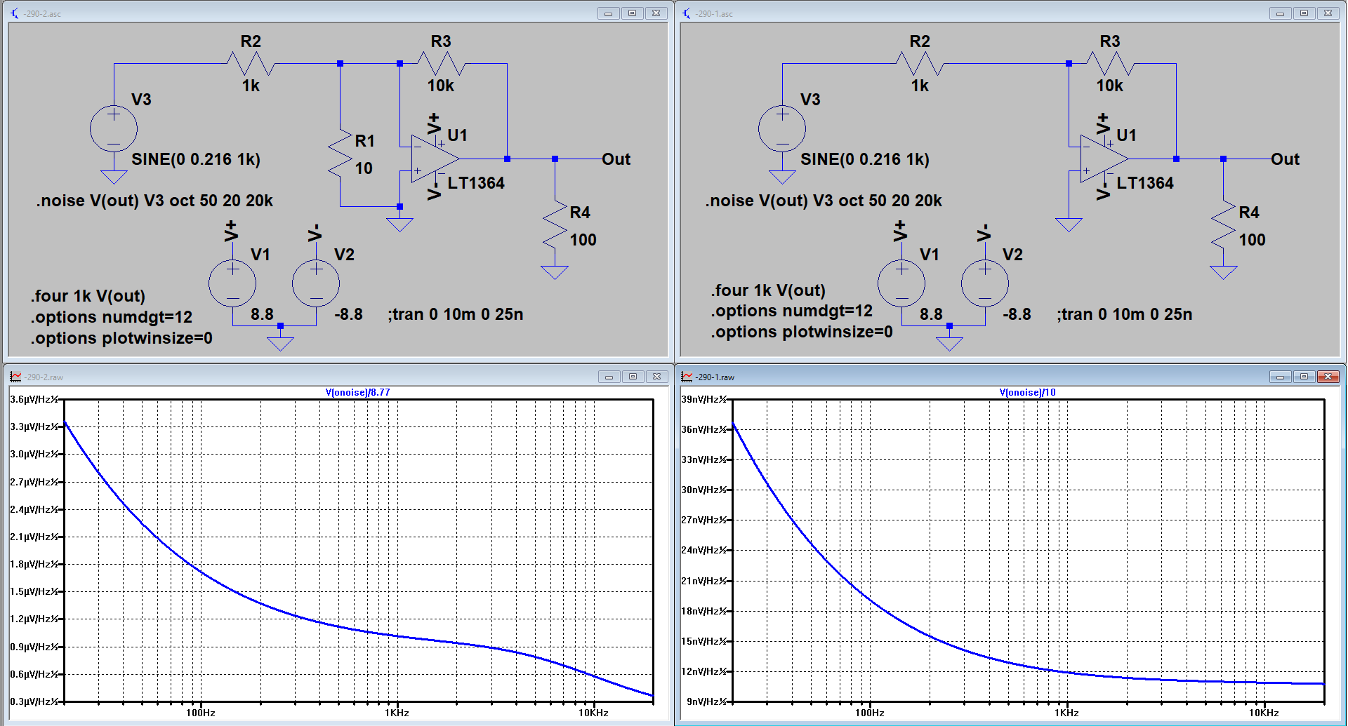

@hellokitty
For both versions with and without the 10 Ohm resistor between the inputs, I have plotted the noise spectrum referred to the input.
It would be instructive if you could simulate and show us the noise spectrum for both versions, but now including your EC.
Hans

A better analogy is to heat the metal bar to 1000C, then plunge it into water. As we know water lowers the temp by 1100C the water will freeze at -100C. There is only a small difference between 1200C and 1000C so the water should have the same effect, namely reducing the temp by 1100C.hellokitty123 said:That analogy doesn't work. It relies upon two methods of reducing the temperature. (distortion) Mine only has one.
It's even simpler. An EC that has itself a distortion of say -120dB will easily lower your amp's distortion from -40dB to -100dB. But it will obviously not lower your amp's -80dB to -140dB

I’m still interested in the simulated noise spectra with EC.
That could give some additional info helping to setting your goals sharper.
