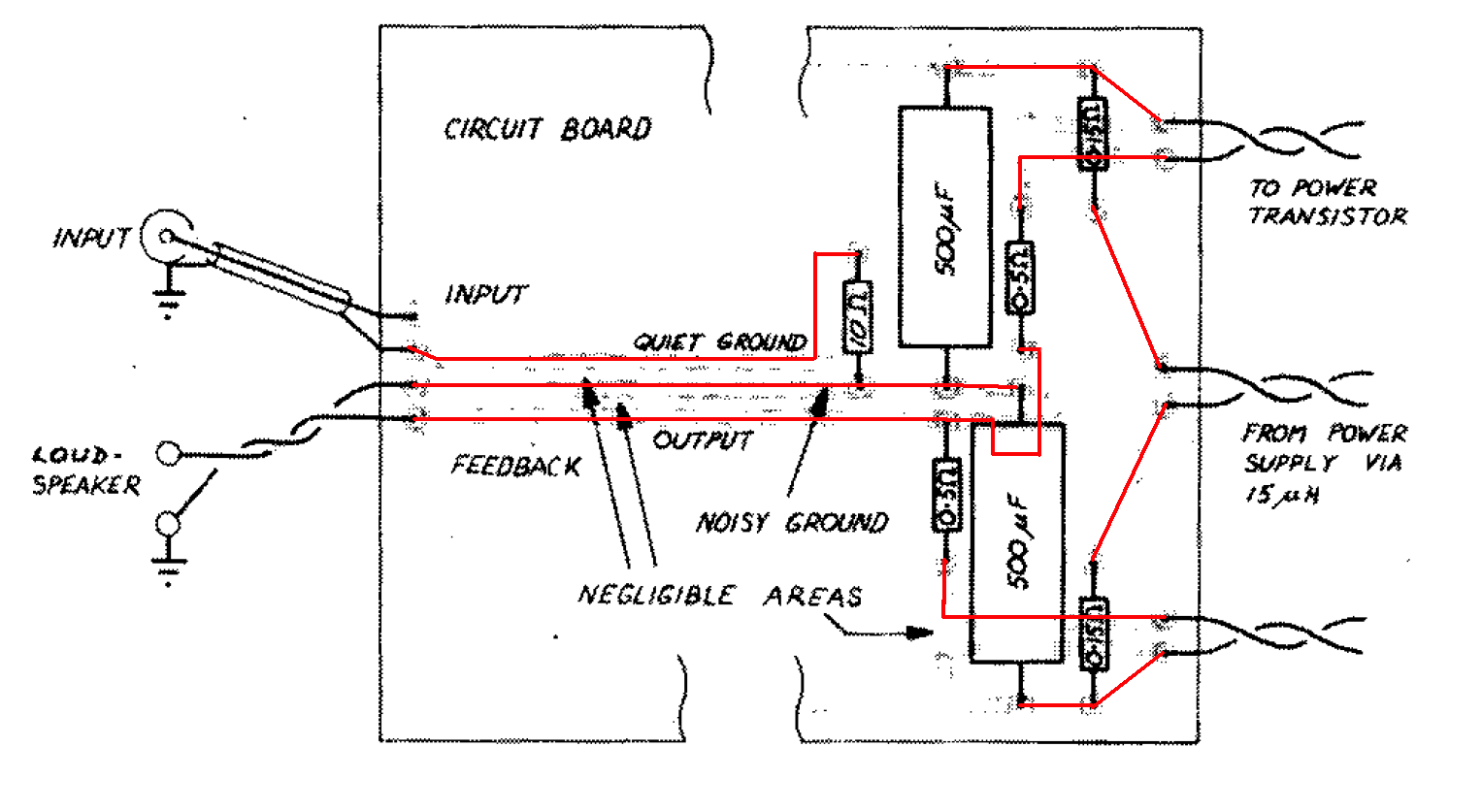

I don't think Cherry's approach is necessary a bad thing, in particular for medium power amplifiers. I don't follow the same approach, though, and always separate the signal ground from the "dirty" ground right at the input (10 ohm resistor). I also don't twist together the power supply wiring with the output wiring, I keep the output/ground wiring twisted separately.
The PCB image on the Cherry paper has a rather low quality.
That's why I have drawn in red the supposedly missing traces.
Here he connects resp. 1) the cold Input, 2) the cold LS wiring and 3) the Power supply Gnd all "somewhere" to the chassis.
This has to be handled with much greater care, not to nullify with ease all taken precautions to reduce mutual induction.
So what you do sounds a lot better.
Hans

I see primarily as minimizing the loop areas - which would of course minimize the inductances Cherry mentions as well. There are clearly a number of ways to achieve this as there are a few designs on the forum at ppm levels that don't use this specific layout, but the designers have simply found a way to overcome the issue through good layout practice.
I like the way he has laid the emitter degen resistors next to the on board filter caps but balk at the speaker and input connections being next to each other.
(Thanks for clarifying the drawing BTW)
