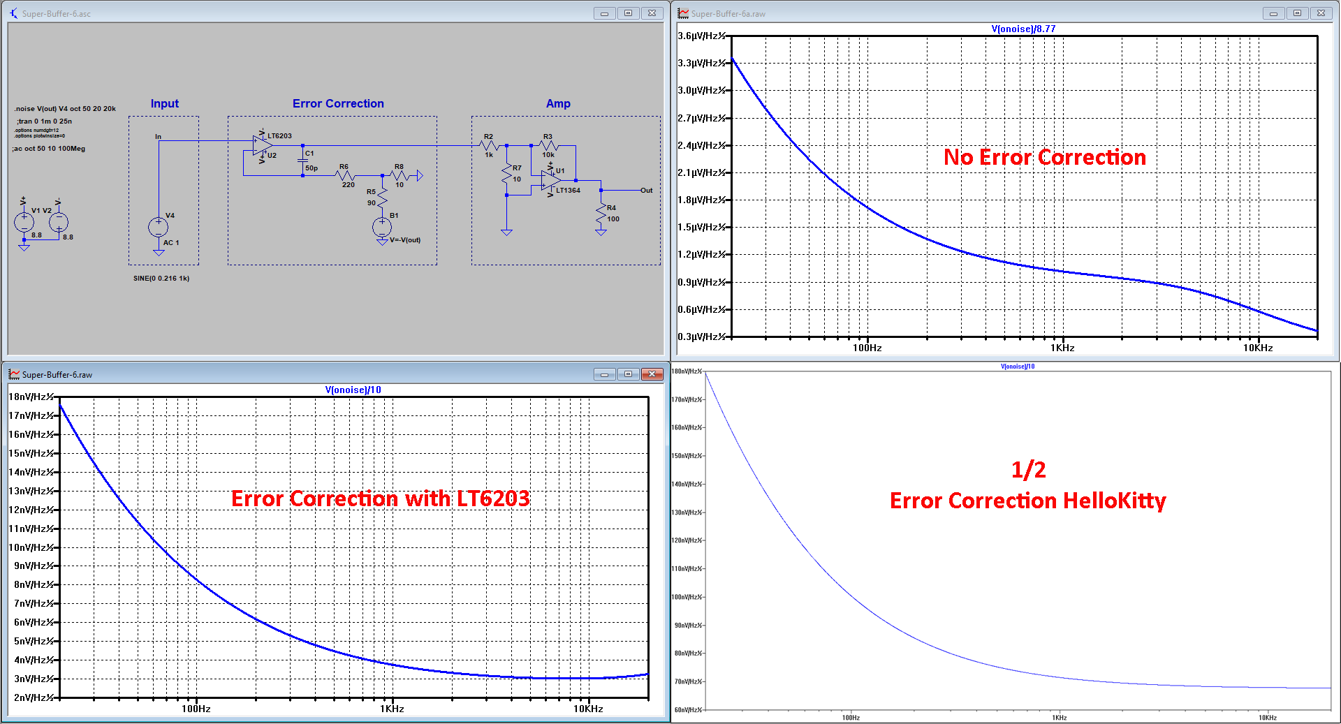

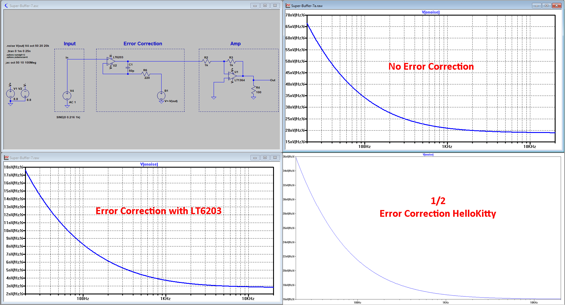

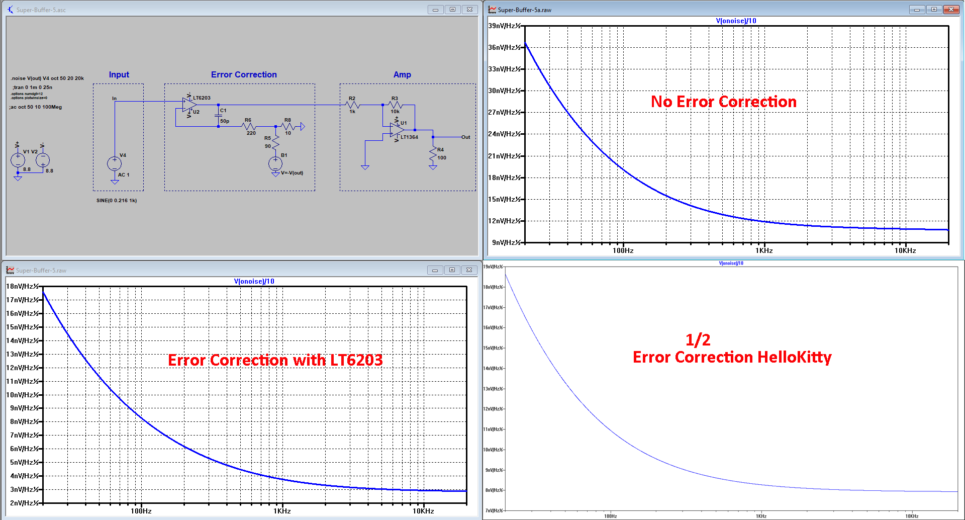

I'm glad you are still there. There was no reaction from your side to my noise simulations, maybe because it was a bit unclear what I tried to tell.
That's why I have made the simulations again, but now including the noise spectra without EC plus the noise spectra that you showed here -290 dB Distortion?.

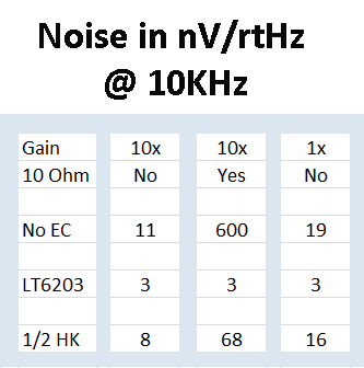

I also included a table at the end with noise data extracted from these figures at 10KHz, the frequency that you also used here https://www.diyaudio.com/forums/analog-line-level/338635-290-db-distortion-post5816052.html. These spectra are showing 4 EC steps, whereby each step suppresses the 2nd harmonic by roughly an extra 30dB. So 1/2 of your EC as used for your noise images should suppress ca 60dB at 20Khz. Suppression at 10KHz should be comparable or higher.
However when looking at the table with noise figures @10KHz, the highest noise suppression with 1/2 your EC is from 600nV/rtHz to 68nV/rtHz, or 19dB suppression and not the expected 60dB.
Without noise (and other missing things contributing to THD) in FFT simulations, you can get these very nice figures, almost up to 60dB for the halve set and 150dB error correction for the full set of EC stages that you have in mind. However, the much more reliable noise simulations are showing at the best a noise suppression of 19dB @10KHz, which seems difficult to understand.
So my intention was to stimulate you to find out how these seemingly conflicting results should be regarded. I would be happy to receive a reaction from your side.

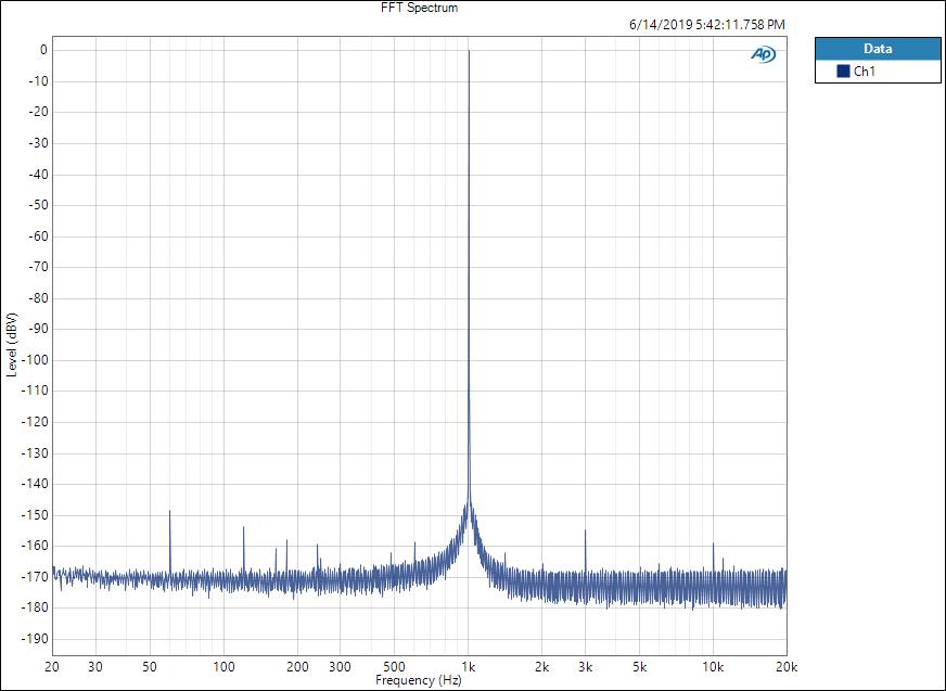

Hello,
In the real world in real time -390 dB distortion lies somewhere between paradox and oxymoron. In the real world in real time there in no -390dB distortion only noise. In the imaginary complex world of DSP you can visualize distortion in an ever narrowing FFT window of noise. Somehow some get the mistaken idea that a lower noise floor is reduced noise.
Noise is random, distortion harmonics are steady state. Error Correction feedback does nothing to remove noise.
Feedback low level harmonics plus the noise that is always there and the THD + Noise will not go down but increase. Out of phase noise added to noise is even more noise.
Just for fun see the attached plot of APx555 1.2M sized FFT window with 10 averages. What happened to the noise did it disappear?
Thanks DT
Oh yes you can, see the head of the 2nd harmonic sticking his head out of the weeds at -165dBV. The thing is you would never see it without the 1.2M sample size and 10 times averaging, otherwise the second and even 3rd harmonic would both be swamped by the noise. Real world and real time the harmonics are completely masked at the low levels in the plot.
Sorry, this is plain nonsense.
Where's the fun? Nobody expects noise to disappear when averaging. Only the distribution curve of the noise narrows down, giving a flatter spectrum at the average level, making it easier to see the distortion products popping out. Narrowing the Bin Width by using a larger FFT does lower the noise energy per bin, resulting in a spectrum with a lower noise level, but all the noise is still there spread over more bins, nothing disappeared.
Hans
It's like the length of the population. Some people are 150cm tall, others are 190cm tall, but if the average of the whole population comes out to 171cm, that doesn't mean that all of a sudden everyone is 171cm tall!
Noise is bipolar so it you average it long enough the average comes out to zero. But the noise is still there!
Its the difference between what it really is and the way you measure it.

Hello All,
Noise per bin times the number of bins equals the Total Noise.
If you increase the number of bins there is a corresponding reduction in noise per bin, the total noise remains the same. Jan, the average man is still 5 foot 10 inches tall.
Thing is with an increase in the number of bins the apparent “Noise Floor” of the FFT plot is reduced. A lower noise floor allows you to see the low level harmonics.
For the sake of HANS POLAK the Error Correction technology we are speaking of here adds back in 180 degree out of phase harmonics and, if you will allow me, 180 degree out of phase noise. Because the harmonics are periodic they will cancel. Because the noise is not periodic it will not cancel, it sums causing an increase in noise. The net effect is a decrease in THD and a net increase in Noise. If the starting levels of harmonics are low the overall effect of EC may be an increase in the THD+N percentage.
