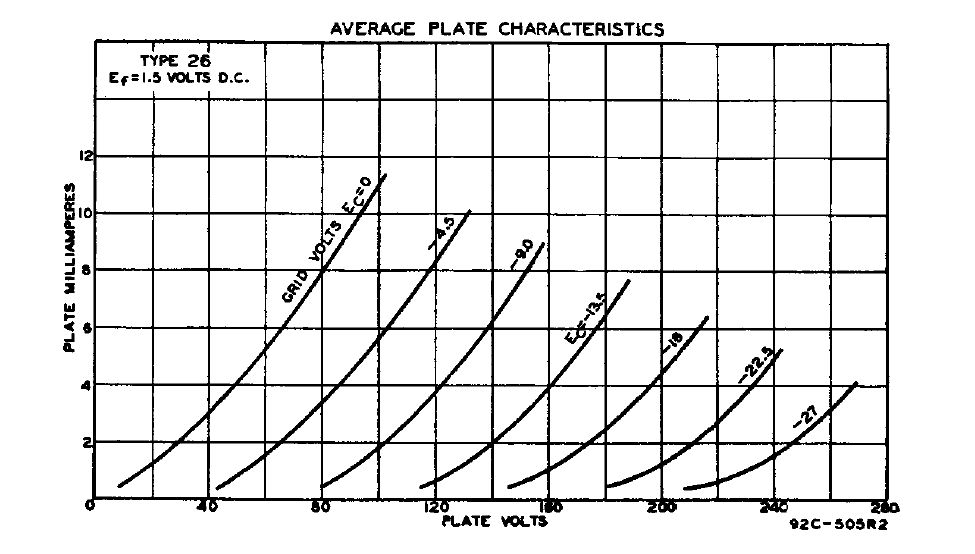

What is your operating point?

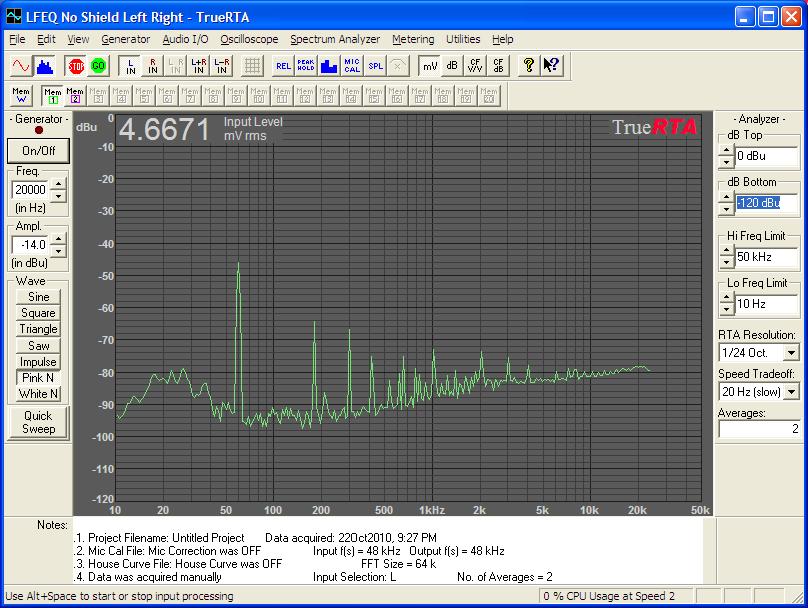

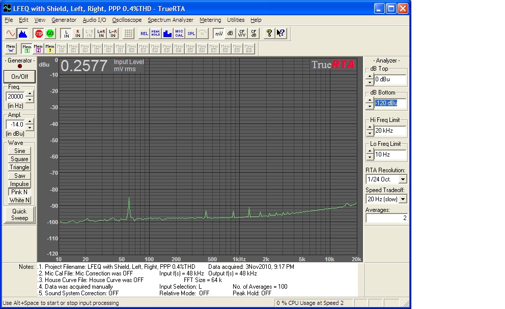

Here are a couple plots showing the background noise of a low frequency EQ unit I worked on. The first is the unit with no shielding around the power supply, the second is with a single layer of TI-shield around the power supply, grounded to the steel chassis. The power supply was in the same box as the audio circuits.
I did make some other mods to the unit that helped, but the majority of the noise reduction came from the TI-shield.

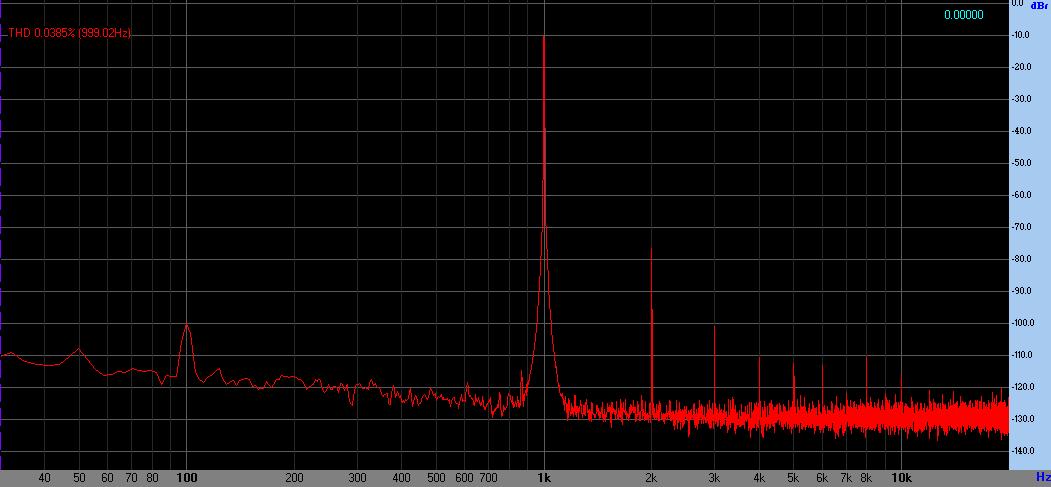

My (breadboarded) 26 pre spectrum (and THD) at 6V RMS output.
B+: 220V, filament bias (Rod Coleman supply) -1A with 10R- -10V, Majestic G-26 tubes, 6mA cascode (DN2540) CCS, 1K Riken grid stoppers, Shinkoh resistors on the input and output, 0.22uF russian FT3 teflon capacitor, S&B TX102 TVC.
Power supply on the another board (about 30cm distance): 2*240VAC-AZ1 mesh-CLCLC-(dual)SSHV2; 2*15V-FexFred bridge-C-CMC-CLC raw filament supply.
No audible hum.
Without TVC the bandwith over 300kHz (7Hz-320kHz +/-3dB)!
With different tubes (about a dozen) 50 and 100Hz components changing about 30db (-80..-110dB)!

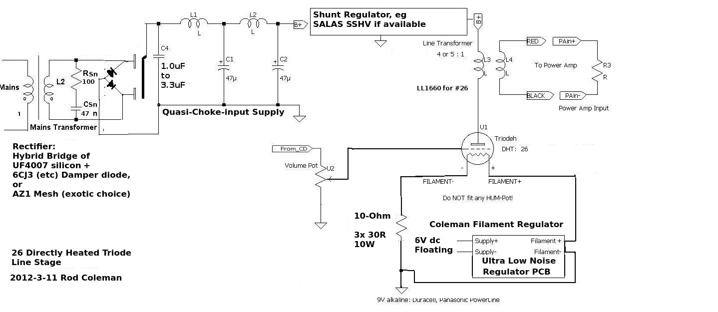

A lot of taste is involved in getting a 26 DHT line amp to sound the way you like, but how about a sketch that gets a newcomer to the thread started? This should not be too controversial, I hope.
Based on properly implemented HV and filament supply, using good quality transformers, and a high quality Lundahl LL1660 output transformer to drive cable well.
I have showed filament bias, so that degradation due to cathode coupling caps can be avoided. Fil Bias generates lots of heat in the Bias resistor, buts gives the least compromise to the sound. (I can post a battery bias version if anyone would like it).
The circuit assumes that Sources have dc offsets below 0.2V, or a series capacitor will be required.

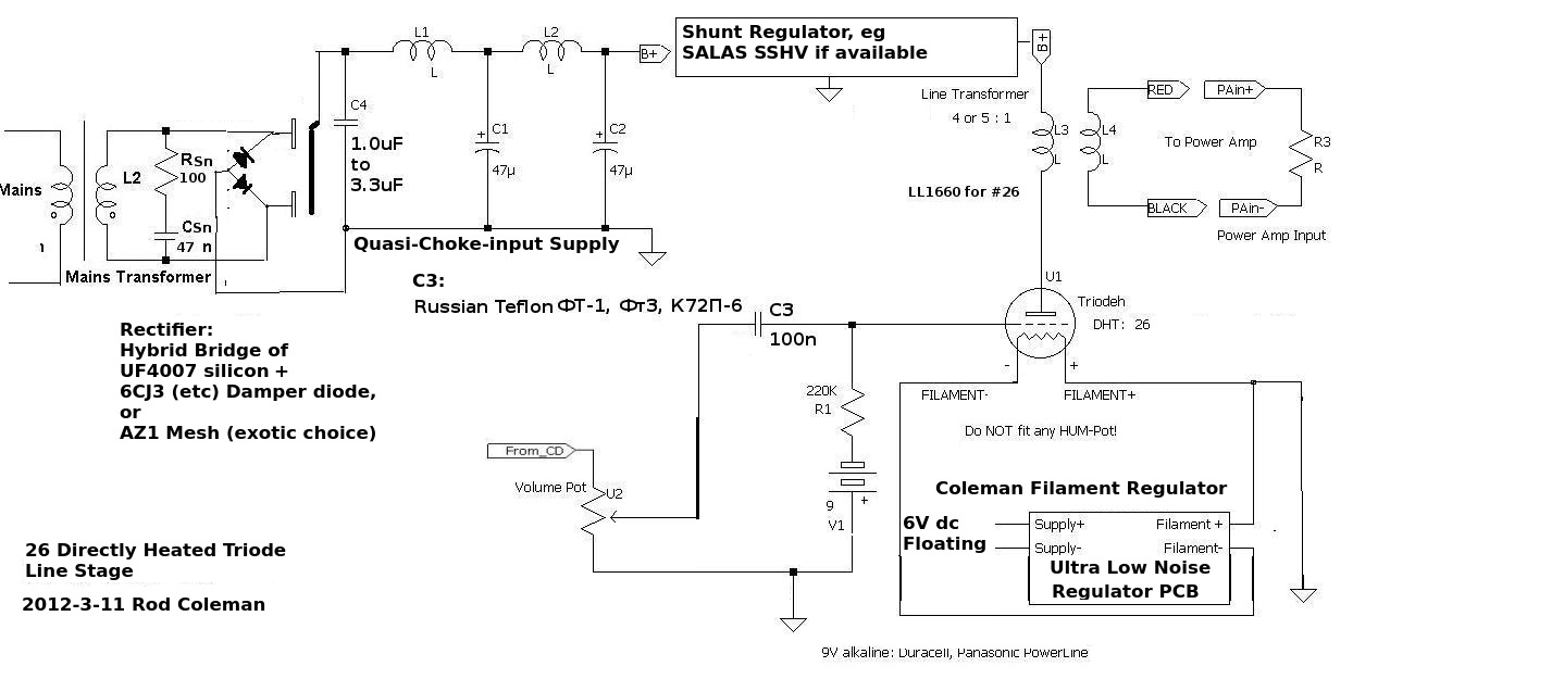

Indeed..not controversial at all from my point of view. For the frugal though...The LL1660 output tranformers are relatively expensive though. Same for good anode/plate chokes (And layout/humm issues). A good CCS adds complexity.
So I guess a plan B would be a simple RC version of your schematic above.
Say 22k plate load with 0,22uF coupling cap. A la 26 Menu
Rod's schematic is excellent. The way I have it I'd have 4.5v on the filament negative and 6v on the positive. 95v on the plate of the 26. My cathode resistor is 5 ohms, which is two 10 ohms 20W in parallel. I have 12v going into Rod's filament supply. I use LL1660/5mA (3mA actual current) in 1:1 because it's effectively the first stage of my amplifier rather than a stand-alone preamp. I actually slightly prefer the sound of two Hammond 156C plate chokes in series as discussed and a 0.1 FT-2 teflon output cap, but this is very prone to low level hum and can only be cautiously recommended. If you can deal with the hum it's a much cheaper option.
But actually, I'm using a 4P1L in filament bias with a 20 ohm filament resistor and a LL1660/18mA. I've moved on. It's a close call but I like the treble and clarity of the 4P1L.
Andy

Sorry my ignorance, do you connect a 9V alkaline between cathode resistor & ground?
