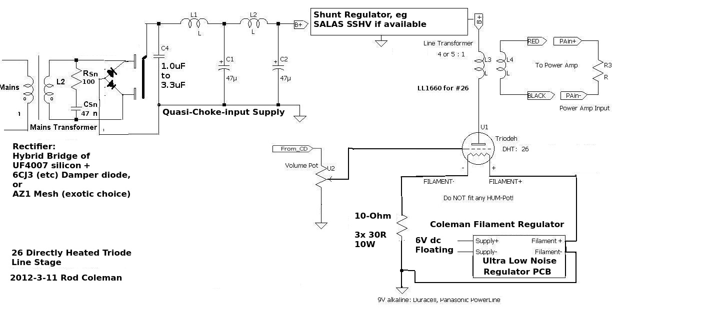

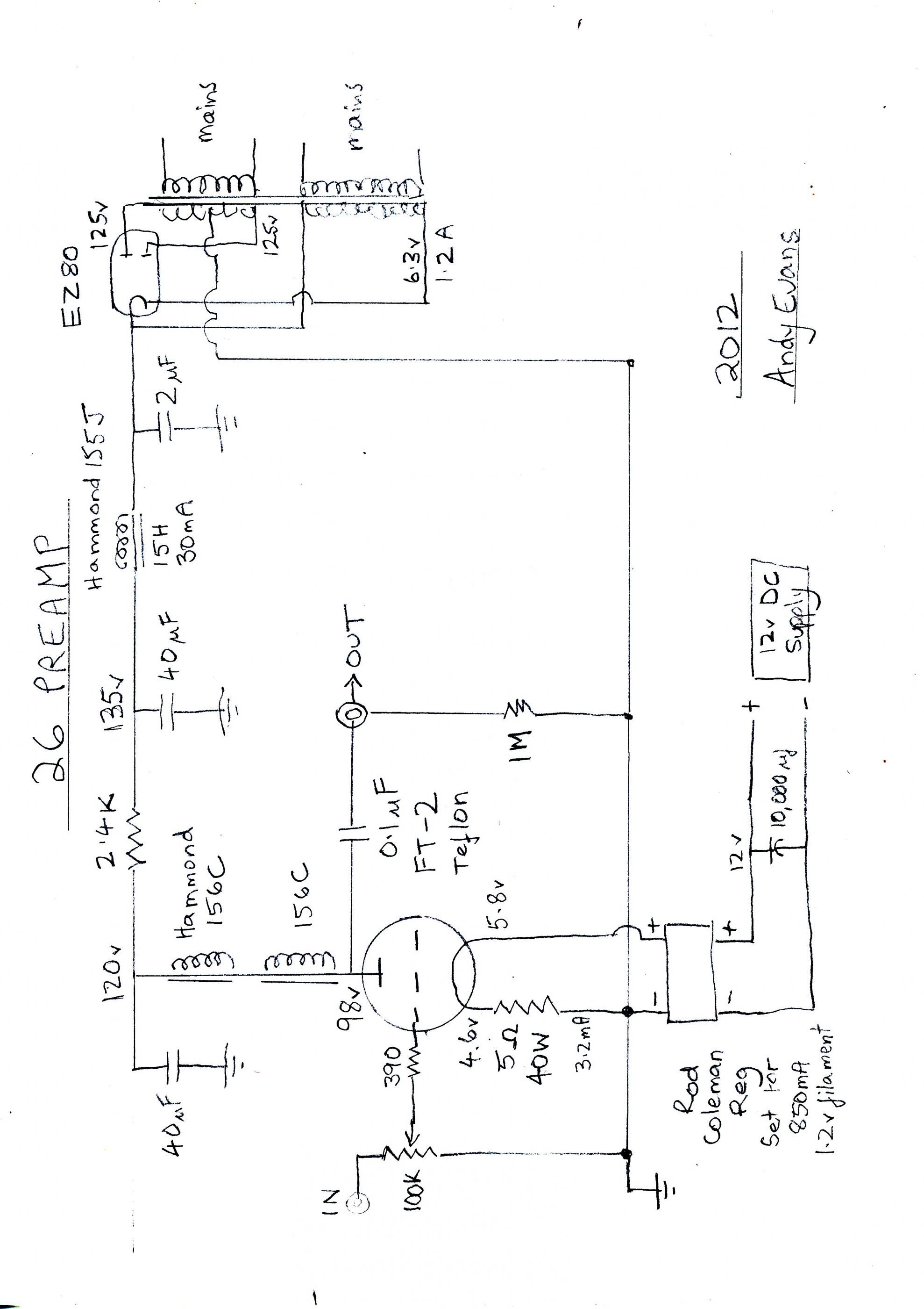

Here's a rough sketch of the design I was using. Andy
Hi Rod, what schematic do you use?
Hi Felipe, my personal taste is to drive cables strongly (unless they have very low capacitance).
So I like high quality transformer output, or low impedance drive circuit.
I like filament bias best - nothing is worse than electrolytics in the cathode circuit! But, the filament supply must be highest quality for this architecture.

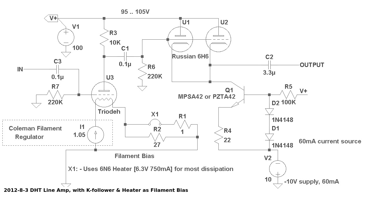

Here's another schematic - this time the low-impedance - but low-cost solution!
This is the version of filament bias we developed, using a IDHT cathode follower - with its heater soaking up the filament bias heat - and saving the trouble of an extra heater supply!
The 6H6 has a 6.3V 750mA heater, and 2 in parallel give 22mA/V, which translates into a cable-drive impedance of 45 ohms !! Enough to drive the worst kind of long cable.

Hi Andy,
In post 1941 above you set the anode voltage to 98V, with 12 VDC as a heater voltage input to the Coleman reg and a 5 ohm/40W resistor.
Last year you mentioned for the 26 an anode voltage of 138V, with 16 VDC as a heater voltage input to the Coleman reg and a 10 ohm/50W resistor.
Can you please expand on the difference, as both designs used the double 156C? Was it just a difference in available mains transformer voltages, or is the one above a further development with audible improvement?

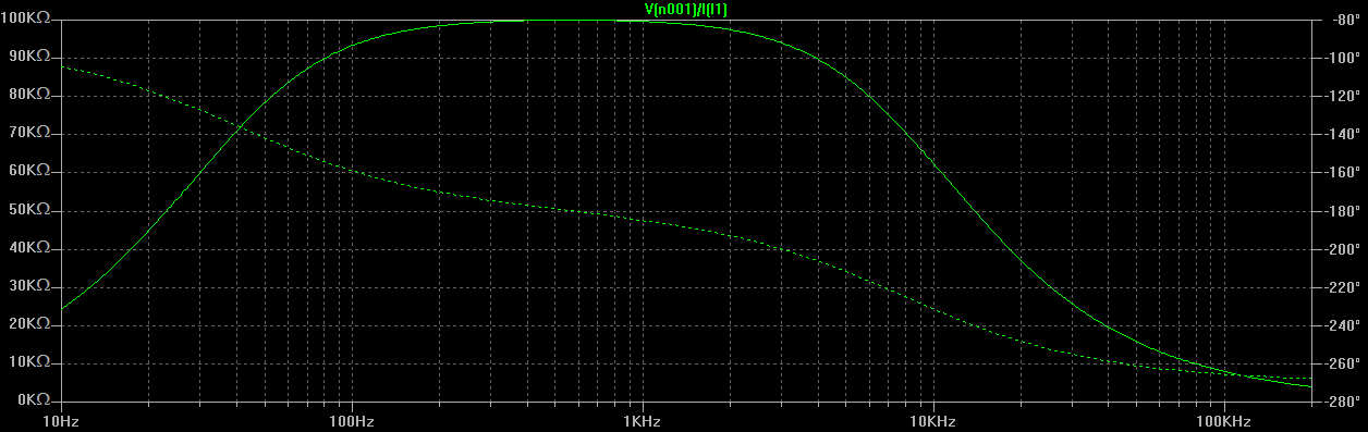

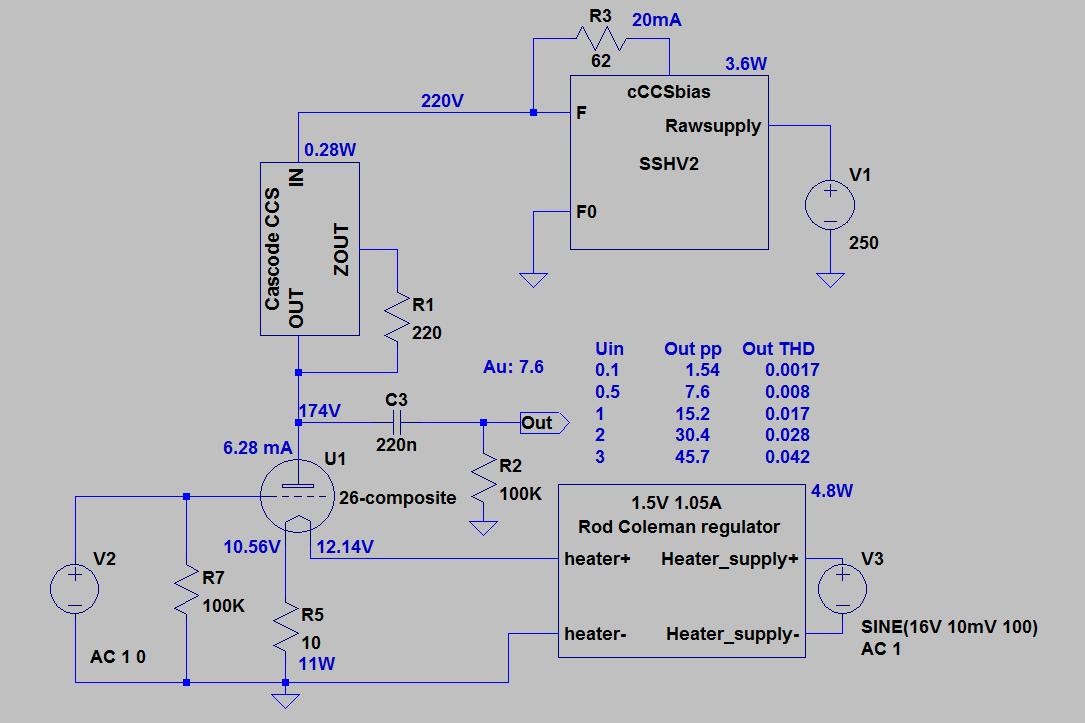

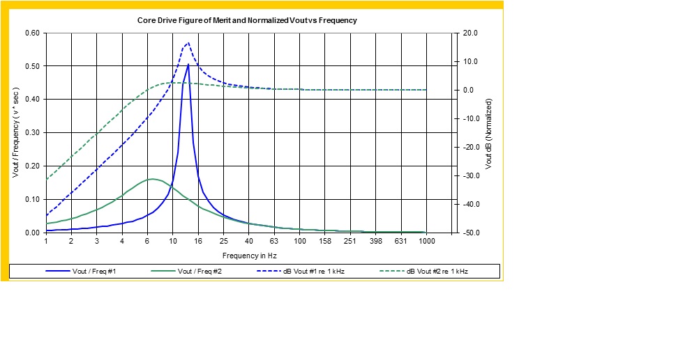

I'll be trying something similar using Slagle autoformers in a parafeed setup. The nickel laminations can be stacked to give up to 190H inductance. I plan to try out the 26 plate output directly into the autoformers as well as the mu output from the plate CCS (should be ~1500ohm). I figure that it can't hurt to try running directly into the volume control before sticking a transformer in between.
I've read that others have tried and failed using a CCS mu output into a parafeed output due to oscillations, but my sims show that with the right "lossy parafeed" setup the LF peaking can be very well controlled. I've attached a plot showing the LF response and the core drive figure of merit, using the autoformer stacked 3x3 (~150H) for regular parafeed (dark blue trace) and lossy parafeed. The extreme LF peaking is greatly reduced using the LPF setup, and the -3dB point is lowered. We'll see how that works out in real life...
P.S.: My two aluminum chassis (PSU and Preamp) are finally in the manufacturing process at Front Panel Express and should be done within 5 working days - Yeah!!
Output to S&B TX-102 TVC.

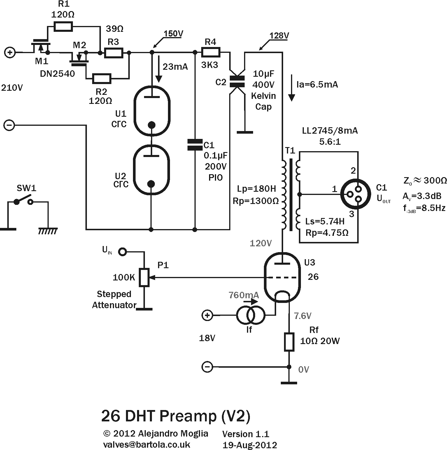

I've been testing the LL2745 OT in the workbench and now am planning to build the following incarnation of the 26 preamp. I will use the Gary Pimm's approach to CCS+VR as HT. I have done some tests recently and they perform really well (i.e. over 60dB attenuation at 50Hz). I'm re-using the HT and LT raw supplies but luckily can try the operating point that found in the workbench to be quite good for the 26 (after previous tests and preamps versions).
I don't have at the moment a balanced input amp, however I'd like to leave this preamp ready for future push-pull amp project which may have a balanced input. I can then wire a special set of cables with the pins 2 and 3 only...
thoughts?

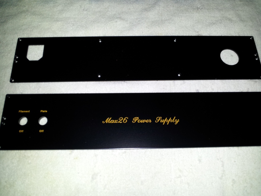

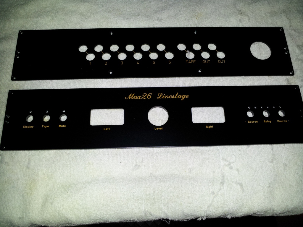

Just received the panels from Front Panel Express. Everything came out great except for one minor glitch...the bottom panels were chromated on the wrong side...we're working that one out. The chromating gives a corrosion-free finish so I can use the bottom panels as ground planes. Other than that they look great! I've attached snapshots of the front and back panels of the linestage and power supply.
The front panels are 5mm thick aluminum, the back are 2.5mm thick aluminum. All are powder coated in jet black and engraved with ochre brown infill. The cutouts line up perfectly with the Bent Audio control and input selector panels, too.
The top panels of both units have been dropped off at a local plating shop for triple chrome plating to a mirror finish for that extra little bling.
Once I get the bottoms straightened out the build can be completed, hopefully within the next 2 weeks!
