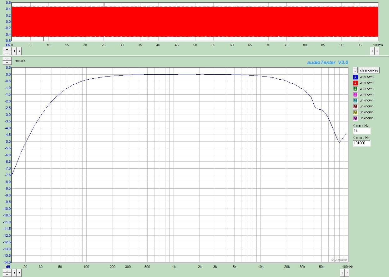

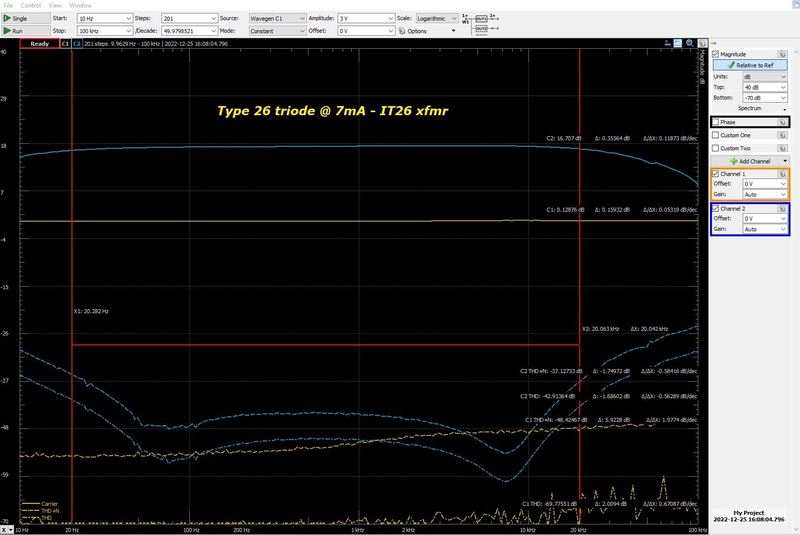

26 plate resistance at its best operating point is 7.3K. The primary of K-400 has Z of at least 15K at 20 Hz (signal level dependent), which results in about 1 dB roll-off at this frequency. It is in agreement with the data sheet. Frequency response graph of K-400 shows no HF anomalies; low capacitance winding technique has been used. HA-133 is -1 dB at 30 Hz and 40 kHz with 15K source; by extrapolation about -1 dB at 20-50,000 with 7.5 K source. K-400 and HA-133 are the pinnacles of this type of transformers.
