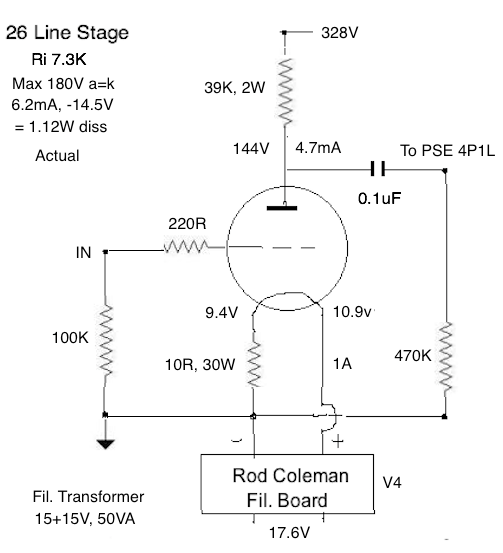

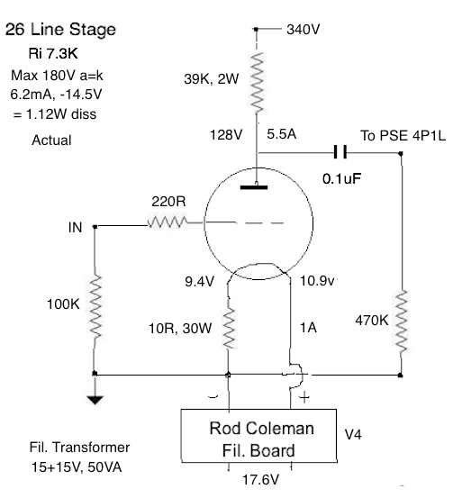

i have my second 26 stage up and running in filament bias. This one has 10 ohm filament resistors instead of 7.5 ohm. Otherwise very similar. With exactly 1.5V on the filaments, the cathode voltage turns out to be 9.4V not 10V as expected from a 10 ohm resistor. The resistor is a nice NOS Ayrton Perry type at 30W. On my other 26 stage the same resistor is bypassed to reduce it to 7.5 ohms, but the wire wound 10W bypass isn't quite so good. You'll note that the Coleman reg is V4 - I've collected a few V4s over the years I've been using them. For a new build you would use V9 and take 3V off the supply to the reg, so a 12+12V 50VA transformer would work. Use dropper resistors in the supply to get the right voltage. For this 10 ohm version the dropper resistor was 0.68, 5W.
It sounds very slightly cleaner than the other one, so all in all it's been a constructive build. Good luck finding NOS Ayrton Perry resistors at 20W to 30W. Yes, they do make an audible difference.
I've been happy with this 26 stage into my PSE 4P1L outputs, so I'm now getting down to some detailed work on parts. I'd be very interested to know what parts you guys are using on your DHT stages. I've also posted a more accurate schematic.

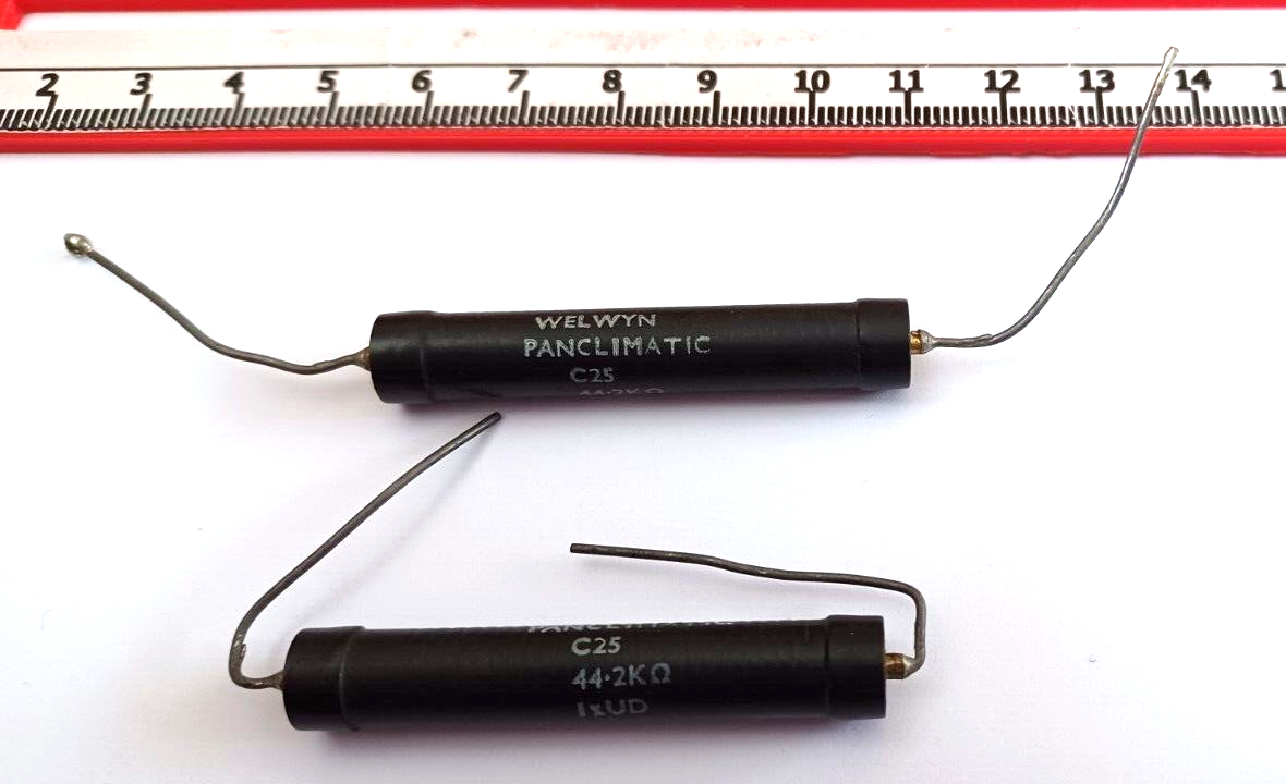

Anode resistors: I've been using 2W NOS black Panclimatic resistors, or alternatively 2 of 1W in parallel or series. I've been collecting these for a while. I want to try some 2W Audio Note Tantalums from HiFi Collective. Not cheap but they get a lot of love. I prefer Panclimatic to Vishay bulk foil.

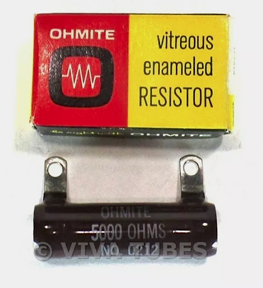

Cathode resistors in filament bias: You need 20W to 30W here. I mount them above the top plate because they get hot. I've tried a few types, and here are my findings:

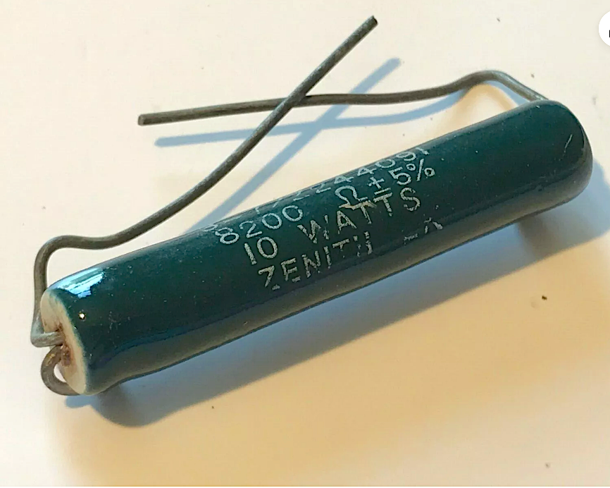

Welwyn Zenith NOS resistors - my preferred ones so far. Dark green with 2 leads on each end, one long and one short. I don't have any more stock, alas
Other NOS large vitreous enamel resistors - e.g. Ohmite. Can also be good
Stackable NOS Dale dark grey resistors: Easy to mount. Good but NOS vitreous enamel are better

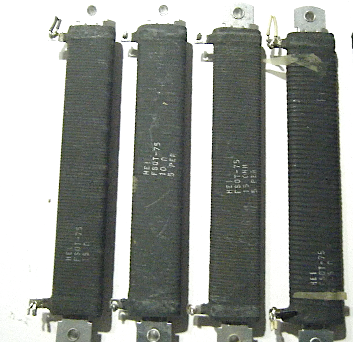

Russian military light grey ceramic resistors: Different sound to the Dale ones. OK but the vitreous enamel ones are better
Welwyn W series: Maximum is 12W or 14W so need to be used in parallel. OK but the vitreous enamel are better.
Aluminium clad power resistors: I didn't manage to get those sounding good
Thick film: didn't like those at all.
Pics below. Do please share your own choices.
