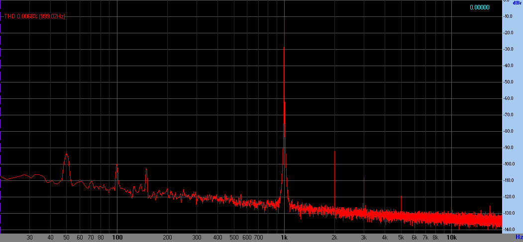

@euro21 - looks good. How hot do your heatsinks get? I'm not looking for too much H2, just more than H3. Do you think the 26 is a better tube for a bit more H2?
The heatsink only lukewarm after few hour operation, with 18W dissipation per each side.
These DHT tubes are very linear (mainly if swing isn't too large) devices, so H2 always greater than H3.
#26 also has very low THD if swing is low (H2 more than 80dB, H3 more than 91 -near 100- dB lesser than carrier signal).
If you want -more prominent- H2, try 01a with forced loading.
See here.

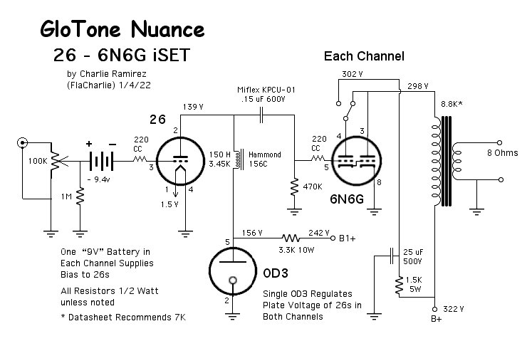

While you’re experimenting you might consider giving battery grid bias a listen.Has anyone directly compared filament bias with cathode bias and good cathode bypass caps?
I'm on my way to doing this, with DC Link cathode bypasses. Schematics below. I'll report back when they're up and working.
I'm curious since battery is in series with signal input, would not the type of battery used affect sound just like caps ?

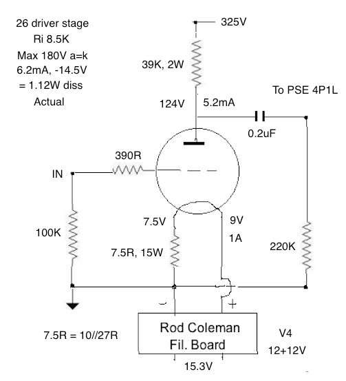

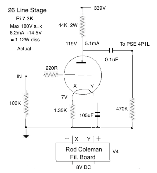

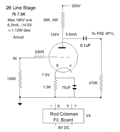

OK - so now I have the cathode bias 26 stage built and I've been auditioning it against the filament bias version. The schematics are pretty close, though not quite identical. Just small variations. Parts are very similar. New cathode bias schematic below. Listening material was opera, classical and jazz piano trio and vocals.
I can say right away that the filament bias version wins comfortably. It has greater clarity and transparency and the tonality on acoustic instruments and voices is clearly superior. Piano is notably more realistic, with more overtones and subtleties. It's a thinner overall sound than the cathode bias version with less "warmth" - it's pretty neutral in tone.
The cathode bias version seemed a tiny bit louder, though I didn't measure this. The sound was warmer with more lower mid bias. But even though the bypass caps were good DC Link Kemets, the sound lost transparency. The clarity and transparency of the filament bias version were unfortunately replaced by a more veiled overall sound. It was simply a "good" valve stage rather than a special one. The subtleties in voice and piano were less in evidence. It was consequently less involving and attention tended to wander. A disappointing result - the differences were bigger than I expected.
The conclusion is pretty simple - if you're building a 26 stage, build it in filament bias. Nothing new there, but now I have heard a direct A-B test I know the differences at first hand. I'm going to convert the cathode bias version back to filament bias. Not tried battery bias or other kinds of bias.

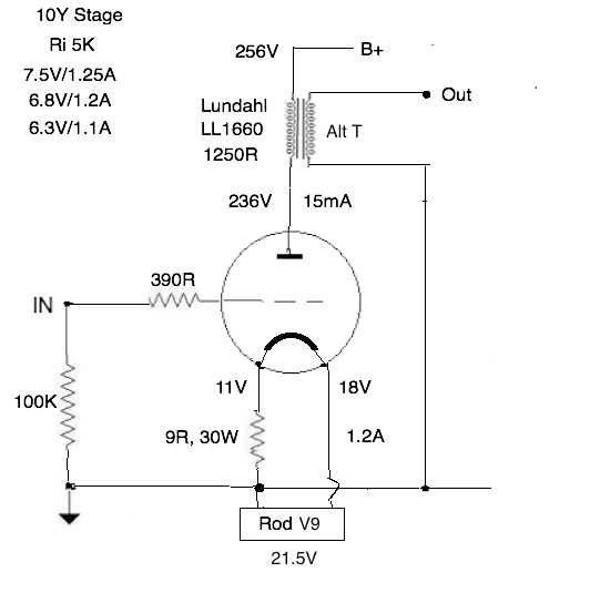

What LL1660 gap are you using Andy?Here's an example of filament bias with a 10Y. The cathode resistors will get very hot and I mount them above the chassis, same with the heatsink.

I assume your question is directed at me. No, I have not compared them myself. I was suggesting that Andy include battery grid bias in his comparison since he is currently experimenting with other bias methods using the 26.I only listened with filament bias resistor, have you compared vs batttery grid bias?
It would be interesting to hear his impressions. Very easy to give it a try.
Not sure where I saw it but there is some technically oriented builder who found that battery bias resulted in lower distortion than the other methods they tested.

Andy 59uF are enough to bypass the cathode resistor for 20Hz so surely sounds more clear like using 105uF.
I'm not using LL1660. This is the driver stage for my PSE 4P1L outputs.What LL1660 gap are you using Andy?
For the Cathode bypass cap, I don't think changing the value would have too much difference. The overall difference compared to filament bias was substantial. Anyway, I've almost converted the stage to filament bias using a 10R resistor - see if that makes a difference.

I'm sorry Andy I mixed things, I'm asking about your 10Y schematics at posts 5.460 & 5.470 using LL1660 for 15mA.
I understand your concerns but, when used in the grid, battery life is the shelf life of the battery. In the case of a lithium that's probably 9 or 10 years. Not zero maintenance but certainly minimal.Anyway, I have a horror of batteries. I like to have a no-maintenance amp - build it and it's done. That's just me!
Just thought you might want to listen to battery grid bias since you're in experimentation mode. Especially if you're not really sure if you've tried it before or not. It's also possible you tried it in the cathode of an indirectly heated tube which is a totally different situation.
