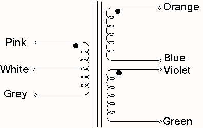

Incorrect...Really Sowter 9063 doesn't have two input coils it's a center taped....
https://www.sowter.co.uk/specs/9063.php
Sowter says "Two chamber bobbin provides full geometric balance for the ultimate in noise rejection and phase splitting performance." so the schematic is correct.

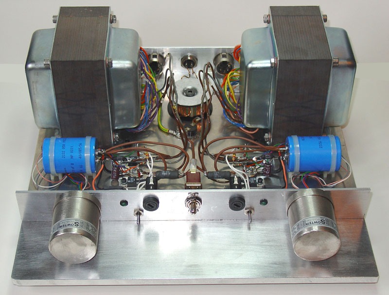

I use these transformers in my line-drivers:
"Two chamber bobbin" is what the Sowter page says.Sowter says "Two chamber bobbin provides full geometric balance for the ultimate in noise rejection and phase splitting performance."

Yes, you are quite correct.primary is always CT
The primary signal is always across both windings, otherwise the output won't be symmetrical because each output is on a separate section.
The schematic you are referring to also does not show the sectioning... it is not a physical representation of the winding stackups.
I have been using the 9063s since 2006, and have a couple in a box at my feet which are just about to go into a new line-driver.

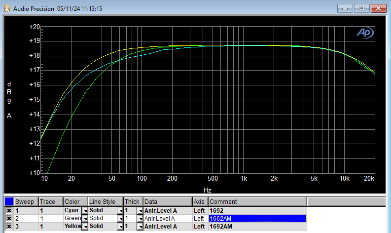

witch LL transformer??? ratio should be 1;1 ? to tune transformer a secondary load resistor its requiredI would like to share frequency response of 26 tube with LL interstage transformers
100mVrms input, about 800mVrms output, B+135V, plate current 4mA, secondary windings not connected
witch LL transformer??? Transformer model is in the comments column 1692, 1692AM and 1660AM (not 1662 - typo), all 10mA dc rated
Secondary not connected? How did you measure this then? These measurements were done on the first anode
Which configuration for the interstage are you using? that is recommended by Lundahl, Alt Q SE Line Output, will check later for Alt S SE to SE Interstage
The aim was to determine low cut, caused by the inductance of the primary winding. It looks that 95-100H is not enough

ALT Q is better choice (10Hz...55kHz) ... if you have low (below 2k) impedance tube (in this case inductance is only 95H).Alt Q SE Line Output, will check later for Alt S SE to SE Interstage
In this operating point #26 has 7k6 output impedance.
Using #26 with inductive load is the nightmare.
BTW Vinylsavor wrote here about this problem.
I ended up by designing my own xfmr for this tube (and let's say 6SN7 and alike) but it was a challenge because I wanted to be on the smallish side too, check post #5296

Thomas was just concerned about the output impedance which he wanted to be 300R rather than 600R to drive a TVC. But yes, tubes like 26, 27, 37, 56, 76 need the right load. I use a resistor but it needs to be at least 39K or more if possible. I remember using a 135H plate choke with the 26. Can't remember any special problems but can't remember what it was like either.ALT Q is better choice (10Hz...55kHz) ... if you have low (below 2k) impedance tube (in this case inductance is only 95H).
Using #26 with inductive load is the nightmare. BTW Vinylsavor wrote here about this problem.
Can you please explain distortion rise above 8khz?I ended up by designing my own xfmr ... check post #5296
