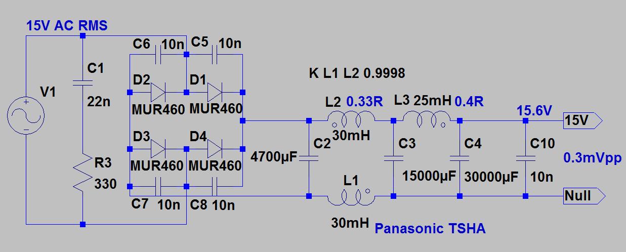

For -filament biased- #26 LT PSU even this PT may be appropriate (before R.C. regulator).

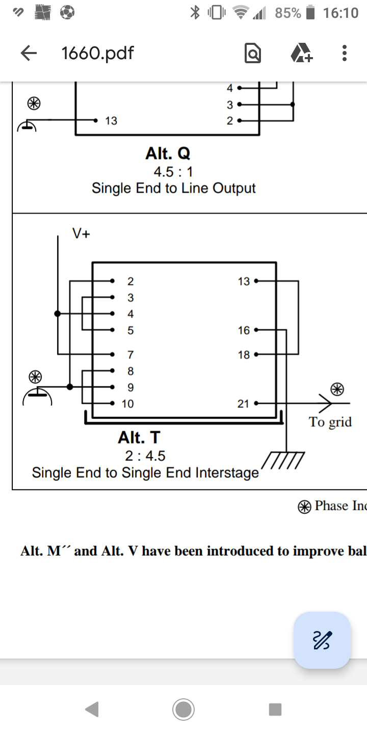

Hey guys advice for Lundhal LL1660 owners not using as anode load like me that I use active load or resistor-choke anode load like Andy you can use it as step-up using the configuration Alt.T 2 : 4,5 more or less a gain of 6dBs
Alt. T
Primary Inductance 33H
Freq. Response (+/-1dB) 25 Hz - 30 kHz
@ source impedance (max) 3.5kOhm
Secondaries open
The source impedances used in the tables indicates a recommended upper limit, unless freq. response can be compromised.
At lower source impedance resonance peaking will occure. It can be reduced using secondary load resistors.
33H at 20Hz about 4k1 impedance.
You must to use driving it with -max- 1k3 output impedance device ..... then must to use on secondary (few kOhm, circa 10-20k) resistive load to damp resonance bump... so "6dB gain" flew away.
No free lunch.

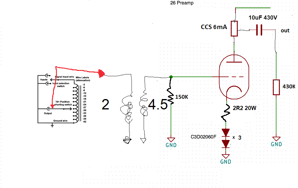

When you said "if you drive this transformer with low output impedance tube" are you refering to 26?
No.
#26 has 7k3...8k9 output impedance, so practically unsuitable to drive well LL1660 in Alt T (source impedance (max) 3.5kOhm), which transformer primary is 4k1 impedance at 20Hz (33H) .
#26 requires at least 120H as anode load.
p.s.
In my old #26 preamp I use CCS as anode load and capacitor coupled 400H TVC as volume controller. See 5416 post.
Reactions: andyjevans
If you don't use enough impedance transformation (scaling up to #26 anode), the 4k1 impedance at 20Hz can cause a problem just the same.
The #26 requires at least 15k-18k impedance loading at the lower region, which is result of all loading (anode load paralleled the AVC impedance paralleled the transformed impedance of AVC loading etc.).
Please sketch the schematic to avoid misunderstandings.
Oh, I totally misunderstanding the arrangement. 😢
Using line output transformer as input stepup not a standard method.
p.s. Sowter 9063 has two 24H "input" coils connected in series (pink-grey). Center "white" wire used only if the connection is symmetric.
