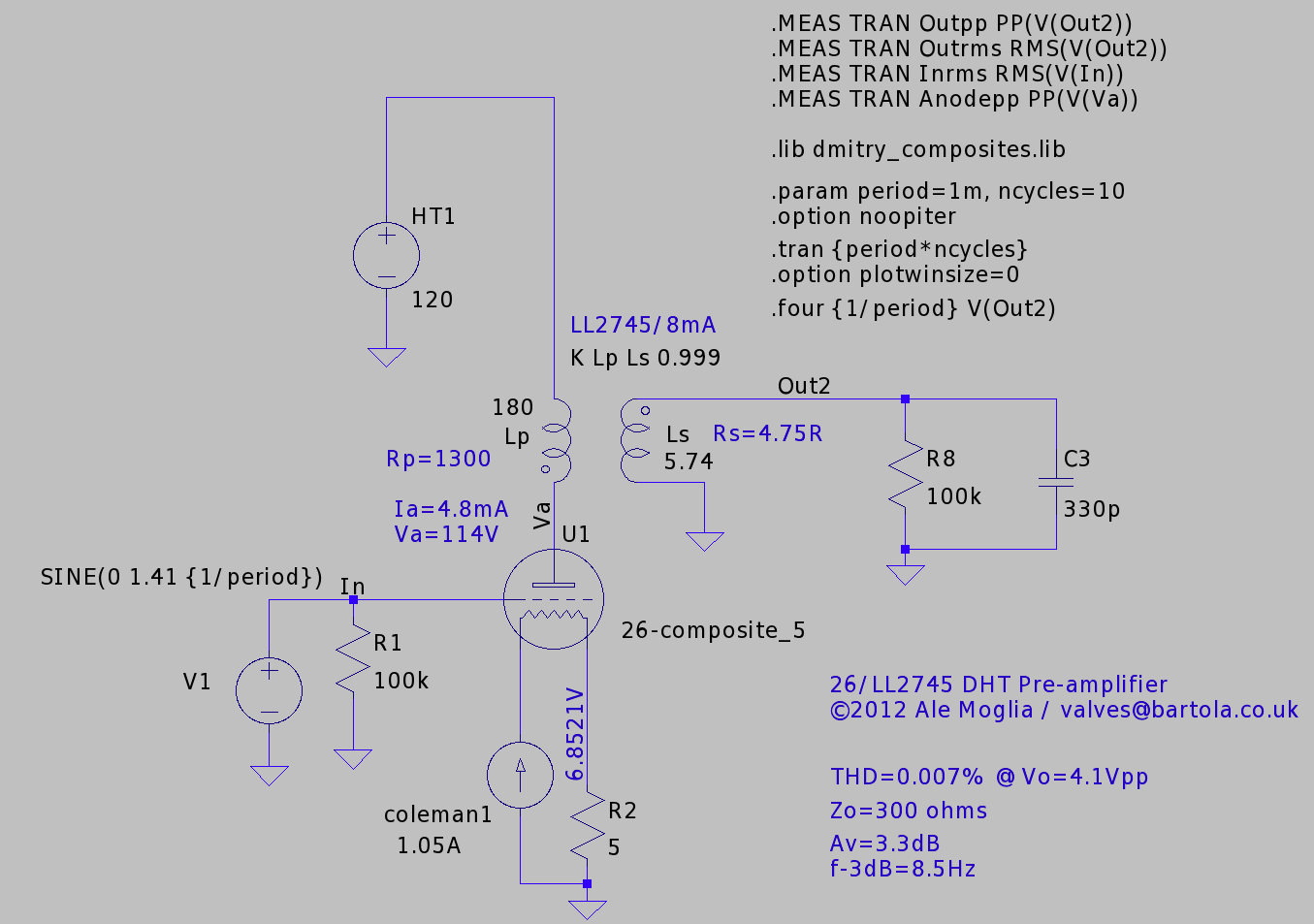

Thomas Mayer kindly send me a pair of Lundahl LL2745/8mA to test on my 26 and CX301a preamps. These OTs look very promising to provide low output impedance in an DHT pre-amp configuration whilst driving them in their best conditions.
http://www.bartola.co.uk/valves/wp-content/uploads/2012/07/26-preamp-based-on-LL2745.png
I played a bit with spice to try different operating points based on previous tests and what Andy also tried. Found an interesting point that I'd like to try this setup which is Va=114V, Ia=5ma, Filament bias at around 7V with Rod filament boards. Gain is about 3.3dB when configured in 5.6:1 and distortion figures seems really promising. Much better that what I had with the LL1660 and previous op point.
Has anyone been using the LL2745 OT and share his/her experience?
Been also looking at similar circuit for the CX301a as am currently using it in my setup and want to do a side by side comparison to the 26...
http://www.bartola.co.uk/valves/2012/07/14/a-preamp-design-with-the-ll2745/

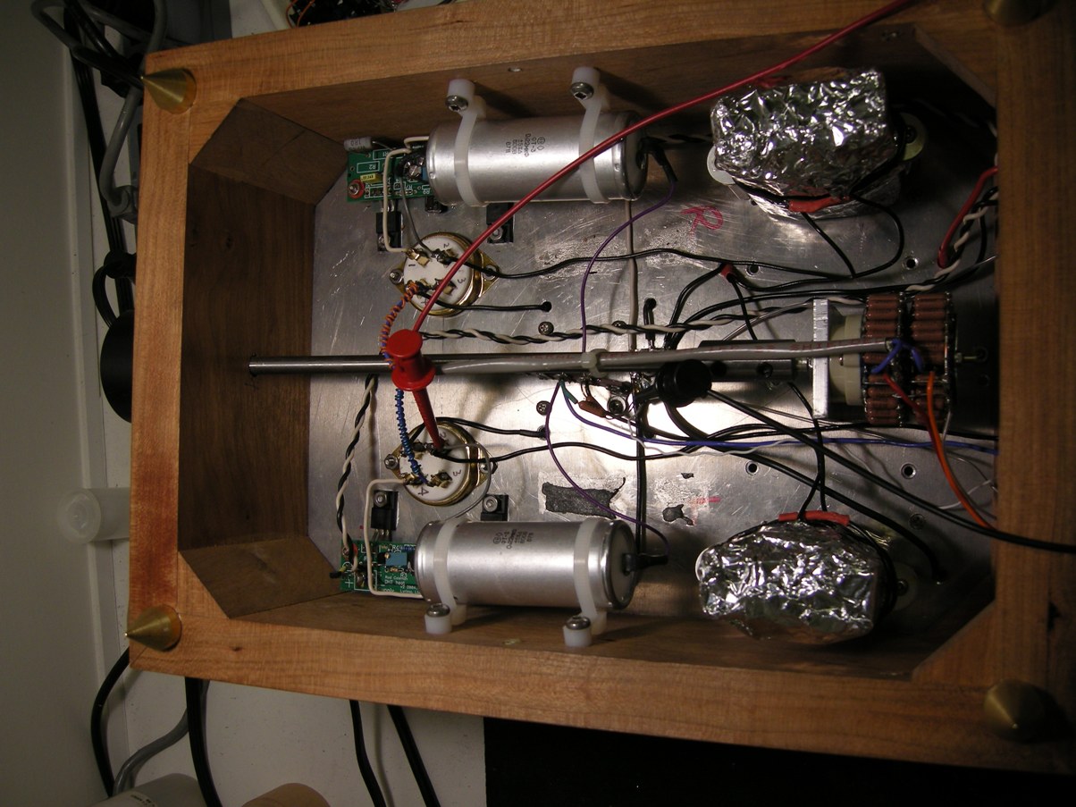

I lately tried 2 156c route with Andy's inspiration. The result is more than what I expect. It sounds better and measures better to my former configuration with 1660 10mA.
I have Sala's SSHV2 in 40mA to 2 156c, a FT-3 0.22 with 1M to ground, filament bias with Rod's reg. My power amp is with 100k input - 6C33C OTL. Soundstage is open, wide and deep. Sounds very good indeed and not congest with complex music. I know there is still lots of good tubes for preamp out there, but this is the best preamp to my ear to date. Will up some pics later.

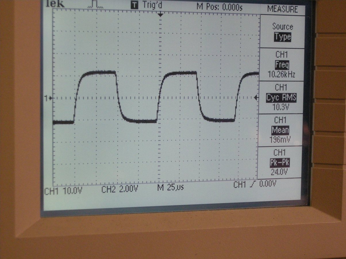

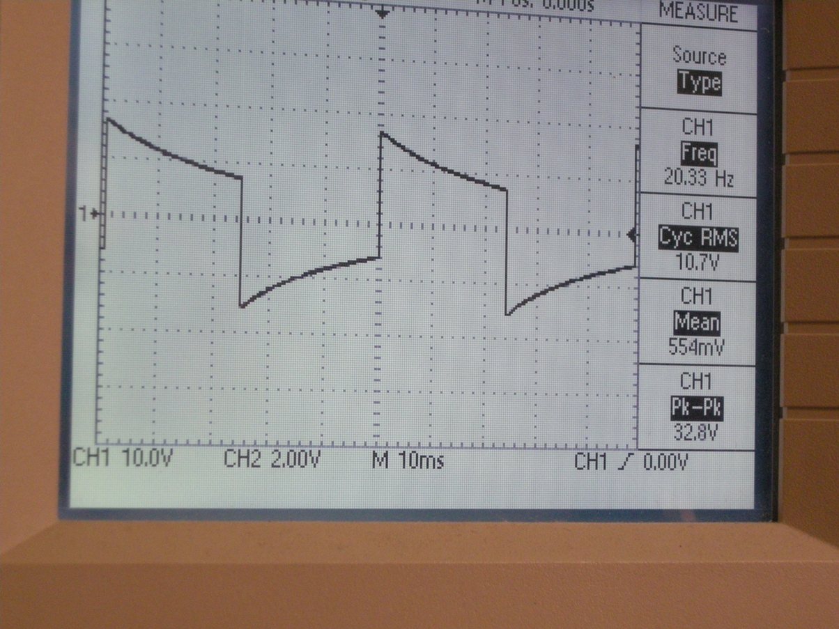

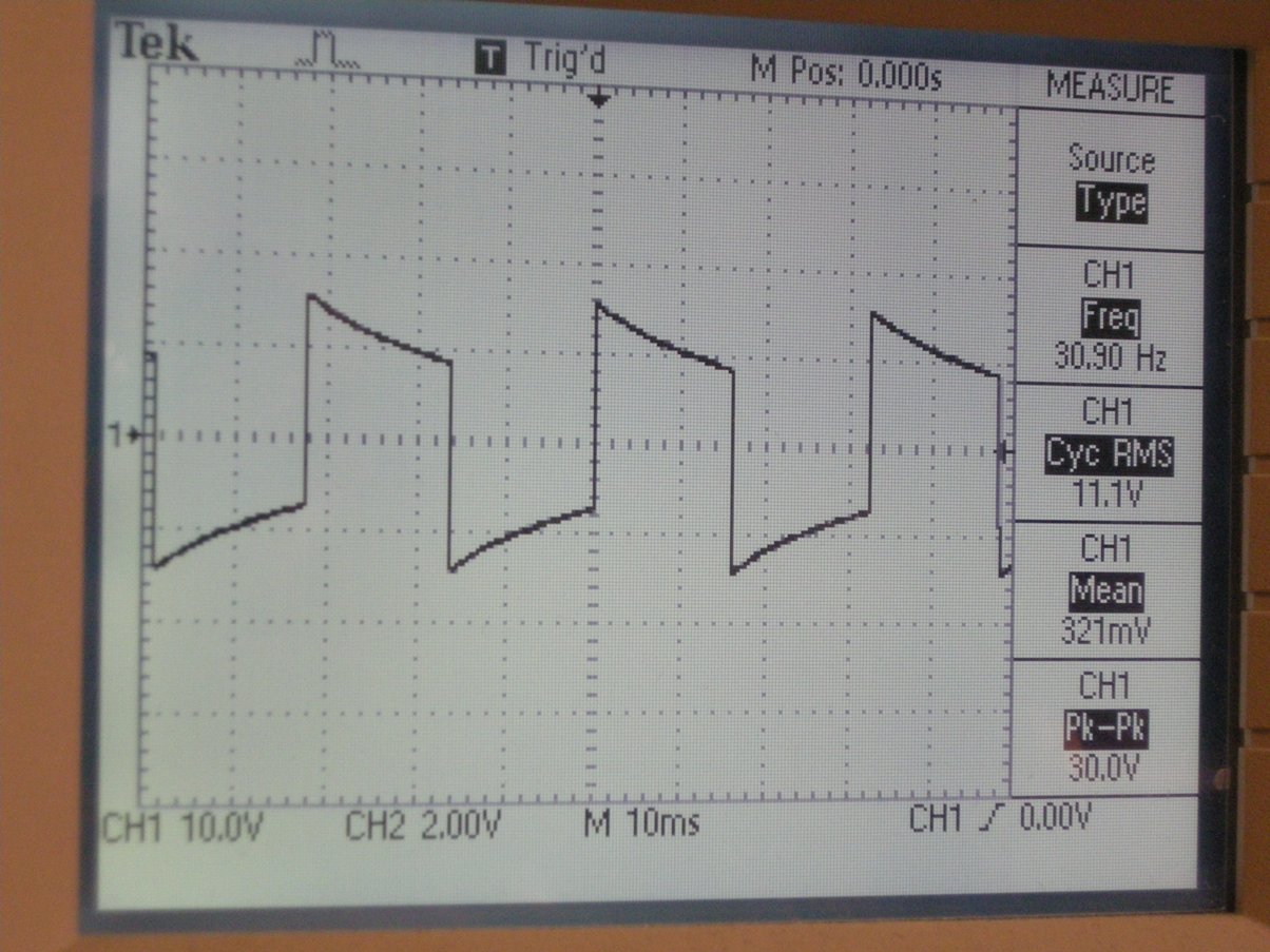

Measure with cyc.RMS
I fixed 10v input from my signal generator to 1K and I have the following numbers.
20 9.65
30 9.95
40 10.1
50 10.2
80 10.3
100 10.3
300 10.3
500 10.3
700 10.2
1k 10
2k 9.92
3k 9.77
4k 9.69
5k 9.60
6k 9.52
7k 9.45
8k 9.36
9k 9.30
10k 9.13
11k 9.07
12k 8.98
It shows the higher the frequencies, the more it drops. Is there anything I could do to improve this ??
I added 3 4.7uf Solen on the signal box before the Sala's reg. and it improve the noise floor.
A friend with good ears came over last night and he gave very good comment to this pre. We really enjoyed listening to Cello & Piano kinds of music with this preamp. The saxophone sounds so real that we almost can touch it.
It had a very light hum at first. I have the 2 156c wrapped with plumber tape and topped with tin foil, and it works perfect. They are under the hood, you don't see them anyway. Ah...........

I've been looking at 2" aluminium tube to put around the 26s, 1.5mm wall thickness. The 26 is 45mm diameter, both ST and globe, so may help. Haven't bought any yet.
Wondering if the hum comes from the tubes or the 156C chokes
Andy
When I built my 26 preamp first time I've documented (earlier in the thread) that the 156C chokes pick up hum like crazy. No problem whatsoever with gyrator/ccs. In your case I don't think it is the 26s that pick up the hum, but the chokes.
Hi Andy,
- orientation: if you are lucky, rotating the choke will help, since the electromagnetic fields are oriented.
other methods to try:
- all power transformers located on a remote chassis.
- wiring between power transformer secondary and rectifier - and from rectifier to caps must be kept to an absolute minimum length. This is especially true with filament supplies, where the peak currents in the rectifier are 3A or more. The bandwidth of the rectifier pulses is very high (may be hundreds of MHz) and long wiring "transmits" these pulses to sensitive nodes of your audio circuit.
If you have a remote power chassis, and wire the rectifiers short, and locate it 1.5m away or further, and there are no large filter capacitors on your signal chassis, AND all filaments/heaters are well filtered or regulated dc, the hum-generating sources should be very small.
Screening with thin Alu or steel sheet will work if electrostatic fields are the problem (presence of voltages nearby that swing rapidly from one value to another (eg anode signals). This is much less effective against magnetic fields (proximity of rapidly changing current, eg power supply capacitor/rectifier node). In case of magnetic field, distance (from the generating source) is your only practical friend.
